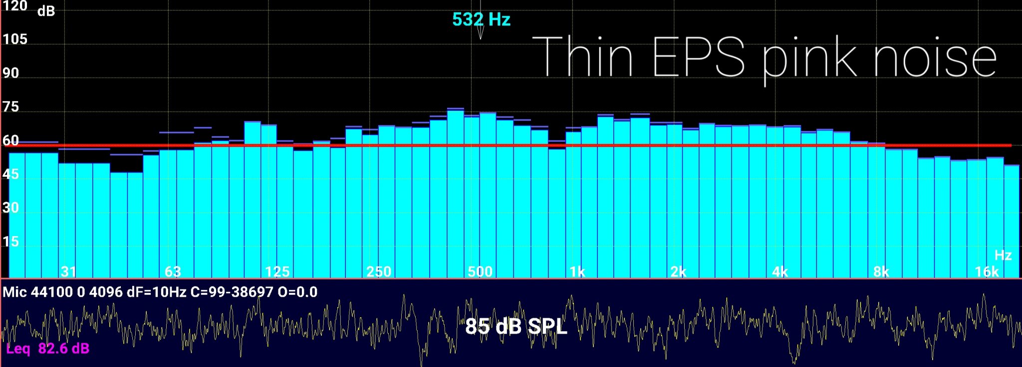

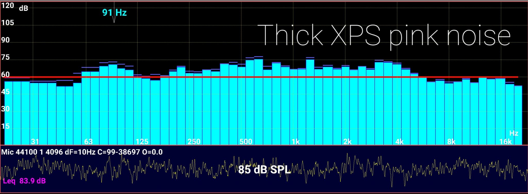

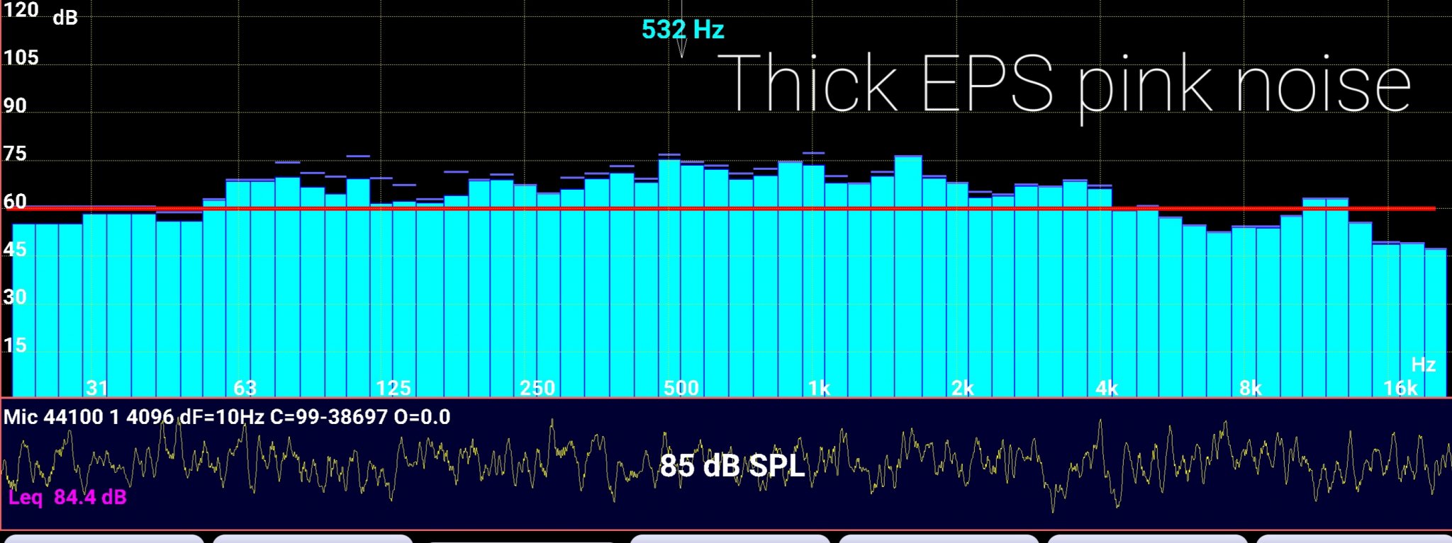

I tested several thicknesses of EPS and XPS, with various levels of 50/50 water/glue treatment on them and I really liked them for midrange and midbass, but to my ear the XPS gave better clarity and detail in the upper mid and high range, and a tonal quality I preferred. Not to say the EPS was bad but I preferred the XPS. They seemed to RTA about the same across the middle as I recall, but the XPS got better top extension and the EPS got better bottom. Seeing as I was going to run a 2.1 I figured highs were more valuable.

Apart from the thin eps the thicker eps and xps seem to roll off well before 8k ?
It's a little difficult to see with the 15db segments.
Interesting.
Steve.

Yeah, they all roll off about 8 but the XPS dips less then rebounds from 12-16 or so.Apart from the thin eps the thicker eps and xps seem to roll off well before 8k ?

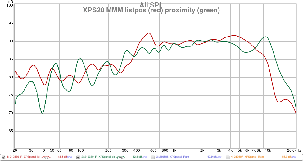

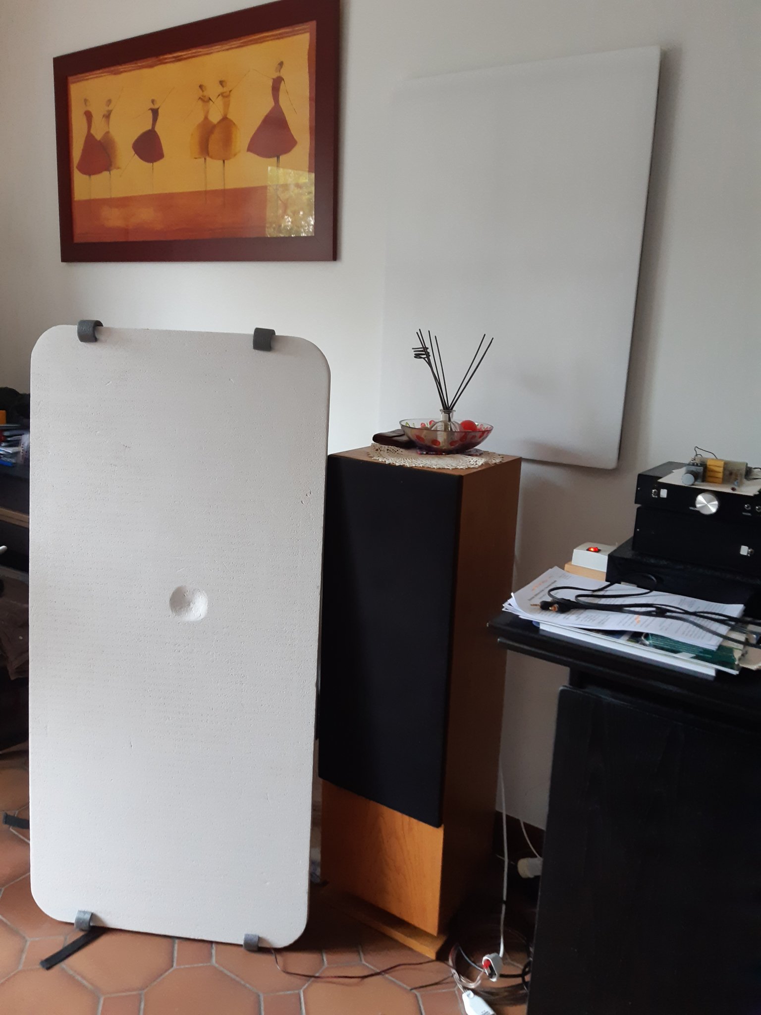

Below are measurements I made with a 125x60cm XPS panel, 20mm thick. Watered PVA coating + watered white acrylic paint on the front face. The thickness at the exciter axis was reduced (see picture) to reduce the treble (too harsh before that), the exciter is Dayton Audio DAEX25FHE-4.
So in my experience no lack of treble with XPS 20mm (density 31kg/m3, mu after coating 0,8kg/m², D bending stiffness 22Nm - was 18Nm for the raw XPS).
As you mentioned I think it is to check the exciter. I have no experience with other exciters but the reasons of my choice of the Dayton Audio DAEX25FHE-4 are a low voice coil mass, low inductance which could be reason with other exciters of a more limited bandwith ?
Christian

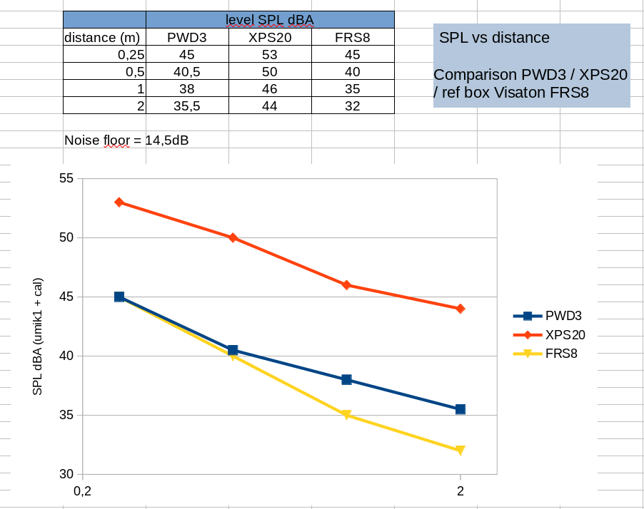

I measured a difference of about 9bB between a 3mm poplar plywood and a 20mm XPS. So the 3mm poplar ply is comparable to a 82dB standard loudspeaker and the XPS to a 91dB. I suspect a birch ply to be less efficient (heavier)....Ended up using the Birch Ply for my final build because the tonal quality was worth the trade for efficiency. I would be down to use smaller Ply panels but I know XPS is far more sensitive. Balsa may hit a middle ground between tone and efficiency...
A big difference between DML and a standard loudspeaker is the sound field decreases more slowly; a bit like a line array so an additional gain of about 3dB can be expected at the listening position.
Attached those measurements : pink noise at different distances for a 20mmXPS (125x60cm) panel, a 3mm poplar ply (120x45cm), a Visaton FRS8 speaker in a 1.2l closed box (I used it as a kind of reference).
I saw in different post the idea of panel made from balsa. I am interested by this idea. Does somebody have experience, construction ideas? Which balsa? which direction for the wood grain?...
Christian
