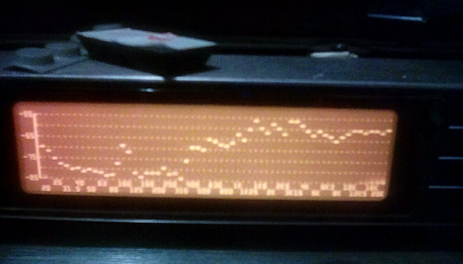

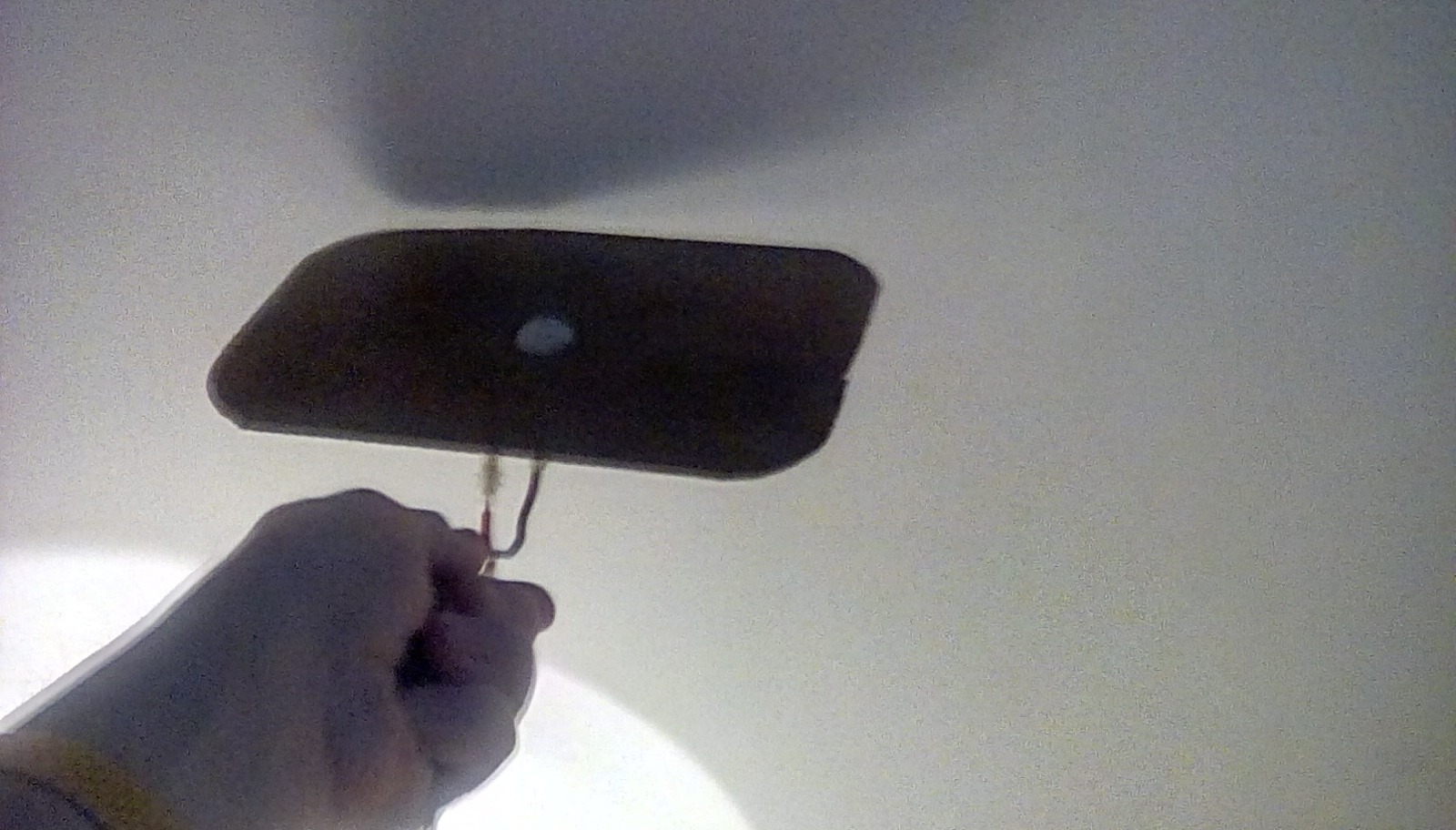

I made a mp4 recording of my 6x9inch veneer panel to show what happens when you mount a panel flat up to a wall or ceiling, but it seems mp4 does not upload anymore .
I did post the question about upload formats in forum problems but with no answers, so it would seem like no more recordings ?
The response below at least 500hz falls away dramatically when placed flat against The ceiling.
The music I was playing had very strong bass down to 40hz which came through in the centre of the room and with one edge close to the ceiling as in the picture but not flat up against the wall !
Steve.

Just made some quick measurements of the panel ,one with the panel edge close to the ceiling as in the photo and one with the exciter side up close to the ceiling.
The microphone was lying on the listening area seat and the panel was about 2.5m in front, but on the ceiling.
The roll off in The top end is more to do with the CD and mic position.
Steve.

I should have mentioned that I was playing a track from the CD on peak hold, that has a lot of low bass .
The dip in response above 100hz reduces the closer you get to the panel.
Steve.
Steve.

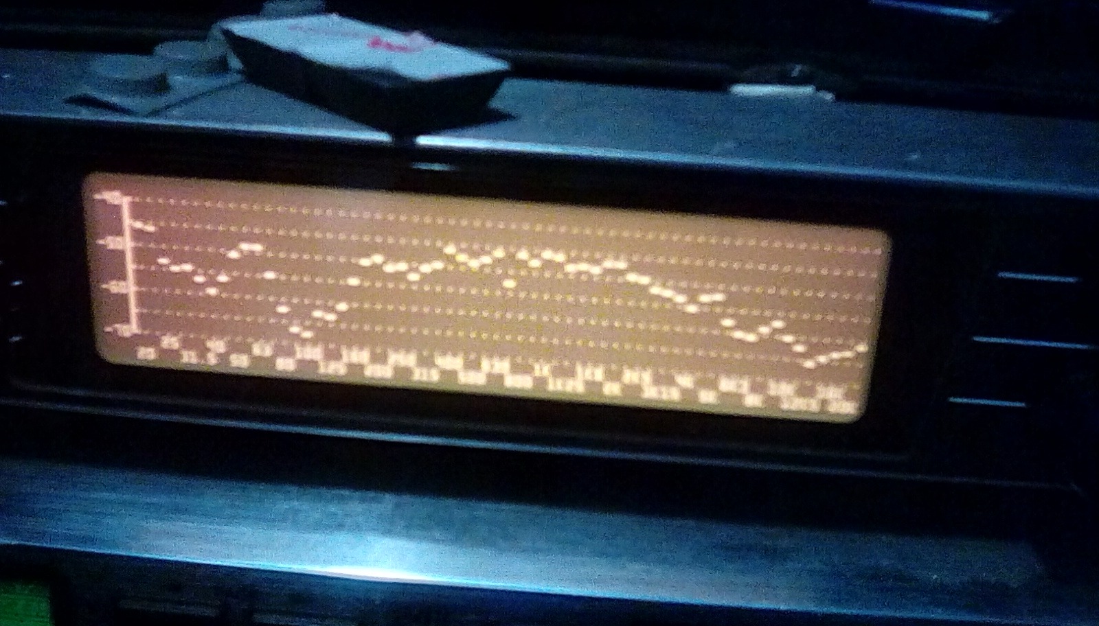

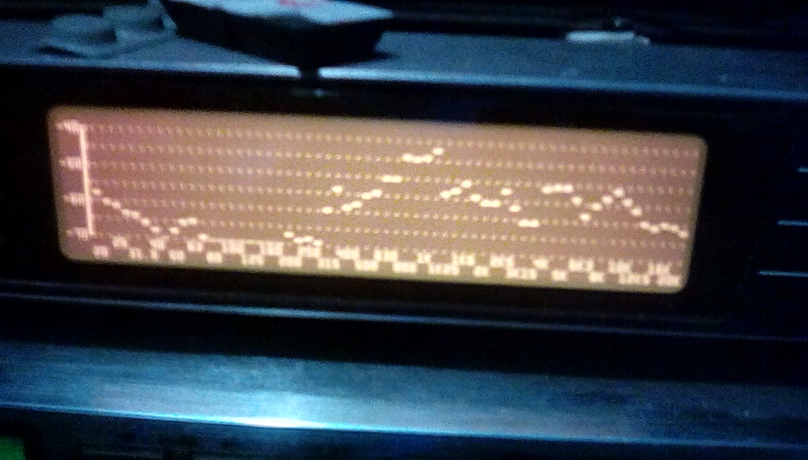

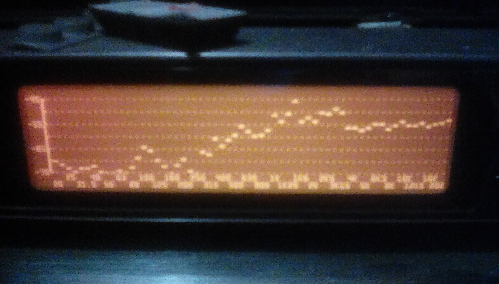

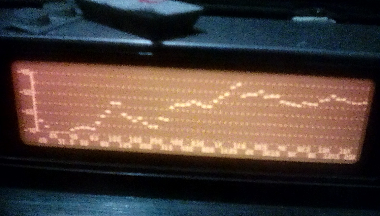

I measured my 6x4 inch ply panel that I peeled off of my canvas panel,which is missing one of its plys as it is still stuck on to the canvas .
Sorry about the quality of the photos, hopefully I will get a new phone soon ?
The lines are in 5db steps.
The roll off point at 3m is just below 400hz.
pic 1
30cm
Pic 2
1m
pic 3
3m
Steve

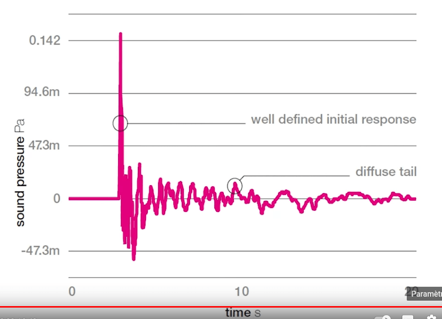

Good question! As there is no notes in the file I did some archaeology in my notebooks and on the net... So I think it is from the available information plus some speculations...
The facts for Tectonic panel are (from spec and video)
- 40x50cm (378mmx478mm) => A = 0.2m²
- 3.5mm thick
- carbon honeycomb
- stiff and light (91dB efficiency?)
- used from 100Hz
Here start the speculations...
There is a standard ratio of 2.5 between F0 and 1st usable frequency. This leads to a "classical" F0 = 40Hz
As F0 = pi/A*(D/µ)^.5, it gives D/µ = 6.5. Then Fc = c²/pi*(µ/D)^.5 = 14.5kHz
The second level of assumption I made (and today I can't find how I come to that...) is µ = 0.4kg/m² so D = 2.6Nm
If I find where how I infer the µ value, I will tell you.
By searching for the justification of those values, I found in a Tectonic video the FR and IR of their panel. Interesting to keep.
Christian
