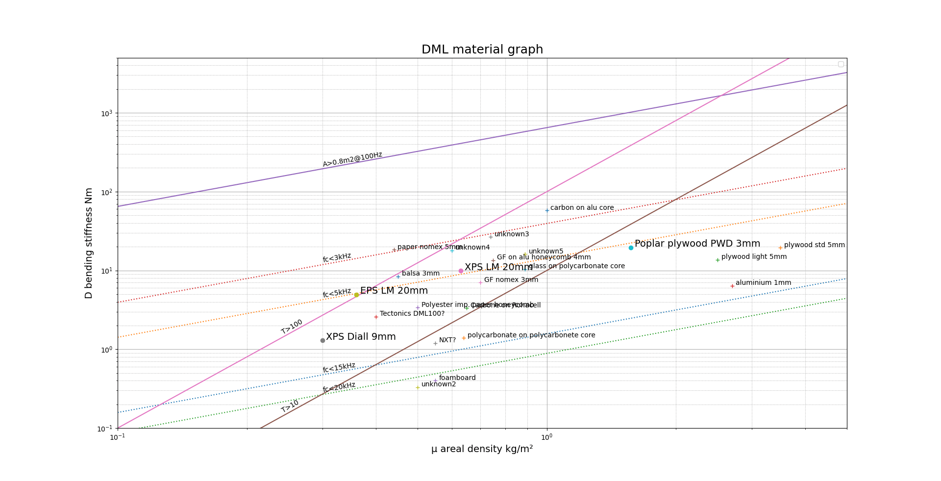

You will find attached a graph I made plotting the DML materials I crossed while reading or testing in m, B axis. I added some lines to see where are those materials in Fc, needed area to reach low freq or some B/m^3 (=T)
In my documents D is for B and µ for m.
I copy here below the list of materials (list1 was collected in readings, list2 in my own tests)
If somebody likes python script, I attach it (change .txt to .py extension; need numpy and matplotlib)... but helping to learn how to use a python script is out of scope (thank you for your understanding). Something similar can be done with excel, OpenOfficeCalc
To come back to you post 599, I think you had the basics :
- f0 (lowest frequency) is driven by B/m
- fc (coincidence frequency) is driven by m/B
- efficiency is driven by B/m^3 (here is link to piano sound board thesis )
I am convince that keeping an eye on those values should help while testing or comparing realizations (ie for panels made from XPS, EPS or plywood).

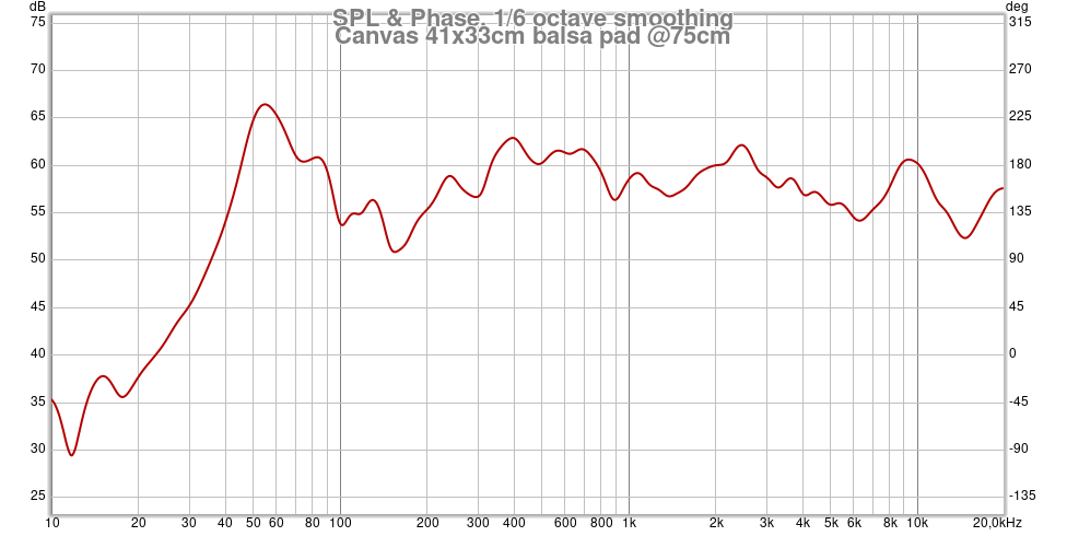

I just weighed my 2mm 3 core 6x4inch ply panel I used for my canvas panel.
It was between 16g to 17g ,I think the core material is supposed to be balsa and the outer is another type of wood ?
It is very rigid and hard to flex, 2 ply balsa may not be rigid enough ?
My art panel if I remember correctly ,had quite a large hump in the response below about 100hz to the sharp roll off at 40hz.
Also the measurement of the panel before I attached it to the canvas was pretty much the same from 20k down to about 400hz where the panel rolls off.
The canvas helps the ply fill in the response below the 400hz point.
Because of the ply used it will have a similar sound to the larger ply panels I have used but maybe slightly more damped by the canvas and glue?
Steve.

I see you pad is closer to the first one I cut before being afraid by its weight! Seems more plywood from a light wood (poplar? basswood?) than balsa. I saw from a famous internet site small sheet of plywood called "balsa" which are not balsa.
The panels I built has its resonance at 55Hz. A little bit higher what you get (my pad is lighter, the tension of the canvas is quite high). See FR below (at 75cm on axis)
At the moment, I think 3mm plywood is too heavy and perhaps a bit too stiff. The mix thinner plywood plus fabric seems promising would be the next?
Christian

as you say the canvas panel is a good full range panel ,as long as you do not place it up against the wall !
Unless you toe them out from the wall , as demonstrated in my recordings of the panel close to walls.
This would be my choice if I was using them full range, I might even have them hinged on the side wall and swing them out when I wanted to listen to them ? Or even the ceiling ? And obviously the front wall of course.
But as I use my tls for the low end duties below 300hz I will stick to my various ordinary dml panels for my main system.
Steve.

Christian,I will be happy to read about your method to evaluate B. You will find attached how I proceed. This kind of things were part of my education (to get my degree) but it was a long time ago now and never used since so do not hesitate to tell me if I am wrong.
Your method of measuring D (i.e. B) is equivalent to mine. I simply use a three-point bending geometry, instead of the cantilever beam that you use. That is, instead of the cantilever geometry, I use the geometry shown here:
http://mi.eng.cam.ac.uk/IALego/bender_files/bend_theory.pdf
For this case, the equation is the same except the constant needed is 48 (in place of 3). The only reason I slightly prefer the three-point method over the cantilever methods is that I think it's a little harder to be sure you have a true cantilever. But either method should give the same result if done with a little care.
Also, as I suspect you know, for some materials you can easily calculate D.
For example, for a homogeneous, isotropic material:
D=Et^3/12, where E is the elastic modulus and t is the panel thickness. For materials whose modulus you can easily find in a textbook or reliable internet reference, this should work well.
For a sandwich composite with skin layers of equal thickness on both top and bottom you can use this:
D= (2/3)(E1)f^3+(2/3)(E2)h^3+2(E1)fh(f+h)
where E1 is the elastic modulus of the skin(i.e. face) layers and E2 is the elastic modulus of the core layer. Also, f is the face thickness and 2h (yes 2h, not just h) is the core thickness.
if I've typed correctly, this matches the first (least simplified) equation in the wiki link:
