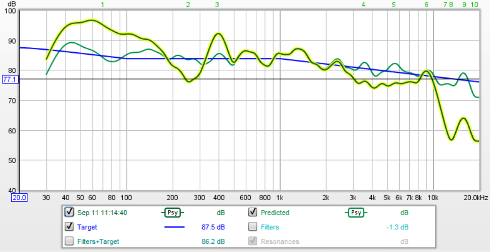

Below is the only chart I have (I don't have one with a measure of the panels alone). The highlighted one is the raw measurement. You can see the dip at 250Hz where the sub falls off and the panel begins to pick up. You can also see the huge falloff up top. I just remembered I put the exciters (Aiyima 25W, 2x per panel in parallel IIRC) on with thick double sided tape which might be robbing some high end response. I will glue them on directly and see if that helps.
I have the panels down hung about 4" off my kitchen ceiling. That probably doesn't help, but that's how I have to hang them lol. I'm sure if I had them perfectly placed I'd get better response, but we work with what we get.

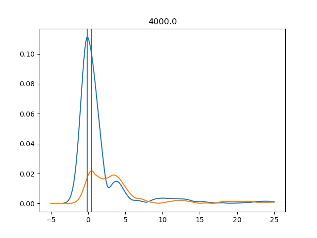

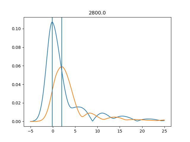

I tried some measurements to visualise the wave speed in the panel with no success.

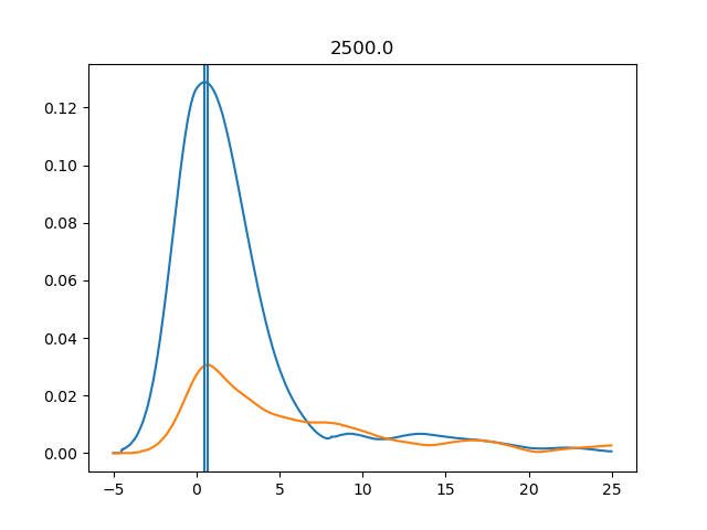

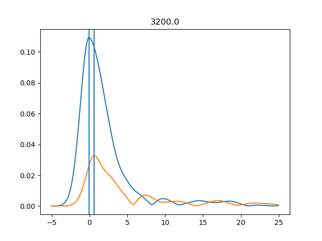

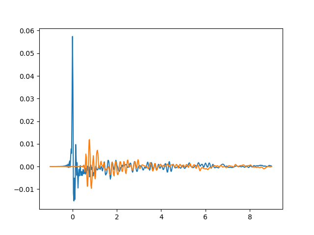

For the wave speed tentative of measurements :
  • In alternative to umik1 USB microphone I use a hand recorder Zoom H1n with 2 omni electret PUIaudio AOM5024 (the reason of the AOM5024 is their much better signal to noise ratio than other electret, they are affordable, easy to find - ie Mouser)
  • with that I have a logsweep on a usb stick
  • The Zoom H1n allow me to record 2 synchronized signals
  • For the wave speed test, one mic is at the exciter axis, 1 or 2cm from the membrane
  • The second mic is placed in a second location, 20, 40, 60cm from the axis in the panel plan, at the same distance from the membrane than the 1st one.
  • The sweep is recorded, a correlation extracts the Impulse response.
  • Some home made Python scripts make all of that a little bit easier but the core is the use of logsweep and correlation from DRC by Denis Sbragion http://drc-fir.sourceforge.net/ (my laptop is under Linux). See below my notes about Denis's tool (those notes should end with may others in a web site but it needs time..)
  • Attached is an exemple on my plywood panel showing the IR at the exciter (blue) and 40 cm away (orange)
  • I applied bandpass filtering in order to have a delay versus frequency and check against the theory...
  • At least, we can see how is the attenuation as the distance from the exciter increase
  • This try was based on the hypothesis the second mic picks up the sound coming from the panel in front of it. Is it so sure?
Please give me your feedback. I did those tests on a short period last July and after reading Aagas (#3619) about 1st reflections, there is perhaps some interest to undust this.

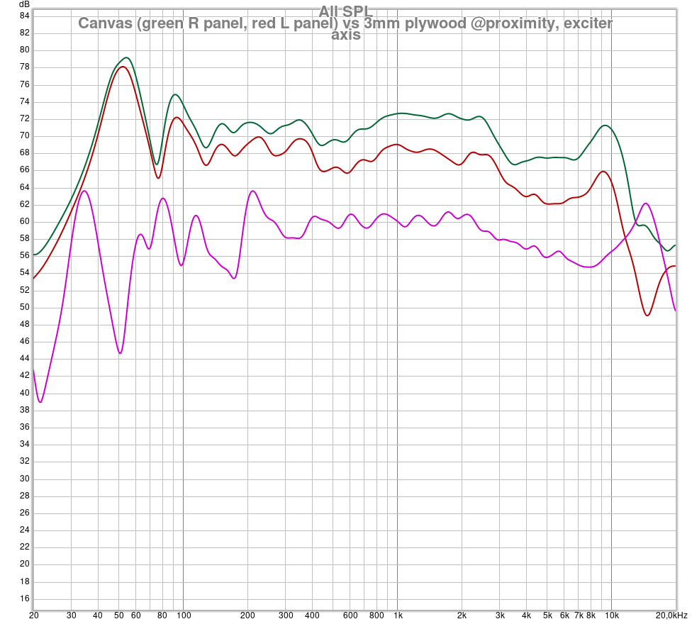

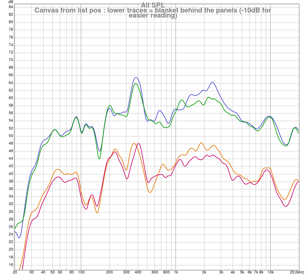

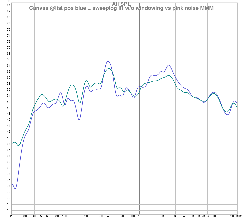

To come back to the my 1st canvas test you will find below some measurements.
  • proximity versus listening position
  • comparison to 3mm plywood (be careful it is not in the same room)
  • IR logsweep compared to pink noise MMM (Moving Microphone Measurement) - the results are similar
I made the choice of the IEC2623 export option from REW.
There is no EQ, no woofer. Only the panel. All the measures are with an Umik1 and REW.
The canvas have an incredible sound, time, cost efficiency score. For a low spending, quite quickly you can set up a pair of very good speakers! Cherry on the top of the cake : their size.
For now the missing point I noted compare to the plywood panel is the lack of very fast transients (or is it an excess from the plywood?)
What is noticable from the FR, is the damping in the canvas is higher (lower Q) so gap between the resonance is more easily fills.
Does somebody has advice/comment about :
  • this difference in transient? Is it written somewhere in the FR?
  • the FR shows peaks in medium (200, 400Hz and after). Those peaks are not in the proximity FR. Is there a method to search/understand their origin?
Any other comments/advice welcome

Christian,
Thanks for the description of your measurements. Very interesting.
So, was it your hope to be able to determine the wave speed in the plate by measuring the delay of the peak in the impulse response between the first and second microphone? Is this correct? But then the shape of the impulse was so different at the second microphone that you could not clearly pick out the time delay? Is that why you felt your measurement attempt was unsuccessful?
Actually, I think your measurement may be good. But the "problem" is that the wavespeed of a bending wave in a plate is not a constant, but rather depends on frequency. This is perhaps surprising. For example, the speed of sound waves in air is a constant, independent of frequency. But this is not so for flexural bending waves. Rather they follow the rule:
c=(B/m)^1/4*(W)^1/2
where c is the speed of the wave, B is the plate stiffness, m is the plate areal density, and W is the angular frequency of the wave.
See equation 3.85 from page 55 here, for any clarification:
https://www.google.com/books/editio...pAtwmxs-jaMC?hl=en&gbpv=1&printsec=frontcover
So since an impulse is not a particular frequency, but rather contains a whole spectrum of frequencies, it does not propagate across the plate a a particular speed, rather, each portion of the impulse travels across the plate at a different speed, depending on it's frequency.
As a result, it is actually expected that an impulse will change shape, at is moves, because it spreads out as it moves, since the high frequency components move faster than the low frequency components. Such waves are called dispersive waves. There is some explanation here:
https://www.acs.psu.edu/drussell/Demos/Dispersion/Flexural.html
and here:
https://www.acs.psu.edu/drussell/Demos/Dispersion/dispersion.html
Your impulse measurements look a lot to me like the figure in the first link above titled : "Hammer impact at point 1"
Eric

Hello Eric
I see my explanations were not fully clear and I should have added more pictures.
So :
  • yes the basic idea is to measure the delay between the signals of the 2 microphones
  • the formula you mention is what I expected by the theory of bending waves in a plate
  • after having the IR, I apply to them a band-pass filter to limit them in frequency
  • it is between the IR band-pass filtered I measure the delay, not between the raw IR which are for sure broadband
  • when I plotted the delay as a function of the central frequency of the band pass filter, I didn't get what is expected from the theory but something "erratic".
Something is wrong somewhere.
You will find attached some example of filtered IR. I am sorry not showing for now the delay vs frequency but I am not sure of what my Python script output for now (problem of a software going from modifications to modifications and abandoned a few months ago), I should spend some time to look at it. If you have an interest for more on this topic, I could probably do it. Let me know
Christian
