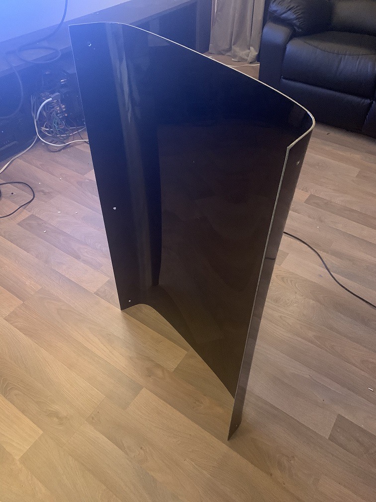

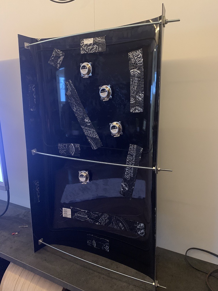

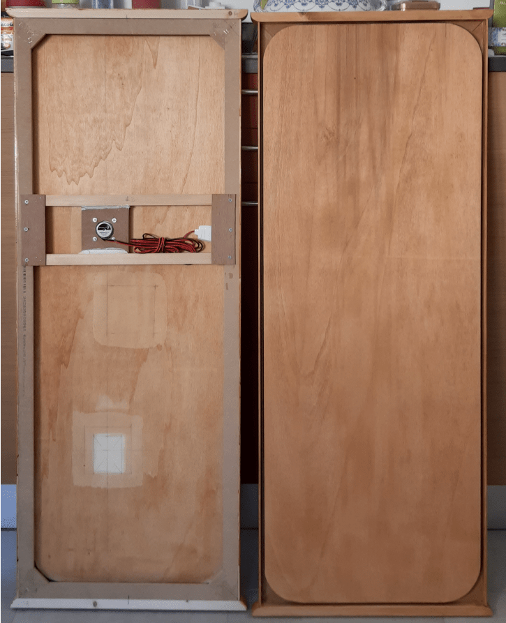

Here are a couple of pictures of a panel with a new material I have been testing out, Dibond.
It is 3mm thick with a core polyurethane and a surface of 0,3mm aluminium. This material can be bended and it still keeps its shape.
I bended it with the idea that this would increase its stiffness, while staying at the same weight.
I also "clamped" it by connecting some threaded rods to the corners and the middle. In theory if two opposite corners move outwards, the two movements should cancel each other out.
I put some bitumen damping mats on the back side of the panel. These are usualy used in cars to dampen sound. And work beautyfully to dampen some ringing I had, and to tune some resonances of the panel. On the aluminium surface the bitumen can be put on easily and removed to be moved around the panel.
The panel size is 1000mm x 748mm and I divided the distance between the exiters in height by using the golden section. Distance from top: 618, 382, 236, 145. If I make a panel that is closer to square, I tend to also use the golden section when deciding where to put the excters in width, but the shorter the width is I tend to put them closer to the center. The only change I did here was to place them close to the center in width, but not directly above another exciter.
I first hanged it from the roof and it sounded good. Then I decided to make a rib behind the exciters, which also goes thru the threaded rods, to dampen some of the vibrations in the rods.
Now it does not sound so good and I have some distortions that I can not make out where they come from.
Work in progress ...

Hi Giamesh
DMLs often get described as "bending wave loudspeakers".
One typically wants them free to bend rather than stiff or rigid.
I also don't follow your reasons for "clamping" the sides together with threaded rods.
I like the idea of using Dibond panels, but as they get manufactured for signage and often outdoor signage, I think the weight (thickness) of their aluminum skins may work against you.
I'd love to get panels like these with the thinest aluminum skin possible, which would give an interesting balance of bendiness and surface hardness.
I tend to follow the simplest path with these DML experiments.
Why not just try sticking a single exciter on the back of a flat Dibond panel and see what it does.
It might surprise you.
I increased the stiffness (by bending the material) based on the idea that better stiffness : mass ratio in the panel material usualy is a good thing for a DML panel. (Stiffness brings up the natural frequency / resonance of a material) I don't need to bring the resonance frequency down, since I always have been able to make DML panels of different materials, that I crossover with my sub in the 100hz area. And I find it easier to control any problems/resonances I get in the higher frequency area, compared to lower frequency.Hi Giamesh
Can you explain why you think a DML will benefit from "stiffness"?

Hello to all DML builders. This will be my first post!
Despite I have been in audio DIY since a while, I discovered DML thanks to this thread beginning of this year. Thanks a lot!
I would like to make one suggestion and ask for advice.
Before, for a better understanding, let me summarize where I am with DML.
I started with the topic beginning of the year to replace my tired 3 way columns.
The hazards of surfing the internet lead me to this thread. Attracted by the possibility to make my own speakers (not only the cabinet!) I started to read from the first post to the current last one the threads about DML (diyAudio, the historical Audiocircle, Part Express...). A little bit long... very instructive. I took some notes.
Even if I was septic on the possibility to reach a "good enough result", I decided to give it a try.
The first prototype was a standard home insulation 20mm XPS 1.25x0.6m, moved by an off-center Dayton Audio DAEX25FHE-4, then PVA coated and after with a white acrylic finishing. It was an encouraging try as expected, at least on the sound reproduction... my wife was not really happy with the dimensions neither with the aspects even with a paint finishing. To be elected as a main sound system, some equalization is needed.
The second prototype was a 9mm XPS 0.50x0.60m, exciter at the center. Very bad results.
The third version is a 3mm poplar plywood 0.42x1.20m on a frame with a foam suspension, an off center exciter, a spine. Excellent! We have found with them what is written in this thread : wide frequency range, good sound stage, no sweet spot effect, impressive transients, something incredibly natural in the sound... even if I think it can be improved. No need of equalization. The best feedback is from my wife who finds with this version a very good sound in a nice enough finishing for our living room. She is even proud to make demo to our friends.
So on this basis, I am coming back to the forum reading... 5 or 6 months after my 1st reading how it is difficult to find again the thread of ideas!
Here is my suggestion (for readers like me...) : would it be possible to have from the DML builders from time to time a short summary of what they have in use ? Something like "my current panel is :...". I have written below how I'd describe mine. Please ask for additional information. i think it would be good to keep the description not too long.
I am wondering now which direction to go to improve the efficiency, to extend to the bass, if possible reduce the distortion.
Then now my questions :
Thanks a lot for your feedback
My current DML realization
in use : from 2021 summer
type : standard plain membrane (not a canvas type)
membrane material : 3mm poplar plywood
dimensions (WxHxh) : 420 x 1200 x 3mm
coating : no coating
finishing : highly diluted varnish
shape detail : rounded corner
spline : yes
exciter : Dayton Audio DAEX25FHE-4
exciter gluing : original double side tape
exciter position : off center (inspired by the IEC baffle)
bandwidth : about 150Hz to 20k
mounting method : frame with foam suspension
equalization : not necessary. I think about for a fine tuning
Christian

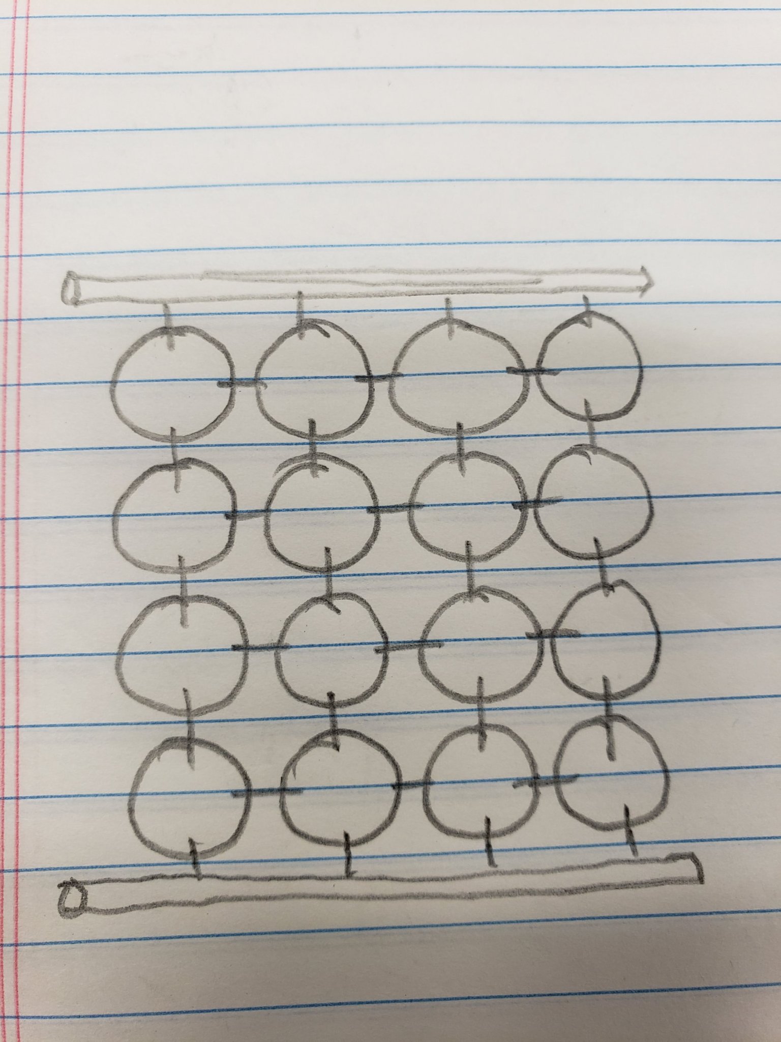

Has anyone in here experimented with or built a DML line array with low-powered exciters rather than a high output single panel? I had an idea for like a "curtain of sound" using 16 of the 3 or 5 watt Dayton coin exciters on small 8-10" round or rounded-corner square panels either suspended from one another or mounted on a grid in a 4 x 4 pattern. Obviously with them being possibly round, and suspended, and undamped the goal would be more of a whimsical, moderate SPL, backyard party speaker design than a critical listening panel. Cool thing is you could wire them in series-parallel and push the whole mess on like 25 watts per channel. I'm thinking with that many small drivers and the right substrate you could get a nice full sound. And you could basically roll it up for storage.
You guys think this is a folly project before I buy 16 exciters and a bunch of 1/2" xps or something? 😂

Experimented this kind of array no...
As every kind of array, a limitation in the highest frequencies should appear due to the geometry (the area will be like 75mm by side at the axis) and the sum of the coil mass (something like 0.26g x 16 = about 4g). The question is to predict it compare to your need.
Smaller exciter have smaller displacement and also smaller magnet. So in the overall, is this area able of at least the same efficiency and distortion. The displacement is probably a limitation.
From cost point of view, there is a ratio 3 to 6 between a coin exciter to a more powerfull one. Possible other cost balance are possible.
So why not to think about a more classical arrangement with let say 4 standard exciters, one in full range to go the treble, the 4 working in the bass.
Here, it opens a more general question to the community : among the DML builders, which arrangement is currently working? Single exciter or multi exciters like in the earliest posts?

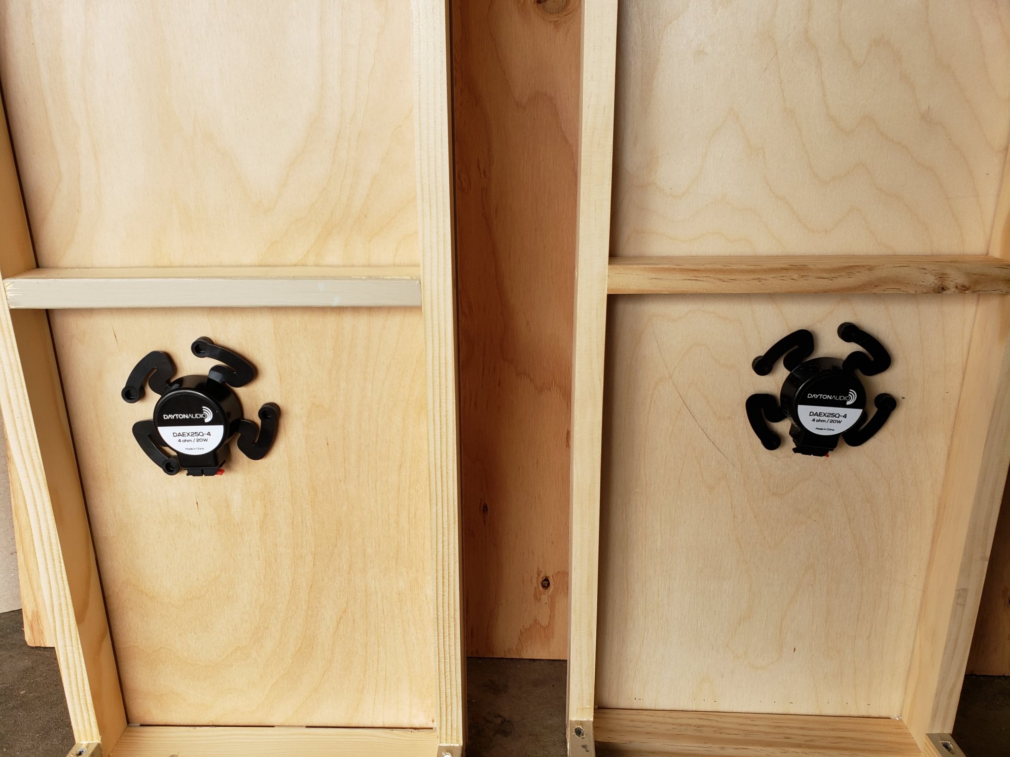

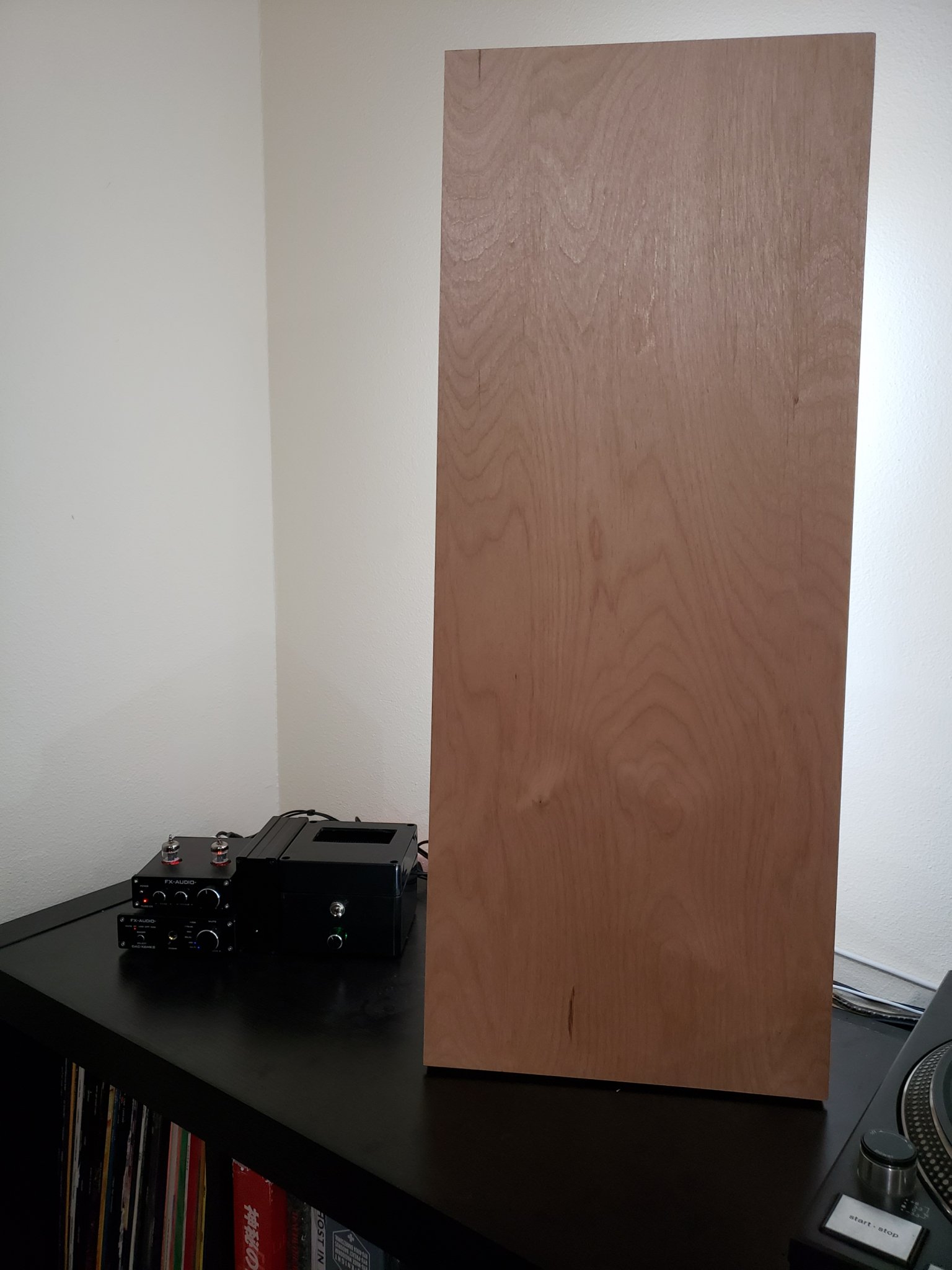

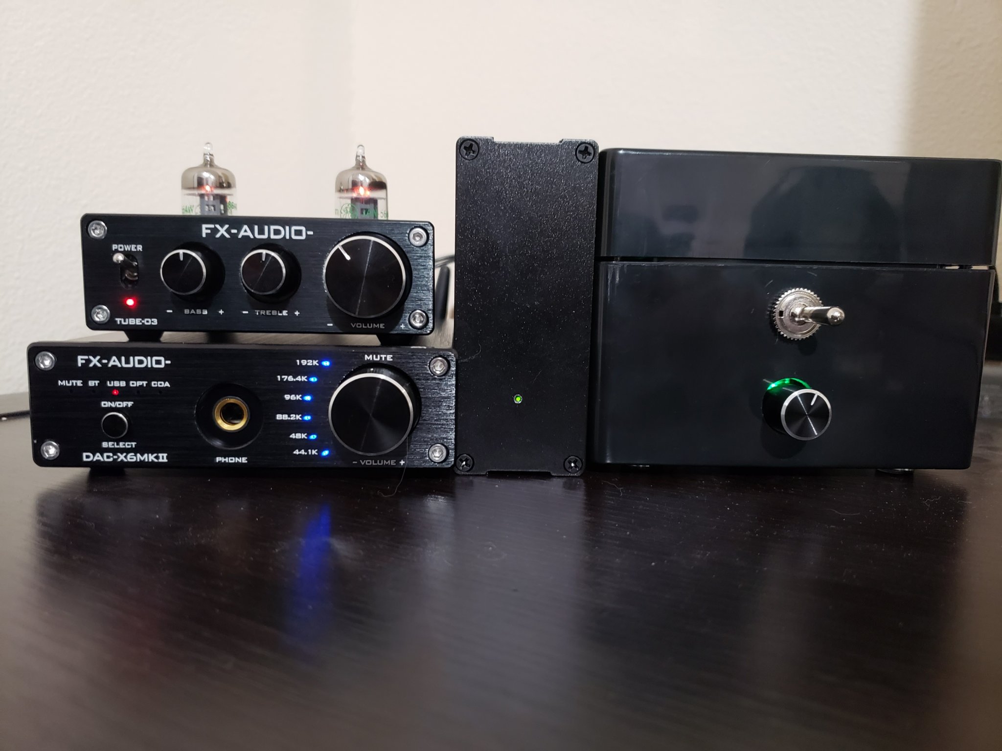

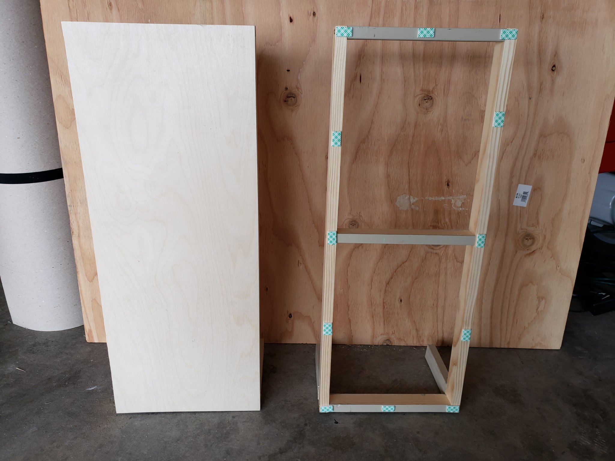

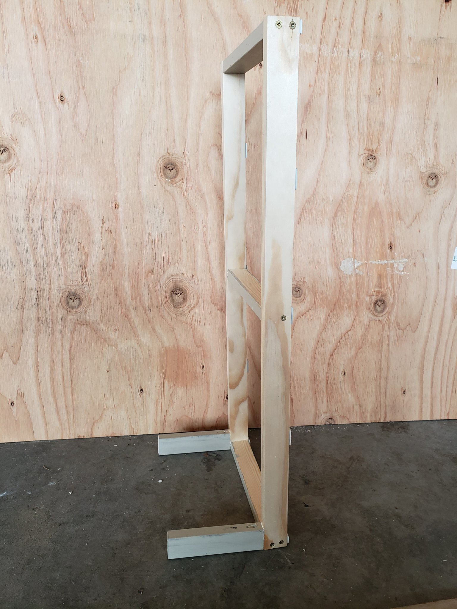

So after lots of experimenting, conceptualizing, failed prototypes, over- and under-designed and -thought builds, burnt exciters and wasted materials, these are what I ended up with, and I'm very pleased overall.
3mm Birch Ply, 12" x 30" surface mounted with foam tape to poplar frames. 3 thin coats of aerosol water-based poly on the Ply. Dayton DAEX25Q-4 exciters, non-reinforced, mounted on the basic 3/5, 2/5 node, powered by a custom build class AB 2x35 amplifier. I'm running them in a 2.1 configuration with a 10" velodyne sub, crossed over via a Dayton DSPB-K at 110Hz, 3rd order, with a little bit of parametric eq to smooth out the peaks and dips. A simple in-room RTA shows a nice overall response between around 90-16k, with the expected tapers beyond, but frankly less sharp than I was expecting.
I think they sound excellent. Warm, airy, but not thin, with great detail and solid imaging. They give me the sound I am looking for out of everything from jazz/vocals to electronic and metal. I found good placement in the middle of my listening space gives me excellent depth and breadth of sound while neither losing instrument/performer placement in the stage, nor being easily to locate with eyes closed. Long 20-20k sweeps show excellent response with no unsavory panel resonances anywhere in the spectrum.
I may not have achieved the potential as some of the exotic and more calculated panels from the most talented folks in this community but I get the results I wanted and then some.
