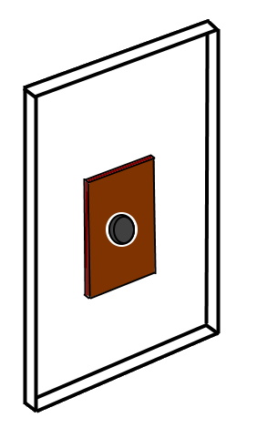

Hi everyone,
trying to update my test protocol on dml canvas panels and planning to do some testing in the upcoming weeks.
I ll have:
Canvasses: 4x Cotton (260g/m²; 4x primed): 2x 30*40cm & 2x 40*50cm
I ll measure each of the panels resonance frequency by using a drum tuning app and tapping on the canvas.
Exciters: 4x Dayton DAEX25FHE-4, one for each canvas panel, mounted centrally
Ply: Birch Plywood 2.5mm mounted centrally
Ply Dimensions: 9.2*13cm (small canvas frame) and 11.9*16.8cm (big canvas frame)
= 10% of canvas surface area; width < 4/5 height (source: Dayton) & ratio 1.41:1 (NXT technical notes)
Question: what might be a better orientation of the ply panel relative to the canvas panel? long sides parallel or perpendicular?
I want to do REW near-field frequency sweep measurements on both sides of the panels in the following succession
I: - one big & small canvas panel with ply (pva) centrally glued to canvas and exciter centrally glued to ply panel
- one big & small canvas panel without ply panel; just the exciter centrally glued to the canvas
II: only applicable for second pair of big & small canvas panels: glued ply panels to the canvas with appropriate exciter-diamteter cutouts
III: all panels: added beams of transparent silicone around all inner edges, and in form of a spiderweb (as suggested and later retracted? by Offgrid 🙂)
IV: all panels: added spine
V: all panels: added layer(s) of dilluted pva
VI: all panels: added strips of FK foam on the back of the spine
VII: all panels: using a tone generator to identify when and at what frequency buzzing occurs
VIII: all panels: room impacts on frequency curve due to different panel to wall distances; parallel/unparallel mountings
Any feedback on what I should change? Any hypotheses I could try to look into?

Hi Eric,
yes, copying Steve's (spedge) interesting experiment, I want to glue the exciter directly onto one small and one big canvas panel.
In a later step, I ll glue a ply panel onto the same canvas panels with cutouts for the already glued on exciters as in the following sketch... probably to see to what extent this step helps bringing back some of the lf? 😕

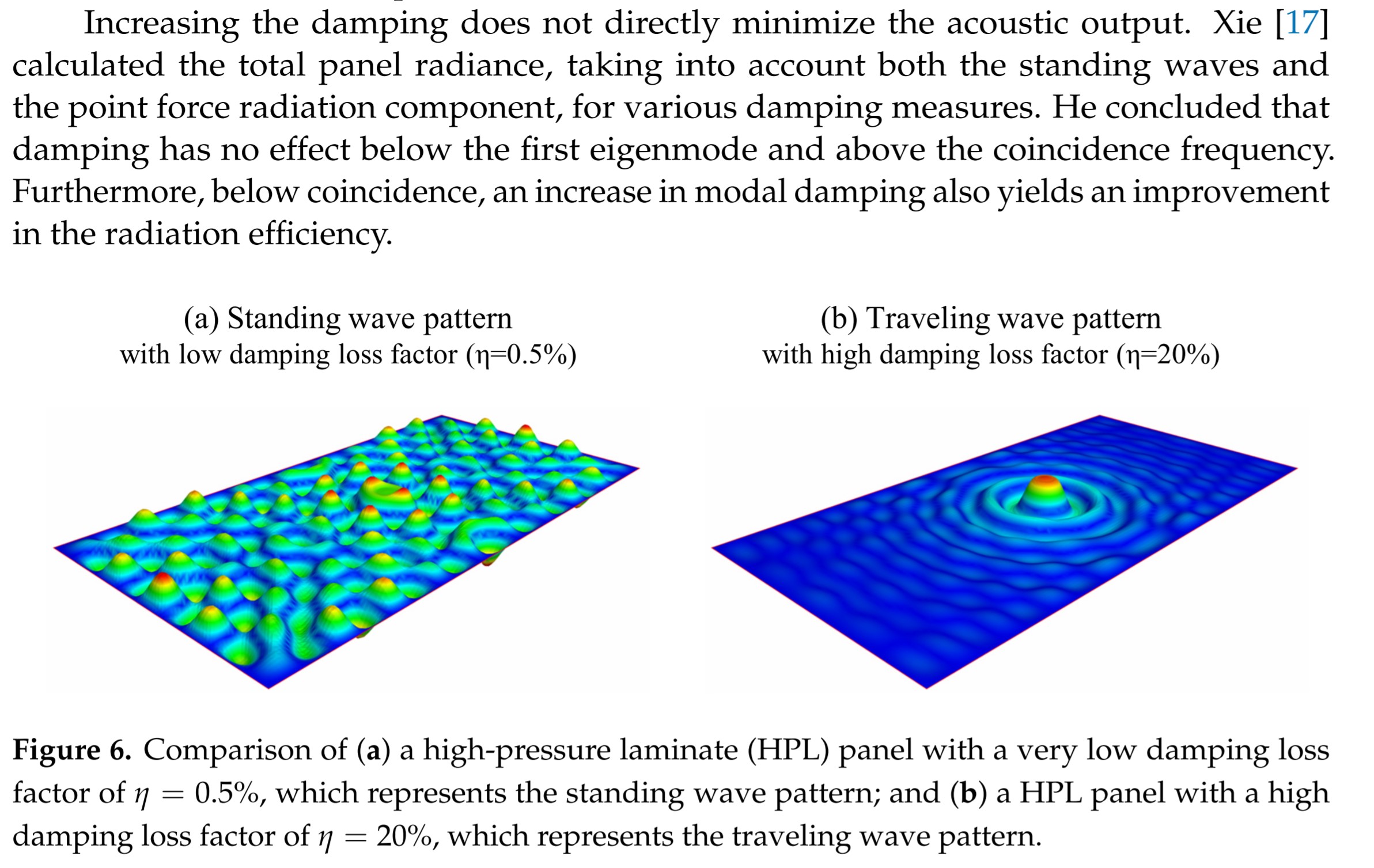

.... Now check the comment paper which says:
Interestingly, at frequencies well below the critical frequency (10 214 Hz for the experimental DML), the far field so generated is omni-directional and the associated sound power per unit mean square force is independent of frequency and plate stiffness and inversely dependent on the square of the panel mass per unit area. The contribution of this source of sound, relative to that of the reverberant vibration field in the plate, increases with the plate loss factor.
Control of the panel mechanical loss factor is vital, because the proportion of input power radiated by the reverberant component of panel vibration is crucially dependent upon the ratio of mechanical to radiation loss factor.
What this is saying is that since fc>>f0 the panel is acting not so much as a flexural resonator but as a panel piston speaker. In this case SPL is independent of frequency and depends ONLY on the panel mass per unit area which should be as low as possible for high SPL (desirable since the exciters are low power).
Hmmm. I must admit I don't quite get what the commenter (Fahy) is really trying to say here. But he doesn't actually say anything about the relationship of fc to f0 as far as I can tell. Anyway, for virtually any reasonable panel, fc is always much greater than fo. So if that makes a panel mainly pistonic, then every panel speaker is mainly pistonic. And I'm pretty sure that's not right.
I wonder if Fahy isn't really trying to get at how mechanical loss factor (presumably he means damping), changes the vibration field of the plate from standing waves to travelling waves, as depicted in the attached image from Zenker's paper. But both cases seem to me to be types of bending waves, rather than pistonic motion. No?
Eric

Hi bernardy.
I'm not sure which interesting experiment you are talking about but if you are mounting an exciter on a canvas panel ,you will need a bracing support at the back to take the weight of the magnet.
Although the brace may not be necessary if the exciter is glued to a balsa panel.
The naked canvas panel should be good down to at least 300hz.
But with the balsa ply it should go down to about 40hz or so.
I'm not sure what is happening in you picture ? Are you cutting a large hole in the ply to slide over the exciter ?
As this would not drive the ply panel ?
Sorry if I've misunderstood the picture.
Steve.

Hi Steve,
if I remember correctly, you had the idea of attaching the exciter right onto the canvas without any plywood inbetween and found, that the canvas still performs well down to around 300Hz.
How would you compare the overall sound preformance between your favourite EPS board and the canvas-exciter combo?
Good point with the bracing support, thank you.
Yes, your interpretation of my pic is correct. But you get me thinking...
I dont know very much about the underlying physics of DMLs. You'd say, that sliding the plywood over the exciter doesn't make much sense from a mechanical standpoint?

Maybe I discard the sliding ply panels...
And look into the impact of a much higher plywood:canvas ratio like in this patent you once posted, Steve.
WO2019061685A1 - Full-frequency sounding structure of loudspeaker
- Google Patents
30*40cm canvas panel -> 6*8cm plywood panel?

Bernardy.
The standard size art panel I used was the 30cm x 42cm.
The balsa ply was 2mm x15cmx10cm .
An ordinary 2mm ply would probably do just as well.
Very cheap on line.
Which exciter are you using ?
It would probably make a difference to the design.
Steve.

Interesting. I always considered both "dml" and "bending wave" to be basically the same. Tectonics seem to agree:
Bending Wave Technology: An Audio Game Changer - Tectonic | Tectonic
A company called NXT was formed to research and commercialize this novel approach to loudspeaker design. In fact, 40 mathematicians, physicists and engineers buckled down to tackle the problem. Thanks to their work, the strong link between the size of a speaker and its bandwidth was finally broken by utilizing a complex arrangement of optimally spaced bending wave modes in a flat, composite panel to produce sound. In 2012, Tectonic Audio Labs acquired the rights to Distributed Mode Loudspeakers (DML) for sound reinforcement and has been producing loudspeakers with bending wave technology ever since.
What makes bending wave technology different is that in traditional speakers, pistonic (rigid body) vibrations of the cone diaphragm produce the sound. However, in Tectonic’s DML loudspeakers, the sound is produced by complex bending wave vibration patterns. Loudspeakers featuring this technology utilize bending waves excited into complex modal patterns to produce sound.
Sure, Gobel may want to distinguish his speakers from others, since they co$t so much. But I don't think the "rules" are really any different. Some just understand and execute them better than others.
