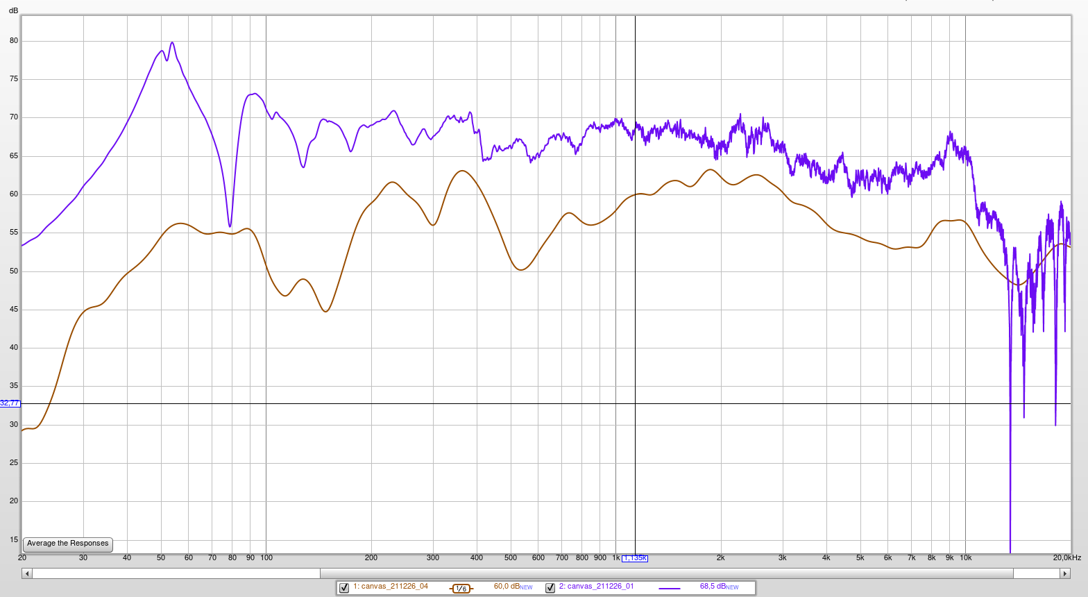

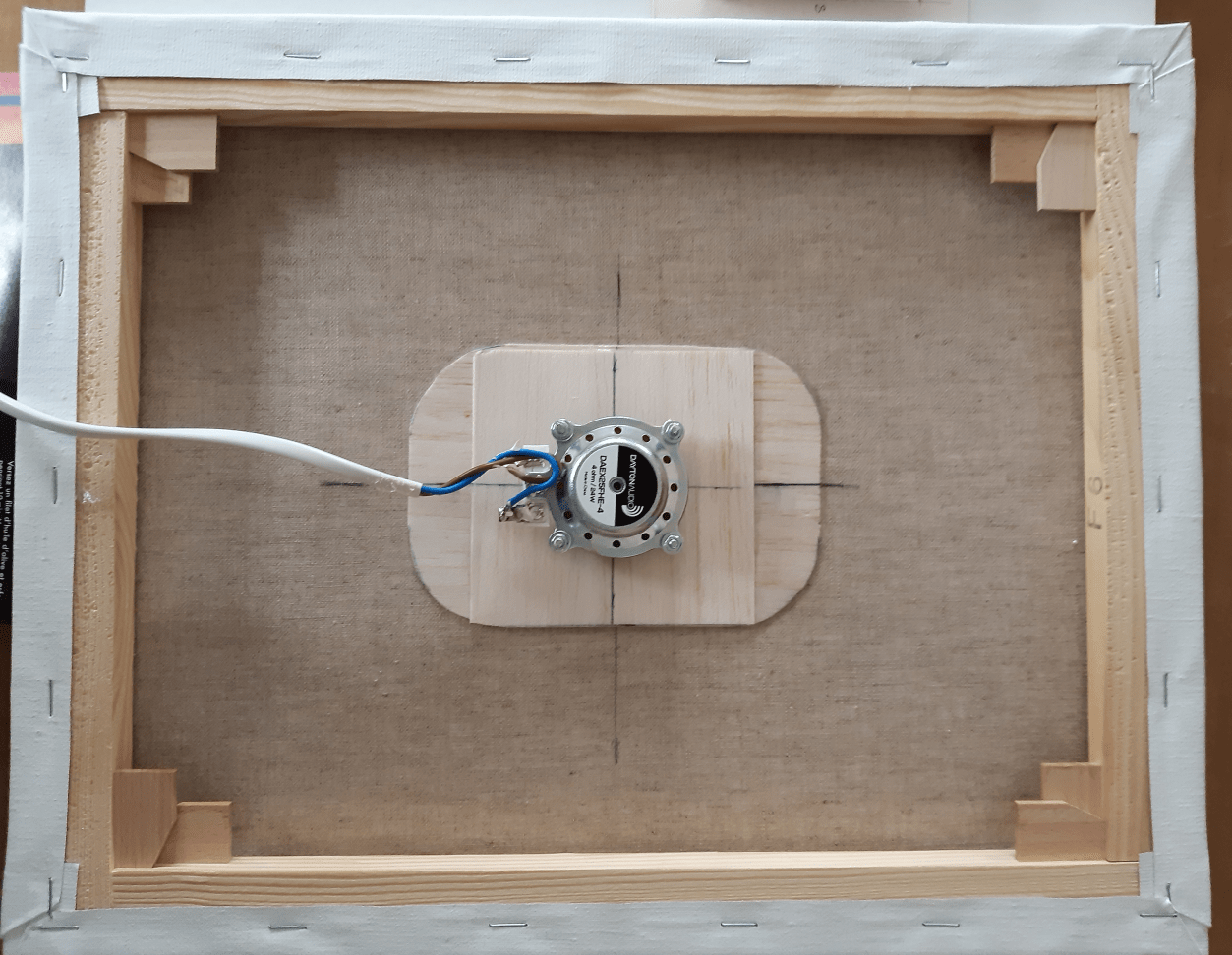

Generally speaking about measurement, what I do now with DML is to measure them at a close distance (proximity, let say 1 or 2 cm right on the exciter axis) and at distance somewhere from 0,7m up to 2m or more (listening position).
The proximity measure gives a good overview of the overall performance. Like for conventional cone speaker it shows the best performance the panel can have at low frequency (without room influence). As it is not a pistonic behavior, the result at medium or even high freq is almost right.
At distance, you have the combination of the front and the rear wave plus the room reflections. It is much more tricky to understand what is what. Additional tests by changing the mic position or the panel position help in the interpretation... I am sure not mastering it!
Up to now, I have seen a little influence of the panel position according to the floor (see page 14). I think this goes in the way what Spedge get with his canvas in contact with the side wall (wall perpendicular to the panel)
I see a much important effect of the rear wall distance (wall parallel to the panel) or the panel dimension (how the reflected wave can go around or not)
The weight is still a question for me. The main drawback of weight is the efficiency. As you said watts are almost free (except in tube applications). The possible problem is pushing at to high power the exciters. At the opposite the weight might be a countermeasure against possible reflected waves coming through the panel but I have no evidence about that.
About REW and the views in my pdf, everything is available quite easily when the measurement is done. If needed, you will find in the attached file some screenshots of what I use.
For sure you can post what REW records (see attached file [save]). It is .mdat file extension probably to embed in a .zip for posting... but I can't guarantee you to work on it... We can give a try.
About my canvas : yes the canvas is taut (= stretched?). Very... I don't know; I would say yes (the 1st resonance is about 50Hz where Spedge mentions 40Hz if I remember). When I bought it it was already stretched. I then increased a little bit the tension by inserting the wood corners provided with canvas. After I apply several layers of watered PVA on the back side (one layer, the pad was glued, new layer on the pad and around, then a 3rd layer on the whole surface). See the attached picture. I will try to provide later a record of the panel resonance while hitting it).
On page 5 of the doc, the red curve is what I suggest at the beginning of this reply : the microphone was a few cm from the panel in the exciter axis (hand-held mic). The green curve is at 75cm according to the setup of the document.
About the sound... The panels work in full range with no EQ (I have no sub for now, neither EQ). In the first place (west of France) I tested them in december, it was correct but not exceptional (not like reported in other canvas builders posts). In the place (Paris area) they are now, it is much much better. They change from good full range to very good for me. Still not as good my 3mm plywood panels which have a better sound stage, perhaps more life and faster transients but the canvas are really promising. They are quite simple to build (less complex than the plywood version). Their cost and building time efficiency is incredible.Very low surface also (currently they are simply on the top of my previous 3 way column). Really living room friendly.
At the moment I think they could be by their dimensions more sensitive to the boundaries than bigger panels like my plywood. This is an assumption. I just ordered a batch of "magic sponges" (see Jaxboy #4133) to experiment some rear wave absoption. I will try also to understand why in the first place, they sound not so good (walls around? electronic?).
Christian

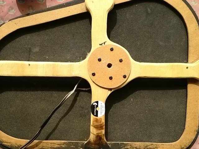

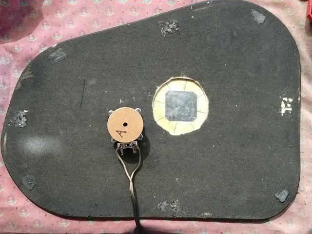

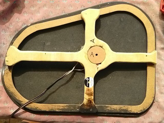

Fail / Resurrection

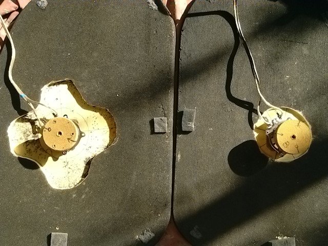

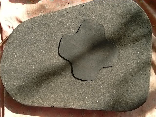

So I built the DML's in these posts: #3076 (canvas + wood) and #3207 (dense EPS + back frame/spine). While trying to extract the homemade exciter from the dense EPS I ended up with holes in the panels so I decided to combine the two build techniques to see what happens.

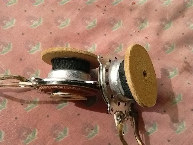

I finally received a pair of DAEX25FHE-4 exciters so this experiment is for real. I originally cut the EPS rough torn holes out to about a 3" diameter circle and cut the thin ply in a "freehand" t shape 7x7" and glued them to the front of the EPS at an angle which I don't think really matters but intended to black it all out anyway.
After figuring out the mounting of the exciters (dense foam and wood disc) so they can be seperated from the backframe easily I mounted them so that the exciters were holding the panel all by themselves except for the top foam strip which is super glued to frame and panel. I just see future problems without some support. The other foam strips are just attached to the panel because they were there anyway so I just left them but it is
mostly "free floating".
Testing was a major letdown, certain things as expected stood out and sounded great, as in wooden instruments (cellos to die for) and mid range percussion and all instruments in general were pretty darn good, piano especially along with those cellos. The rub was the vocals. Willie Nelson's "The Last Thing I Needed TFTTM" has a slight "hall" thing going on anyway, but he sounded as if he were singing down a long steel pipe. Not hollow sounding but just distant and filtered.....strange.
So on with the experiment. I removed the frames and carefully cut out and removed as much EPS as I dare that's glued (50/50) to the wood. BOOM!...that was it. Night and day on the vocals and everything else came alive as well, especially the high's. These could easily be used as stand alone speakers with sub but In conjunction with my bookshelf JBL's and new Klipsch sub they just fill my small listening space wonderfully. They take away the directness of the bookshelfs allowing everything to blend.
Next project is a pair of center channel panels, mounted over and under the TV wired in series to obtain 8ohms. Have read good things here about doing that. take care

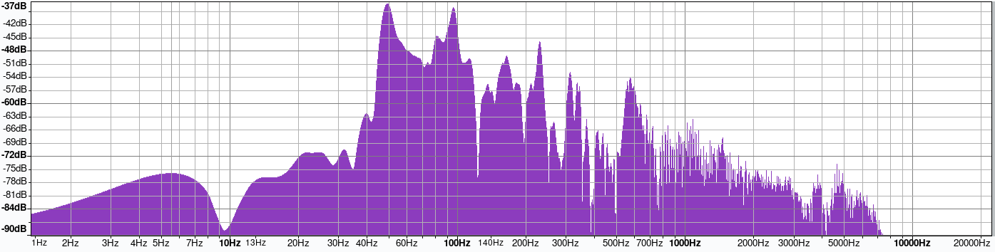

Here is an mp3 you can hear the canvas panel while hitting with a wood spoon (mp3 in a zip)
The spectrum

Fail / Resurrection
After figuring out the mounting of the exciters (dense foam and wood disc) so they can be seperated from the backframe easily I mounted them so that the exciters were holding the panel all by themselves except for the top foam strip which is super glued to frame and panel. I just see future problems without some support. The other foam strips are just attached to the panel because they were there anyway so I just left them but it is View attachment 1014512View attachment 1014513View attachment 1014514View attachment 1014515View attachment 1014516View attachment 1014518mostly "free floating".

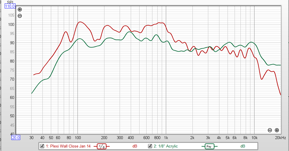

Small update.... I tested the 18x24x1/8" acrylic panel again as well as a CF panel. Results shown below are as follows:
Green: old test; 75cm on hardwood floor against desk
Red: new test; ~2cm on carpet against dresser
Surprised with the change to be honest. Same mic/amp/setup. I will have to test on the hardwood again to see if some property of the panel has changed over the last few days (???).
Also CF was a total bust. I lost the reading but it was terrible. Another bad bandpass, with a very loud resonance between 100-200Hz that repeated with harmonics. Sensitivity wasn't great either. Honestly I'm kind of glad as that will save me a lot of money. I spend that on exciters instead of panels and maybe get enough low end to #DitchTheSub.
Anyways hoping to measure and confirm the hardwood setup again. My kitchen is more similar to the hardwood setup in terms of room properties so if it works better there that's a good thing. I'm happy to lose that sub 1K hump for a flatter overall response (especially above 10k)

I am far to have all the explanations but there are similarities with what I see in my measurements. I think the measurement at short distance gives the general character of the panel. Here a loss of level above 1kHz. At distance, the mic receive the front wave and also the rear wave reflected by the surrounding walls. It seems this has a low consequence at high frequency (the reflected wave is attenuated?). At low frequency the level is reduced by the recombination. In your test, the panel loss after 1k might be compensated by the loss in low frequency at distance. At medium frequency, reinforcements can happen. For my canvas, it is more flat at close distance so there is a lack of level at distance at low frequency. This my understanding from today... Let see with new tests, design, listening if it will remain like that.
About CF (I don't know this material) it might be one characteristic is its low damping. Is it? The frequency response of a DML is the result of the all the individual frequency response (bandpass) of each modes. If the material damping is low, holes will remain between those frequencies. I add below the example of the canvas panel. The blue curve is at close distance with no smoothing. We can think the damping of this panel is high (no real visible resonance except at very low frequency). The brown curve is at listening position 1/6 octave smoothing no windowing. At close distance we see also a slight drop of the level above 3kHz. As in a standard loudspeaker (cone) we could imagine that the voice coil mass and its inductance play a role of low pass filter.
I don't have an explanation (even idea of) for the band pass characteristic of some panels (seems the case for your CF)
Up to now I made 2 types of panels : 2 where quite big size (about 1.2m high, 50cm width) and 2 other with the height similar to the width (like 70x50cm or 41x31cm). For those latter, it seems the loss in low frequency is higher leading to a more important difference between the close distance measurement and at distance. Yesterday, I baffled the canvas panel using one big cardboard calendar on each side. The low frequency loss was significantly reduced. I had the same results testing one panel outdoor last summer. The low frequency level was much higher than in a room, close to the short distance measurement.
Beware of the rear sound wave ;-)

I should mention- I measured the panel at listening distance in the carpeted room, and the measurements were basically identical to the up close measurement, which is part of why I didn't post them. So it looks like my original measurement in the more reflective room might have had some mid to high frequency resonances. Kind of makes sense with a sweep on a hardwood floor. In any case, having the "true" speaker measurement seems like very valuable information for general tuning- again I will have to make some confirmation measurements back in the hardwood floor room that mimics where these panels will be mounted.
And yes the CF panel has super low damping........ they basically ring like a bell on impact; I will get a measurement of that too when I have some time. The response was terrible too. Just a surprisingly bad material all around.

Second pic is the same panel but an inch of two to the left of exciter,also 1ft.
Third pic is same panel but now at least 10ft back into room near seating position,I have rolled off the response below 150hz on all pics to simplify the view ,sorry about quality of the pics as I had to take photos of my phone pictures ,too large for this site!
Steve
On this page you will find picture's showing the response of an old eps panel, it shows the peak in response at about 10k in front of the exciter area,caused by the oil can affect.
Moving the microphone a few inches to the left or right of the exciter coil area (near field),you will see the response above 10k drop like a stone.
This is measuring the pistonic pulse or primary drive area.
But the in room response picture shows a flat ledge from 10k extending to 20k at a lower level, this is the in room panel response.
This is from 2years ago and are pretty much identical to postings I made on the NXT RUBBISH site over 10years ago with various eps panels.
This is with my exciters and my panels in my room.
This response is easily improved as with my small veneer or card panels and the canvas panels.
It just takes a lot of loving care , and attention to detail.
Steve.
I should have mentioned the wonderfully flat response from 200hz to 10k, even with the 10k peak it is about plus and minus 2.5db !!
This is with no EQ !!
there was probably a dip in the room response below the 150hz point so I probably cut this off so as to make it a simpler view.
I use my TLs to fill in below 300hz anyway and would recommend the same to others for good room integration.
Steve.
