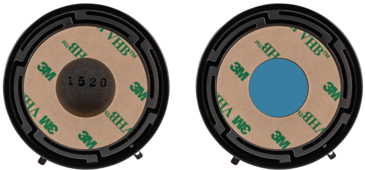

Just to get specific, I've attached photos of the panel side (front surface) of the Dayton Audio DAEX32EP-4 Thruster I use.
The left one, as is out of the box. The right one with the center in blue.
Does the right picture accurately show where you propose I place the blu tack?
I used the suppled 3M VHB (Very High Bond) tape to secure the exciters to the panels.
I've worked with VHB tape before and have experience in preparing surfaces.
Doing so produces a near permanent bond.
Neither of the exciters feel at all like they've come loose.
I think I'd have to figure out a way to slice off the VHB tape to remove them.
Perhaps more likely, if the VHB tape adheres more strongly than the aluminum skin does to the honeycomb core the forces of the exciter might begin to delaminate the panel.
I don't see any evidence of this, but I'll keep my eyes and ears on it.
I hope to get to some measurements this afternoon.
The blutack should be placed on the front surface area in the middle of the voice coil area.

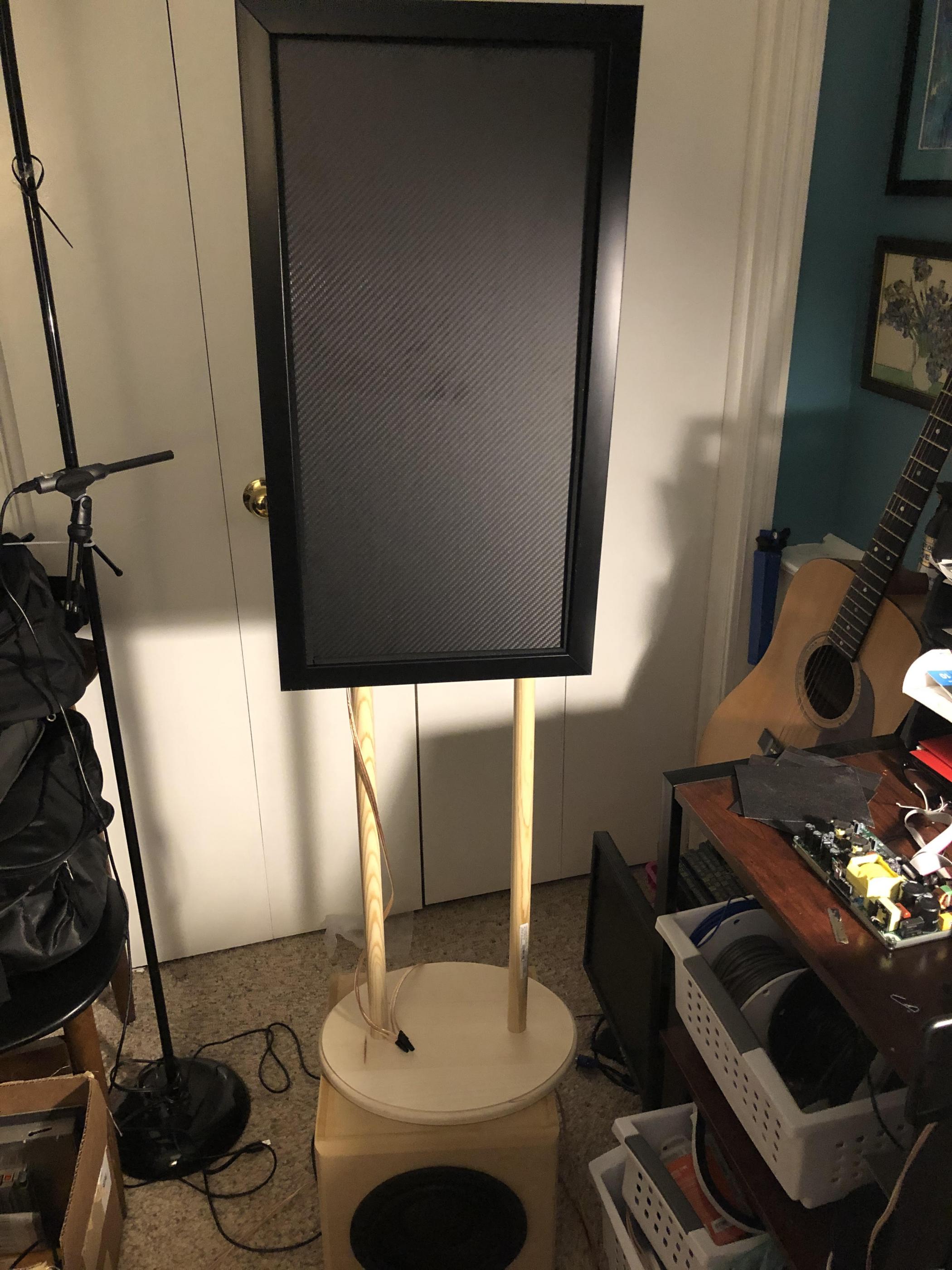

Dave,
Did you buy these carbon/nomex panels or make them yourself? I'd be interested to know more details about your panels.
Eric
Eric,
I found a company in China (CA Composites) who made the carbon/Nomex panels for me. The panels are actually 1000hx300wx3.5mm thick. They had a minimum purchase but they were still cheaper than US sources.
Thanks,
Dave
aagas.
Yes the blue area in the photo is the internal area of the coil.
You could fill this area to see if it reduces or kills the sound,then if it reduces the sound you can try a smaller piece about the size of a small pea in the very centre of the coil area.
If when measuring you could do one measurement from the exciter side,as this could be quite enlightening,maybe?

Steve,
Thanks.
Do you suggest this because you think the internal area of the coil could slam against the panel?

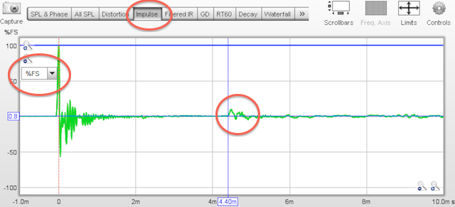

The frequency response from the exciter at the rear will be modified by the exciter itself causing irregularities.
This Could be reflecting from the rear wall or window?
I usually move the microphone around the back of the exciter to see if anything unusual is picked up in real time,like a sharp peak of dip.
So not necessary to turn the panel around.
You have to trace where the sound is coming from before you can say what is causing it.
You have not said if the sound is just in the recording or is actually coming from the panel?
Please don't start pulling things about it you don't hear any problems.
Steve.

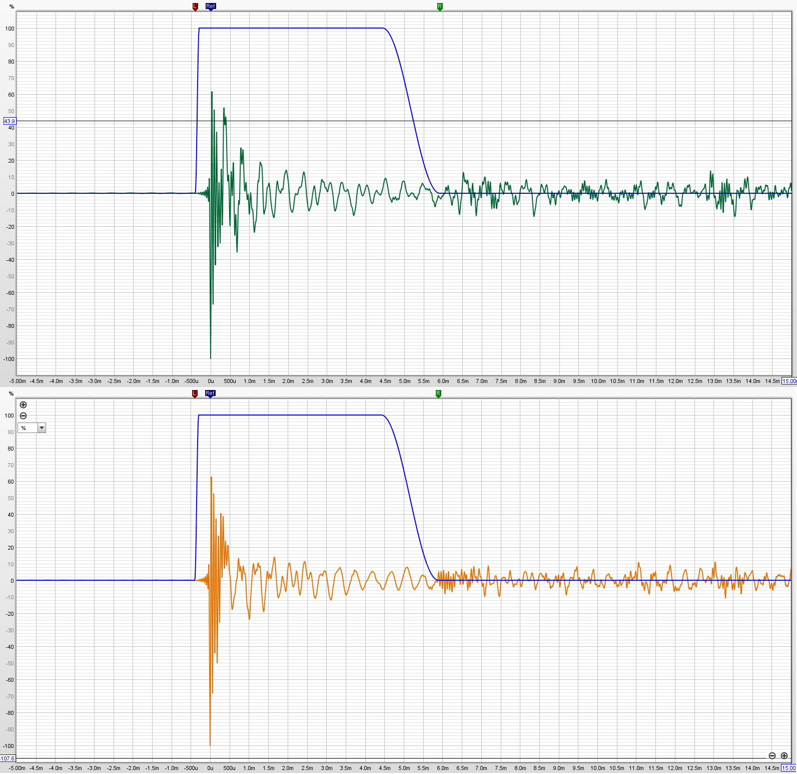

Update
Alright, started to set everything up and get used to working with REW, I decided to change and add some things in my test-setup:
circular = green
square = orange
Now, I ll try to find some resources on how to interpret these frequency responses.
Any comments on the changes and additions? 🙂

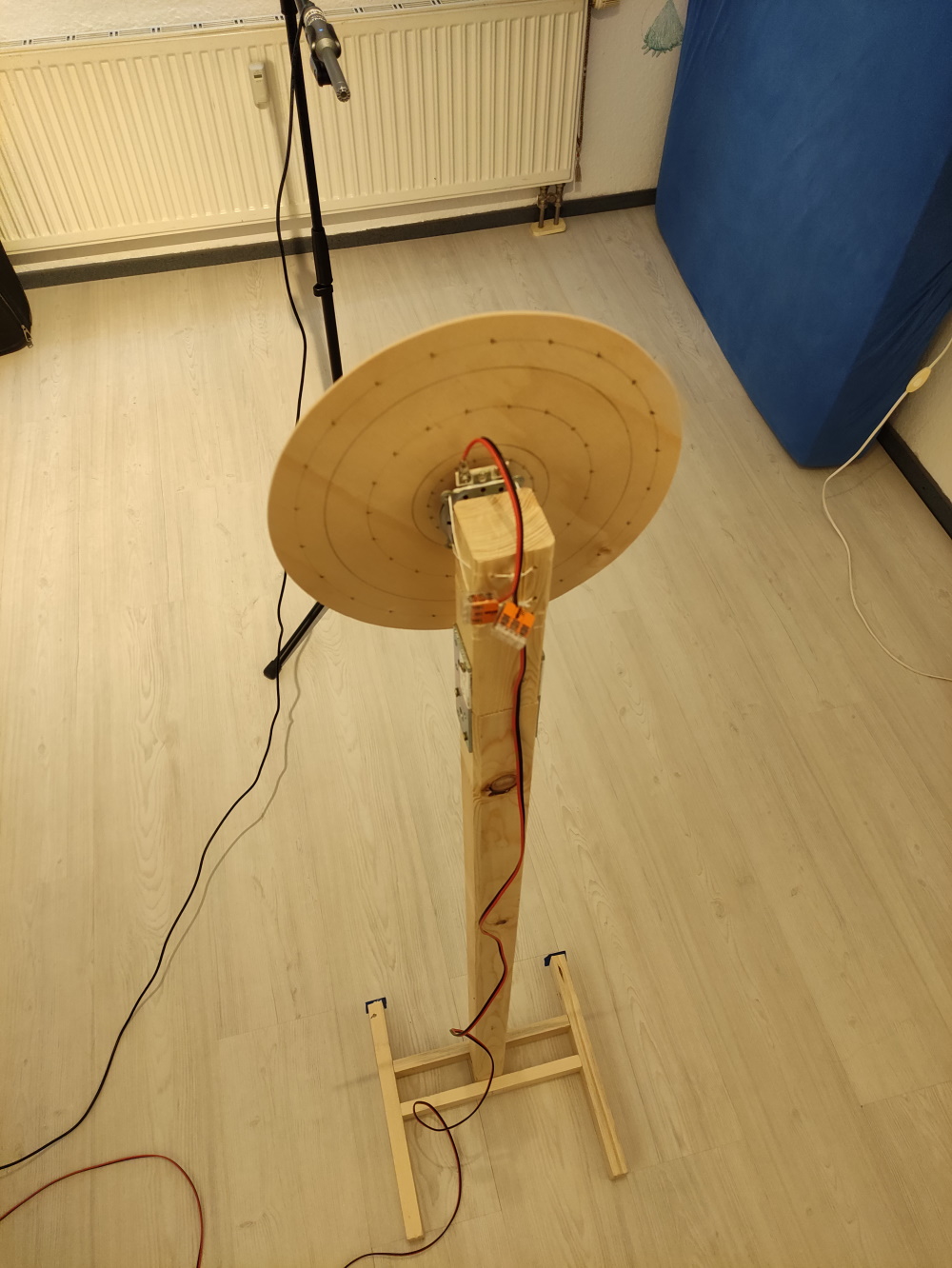

Hi fellows,
After reading through the whole thread, I am so excited to finally start my own basic testing on OffGridKindaGuy's Canvas DML Design.
I am really grateful about you guys sharing your knowledge and helping me in this process!
Being fairly new to loudspeaker building, I am trying to come up with a test-setup that gives me a basic understanding of core principles, meaningful correlations and data. [...]

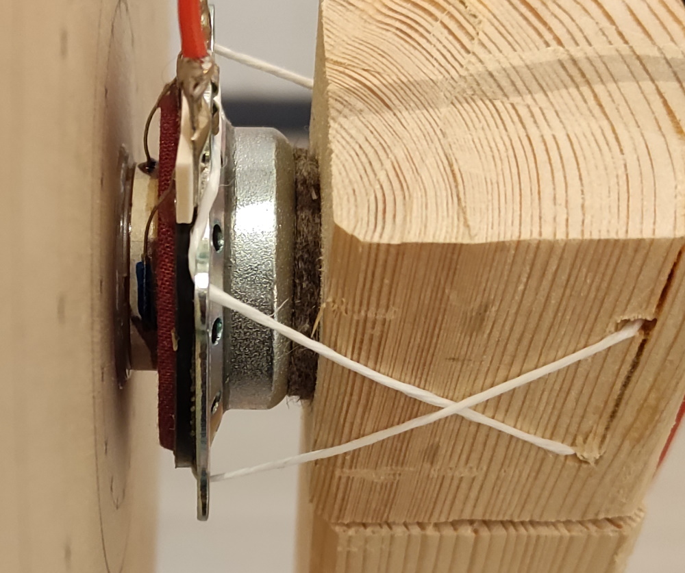

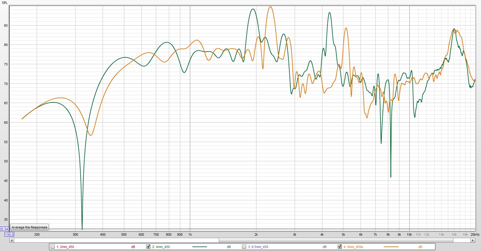

- I mount the Exciter to a wooden Stand with 4mm felt in between. (see pic 1 & 2)
- I decrease the Distance between Mic and Panel down to 50cm. Gated Window = 0.4 - 5.85ms
- I set the AMP Output Voltage to 0.6V which equals right now (dependent on the surface area and thickness) around 81dB SPL at 50cm (= around 90mW?)
- I connect my USB Audio Interface via Cinch to the AMP (removing the Raspbi and DSP)
- displaying the frequency response I use a 50-60dB SPL and 150Hz-20kHz Range
circular = green
square = orange
Hi Bernardy.
You placed the exciter dead in the centre of the panels,not the best place to put them as this will cause a large standing wave,especially with the circular panel.
The green line peaks seam to have taken a jump to the left ? A bit like the rocky horror show😀
Above 12k they look pretty similar.
If doing this I would probably take a measurement at about 2inches in front of the exciter first, to see what the coils are actually putting into the panel,this hopefully should be pretty much full range ?
Steve.

Bernardy,
If I follow your description and your photos, the adhesive connection between your panel and the exciter places the entire weight of the panel on the exciter itself.
(I do wonder if you need the felt between the exciter and the wooden stand. Varying that particular connection could prove interesting.)
I appreciate the simplicity (even elegance) of your design.
I surmise that the lighter the panel, the more ideal such a solution. But panels have weight.
It seems to me that suspending the entire weight of the panel on an exciter would place significant load and stress on the exciter and the exciter's internal components.
Developers of the technology have designed exciters to move/vibrate the panels not to support them. Hence so many projects that suspend/mount panels as well as those that mount the exciters on some kind of supporting structure. Many designs do both.
I could imagine an exciter designed to handle significant panel weights, but certainly don't know of any. Of course I've conducted my experiments in all of this with much larger and heavier panels (71" high x 29" wide) so I haven't made an exhaustive search.
It seems to me that an exciter designed to carry the panel load would have a range of engineering tradeoffs.
All this said, pushing limits and conventions seems like the point of this collaborative thread.
I very much look forward to watching (even hearing) your explorations.
-- Andreas

Is there a way to relate the biggest peaks and troughs from the frequency response graph to panel dimensions?
Setup, Thickness and Surface Area being equal, this can just have to do with a mode offset due to the different shape - radius = 12cm vs. 1/2 side = 10.6cm...?
Looking at my Impulse Measurements though, I wonder if using this approach of gated measurements is actually valid since there is clearly no temporal separation between the end of the impulse and the first room reflection... 😕 see the attached graph: circular shape = green, square shape = orange;
So, I think I need to move the mic even closer to the panel to have a longer time window and hope for this separation to appear, as you suggest?
Yeah, strange. What might be an explanation for this?spedge said:The green line peaks seam to have taken a jump to the left ? A bit like the rocky horror show😀
I am fairly new to taking measurements. I thought with using gated measurements I ll just measure the panel-exciter performance without any room interference?spedge said:If doing this I would probably take a measurement at about 2inches in front of the exciter first, to see what the coils are actually putting into the panel,this hopefully should be pretty much full range ?
Is this long impulse a trademark of DMLs?
That is a good point. I initially moved away from the idea of clamping the panel in between a wooden frame and foam, to not introduce a variable of different clamping pressure on the panels. Moreover, the panels (except the 6.5mm at 450cm²) are all lighter than the exciter, thinking that mounting the exciter rather than the panel would be the lesser of two evils.aagas said:If I follow your description and your photos, the adhesive connection between your panel and the exciter places the entire weight of the panel on the exciter itself.[...] It seems to me that suspending the entire weight of the panel on an exciter would place significant load and stress on the exciter and the exciter's internal components.
But maybe I try to attach a 'foam coated foot' to the wooden stand on which the panel can rest on so that the voice coil can do its job without interference from gravity.
For the final built I ll definitely attach the exciter to the wooden frame of the canvas.

I just did some more measurements now up close to the panel and with a little foot for the panel to rest on.
I believe voice coil sag is real ! 😀 but as it turns out, resting the panel on a little foot to keep the panel perfectly vertical and the exciter unstressed, doesn't significantly change the frequency response of the panel. So for this first few measurements I ll leave them hanging.
Shortening the distance between Mic and Panel to around 13cm let me increase the gated Windows but I still don't see any end to the impulse and a clear cut between impulse and first room reflection like on the attached pic's impulse performance on what I believe to be a conventional cone speaker...
Would be interesting to find out what might improve this impulse response of a DML panel. Higher compression/flexural strength? Damping?...

On page 6 there is an explanation of dml impulse responses and why it is ok to have a long tail.
http://www.soundright.org.uk/NXTchaos.pdf
