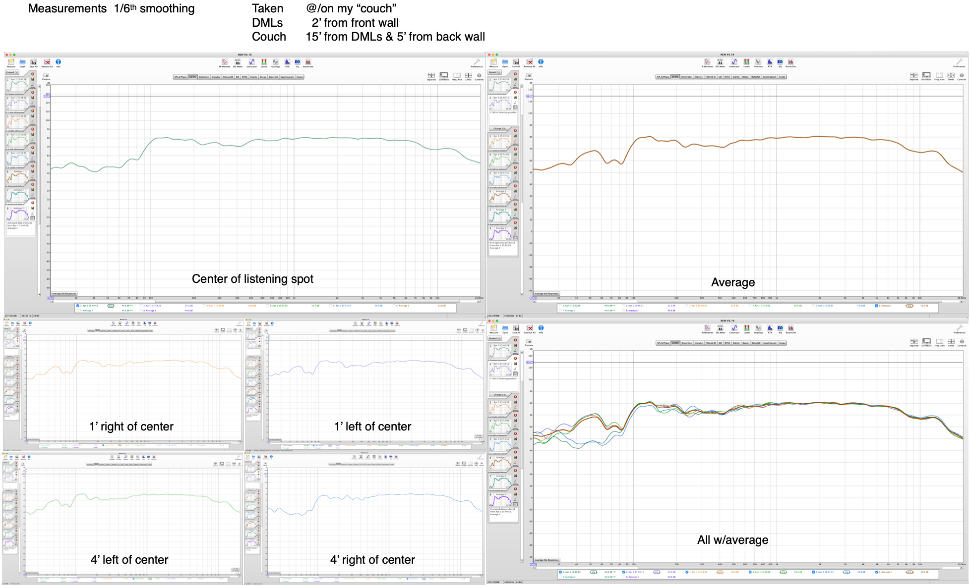

A Study of DMLs as a Full Range Speaker
Measurements with 1/6th smoothing...

Hi Andreas,
The overall response looks pretty smooth. Maybe you could add a high shelf at 10kHz with 6dB boost and low Q (1 or 2), but that's a matter of taste. You might also add a 6dB boost around 350Hz (Q=1or2). I've never had much luck below 150Hz with DML that's why I supplement with woofers below 250Hz. I'm using small (1'x2') carbon fiber with Nomex honeycomb core panels, so low end response is likely related to that.
Thanks,
Dave

The response of your panel seems pretty stable above 500hz , most of the variations happen below the 500 mark.
I have had similar results.
Instead of EQ I blend my low frequency drivers in with the panels to help fill in these dips.
This is similar to using 4 subs to fill in the room nodes .
This works very nicely for me.
Although my dips are usually in the 100hz to 300hz region.
The hf response is down 10db at about 8k but holds there up to about 15k.
Not bad really.
A little EQ could help here as long as it doesn't set anything else off?
Any chance you could do a measurement from the back or turn the panel round and take the same measurements?
For my curiosity.
Steve
Hi Steve,
I've had some trouble today with getting equalization to work at all with the Hypex FA123 amps.
I've tried setting a 10K highstep, Q = 1, 6 db and REW measures no significant difference.
I've varied the settings to Q = 2 and 12 db., with again no real REW measurable difference.
I wonder if this happens because I bridge the amps?
Pretty certain the settings uploaded as they appear when I close down and restart the amps.
I likely need to reach out to Hypex unless anyone here has any suggestions.
Something odd about this.
