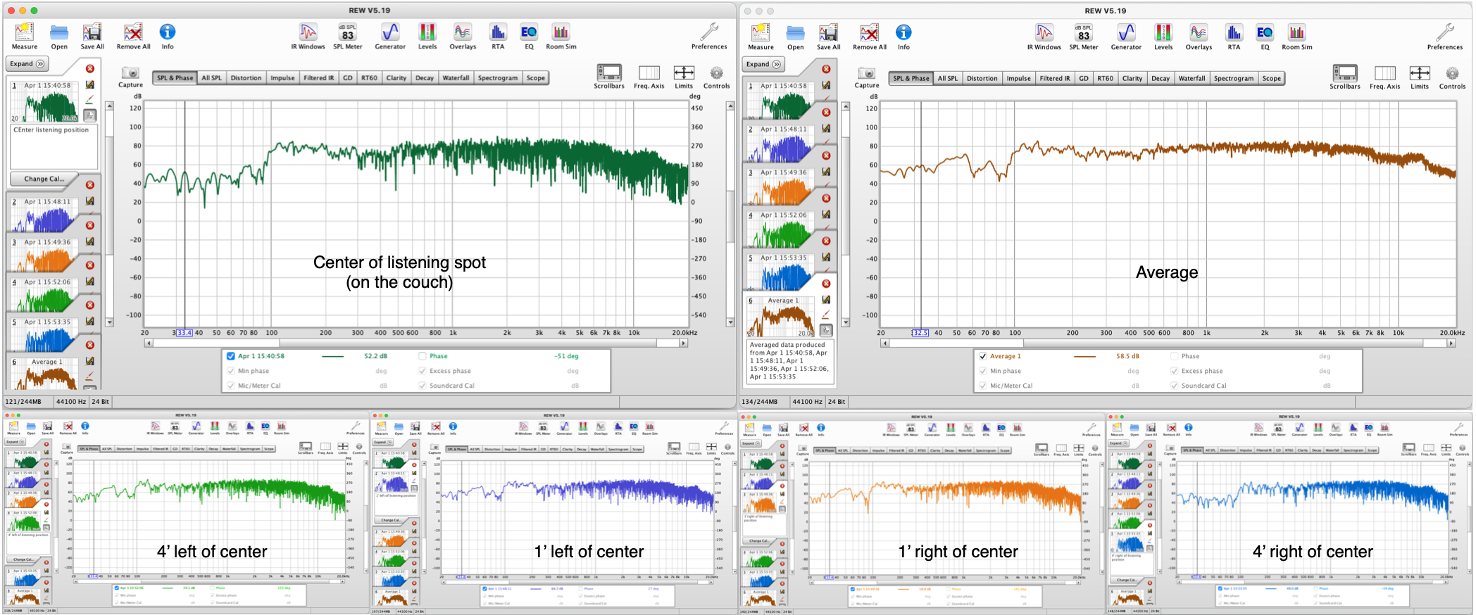

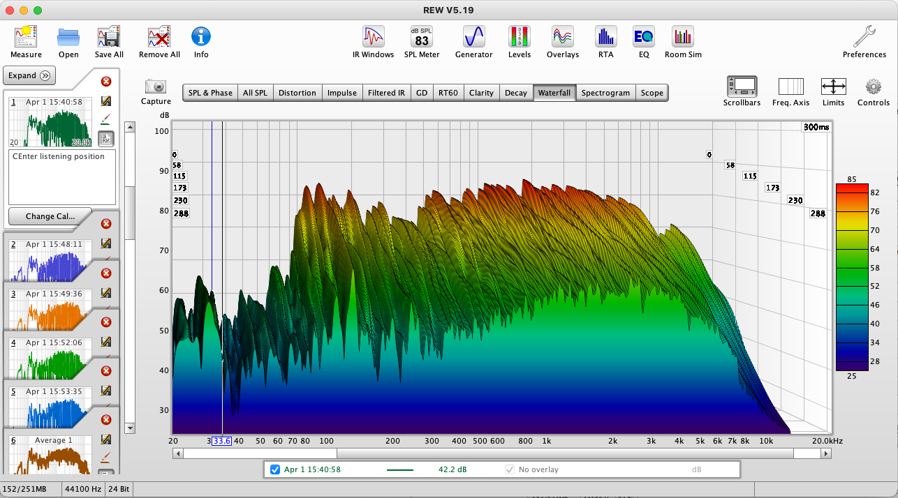

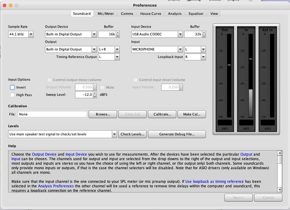

Think I've got my hardware and REW running properly.
It took some fiddling around with preferences.
Curiously, when I have the "Input" set to "MICROPHONE" i can only make measurements with the setting on "L".
I wonder if REW can only see the "Master" Hypex FA123 in this context?
I've used the Behringer ECM8000 microphone right of of the box.
Maybe it needs a correction file. Not far enough along with this to know, suggestions appreciated.
Not certain if the measurements I have attached make sense.
Thoughts and explanations appreciated.

Your measurements are in 20db steps ,so it is hard to see what is going on.
5db steps would be more helpful.
I'm not an expert with rew,but I think it should be smoothed as well for clarity.
Hopefully someone can give you pointers on how to set it up.
Steve.

If you are still having problems with line one .
The behringer is for pro sound,your microphone is xlr mono with central Jack plug for line in and you are plugged into line one.
Line 2 input is inST Jack plug (probably to plug your guitar in) or line stereo.
You have gain knobs for line one and two.
Steve.
