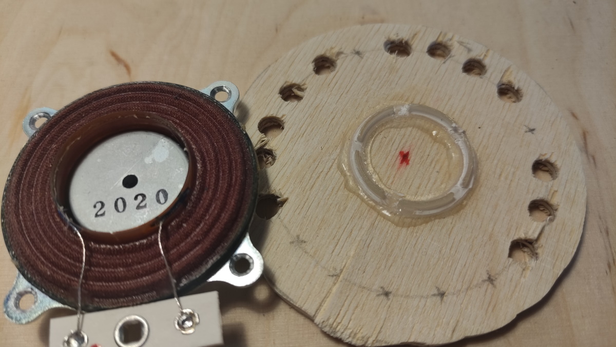

It s been 4 Dayton DAEX25FHE-4.cheapvega said:Bernardy, what exciter is that?
I finished my measurements and was trying to unglue the exciter from the plywood panel.
Got some acetone from the hardware store and kept the glued part in this solution for a few minutes. The superglue was completely unimpressed by this bathing but the ring of the exciter got loose and came off (see pic). The plastic ring should easily be 3d printable which should make exciters fairly easy to reuse even if attached to panels with superglue?

Bernardy.
It might help if you get something like a chisel behind the superglue .
Superglue doesn't like bending much,but the ring is more flexible, so hopefully the two should start to part company?
