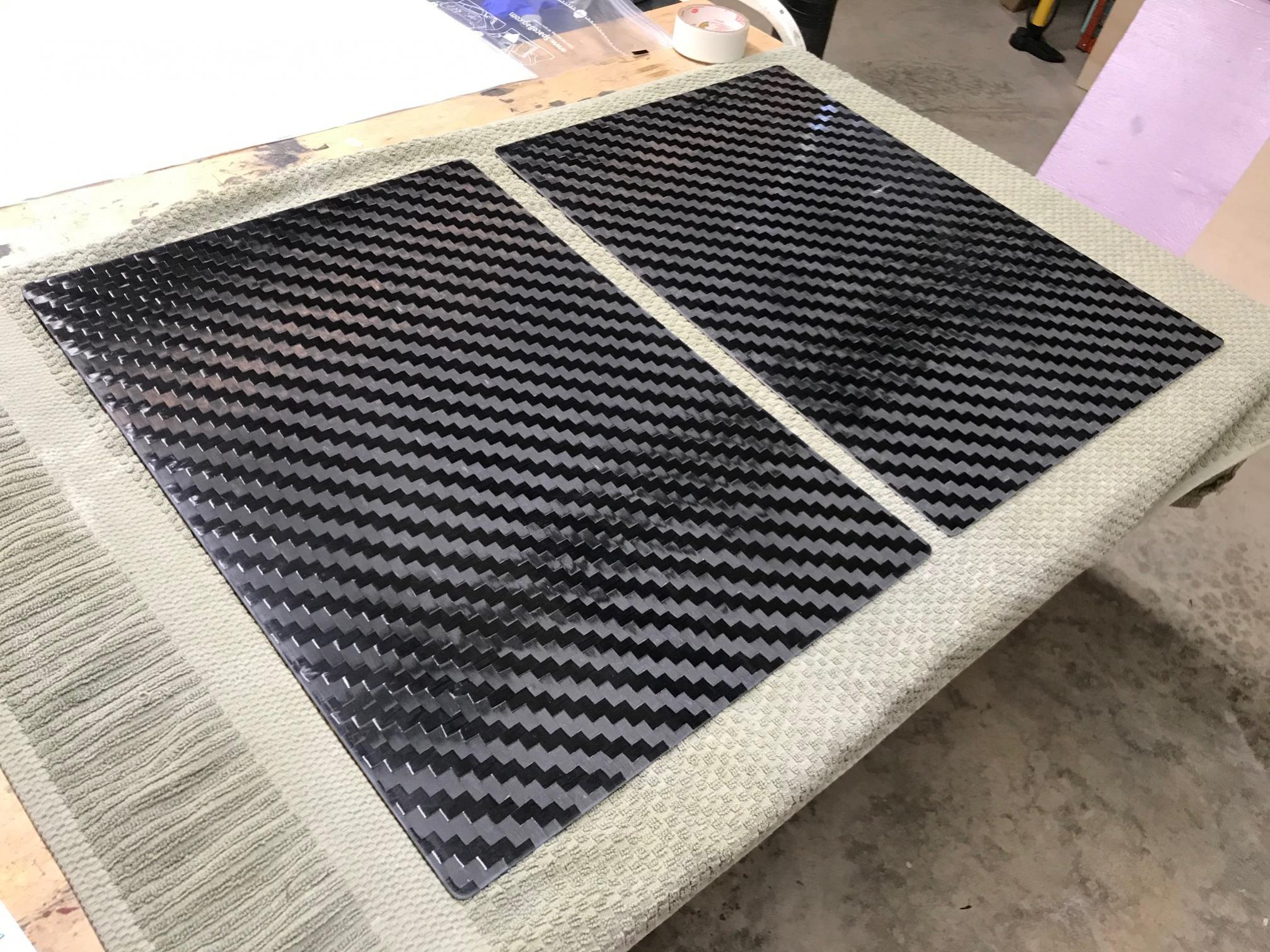

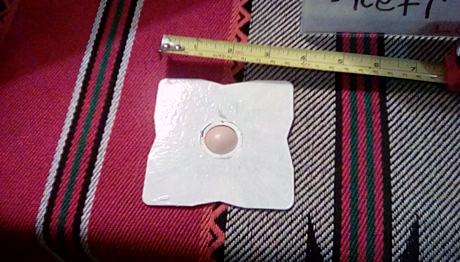

These types of materials could be ideal for my small panels.
Before the lockdown at the last audio show I went to,there were similar cone materials being shown.
I was very tempted to walk out with one of the samples!!
But honesty prevailed
It would be great to mould a single panel with a dome in the centre,like the one in this picture,not this shape but a little larger probably.
I have only read the first article so far as I got a little distracted with the other articles at the bottom of the page.

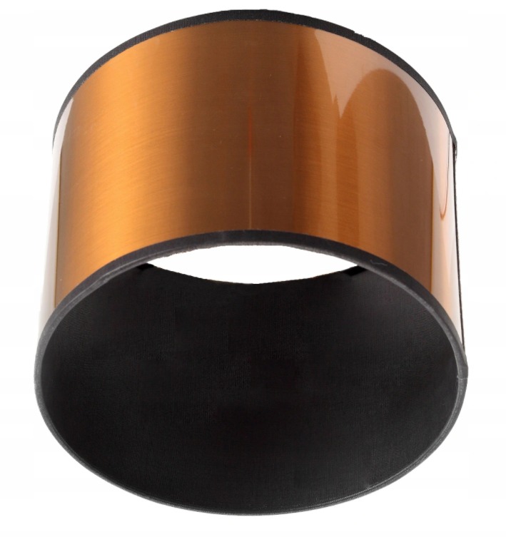

Mainly this one using so-called race track drivers?
A New Standard of Low-Depth Racetrack Speaker Drivers with Flat Core Speaker Technology | audioXpress
I have thought of using this type of coil shape to allow just a thin strip to mount to the panel.
You may have noticed I'm not keen on circular coils and the inherent problems they cause,this I feel should negate most of ,if not all of these problems?
Obviously piezoelectric drivers are another option?
But the dome does a good job of sorting out most of the coil and cavity problems, so I'm happy at the moment ,with the thin card and dome arrangement .
But thicker panels are a harder problem to fix with a dome?
Steve.

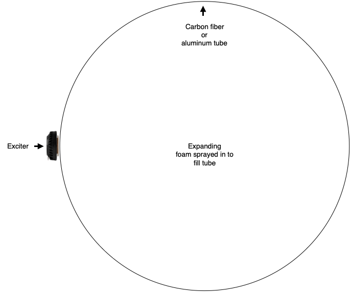

Why not a tube?
I came across large diameter carbon fiber tubes at Dragon Plate.
One can also find such tubes in aluminum.
Consider, bending a DML panel into a long tube as in the attached.
Fill the tube with foam to further "stiffen" the tube.
One would need t come up with a clever way to mount the exciter.
Wouldn't this give one a highly rigid, very light, and omni-directional DML?
Thoughts?
Thoughts?

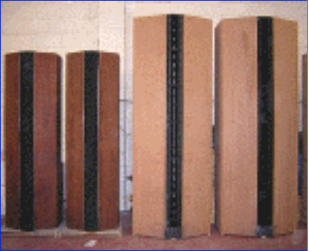

In his The Development of Beveridge Speakers the electrostatic speakers designed by his father, Harold, Rick Beveridge has the following interesting paragraph:
I had a personal experience of such a setup at New York's Stereo Exchange (maybe in the late 1980's, but I could have the years wrong). I knew the owner, Dave Wasserman. Stereo Exchange dealt in new and used equipment, so lots of verying interesting pieces passed through that shop.
On occasion a group of audiophiles would gather after hours to listen to new and used equipment that had come into the shop. This gave all of us chance to listen to equipment and ideas about equipment, many of us (in our younger years) could never afford to own at the time.
One evening, we listened to, what I remember as, a pair of Beveridge X1s or Model 2s (see attached photo, I remember them as very tall) set up to the left and right of the seating area, on the same axis as the listeners ears (90 degrees off what the listener faced) similar to what Rick Beveridge describes in the above quote. One can almost picture this placement as earphones for an entire room.
I remember the speakers sounding amazing - the best sound I had ever heard reproduced at that point (later in the evening someone set up a subwoofer in the middle of the room and we took turns sitting on it while listening to the then top end Stax electrostatic headphones, pretty darn good that too). We had a lot of fun in those days.
The 180 degree dispersion patterns of the Beveridge speakers enabled such an unusual placement.
Seems like DML's would as well.
I don't suggest that DML's would perform better in such a position, rather that DML's might give us far more placement options than conventional speakers.
Because these new speakers were true line sources with a 180 degree dispersion patterns, their placement in our home was novel. Our living room at that time was about twenty feet wide by fifty feet long. There was a large circular fireplace on the centerline and about twenty feet from one end. Each speaker was placed with its back to a long wall, facing the fireplace and the other speaker. The highs, mid-range, and lows were dispersed uniformly throughout the entire room. There were no more "bright" and "dull" spots.
