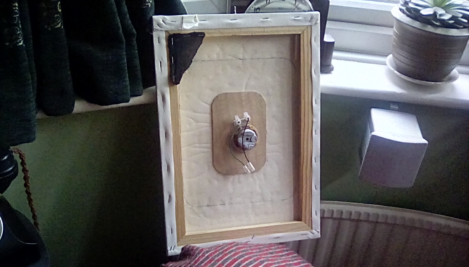

If possible, I was thinking if it wouldn't mess up the sound too bad, I'd like to hide the panels inside stretched canvas artwork like one of these sets of 3 pieces in the 36" x 24" size. The frame depths are 1.5".
https://www.amazon.ca/wall26-Canvas-Abstract-Artwork-Stretched/dp/B0786CNKYQ/ref=sr_1_9
If the frames are 1.5" square, that would limit the panel sizes to a maximum of 21" x 33" but I suppose you'd want to make them a bit smaller than that to leave a gap for foam tape to go in between the frames and the panels.
I can buy 2' x 8' sheets of 1/2" thick XPS from Home Depot here so that should allow me to hide half decent sized speaker panels inside the right and left art pieces. If the 1/2" XPS is not recommended, I can look at using other materials in the 1/2" thick range like maybe acoustic ceiling tile.
If the hiding the panels inside the stretched canvas artwork is a bad idea then I have a lot more options for panel sizing and numbers of panels.

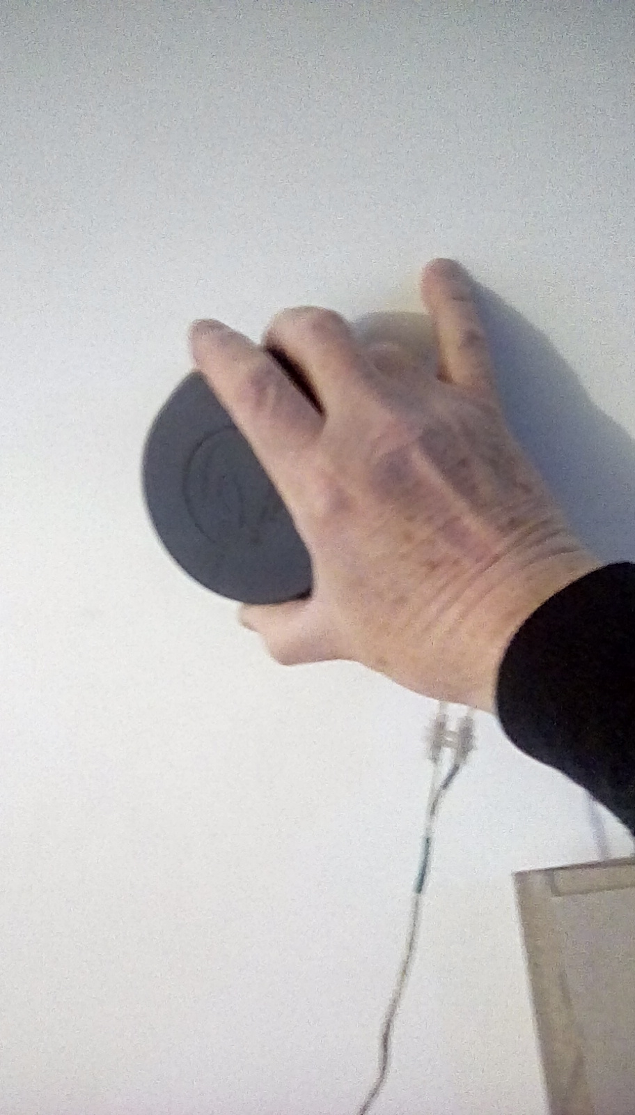

Just did a quite recording holding an exciter on the wall.
It's an hdn8 ,as I say in the recording it's not my favourite, so would not recommend it,
Hope you find it interesting?

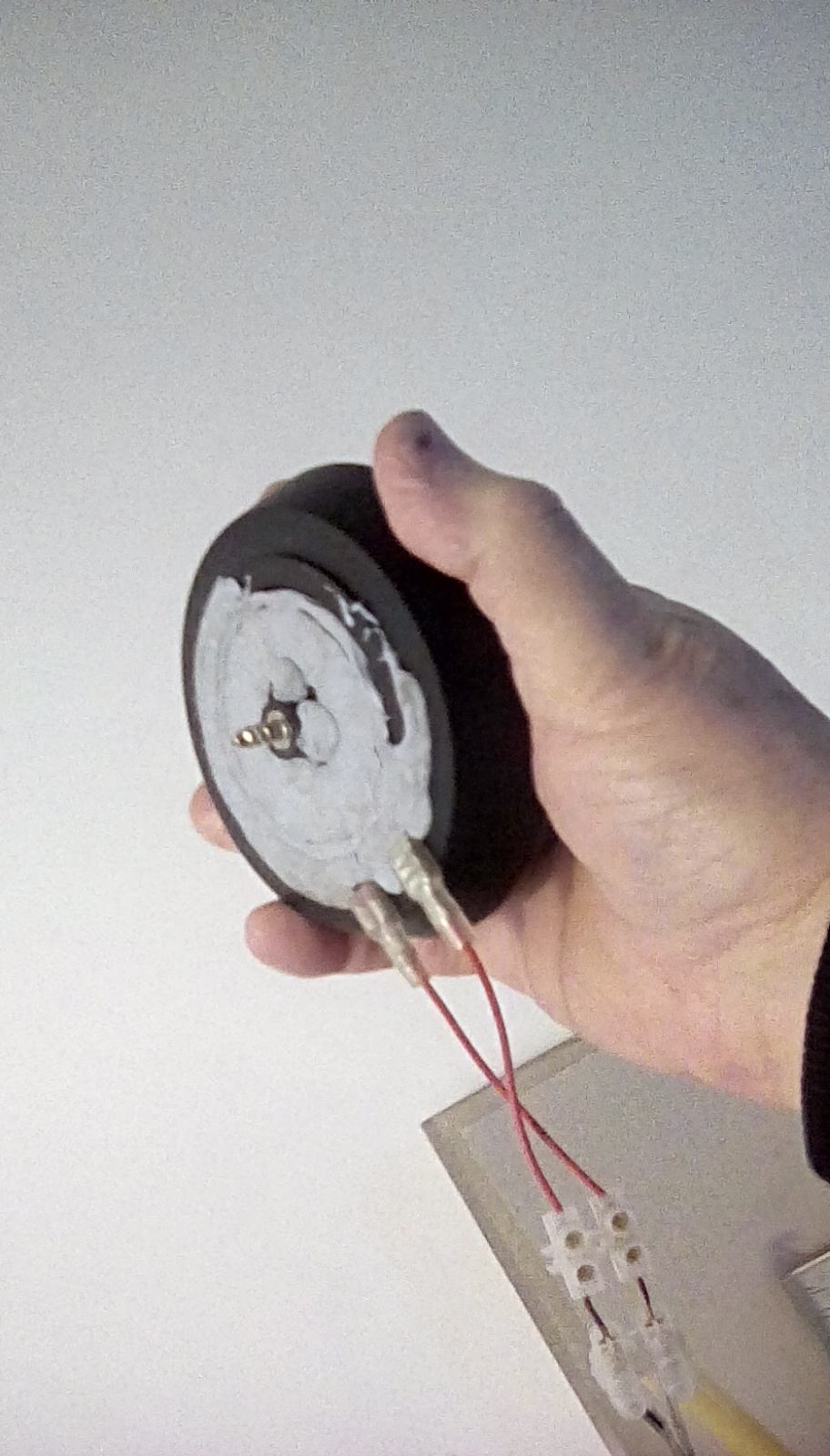

The phone microphone was just plonked down somewhere and I was just tapping the exciter on the wall,the exciter has a screw in the middle which is supposed to be screwed into the wall.

So for now lets concentrate on me creating some rear channel panel speakers and possibly hiding them in stretched canvas artwork, okay? Could use some advice on the material to use and sizing, exciter to use, etc.

It isn't easy holding the exciter against the wall,.
I did try to record Batman the dark knight ,very loudly , but there was too much going on.

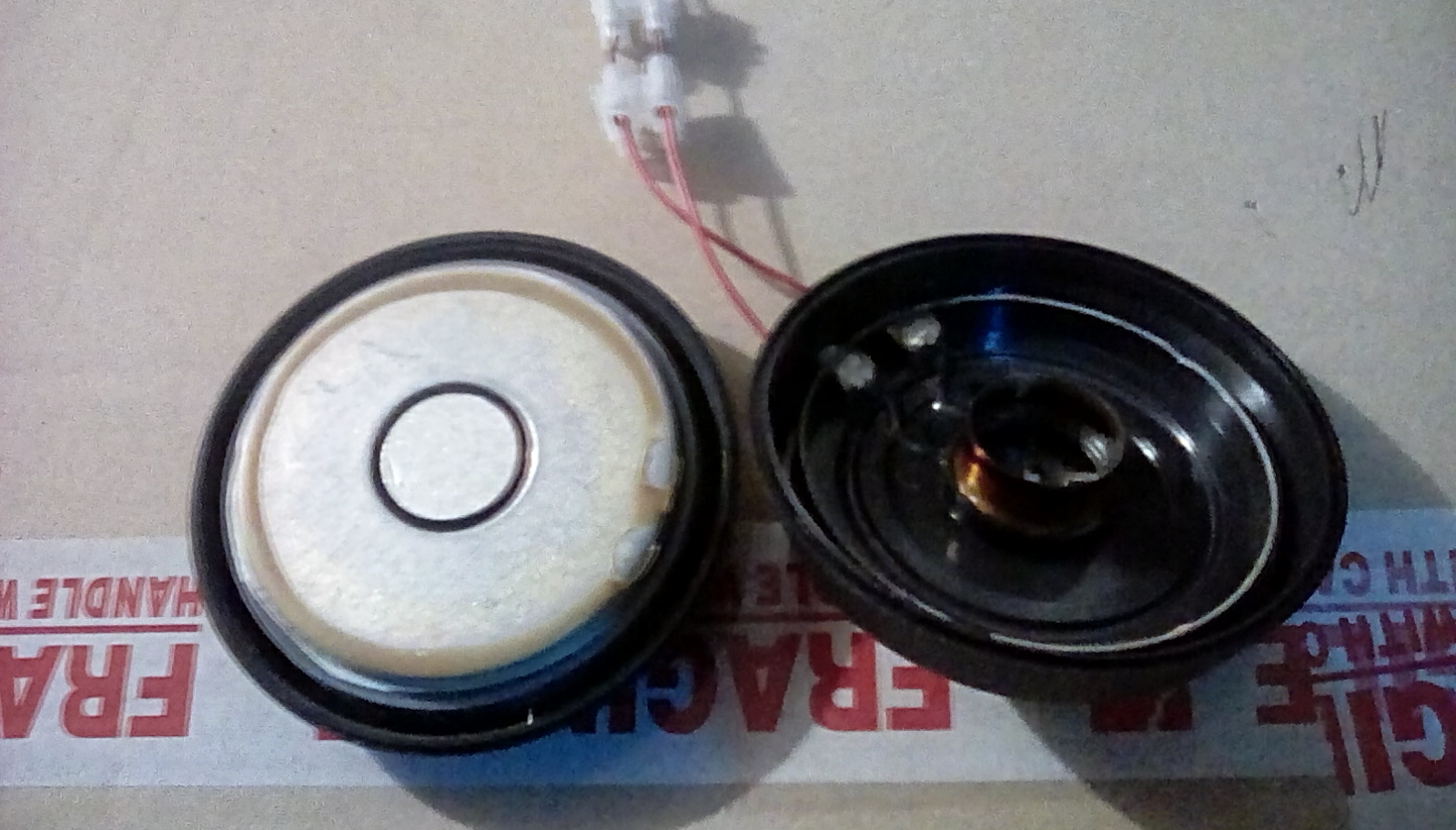

This exciter rattles too much,mainly because of the plastic enclosure, as you can tell when I take the exciter off the wall,it still makes quite a noise!!!
It was impossible to keep good contact.
Sorry for the singing on duty hast.
This would probably be my choice for rear surround speakers,it's a very quick and easy fix.
