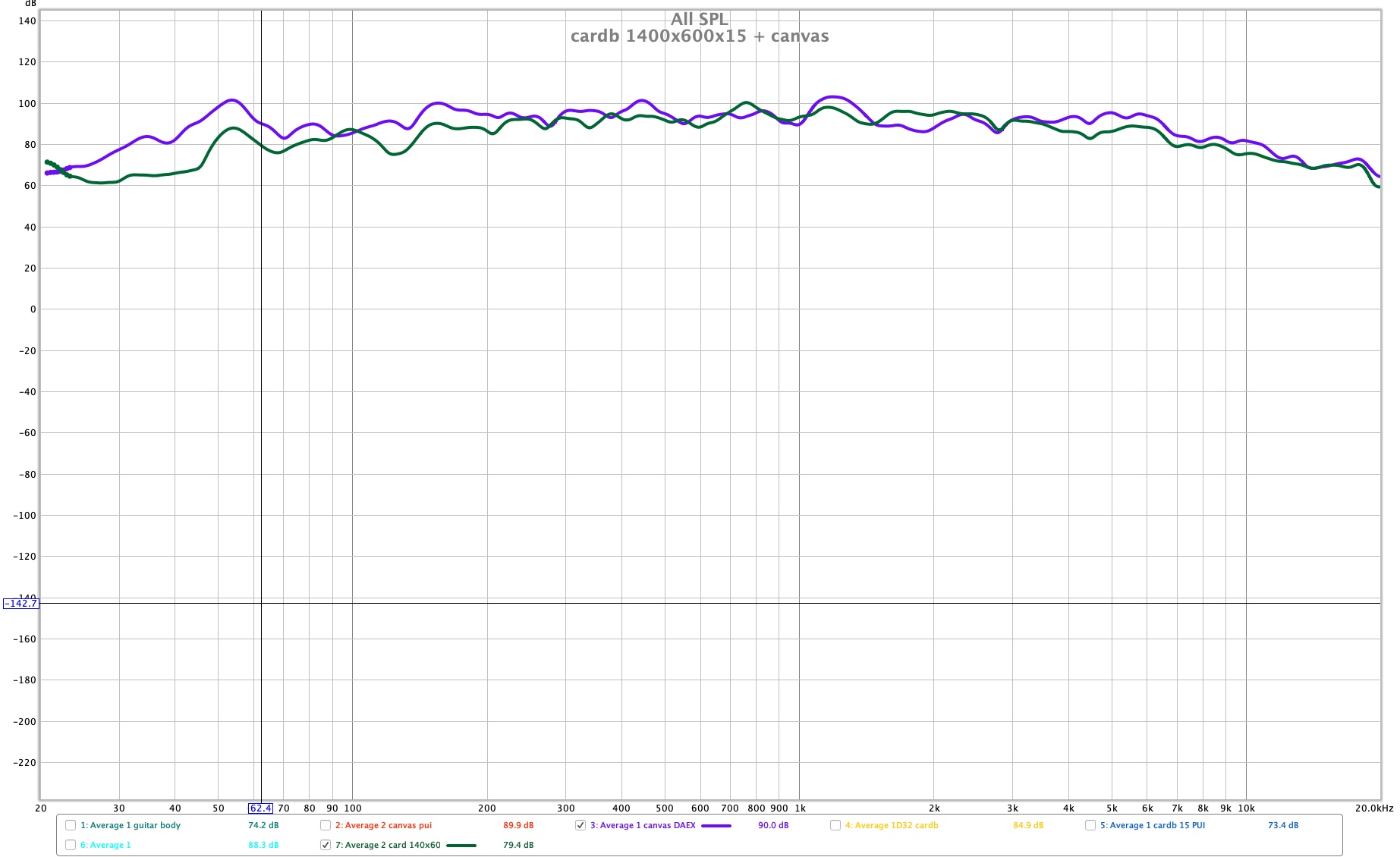

Spedge,
You are right about the 20db scale. It looks too good to be true. I am new to REW and calibrated mics.
The purpose of these tests are to see how different materials behave. IMHO I feel that we cannot take DMLs as pure full range speakers. They really need LF and HF support, there's though some 'magic', a sweet spot hard to ignore somewhere in the mids.

Even with 20dB increments that’s impressively flat. Any EQ applied?
This still looks lumpy to me,and the hf roll off above 6k I would regard as unacceptable for a full range panel ,which seems to be an ongoing problem with exciter and panel mismatch,which I believe is unnecessary.
Of course you could use eq but do we really believe you can bring back what has been mechanically lost?
This graph has a 100db window with the trace squeezed in at the very top,it could be more informative if centred more on the waveform .
I know it takes time to learn how to use these new measurement techniques ,so it is not a criticism ,but just an observation .
All the best.
Steve.

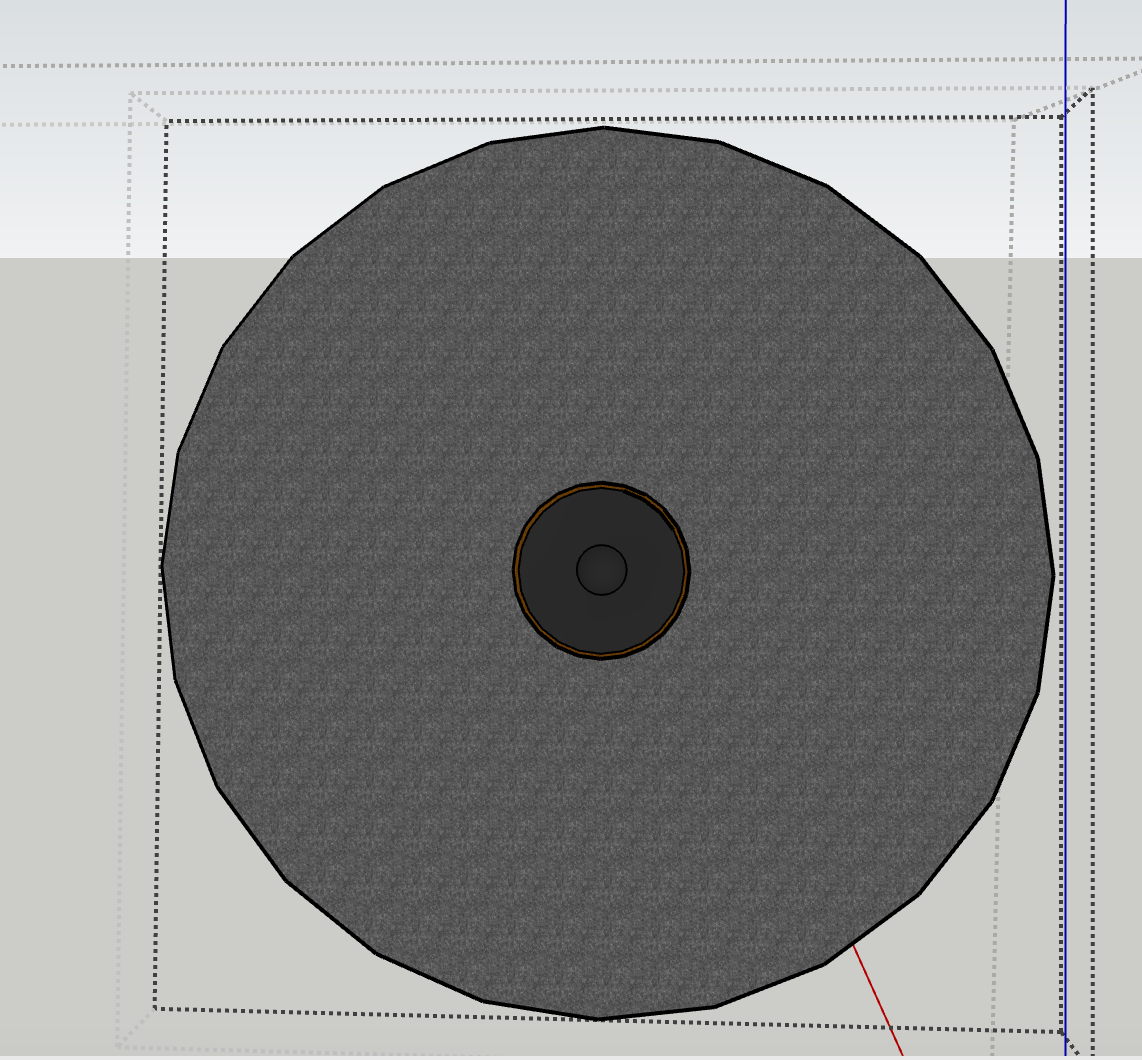

I'm quite new to this, but I was wondering whether someone already tried to build a round, circular panel speaker, and moreover, whether this produces good quality sound. The tech ingredients yt channel used one round panel in their experiment, but they did not dug deeper than that. Because of aesthetically purposes I would propose a round one. To extend on this, I heard lower tones are not always that well for flat panel speakers, would it work to add a woofer speaker in the center of my (future) round panel? something like my attached sketch?
kind regards, Bas

You do not mention panel size and materials?
Placing a cone or exciter in the centre of a circular panel is not a good idea,for well known reasons.
Yes I have made large and small round panels,but with offset exciters.
Not sure why round panels would be more aesthetically pleasing ,but I'm sure you have your reasons.
What is your preferred xo point?
Steve.

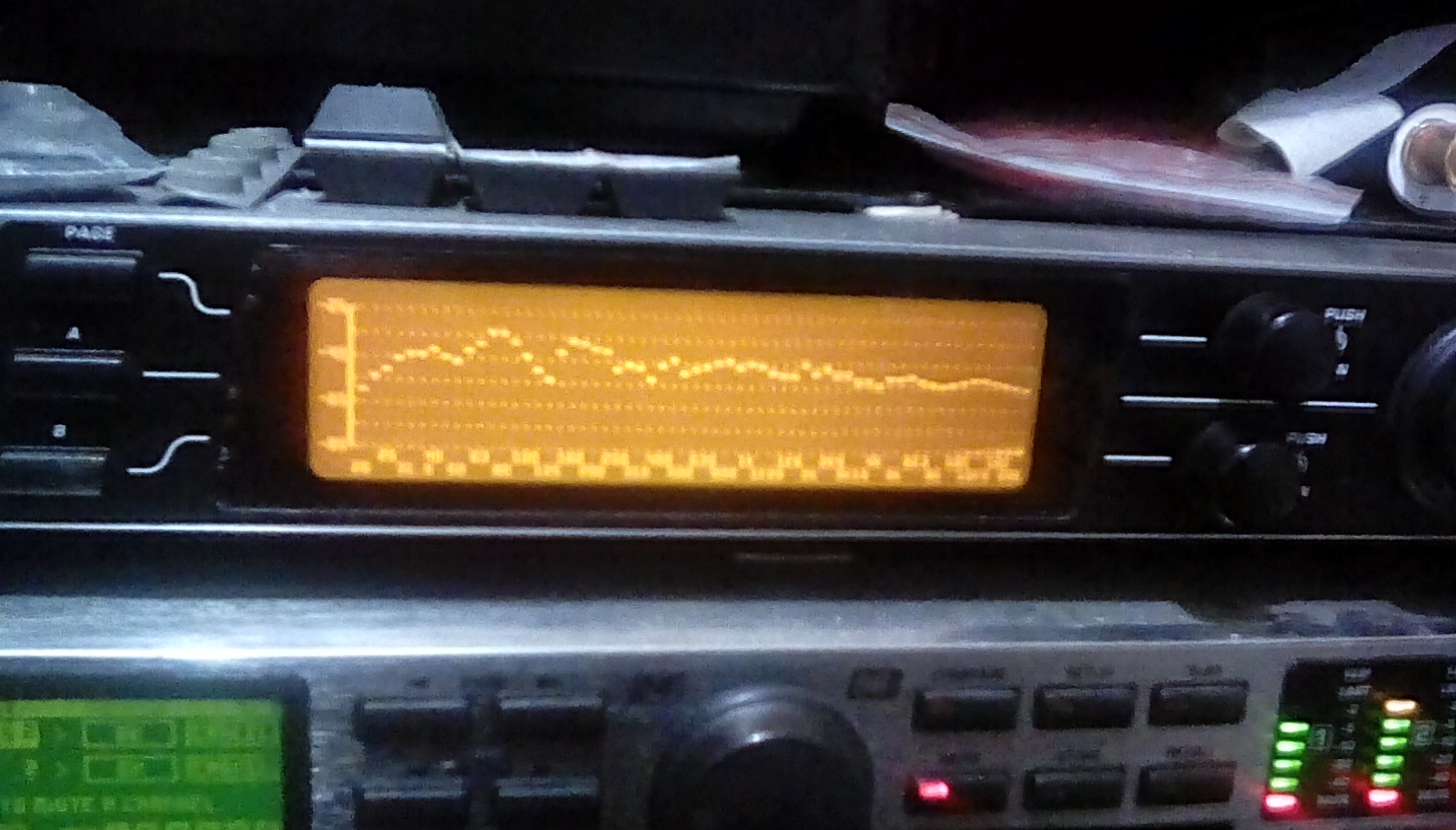

Thought I'd try and make the point,with my deq set to 20db setting ,even though it has 10db dotted lines,at one mtr.
This is just one of my card panels ,that I haven't managed to get around to taking apart yet.
I just wired it up and set the sub levels ,and that was it,3mins max,no eq.
The response looks very nice ,to me anyway,even with a load of junk piled in front of my transmission lines!
The card panel is doing everything above 300hz and stays within about +-6db with strong output up to and beyond 20k ,it only starts to get lumpy below 300hz ,when the TLs kick in ,according to this setting anyways?
If I move it up to 30db with 15db lines it starts to look like a straight line!
I never use the 20 db setting as it hides too many problems.
EQ would be very easy with this panel,by just lowering the midrange response a little,but normally I would try and keep the response as close to +-3db as possible,without EQ.
Steve.

I'd like to use a xps foam panel from approximately 65-70cm dia, 20mm thickness, as I heard in several experiments to be optimal, right?
my initial idea was to place a exciter according to the 2/5 / 3/5 principle, and the woofer as can be seen in the picture as a separate lower producing speaker. But as you show already, the round panel can produce good sound at full range, so I guess a woofer is not needed at all? Correct me if im wrong, I'm quite a beginner in diy audio.
Baswess99.
I have no idea what size is optimal for 20mm xps,I have not seen frequency plots that get anywhere near 10k without large amounts of EQ,no matter what size panel?
It would be interesting to see these experiments.
I have only used xps with a maximum of 5mm thickness ,which did have better results in the HF.
The only small panel I can think of that produces a decent low end down to 40hz was the artist canvas picture panels.
Even this I would use with sub.
I also don't believe I have shown a round panel (or any other shaped panels for that matter ) producing what i would call fullrange ,in realistic room conditions.
Mounting a low frequency driver to your dml panel would also hinder the performance of your dml panel.
I'm not sure what to suggest without knowing how you intend to mount your panels.
Hanging from ceiling. On a wall , standing on a surface?
Or as part of a stand alone speaker?
Steve.
