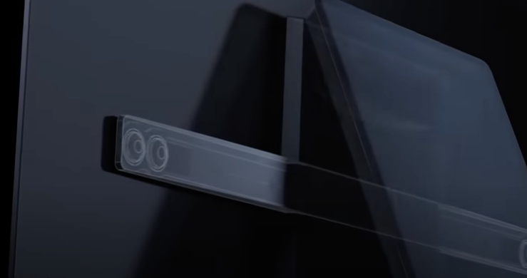

Sony Acoustic Surface Audio explained
Sony OLED screens use Acoustic Surface audio technology to deliver immersive sound (literally) from the surface of the TV screen. We’ve seen several iterations of Acoustic Surface audio since its launch, most recently Acoustic Surface+, but all adopt the same approach.
Rather than utilise conventional speaker drivers, be they forward - or downward -firing, the Sony system relies on actuators which literally vibrate the television’s panel, in turn creating treble and mid-range audio.
These actuators connect directly to the rear of the panel, housed in aluminium baskets, which enhance rigidity for improved dynamics. And no, you can’t see the screen vibrate, even at high volumes.
These Sony TVs use either two (a stereo pair) or three (adding a centre channel) actuators, which allow sounds to be panned and positioned on the screen relative to the original sonic mix. This allows for a true stereo image with clearly defined dialogue, with vocals locked dead centre.
It’s ingenious design, but the actuators have a limit in that they can’t deliver low bass. They’re best suited for mid and high frequencies. So Sony partners them with a more conventional subwoofer on the rear of the set. This fleshes out the soundstage and adds movie-style rumble.
I've uploaded a couple of screen clip shots from the link Sonnar suggested.
Maybe not, but "actuators" sure look like "exciters".
Interestingly, "Sony TVs use either two (a stereo pair) or three (adding a centre channel) actuators" on a single OLED panel.

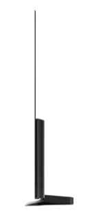

I don't think these TVs can deliver low bass because they don't have enough surface area to excite.

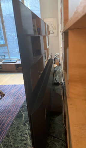

I've attached a photo of the side and one of the back of the LG TV I have.
It has "free" 57" wide x 19" high of OLED panel.
Lots of possibilities to contemplate. Among them:
Stick on a single exciter to make the TV itself into a center channel speaker. Then flank each side of the TV with a pair of DMLs (maybe plexiglass in my particular setup).
Use two exciters on the back of the TV for stereo, with a dedicated center channel DML perched above the TV.
Use three exciters on the TV. Left Center Right.
What can I use to temporarily attach exciters as I experiment?

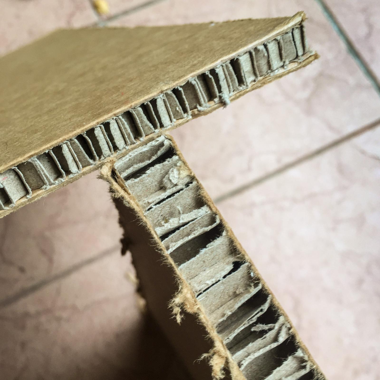

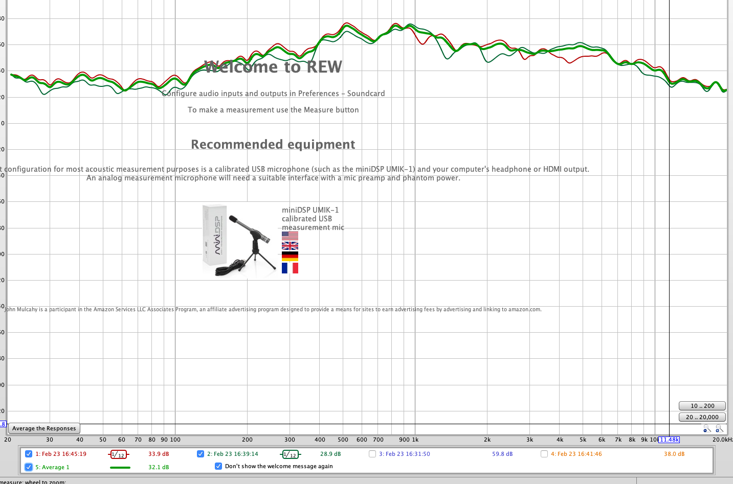

Here are two measurements of two exciters DAEX32P-4 (red) and PUI - ASX05408-HDR (green) on a 15mm corrugated cardboard (raw, untreated). Also there is an average of the two, the thick green line.
The panels in the photo are 48x60cm with thickness of 10mm and 15mm. Strangely enough the 15mm panel is half the weight of the 10mm one, about 88kg/m3 v 163kg/m3.
Spedge,
They were placed on the floor with the panel resting on top of the exciter placed in the middle. I like the idea of mixing the type of panels (cardboard, canvas, plywood, polycarbonate-10mm twin wall) in an array to get a better frequency distribution without too much EQ. I have a DCX2496 ready to jump in (if needed) to be attached to a 6 channel Dared DV-6C amp. They will go into a room that is our cinema, music hub where there is subwoofer support, two or three hidden in the corners. I have also the option to place the subs under the floor using two of the vents from the old heating system.
I am very lucky that the WAF is very high (she was almost in a state of shock) after the first listening impression.
- The microphone was at 1m through an old NAD 7020 receiver (volume at about 9 o'clock).
- The graph's increments are 20db.

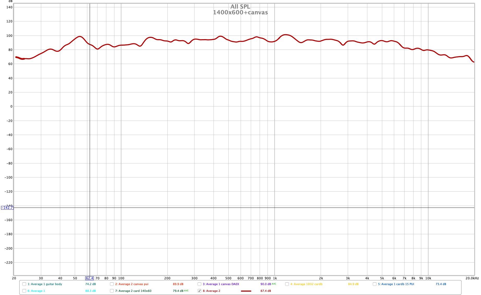

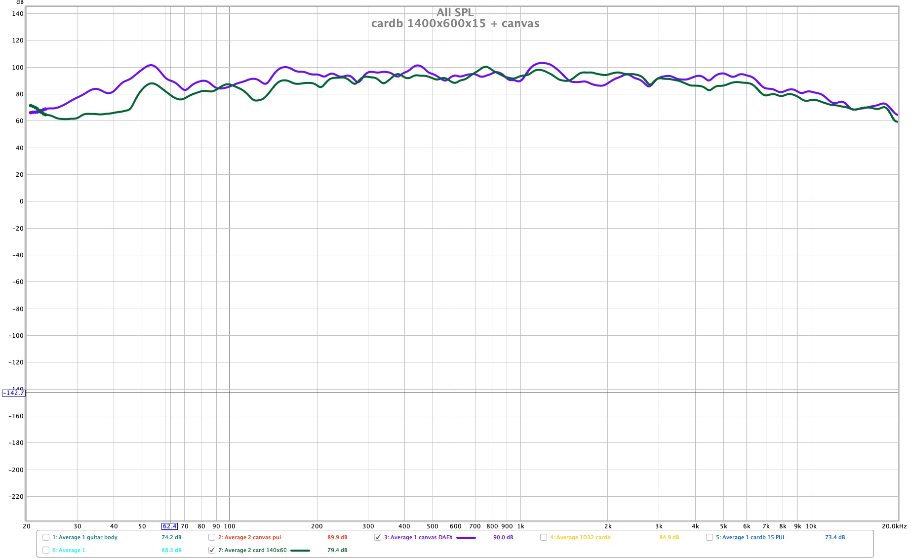

I made another frequency sweep with the 1400x600*15 mm honeycomb cardboard and a 12x16" stretched canvas with a DAEX32ep-4 40w exciter from 1m. The second image is a frequency blend of the 2 panels. The cardboard panel will be painted and possible laminated with 0.03mm fibreglass and epoxy.
I am planning to mount the large panel at ~18cm off the wall and the canvas 'hidden' halfway behind. I am not sure if the SPL will be OK for a listening position of ~ 4m away
Any thoughts?
Any thoughts?
