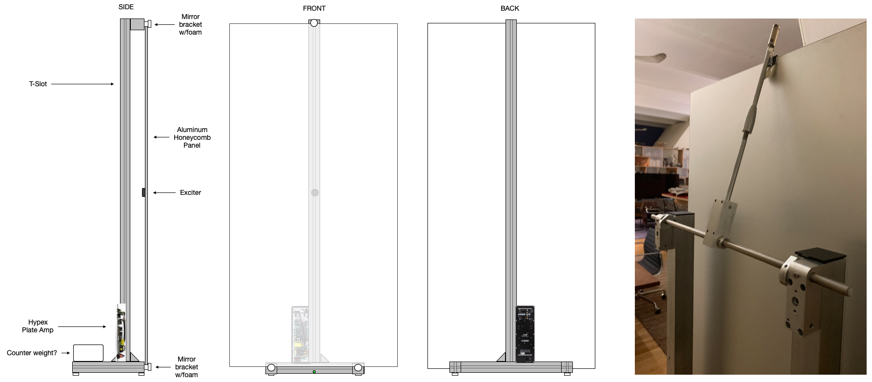

The attached photo has my latest thoughts on on a more permanent and secure frame for the panels.
What I currently hear from the panels has me thinking that the weight of the panels on the inverted speaker spikes may have some positive affect on the sound.
Still forming my thoughts.

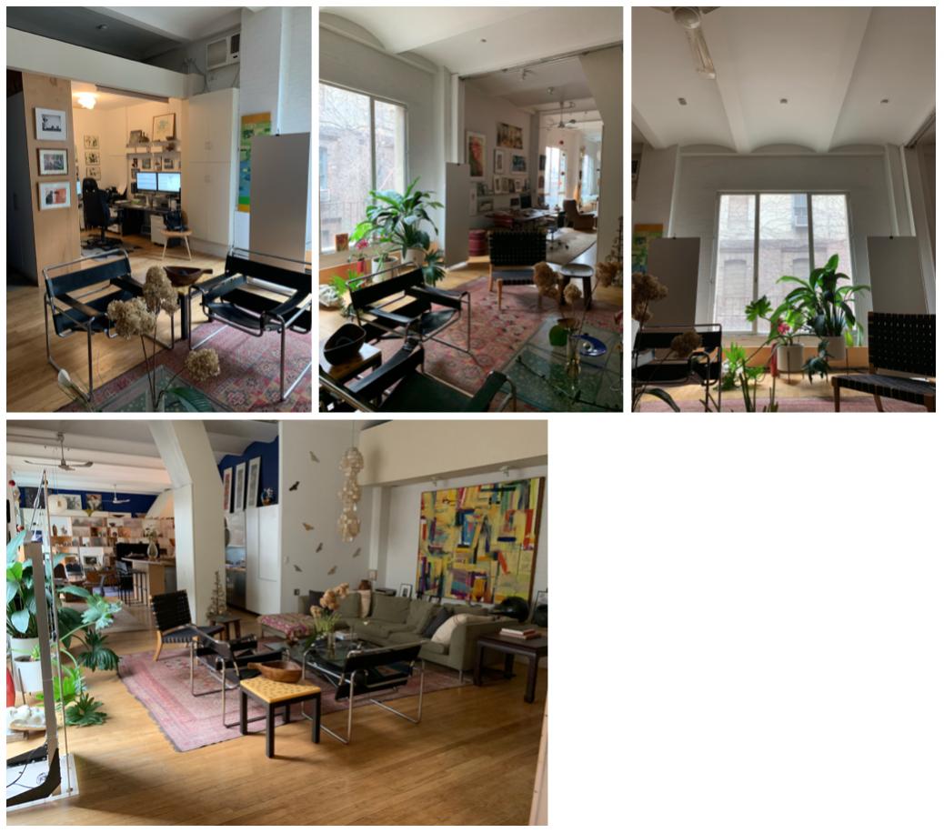

Listening space.
High ceilings, 12'. Massive concrete and masonry construction. Floors 8" concrete (with oak floors on top). Exterior walls, 1' thick brick with 2' thick pilasters of steel encased brick every 15'. Ceilings 8" concrete supported by plastered brick arches caught by steel beams.
My listening area: 23' front to back x ~20' side to side x 12' high. As stated before, the space opens up more to the right as I face the speakers.
You can see from the attached pictures of the space that the arches in the ceiling present the worst physical attribute of the space. Anything reflecting off of that ceiling gets focused.
In the past I have had the most success with speaker systems that didn't have much vertical dispersion (ribbons, panels, electrostatics).
Not fully clear yet how the DMLs interact with the ceiling. Thoughts appreciated.

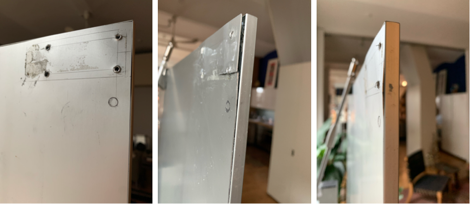

Aluminum honeycomb panels
The fronts of the honeycomb panels look beautiful. On the other hand, I got these when the kitchen store I mentioned wanted to throw them into a dumpster.
See close ups of two of the rear corners of the panels attached. The panels have some old screws holes in them, a couple of places near a couple of corners have started to delaminate.
The panels have square corners.
Nothing perfect about these panels.

Aagas,
Thanks for sharing your impressions. You've turned your find into something really cool. Glad to hear you are enjoying them so much. It is too bad that they are not aesthetically perfect, but I'd kind of look at it as battle scars to be proud of instead of imperfections!
Regarding making measurements. what you need to do is download REW (Room EQ Wizard) and learn how to use it.
Concerning how to support them, I have a suggestion but probably it's not exactly what you are looking for. I suggest you build a frame and attach the panel to the frame around much of its perimeter something like I did here:
https://www.diyaudio.com/forums/full-range/272576-study-dmls-range-speaker-85.html#post5978276
This type of support wasn't my idea. I copied it from Tectonics (as well as I could anyway) from the concept shown in this video (at about 1:30 into the video).
The Tectonic DML Part 2 - YouTube
This type of support tends to boost the and flatten the low frequency end IME. Then have The Architect design the supports for the frames!
I wouldn't sweat the square corners. I think the rounded corners thing is myth. Note also that the Tectonics DML shown in the video has square corners, so you are in good company.
Regarding exciter location: Generally dead center is not considered the best location. Slightly off center along both axis is better (in theory at least) because you can excite more bending modes with off center placement. The Azima NXT patents suggest choosing locations that are 4/9, 3/7, or 5/13 along each of the axes. Try one or more of these combinations and see if you can measure or hear any difference from the center location. I suspect you won't hear a difference but will measure one.

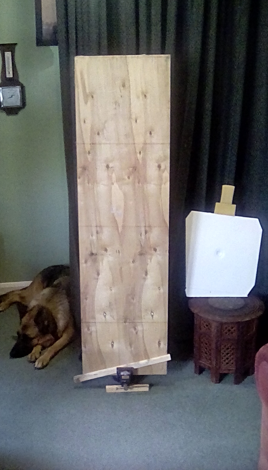

This is a quick mock up of what I have done in the past,feel free to take some ideas.
If you would like to keep the clean lines of your panels you could build a clamping stand ,I'm sure you can build something better than my vice,which was used for testing.
I did use g clamps as well sometimes.
I've used this with eps and ply.
If you angle the the wood clamp at the bottom,this helps break up standing waves ,if you wish?
In the first photo you will see I cut a piece of card to show how I extended the side a little with an off cut to extend frequency response and offset the exciter ,which as you can see was also at an angle.
The small eps panel on the right was included to show how to convert a square panel into a panel with non parallel sides,without loss of any material.
I just cut off the left side at an angle and glued it to the bottom,that simple.I
You could use a v shape at the bottom or an inverted v ,whichever looks good to you,as long as it breaks up the standing waves from top to bottom.
With enough weight at the bottom it should be stable,and not blow over.
