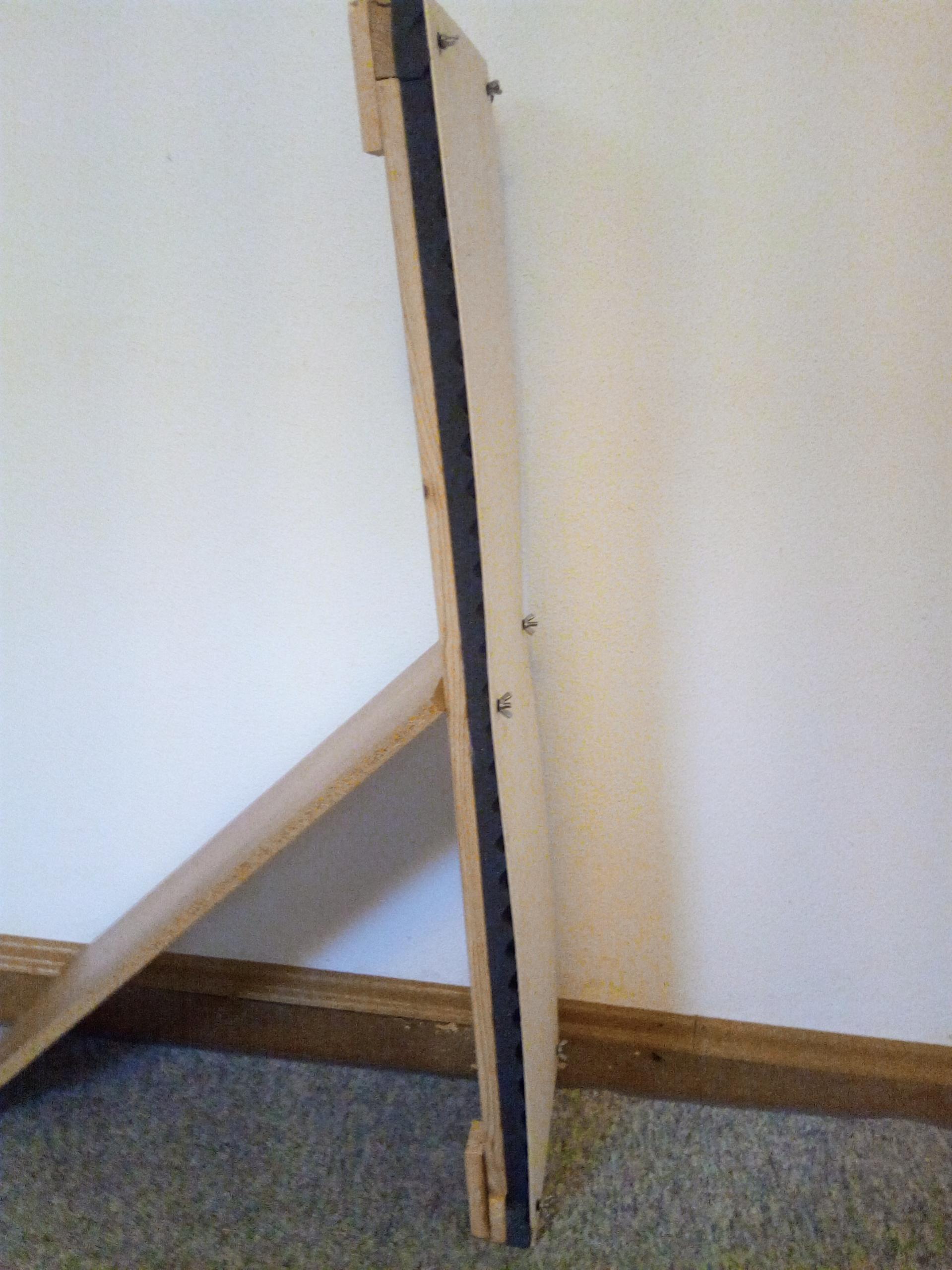

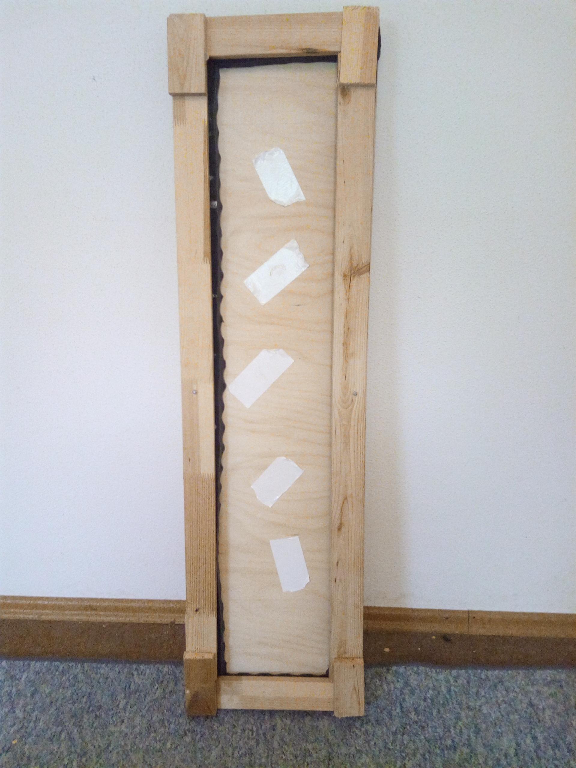

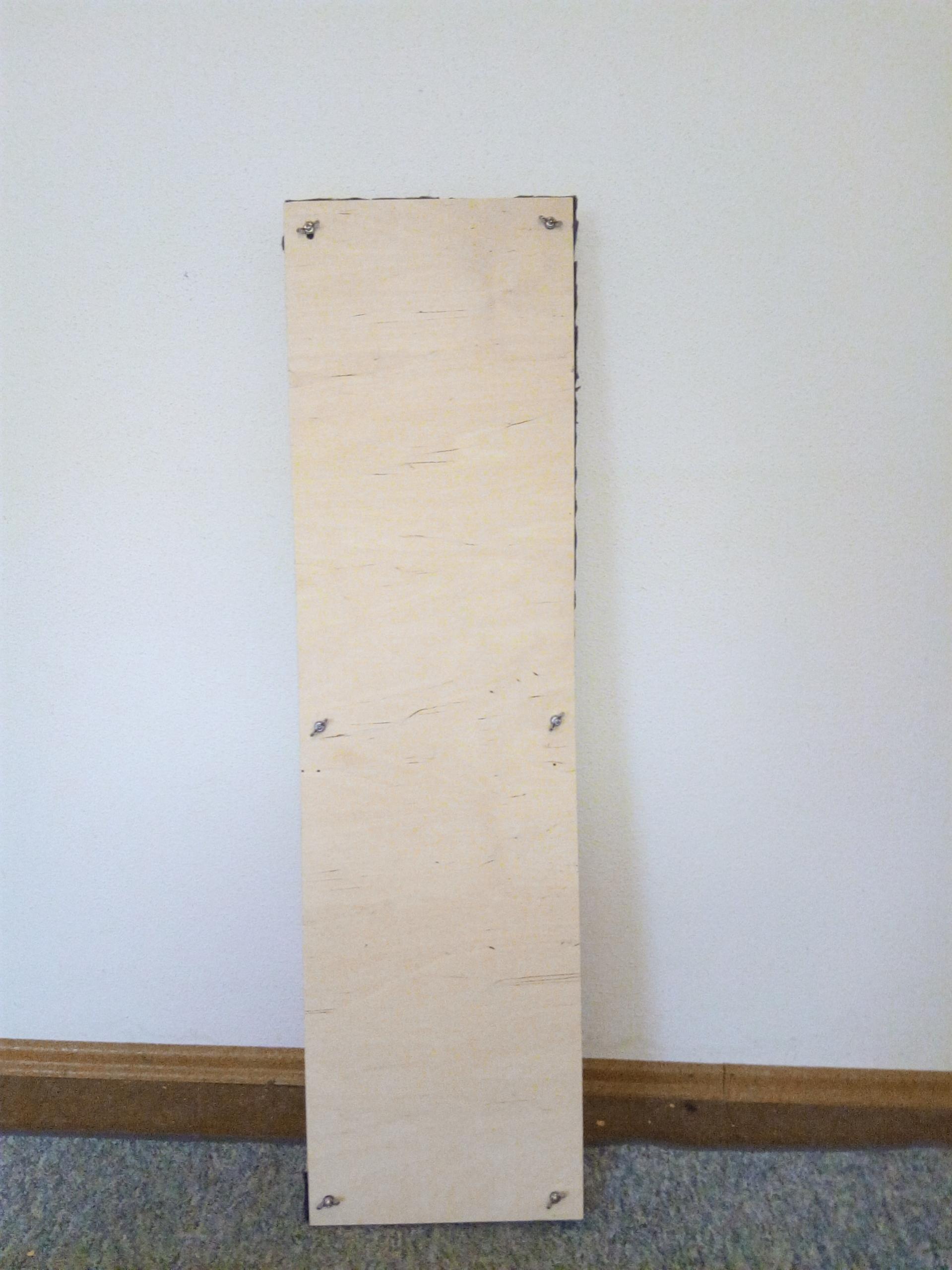

I have started experimenting with DMLs sometime last year after watching the Tech Ingredients video and really like the sound of them.
After a couple of experiments I wanted to share some of my findings, but keep in mind I am by no means an expert in this stuff and have only my ears to go by, since I don't have any measuring equipment.
Firstly I was excited to tell you about honeycomb cardboard as panel material, but xrk and 100ohm found it themself recently.
I got mine from amazon in germany:
Pappwabenplatte kartonkaschiert, 5 mm x 50 cm x 70 cm, 810 g/m2, formstabile Wabenplatte zum Bekleben geeignet, beidseitge Abdeckung aus Karton, schwarz: Amazon.de: Burobedarf & Schreibwaren
I have one 1x50x70cm panel of it in use and recently one with 0,5x50x70cm arrived, which I will test soon.
It is definitly lighter than wood and still very stiff, which gives it an overall higher output especially in the highs, but still has suprisingly good lows.
I added it to my existing setup consiting of two 0,4x70x90cm birchply panels I have curved using a curved wood bracing, which brings me to my second point:
Introducing some kind of curve seems to improve the output of a panel, probably because it increases its stiffness, but again I have no actual data to back up this claim.
Another thing I noticed, then I tried the packing styrofoam panel in the pictures, is that even though the over all sound wasn't that good it had significantly more LF output than a similar sized styrofaom panal with just a plain shape. For the people using XPS or EPS it might be worth trying to cut additional structure into the panels to see if it improves the output. Kinda like the bracings in for example a guitarr.
Also I tested the method, presented by offgridkindaguy awhile back, by attaching a small CF panel with an exciter to a kinda big wooden frame with a thin piece of plastic in it (used to prevent small caliber shells hitting the person next to you) and again while the overall sound wasn't great it had good LF output so there is defintitly somthing to this method.
To the question of exciters the DAEX30HESF-4 was the first one I got and still think it is the best, I also tried the DAEX32QMB-4 in the hope of more bass output but was dissapointed by it.
I also have a question, I have achieved my best results by combining different panel materials for example wood + xps or wood + honeycomb cardborad, but this method of combining materials doesn't seem very common and I was wondering why?

Thank you for your kind words. I will keep you all posted about my future projects and findings
You are right - I have certainly not seen combinations of materials here yet. So, what combination is giving you the best results? Can you share more details - materials used, how are they stuck together, size of the panels, on which side is the exciter, etc.?
I didn't mean two materials stuck together, that I meant was using seperate panels with different materials. Currently I use one panel honycomb and two panels wood with the sizes as in the post and another small piece of wood, that once was the backside of a cabinet, but I will replace that soon with another honycomb panel.
The two woodpanels are wired in series using these DAEX30HESF-4 and the other panels are wired in series using the smaller DAEX25FHE-4, with the goal to tone down the, like 100Ohm described, sometimes very prominent highs of the honeycomb.
So far it works great for me, but I am constantly experimenting and changing some things (for me half the fun of the project)
I have tried wiring them in parallel but this can be a very heavy load for the amp (an old arcam delta 290 atm)
In the past I used a similiar setup but with 2 A3 sized pieces of XPS with a paperlayer on each side in combination with the wood panels, which I also liked alot, kinda like a mid and tweeter combi but I havn't tried crossing them over at different frequencies yet.
I have thought about applying one sheet of fiberglass to one or both sides of a panel to see how that works, but haven't got around to trying that.
-Leonard

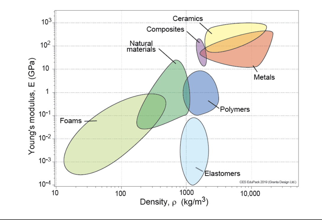

Yep, there is a myriad of materials. The general guiding principle is low density but stiff.
Hi Dave
thank you very much for the keywords with the graph. It is very helpful for me.

Hello everyone,
I came up with an idea for a frame for the panels:
- Make a simple wooden frame the size of the panels
- Put threaded rods through the corners and along the edges as needed
- Glue some accoustic foam or some other spongy material on it
- Drill holes in the panels to fit the threaded rods
- fasten the panels using wingnuts and rubber spacers
So you can controll the amount of dampening along the edges with the wingnuts.
I made a crude prototype for testing, to fit some 30x110cm panels inspired by Burnt's "Tall Blondes", I'll attach some pictures.
First listening impressions are pretty good, I am going to use these as desk speakers for my PC.
Should be easy to adapt the design to all kinds of panel materials and sizes and if you keep the dimension the same panels can be easily swapped to provide a controlled enviroment to test different materials.
It would be great if you could provide some feedback and suggestions on how to improve the design.
Also I'm thinking about purchasing a mic for testing and came across the miniDSP Umik-1, which seems to be a good candidate and I was wondering if someone here has any experience with that model or could recommend a different model in the same pricerange.
-Leonard
