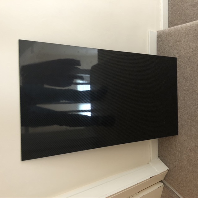

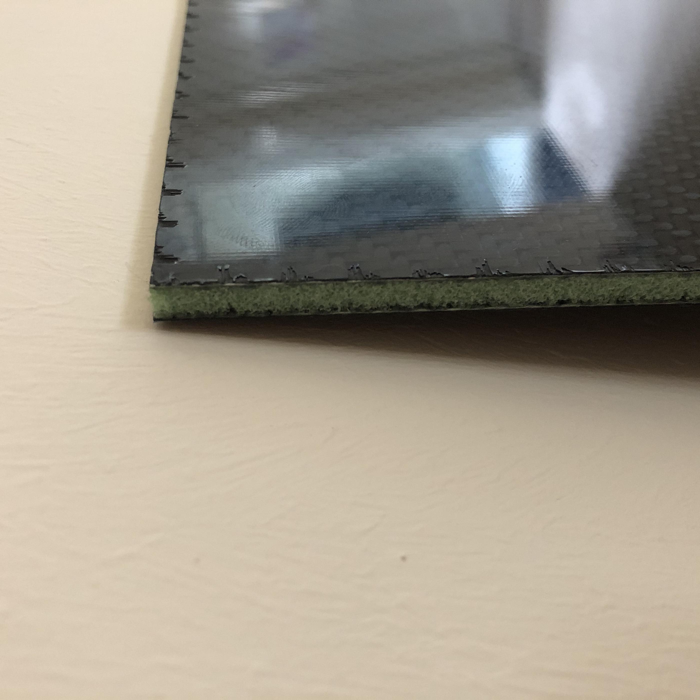

Decided to crack on and give it a try. Was looking at making a nomex honeycomb carbon fibre sheet, but given I have no experience with these materials and the cost is way too high if I mess it up.
As an alternative, I’ve just ordered some carbon fibre foam core panel from easycomposities. Quite a gamble to be honest as it’s still not cheap. Will let you know how I get on once it arrives and I try it out. 🙂
Sorry for the long delay, due to work offshore and covid, my project took a back seat. The panels arrived and I tested them with DAYTON AUDIO DAEX25FHE-4 exciters. I was disappointed with the results. There wasn’t enough volume and the sound was quite tinny (not a very good explanation!). The carbon fibre/foam composite boards really ringed when you tapped them.
I was testing the exciters on materials I had lying around the house and placing them on my acoustic guitar sounded a lot better than the carbon panels.
Thankfully, carbon composites kindly accepted the return of the panels for a full refund.
Back to the drawing board. Start with the tried and tested materials. 🙂
