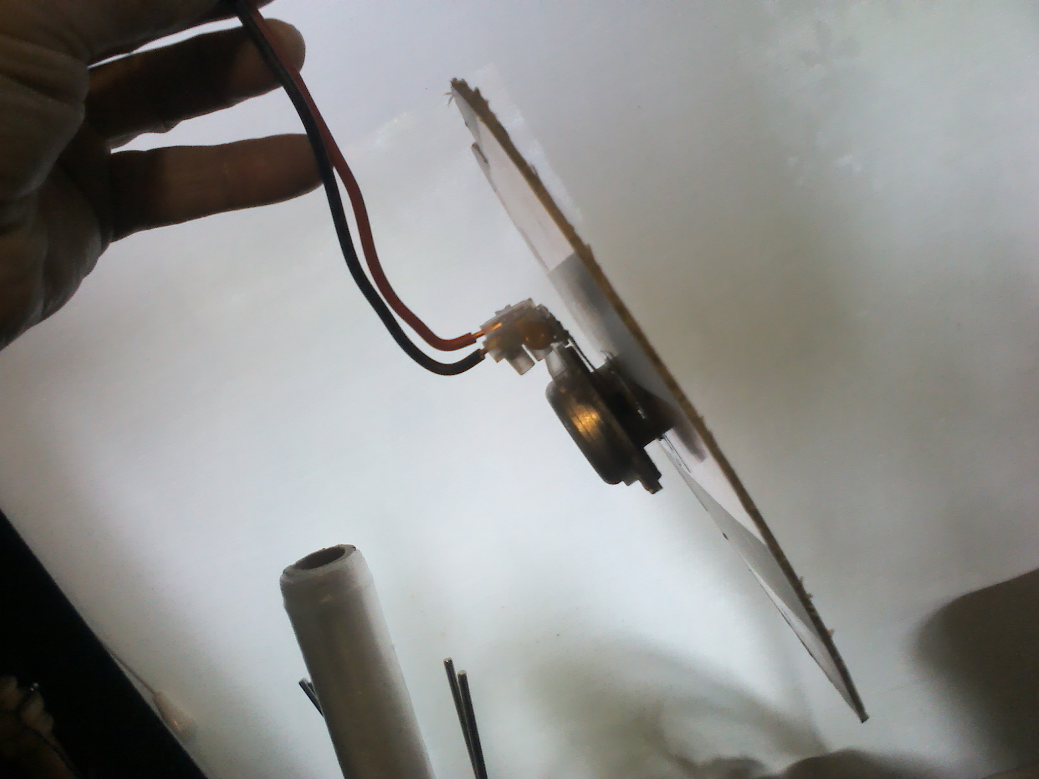

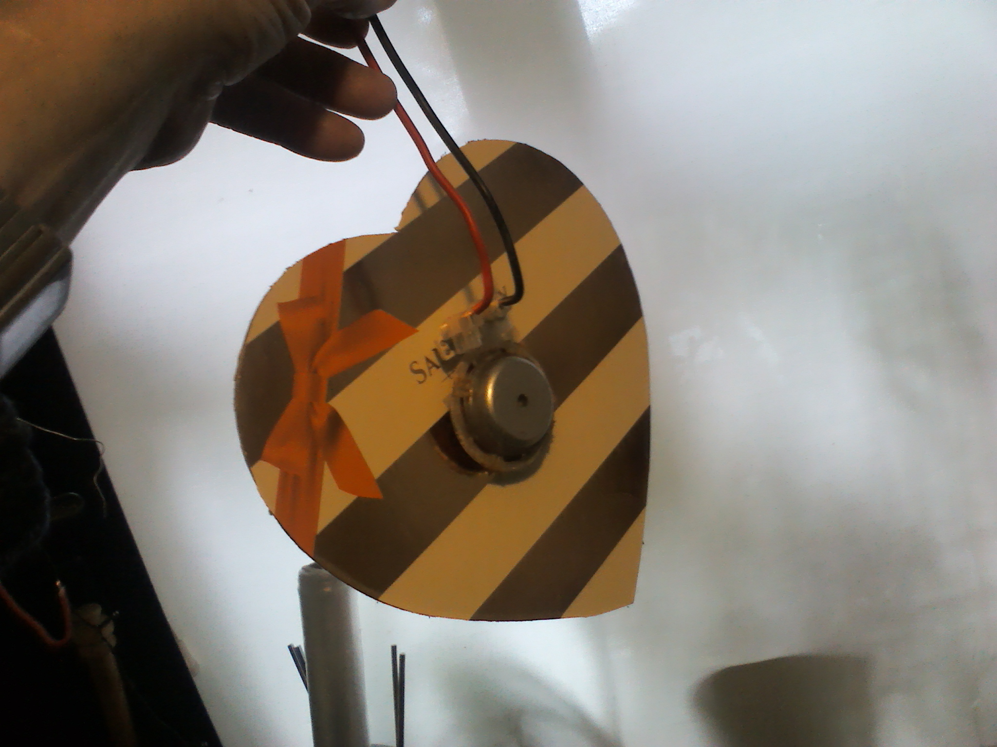

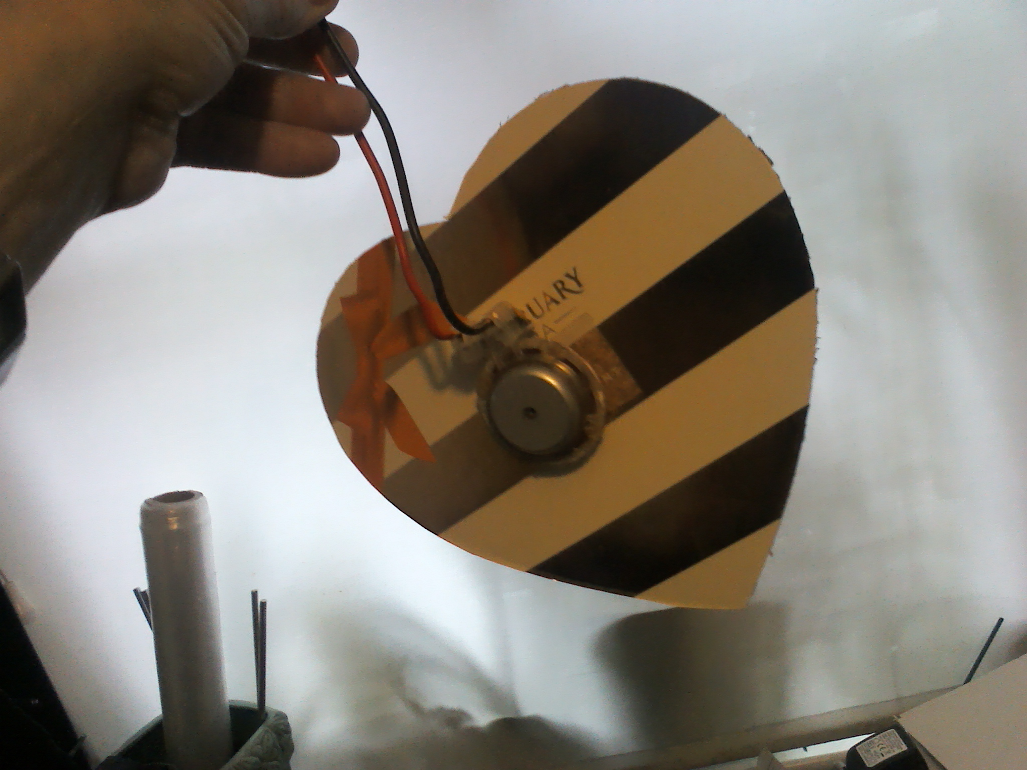

Here's the pics ,try not to laugh,I use what I can get hold of, simplicity is my motto,this is as basic as you can get,2mm card with an exciter stuck on with double sided tape.
This is so easy to improve on,in so many ways, gluing the exciter on,so that the panel doesn't fall off after a week or so(only the left one for some reason) would be a start!
Obviously I have a digital xo so this helps immensely,the panels were run down to 127hz and the bass units were rolled off at 400hz,both 48db slopes,this helps drive the room better,and combat room suck outs in the 100to 300 or so HZ ,which is always a problem!

You may actually have sonic benefits to a heart shaped panel since it doesn’t support rectangular standing wave modes. It will have less peaks of resonance or wider ones rather than sharp ones. Another shape to consider is the Fibonacci spiral (nautilus shell spiral). Another one is a pentagon. For open baffle speakers, these organic shapes tend to sound better than a rectangle. A circle is one of the worst shapes. Perfect reflection symmetry is bad. A 5 petal flower is actually very good also. Trapezoid is better than a rectangle.
Ark.
I have actually got two smaller sizes of 2 to 3 mm ply in the heart shape from the art and craft store for that exact reason.
The idea was to glue one of these to the front of the canvas picture frames also from the art and craft store,for a full range panel (getting a bit arty now),I haven't got around to that yet,too many projects on the go at the same time.
Not sure that the shape would have much effect when glued on to the picture frame?
Although this would not take much time to get up and running,I would have to listen to the naked panel first.
Most of the time is taken up by listening to the panels and adjusting them for better sound ,if I feel they are worth it.

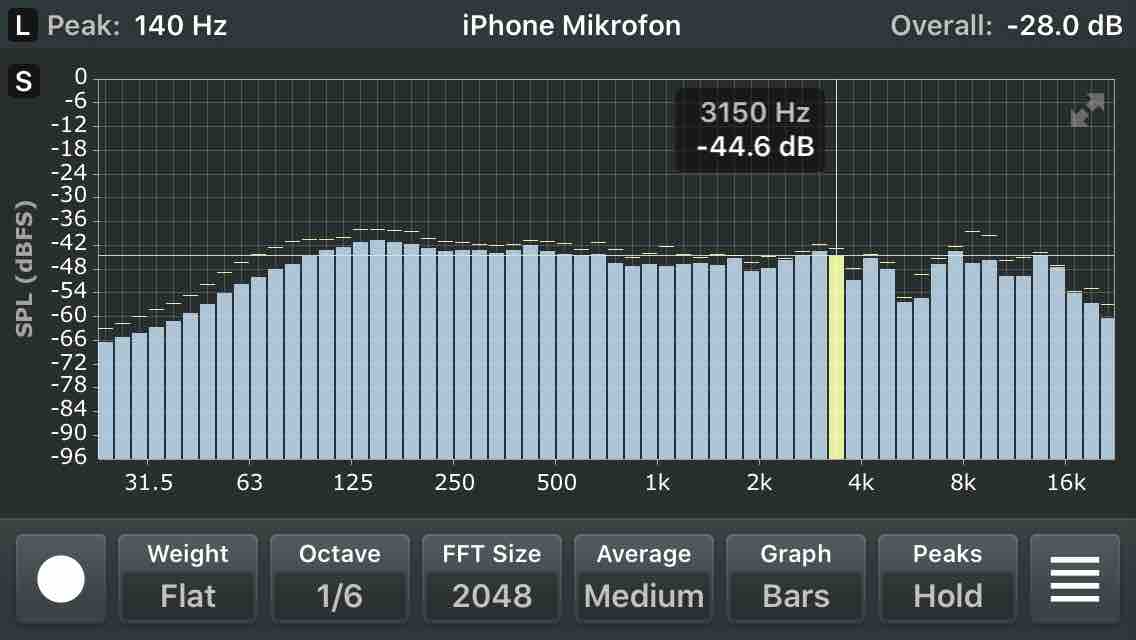

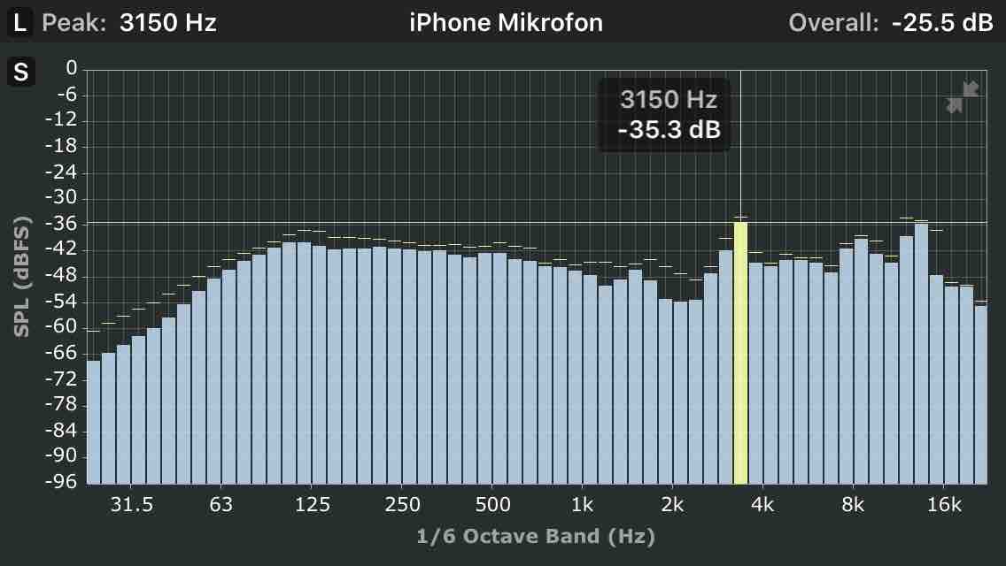

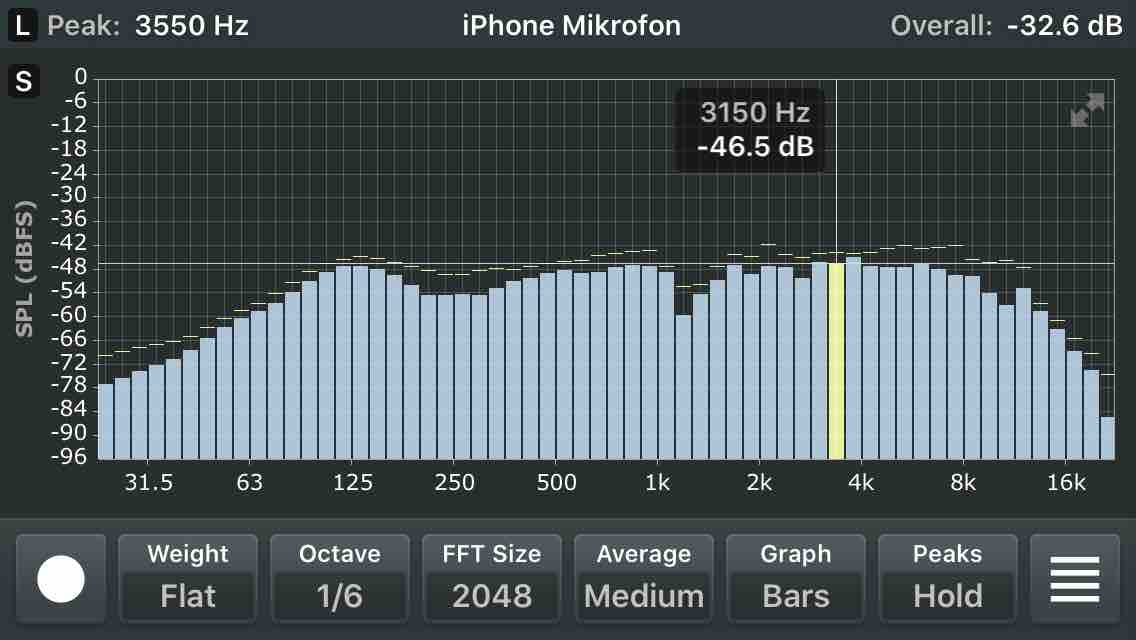

honeycomb card-/paperboard
the honeycomb board has got now on one side 2 additional layers using rice glue and soft table napkins (in total 3 layers, first layer made with paper/printer paper). With the use of rice glue the card-/paperboard get soaked and some altering of the material happens. Within these process steps I've tried to flatten the board with ironing. At the end I did a finish (2x) with very thin rice glue and a spray bottle. The result is quiet good. Tonal balance is good, details are crispy and clear, most of the acoustic instruments have its characteristic and electronic instruments are good too. Voices (male and female) are fine. The only issue for me are the transients of the acoustic guitar. There are some little distortions when a picked string is quieting. I think this is caused by lost joints of the honeycomb structure at the layer.
As a conclusion, I would recommend the use of rice glue on honeycomb card-/paperboard, where one layer has been taken off. The usage with rice glue does impact the soaking and altering of the material. This is the main issue and challenge. For a next experiment with honeycomb card-/paperboard I will first impregnate the material on the surface only with 3 or more thin layers of rice glue using the spray bottle.
The first picture shows the layer side with attached exciter. The second is the pink noise frequency range at the open honeycomb side, the third is the frequency range at the layer side and the forth shows for comparison the frequency range of the 6/9' Goodmans speaker of my stereo set in the living room.
the measurement on the panel are made very close (2') starting at the exciter, going to the edges and crossing the panel; the measurement on the oval speaker is made at 10' approx. The filled bar graphs show the measuring point at the exciter, the small lines are the peak level indicators while crossing/moving the microphone

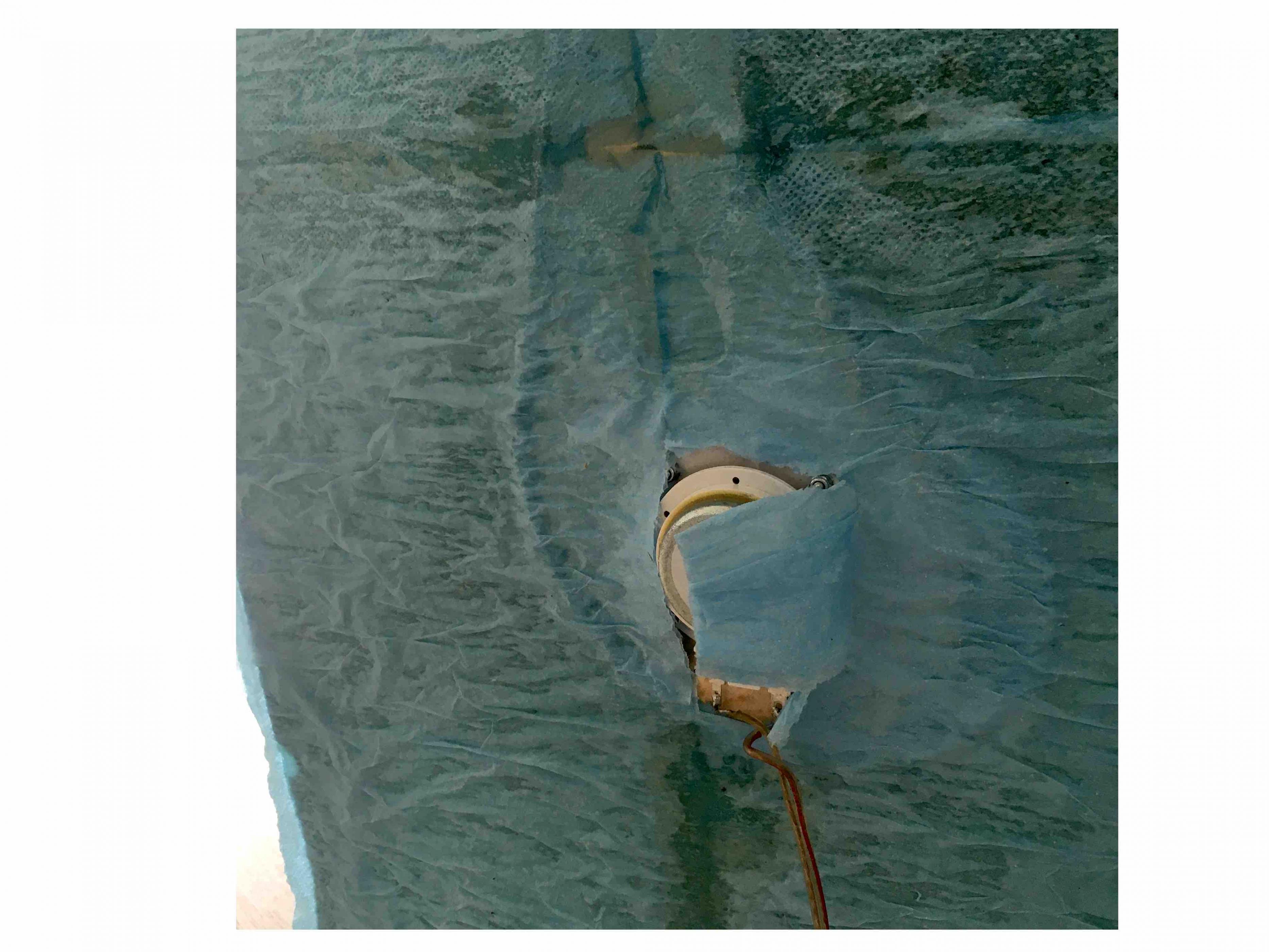

Hi XRK
Did you made any tests and work with your boards?
this week I've worked on a kind of honeycomb board like yours. It is not that stiff as my other cardboard honeycomb boards. One difference is the type of layer. It is made of Craft/Kraft paper. The cardboard honeycomb with screw mounted exciter sounds in mids and highs very detailed and super clear, it remembers me of the old Quad ESL, but lacking the body. The paper honeycomb lacked in details but tonally is much better balanced for me. So I decided to work on the softer sounding board.
After trying to make them stiffer with a kind of 'papier mache' (modified rice glue), I decided later to take away the layers and made one side with paper and rice glue (mixed with paper and cardboard), because a bigger part of the before soaked layer did not make good contact with the honeycomb structure.
I've now one side open (with the honeycomb structure) and one side with a new layer (picture). The exciter mounted on each side and listening tests of all four sides showed the exciter on the layer side and the ear on the open side as best for me. The sound has some details, voice is again in front as well instruments with percussive sounds. Electronic Organ, acoustic and electric bass has a good body. The efficiency overall is much less than with the cardboard panels but still no problem with an 8 Watts amp.
I think there is a good potential for me to work and improve stiffness on the layer side and partially on the open honeycomb (esthetically a must as you can see;-)
