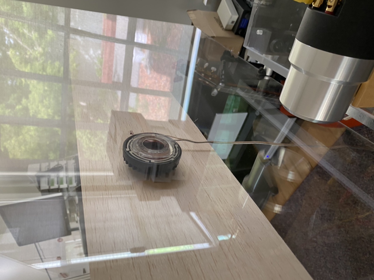

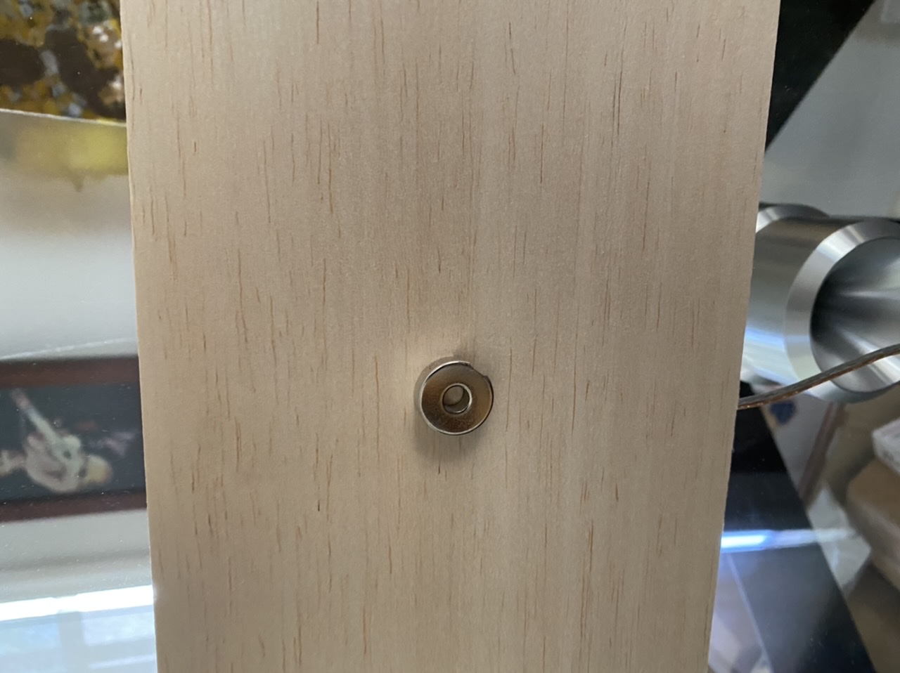

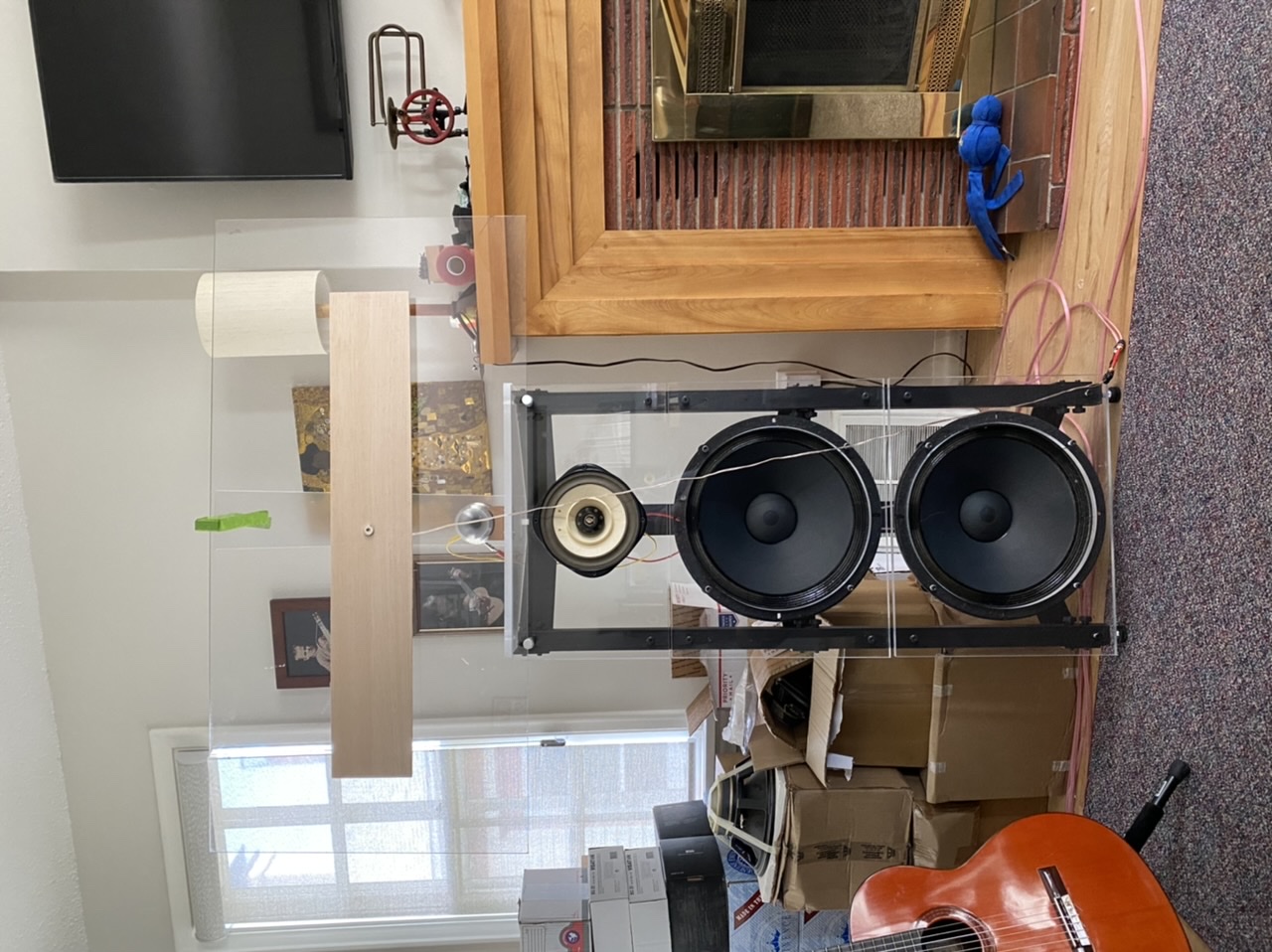

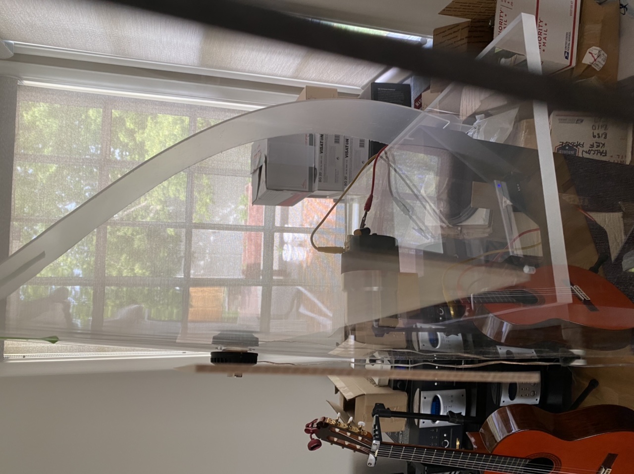

Here is my recent experiment. I found that my plexiglass panels sound good from either side so... I used a neodymium ring magnet to attach various panels of different size and thicknesses to the back of the driver for a hybrid panel. The sound is quite impressive and a n improvement in high end and presence. No measurements yet

That is just a great idea, I haven't seen that done anywhere but it makes sense. I wish there was some way of figuring out exactly how effective the back of an exciter is at exciting a panel so it could be a more informed decision, but if you say it sounds good, that at least is a great start.
I have a few questions though, first, how do you tell what kind of effect the back-of-exciter mounted panel is creating separate from the acrylic?
Could the extra magnet throw off the magnetic field in the exciter in any way that could affect the sound? Could there be issues over time?
Could glue work instead of the magnet? This would remove the need for the magnet and help hide the exciter even better.
Would it not be better for the smaller panel to be shorter and aligned with the short side of the acrylic board to interfere less with the emission of the main panel?
I like the idea a lot because as many have noticed, the exciter-mounted-side often sounds better then the front facing side. This way you could easily style a small magnet somehow and have an opaque board (as you do) covering the exciter. It's quite clever.
Only challenge I see is that the exciter does not receive any support like this, only added weight, and could sag over time.

Initially I tried adding the magnet only to the back of the exciter as a bucking magnet. I noticed improved volume( sensitivity ). Use of a bucking magnet can increase or sometimes decrease the gap field strength and is controversial. To my ears it worked.
I have since read a lot about wood panels on this thread. Low density balsa made the most sense to me. I was also very very happy with how well the exciters stuck to the plexiglas’ smooth surface. Then the “ ah so “ moment hit me... flip panel around and attach a thin wood panel to the back of the exciter WITH the bucking magnet...
My local hobby store had various widths and lengths of balsa, birch, spruce and plywood in 1/16, 3/32 and 1/8 thicknesses. This gave me the ability to vary wood species, width length and thickness. I tried many combinations and settled on my subjective impression of best. The pictures show a 24 by 48 inch 1/4 inch plexiglass panel with a 6 by 32 by 1/8 inch balsa panel.
By species the plywood and spruce panels lacked crispness and HF extension. Thinner panels tended to luff at low frequencies. My panels lack any significant edge support.
My only concern is that the two panel are operating out of phase. I am not sure if that matters with a DML panel. No way to avoid or test it with this setup. (I suppose you could glue or double stick tape a offset block to the opposite side and glue a panel to that. )
I am very pleased with the sound, improved high frequency extension and midrange clarity. I am still using subwoofers for < 100 hz. My full ranger and super tweeter in the pictures are disconnected. I am biamping.
Try it. Post your impressions.
Dave

Close listening with an ear up close (3-5 inches)to the panels clearly shows that the HF extension and crisp clear highs are coming from the balsa and not the plexiglass.
I tried vertical orientation of the balsa panel and it tended to “beam” somewhat... especially with very thin panels 1-3 inches wide.

Thanks for all the detailed answers.
The phase issue you mention could be a concern, but DML's are not your typical drivers, so i dont think it's necessarily that big of a deal.

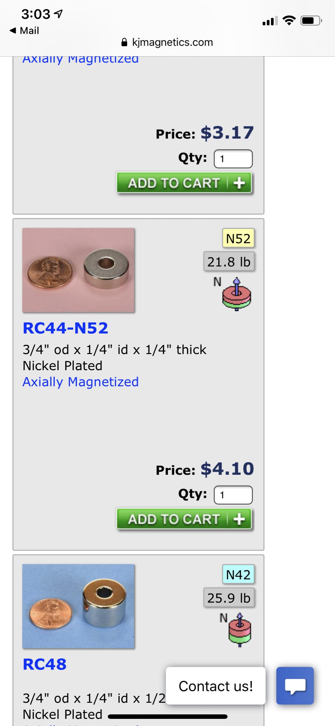

yeah, I'll definitely try this in the near future, i'll have to get a magnet first though, do you know how strong yours is? here they are measured in weight (that they can lift), for example 10kg. I'm assuming the least strong magnet that can still hold the wood is ideal.
Thanks for sharing!
Kjmagnetics.com
Thanks, I found a local equivalent and ordered some.
