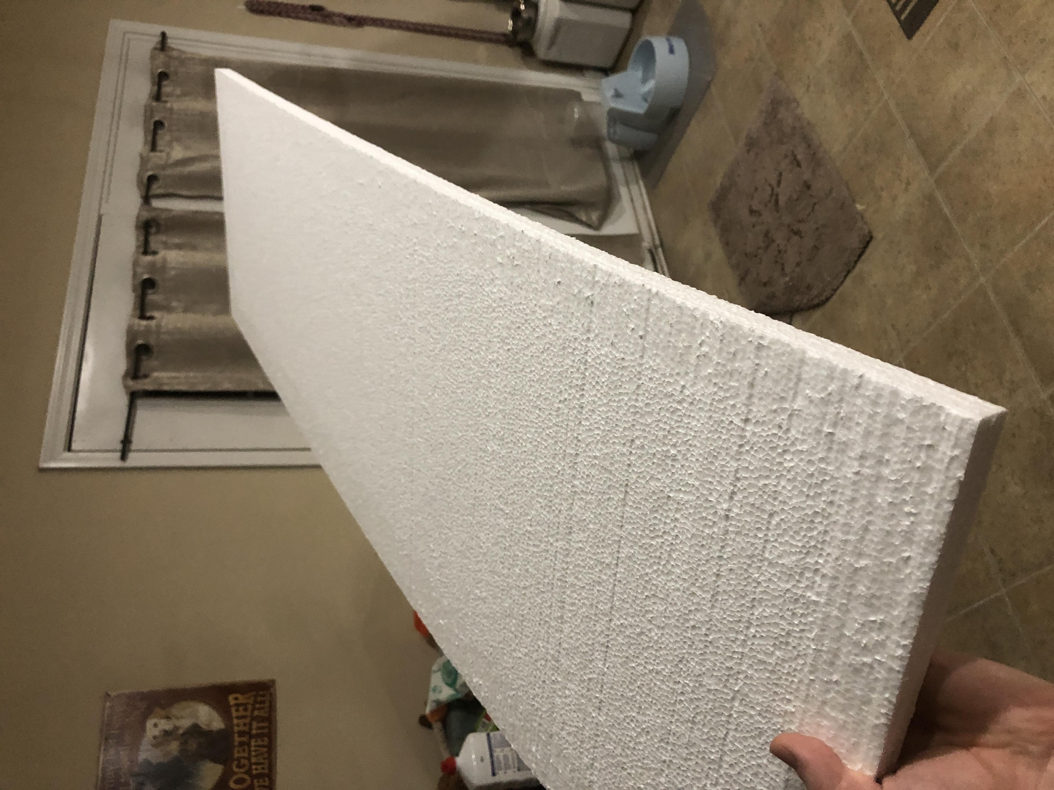

I'm curious too! Expensive is relative, the cheap 10mm is 1.5 euro per panel and the 250 is 5, when sold separately. Bulk is naturally cheaper.
Its cheaper to try out then ply and honeycomb cardboard, and will be good to have as reference.
I would probably get both in 20mm to better compare.

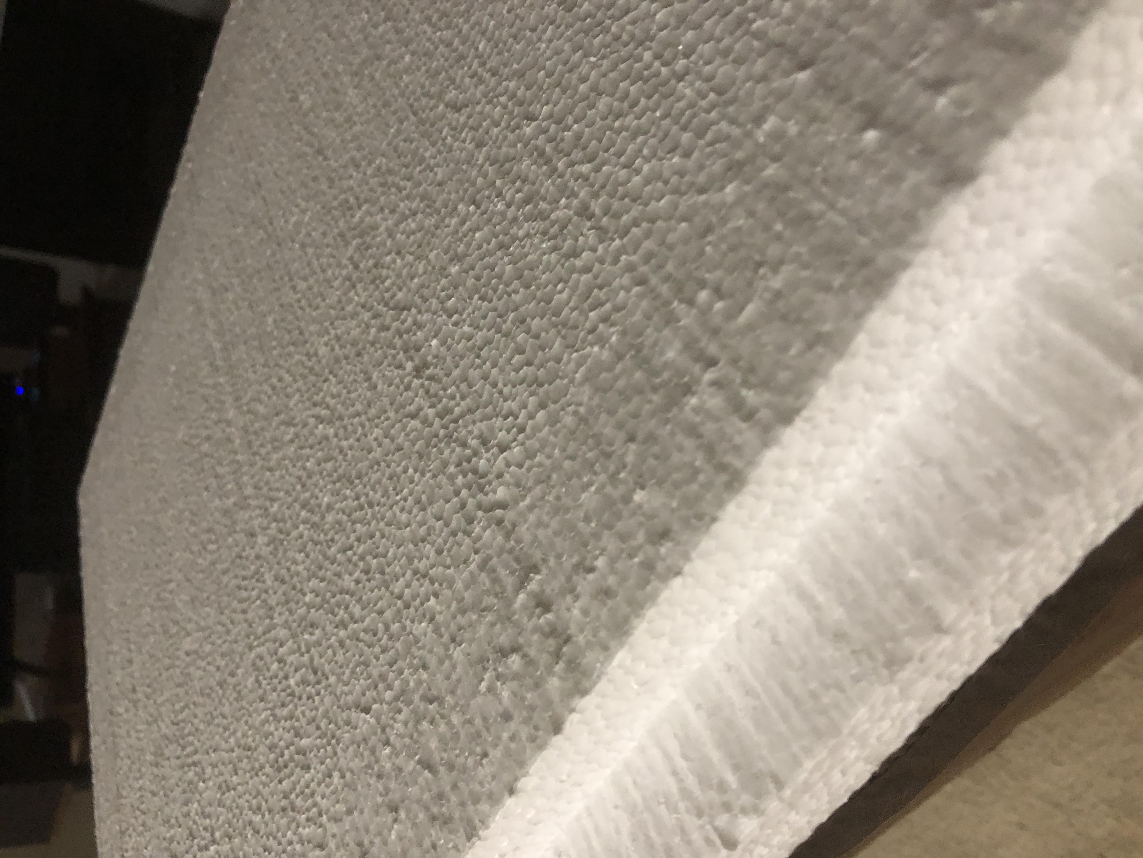

Your eps LOOKS very similar to my original eps panels,the good stuff without holes in the surface,is the surface quite hard ,with a bright sound when scratched with your nails?
This material will go very loud with only a few watts,my 8watt t amp handles this with ease.
The panel looks quite narrow what is the size?
Andreas.
