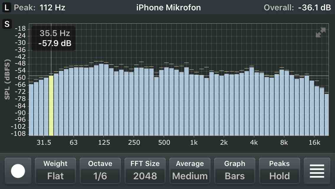

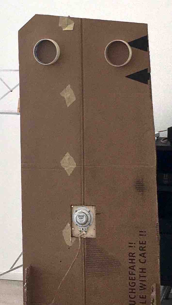

two pictures of the corrugated double layered cardboard speaker.
The exciter is now on a poplar ply of 21 x 30 cm x 3 mm and this is glued on the corrugated cb panel. On the poplar some two dozen holes* of 5 mm drilled around the exciter and on the panel upper corners* there are two left overs of round cardboard (from adhesive tape) glued. *This I made +/- upon Spedge's advice. The sound has now more details and clarity but in this criteria is still far away from the honeycomb panel. For me it is quite good balanced and piano or acoustic bass is better balanced and has some body. The usable frequency band looks now not bad.
Measured from 10 inches away (panel / 20' above floor)
*explanations
probably I'm better to write about my thoughts than leading to a misunderstanding. The feedback of Spedge about some issues of the frequency band measured on my honeycomb panel I've understood, that the issue in high frequency (5.6 kHz) could be solved with a paper (Spedge's technique) and the issue in low frequency could be solved with an AA-battery e.g. at an upper corner of the panel. So I've thought about frequencies, interferences, resonances a.o. To 'decouple' the exciter from interferences and resonances crossing the panel and disturbing the exciter I did the holes in the poplar around the exciter. At the corners I had the same in mind but for simplicity have glued there the round cardboard leftovers. If my thoughts would be right I would not claim. The frequency band on my recent post shows a good result for me.
Eric

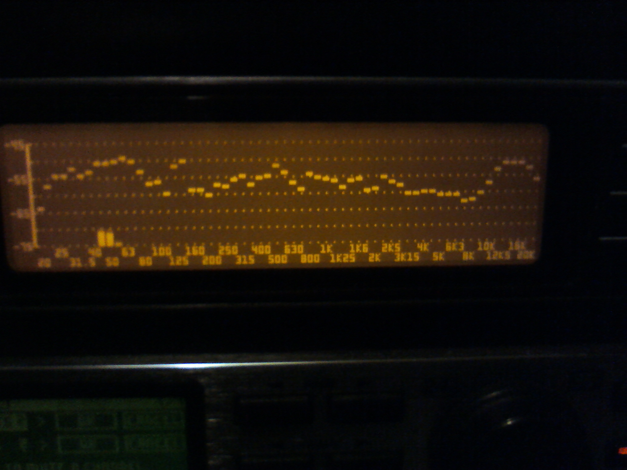

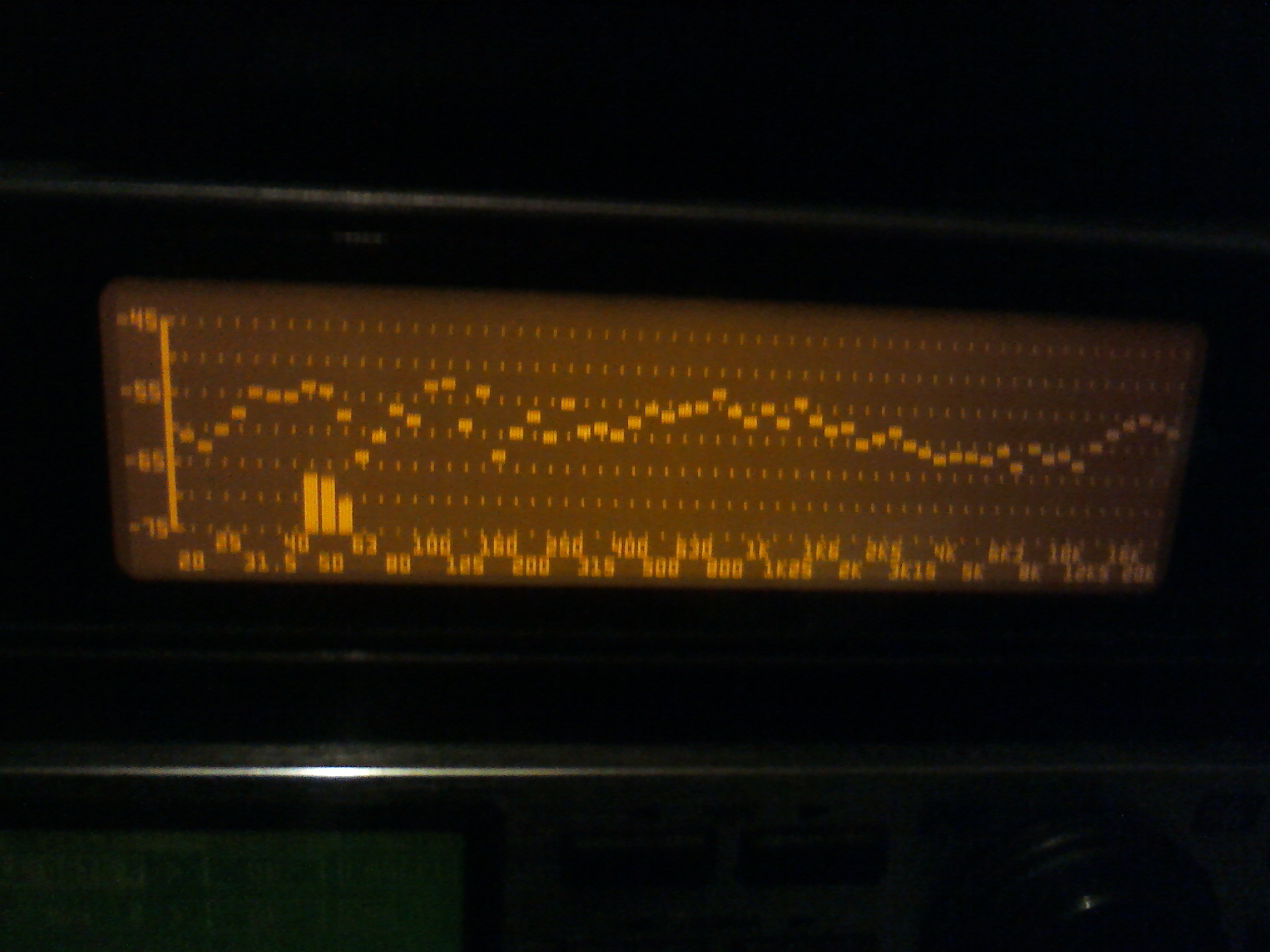

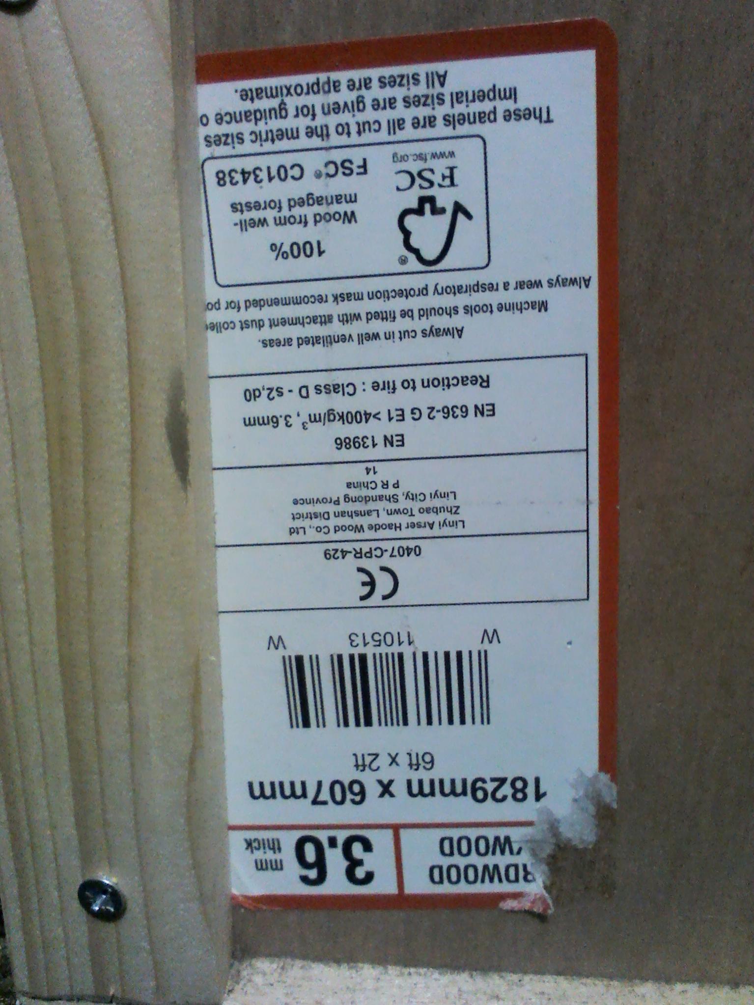

Hi ,the first picture is of the ply panel,the second pic is the 3mm hardboard at about 1m.
The low end goes all the way down to 20hz on both panels ,with the upper peak higher on the hardboard ?
No weights or paper used,just the basic panel.
Might measure the 3x2ft and do a recording ,I can play louder as the panel is glued as well as screwed together solidly.
100ohms.
Can't say I'm not a little confused,it could be the drink I had earlier,you glued a ply panel on the cardboard panel and drilled 5mm holes around the exciter and stuck cardboard rings near the top corners .
It's all part of the learning curve.
Steve
