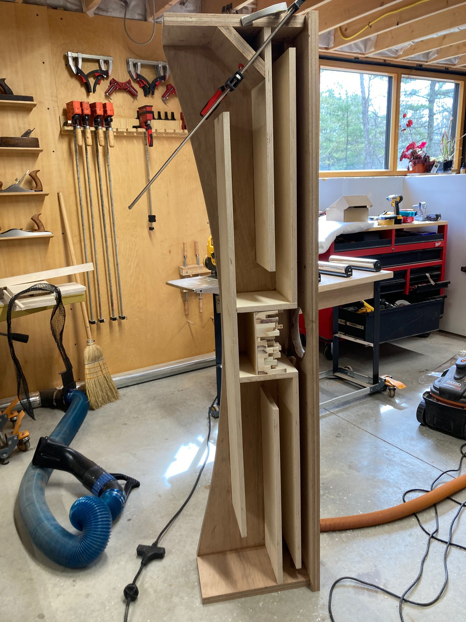

Progress slow and steady.. First cabinet horn baffle complete, now time to start laminating up the enclosure for unit #2... (then demo, tune w/ angel hair if needed, final glue-up, seal edges, wood/pore filler, sand, prime, sand, prime, sand, paint, paint, sand, clear coat and a disturbing amount of wet sanding / polish). ie. much more to do...

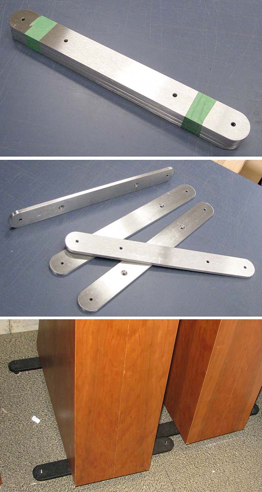

Hi, how would you build the outrigger? Small weels on it would be very detrimental?
It's a way to find a balance between sound and WAF for dust.
Wheels are usually not a good idea. And you do not want to significantly lift thenm off the floor.
I have some nice aluminum bars we had made for FHs, that work well. Points can be installed but typiclly we just add some felt pads.
dave
dave
Particularly on hard surface flooring, I always found the thin Felt-tak style felt pads to work like a charm, and never managed to scratch a floor with them.

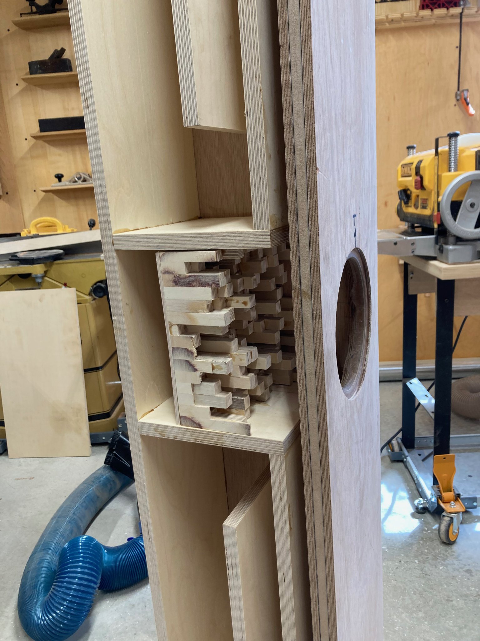

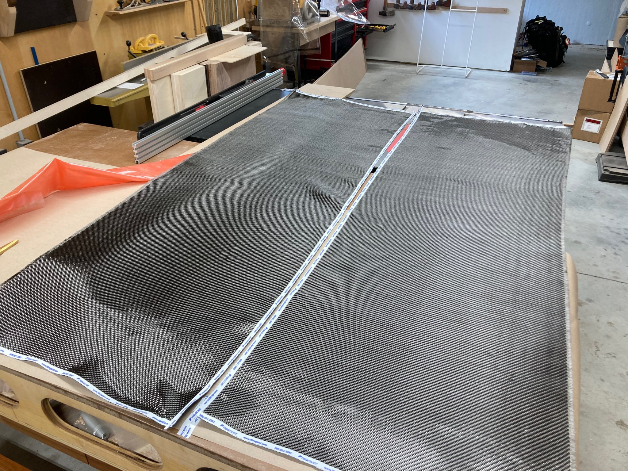

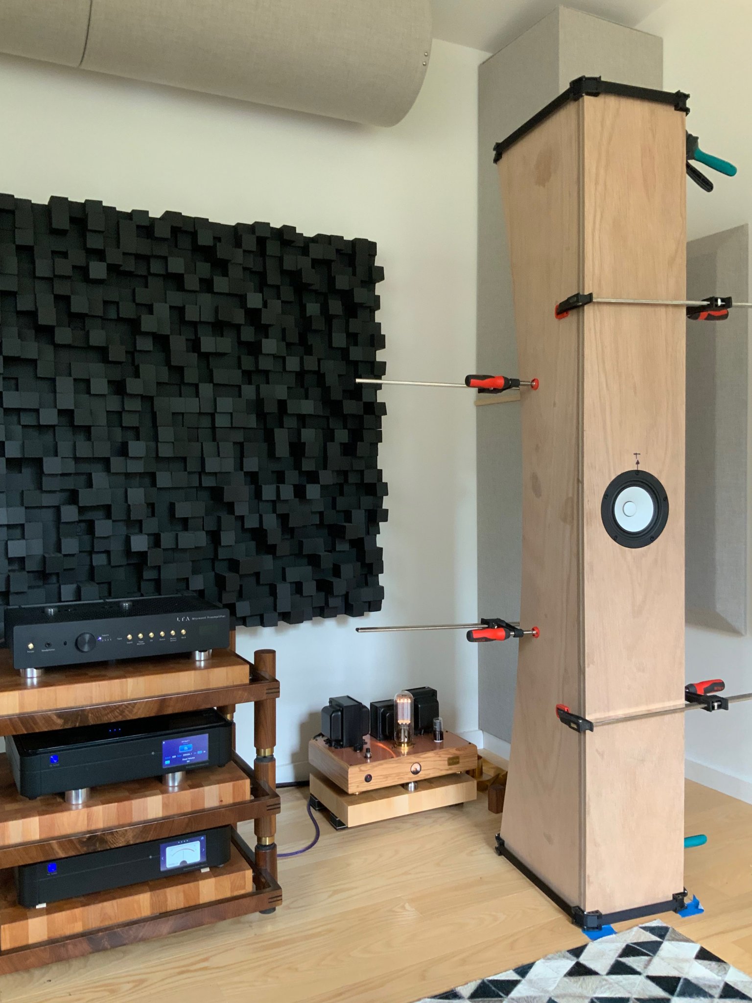

First one complete and clamped up for testing.. These "little" buggers are north of 50kg each once all assembled. Couldn't help but get a sneak peak on sound character, which is not truly fair as its an unbalanced mono source but, "detailed, crisp and large" were the words I initially wrote down. Laying out the carbon fabric for the next panels; now I ""know"" what I'm doing, I hope the 2nd unit will progress smoother and quicker. In light of Yves's comments above, I'm really anxious to get the pair running to compare / contrast my build to his.

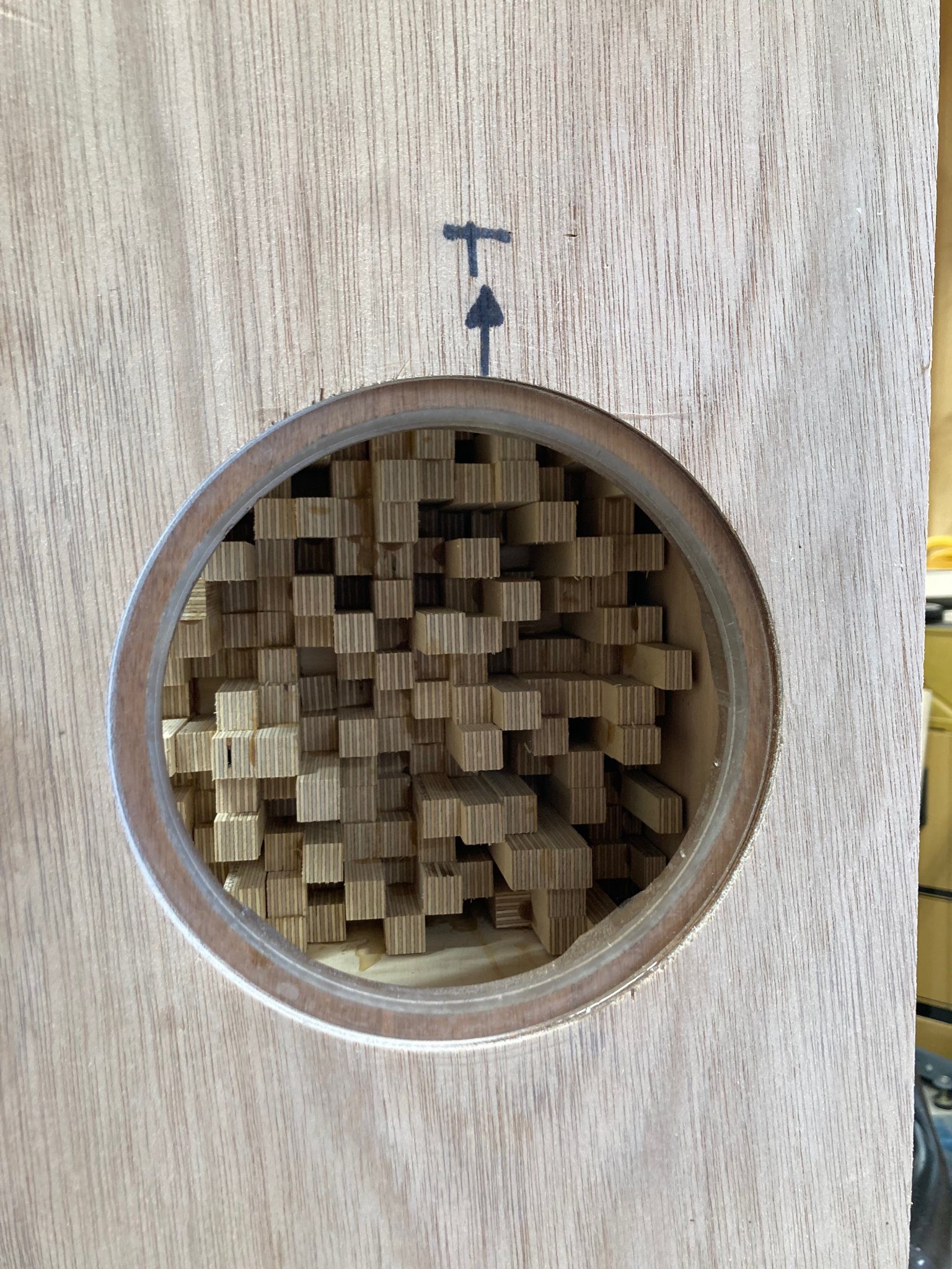

Once I have the pair in place I will experiment w/ angel hair in the last horn, but will be starting my eval w/o stuffing. The only damping in the enclosure is a small amount of 1/2" F-13 felted wool on the side walls of chamber behind the driver to support the diffuser (pictured in previous posts).
