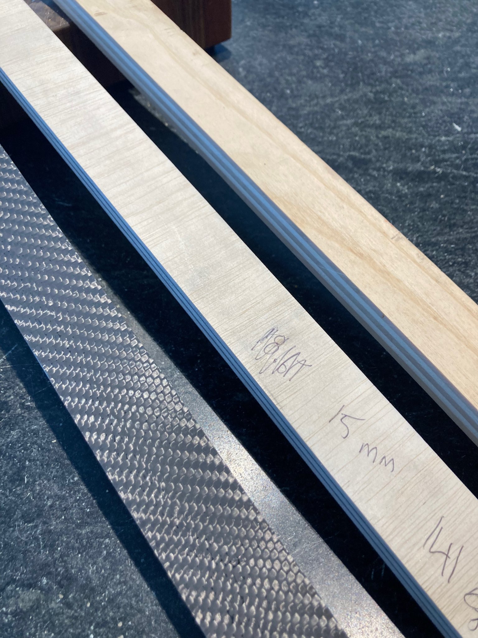

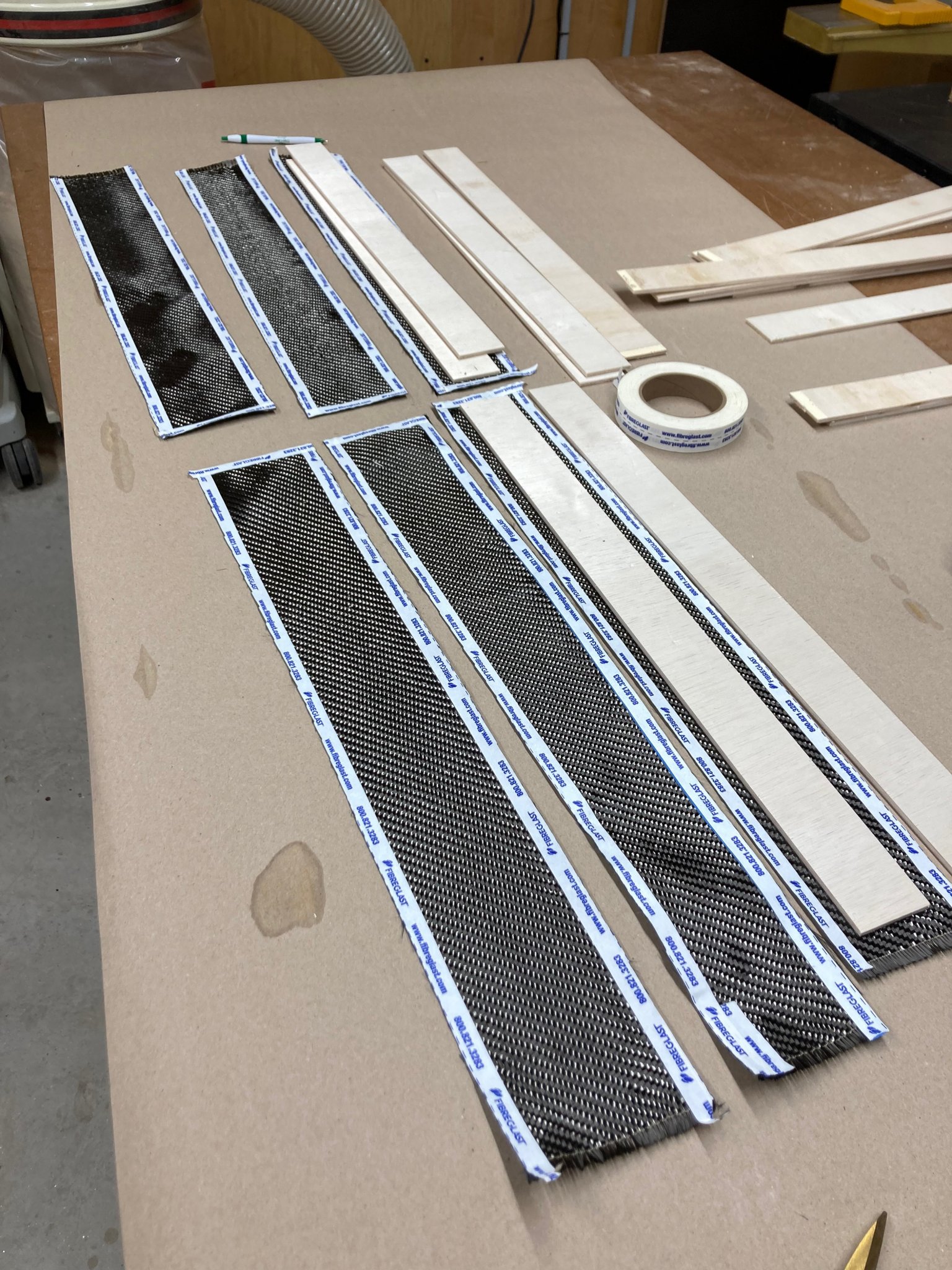

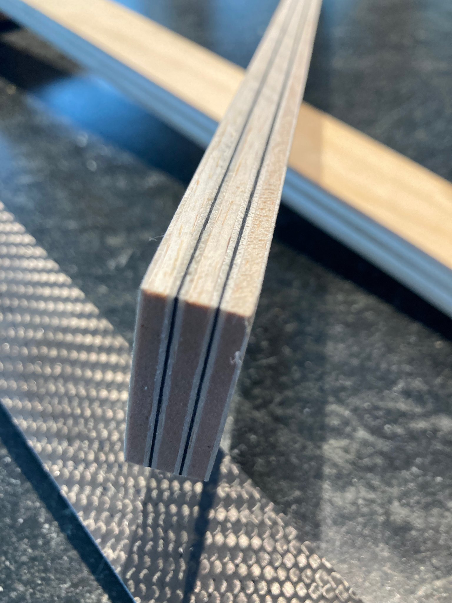

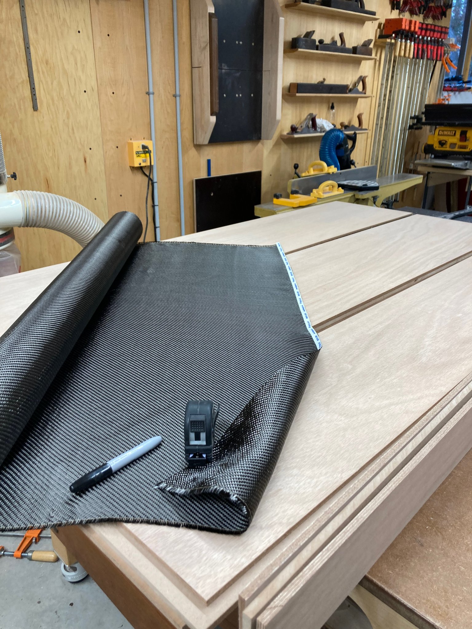

I have officially started my path towards a pair of Silbury enclosures for my Mark Audio MAOP 11's.. Plans ordered and starting my experimentation with materials, in particular carbon fiber reinforced multi-ply laminates for the cabinet and bracing. Using some scrap 5.5mm ply I have tried three constructions.
The [Wood / Carbon / Wood] (not pictured) was not sufficiently stiff, but with only 1 layer of carbon in the center thats not surprising.
The next was [wood / carbon / wood / carbon / wood] which is remarkably stiff (slightly less than full 18mm ply but considerably lighter per unit area and only 15mm in caliper) and the final was [carbon / wood / carbon / wood / carbon] which with only 2 layers of 5.5 mm ply is the lightest and equivalent stiffness to the [W/C/W/C/W] layup but exposed carbon is extremely difficult to get right..
With wood cladding on the outside and inside of the laminate it will make finishing easier and make construction / bracing easier as I can use conventional wood glue. I will try this W/C/W/C/W with 9 mm ply vs 5.5 and blends of 5.5 & 9 to optimize caliper / weight and stiffness. In order to maximize edge / face glue joints I'm leaning towards a tri-ply of 9mm as I worry epoxy saturation of the 5.5 mm core in the laminates will comprise edge wood glue penetration and leave a weak joint.

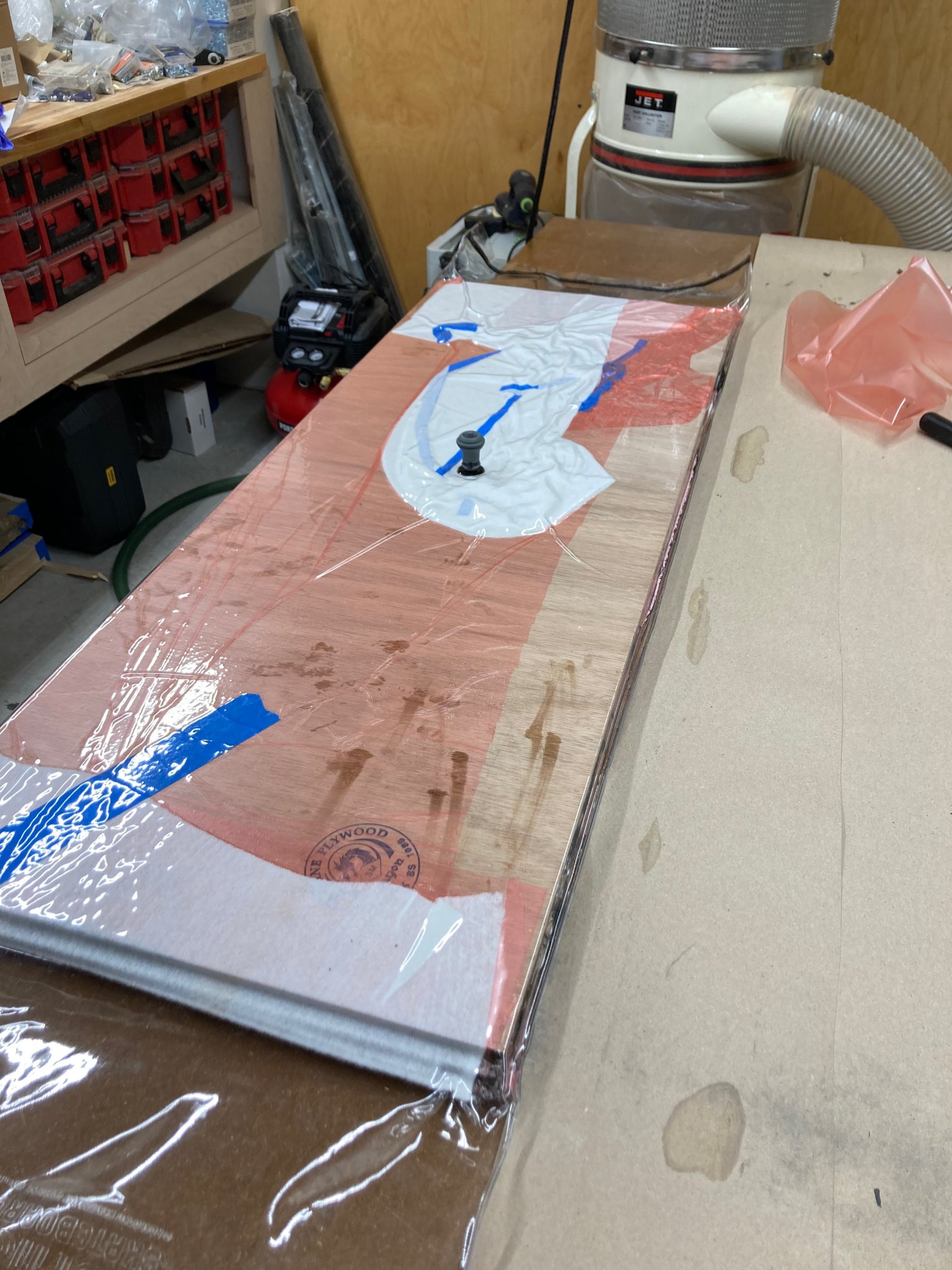

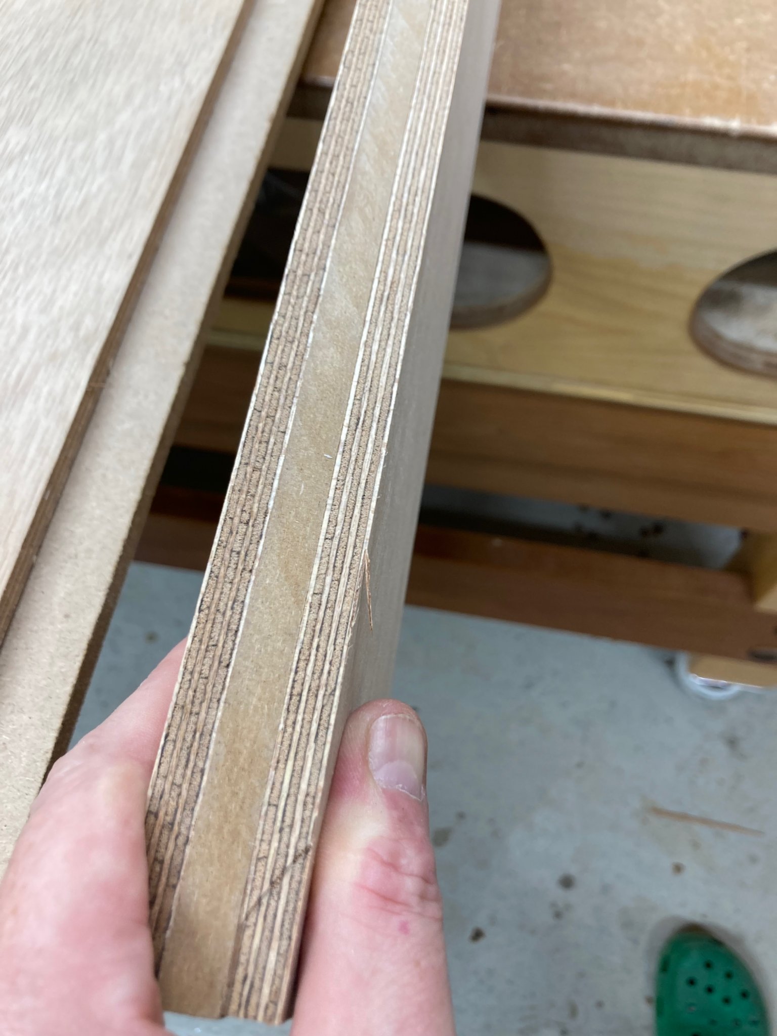

First panels in the vacuum bag!.. Cut the remainder of the panels for enclosure #1. 9 mm Meranti / 9 mm MDF / 9 mm Meranti.. With 18 mm BB ply internals (no carbon lamination) I'm gonna need rigging to move these when complete. Had to order a larger vacuum press (https://www.roarockit.com/tap-bags.html) to fit the 1850 mm panels (oversized to accommodate post lamination trim).. Plus, for those with Saw Stop table saws, dont forget Carbon is conductive and unless you want your project to include a new blade / brake mechanism, make sure you disable the sensor before cutting carbon fiber laminated boards.

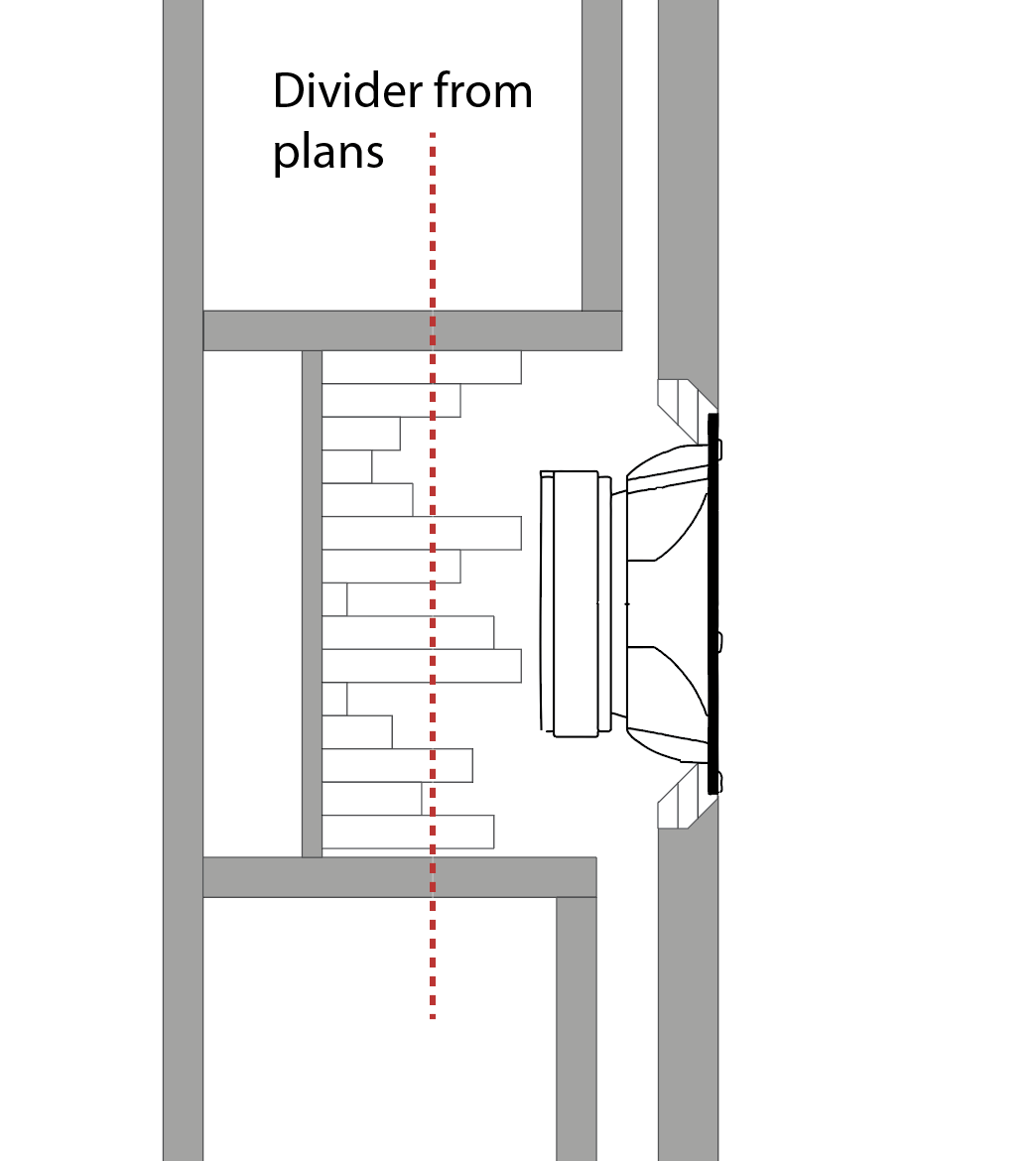

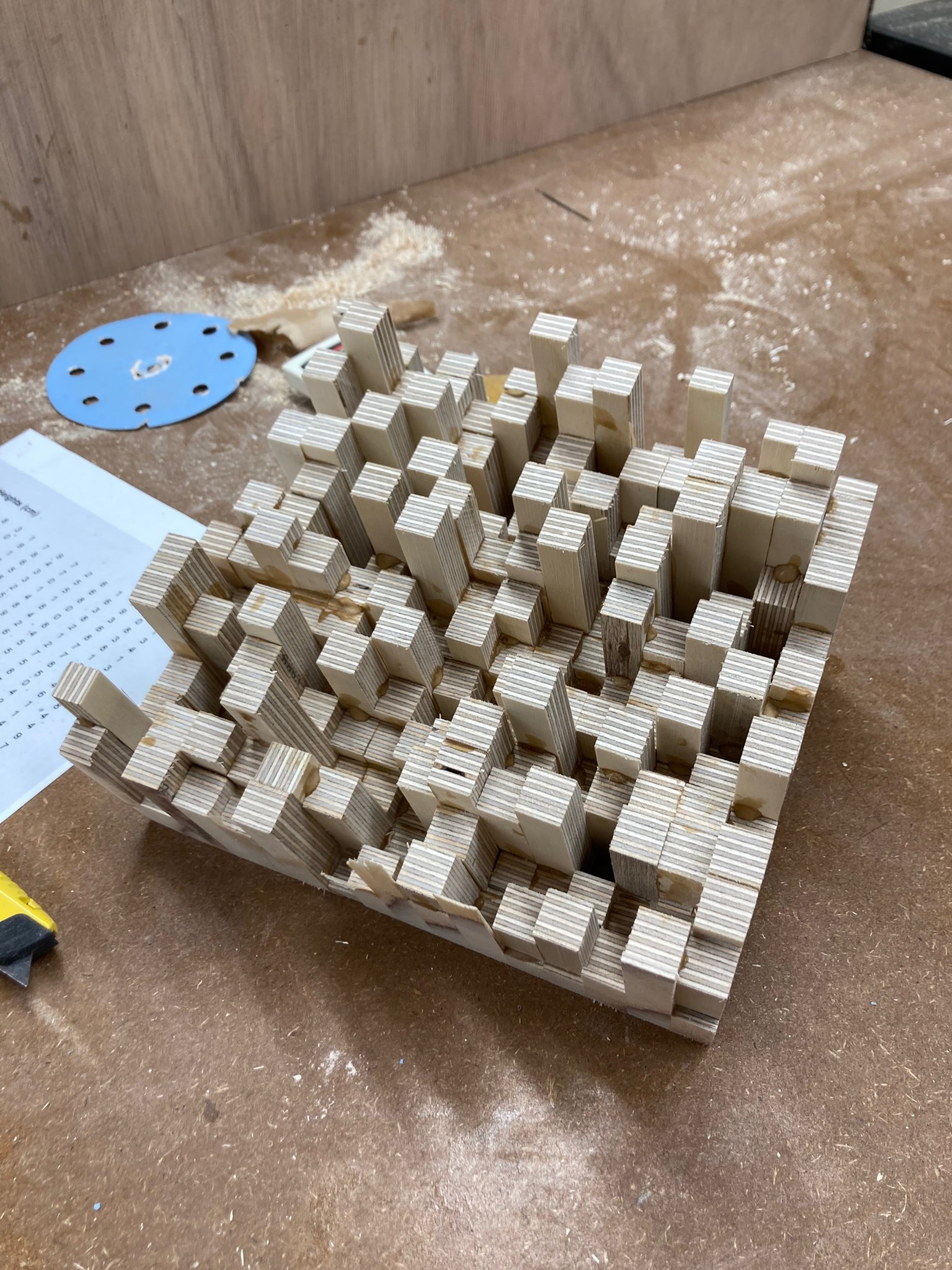

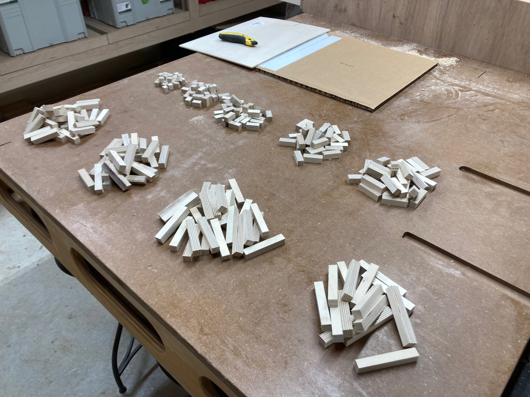

QRD diffuser, prime 241 for behind the driver. (http://actools.tunetown.de/prd/#) great site for diffusion calculations. 229 individual pieces ranging from 10mm to 90 mm. This "should" diffuse from 2k Hz to 13 kHz although I doubt given the proximity to the driver I' get complete diffusion but it will surely disrupt any slap-back off the rear of the cabinet. Will experiment w/ some felt over the diffuser when tuning the cabinet.
Something like the diffusor shown is also useful in the air cavity,
https://www.diyaudio.com/community/...-cavity-pre-chamber-to-the-next-level.195469/
dave
dave
Thanks for the link.. If the volume of the cavity behind the driver is the critical parameter not the point-distance between driver and divider then should my "skyline" type diffuser be placed with the diffuser "mid-line" matching the divider location in the plans such that the resulting cavity volume remains constant?
Yes it is the volume. The average distance needs to remain the same (another way of saying the same).
