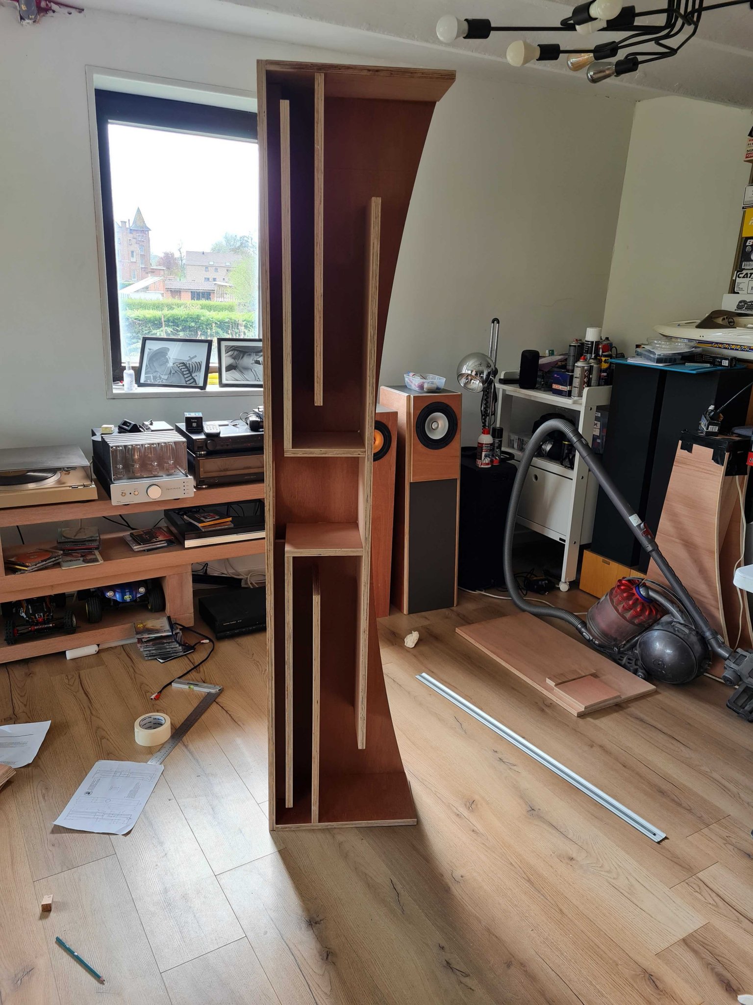

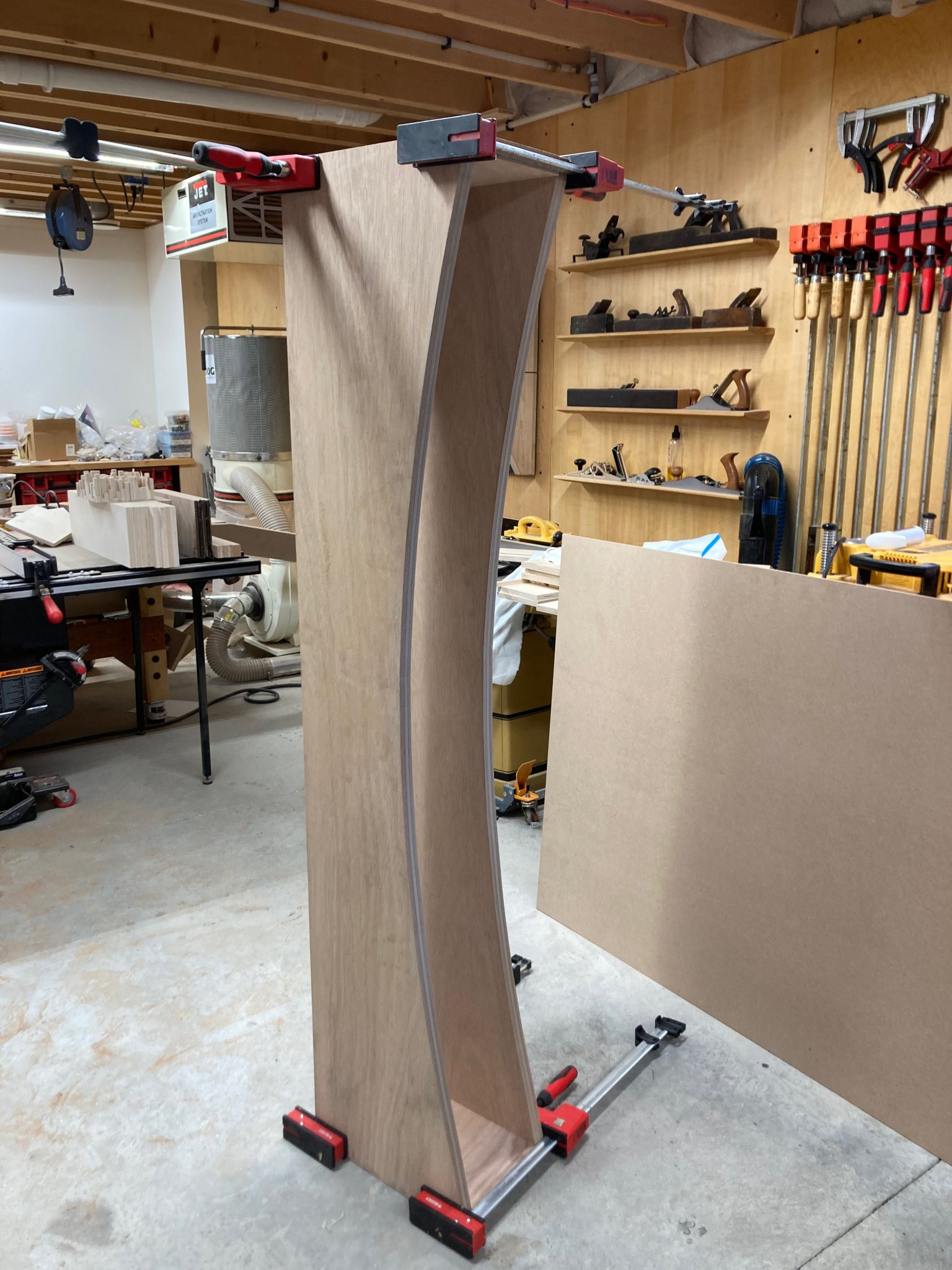

Silbury's beginning to take shape.. The internal baffles are 18mm BB while the external cabinets are a carbon fiber reinforced multilayer glue-up. Heavy is going to be an understatement when these all come together. Will be assembling the internals this weekend and then starting on the external carcass for unit #2.. I was toying with veneering the cabinet sides but such a monolith almost deserves to be a matte grey or white.

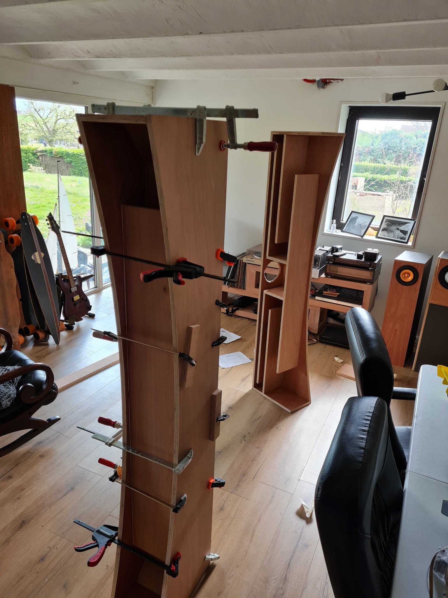

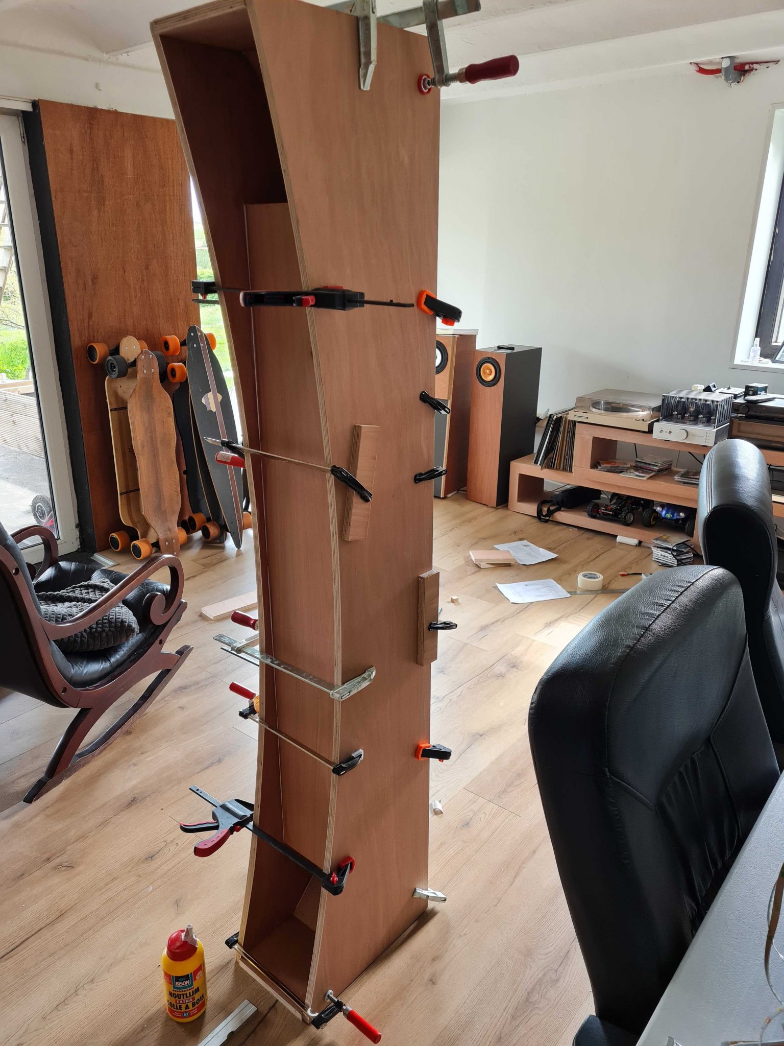

mine underway...started yesterday and still a lot to do...
BTW would you share the .STL file of your diffuser, I would like to 3d print it and I guess this is gonna take some time...I left the rear chamber unglued so I can still add it...

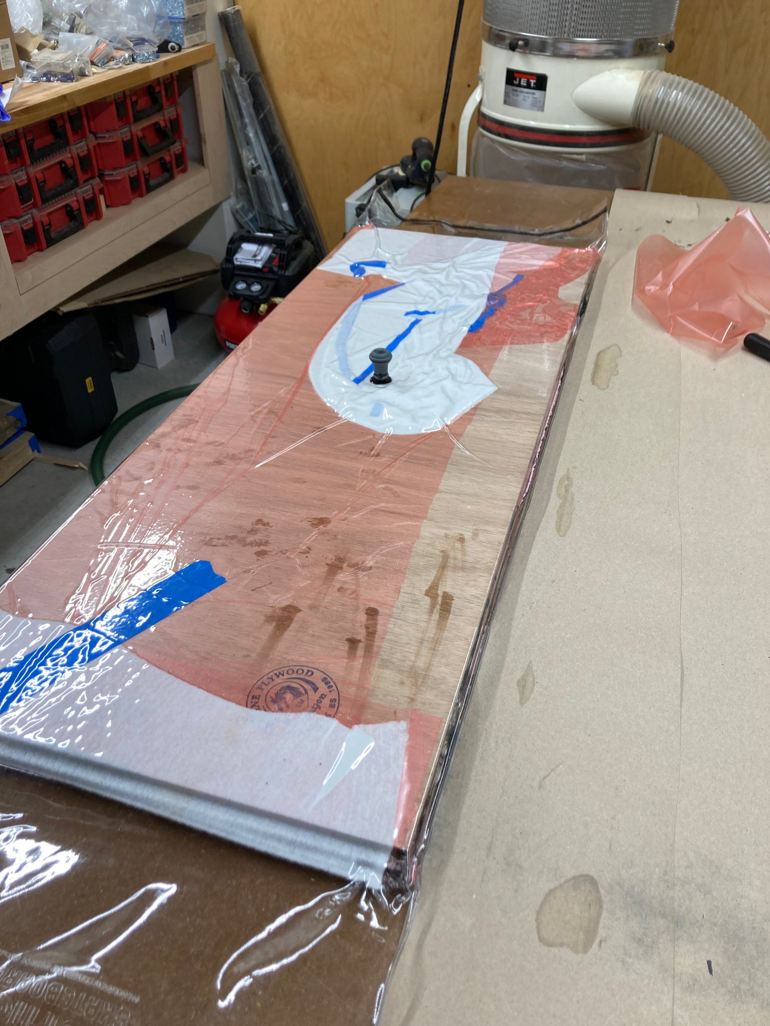

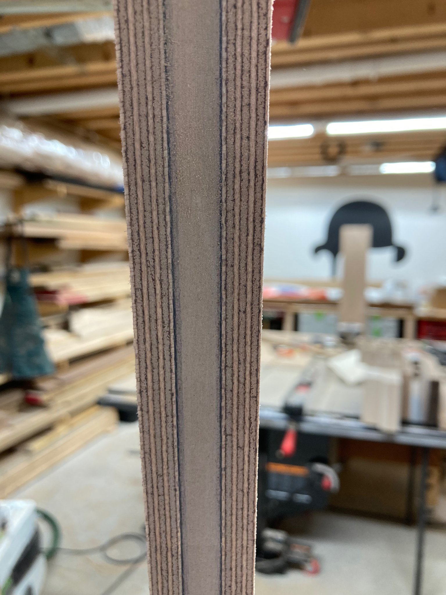

I wet laminated the carbon cloth between the sheet stock. I used System-3 laminating epoxy (slow hardener) primarily as it's slightly higher viscosity than the products from Total-Boat. I notch-troweled it on the wooden surface and then laid down the fabric into the wet epoxy, using a plastic smoothing tool to ensure full saturation of the cloth. Then a second thin layer of epoxy on the cloth and pre-treat the wood with the same epoxy as it (especially the MDF) sucks up so much resin that it would be easy to starve the carbon cloth; repeat for as many layers as you care to build. Finally the completed sandwich was wrapped in non-perf release film to protect my vac bag (https://www.roarockit.com/thin-air-press/) and allowed to cure for 24 hours. In my pre-construction testing a single layer does not impart much strength and 2+ layers were required to add meaningful stiffness. There was an improvement going from 2 layers of cloth (wood / carbon / wood / carbon / wood) to 3 layers (carbon / wood / carbon / wood / carbon / wood) (at the same total laminate caliper) but given the price of carbon cloth (~$70/m) the improvement wasn't meaningful.argoncat, what kind of glue did you use to bond carbon and wood?

I used the great site (http://actools.tunetown.de/prd/) to design the diffuser to get it as close to size as possible. While the site will spit out an STL but I cannot edit them to trim the output size to the cavity and found 3D printing far to expensive to out-source. Thus, I took an afternoon and cut hundreds of small pieces of wood and assembled the diffuser piece by piece following the QRD map generated for the size / frequency / prime # from the site above.mine underway...started yesterday and still a lot to do...

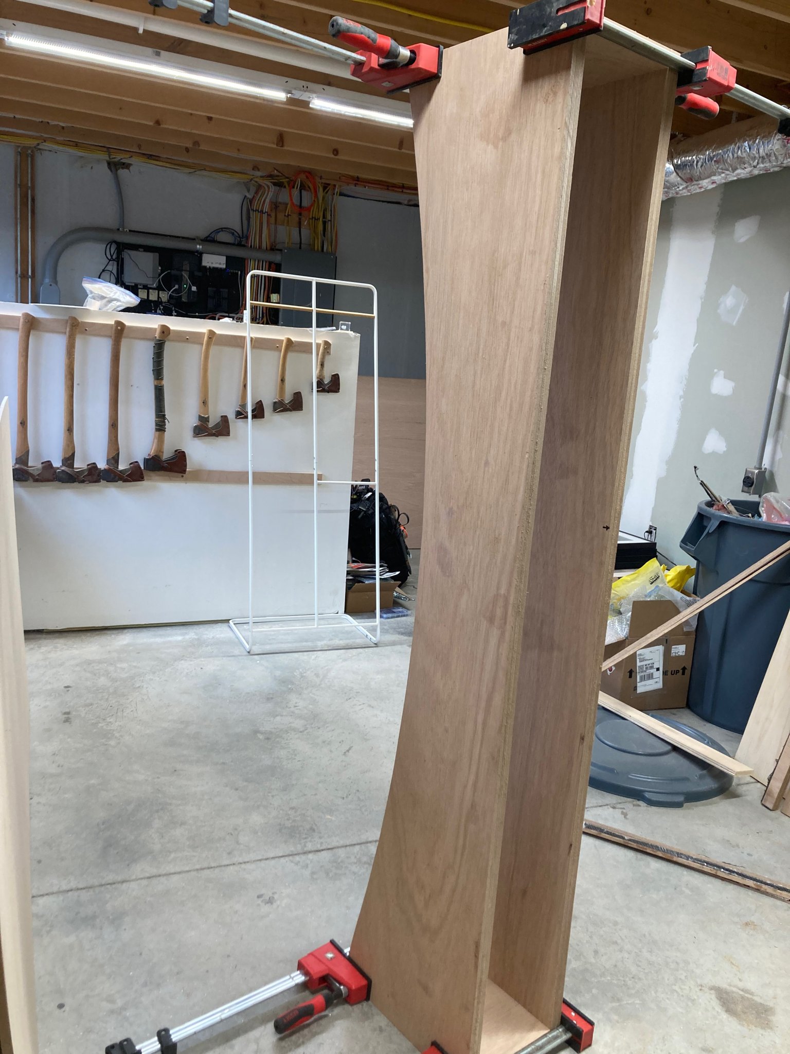

With a known width and arch rise I used a very flexible PVC pipe to trace the curve on 9mm MDF which was then cut on a bandsaw / manually sanded to match the drawn profile. With this as the master template its easy to flush trim rough cut side walls to template profile.Great built!
How did you trace and cut so perfectly the 1,8 meters long curve behind?
