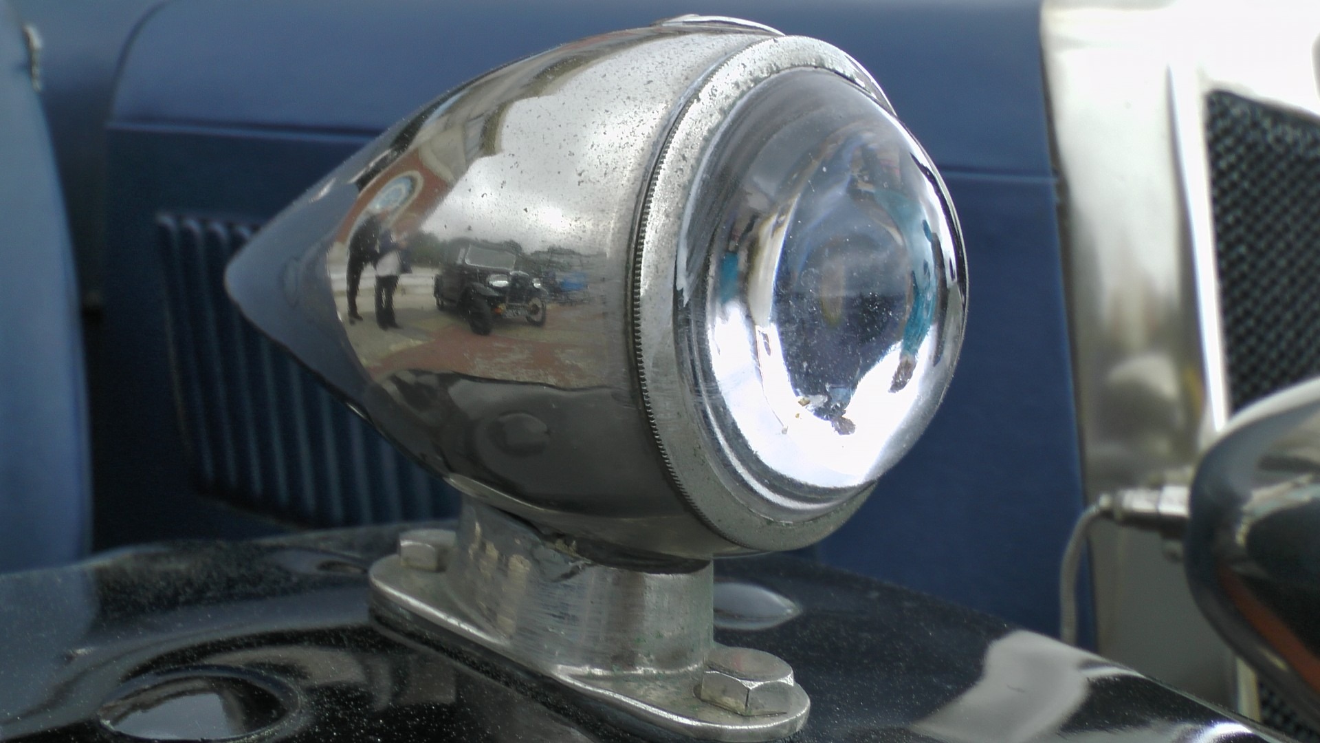

So we could add a 3D printed plastic "old-car lights" shape around the speaker:
I cant give you advice about that. But you can try..So we could add a 3D printed plastic "old-car lights" shape around the speaker:

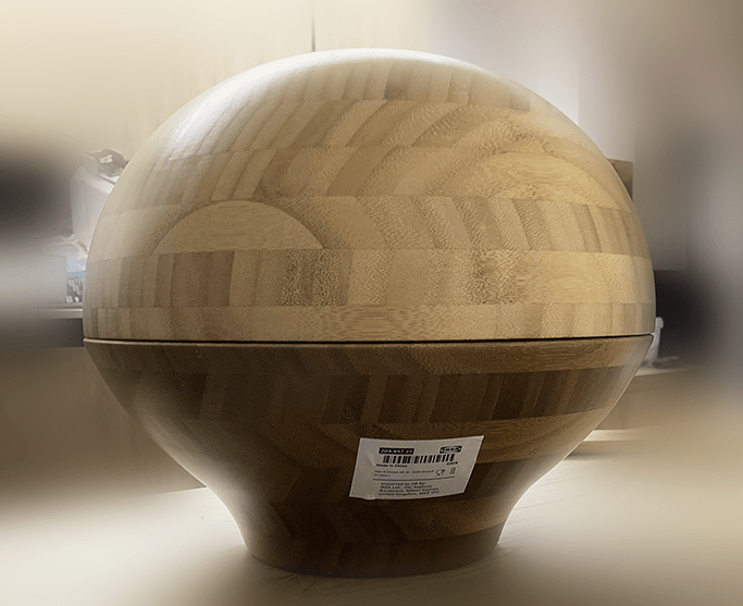

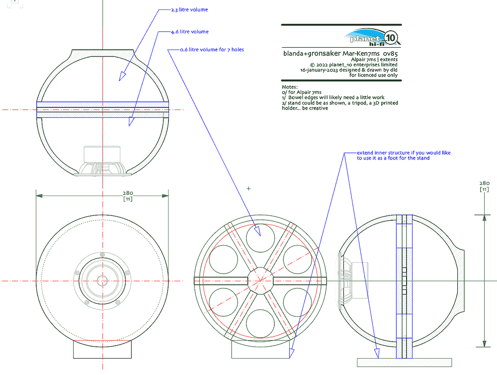

The Blanda Gronsaker is off topic on this thread, but is a speaker David designed for me after I went to the Ikea and saw how nicely these two 280 mm bowls fit tigether:
Fair enough; I can't realy comment on that as it's not my design & it's not my place to do so even if I had the full details.
