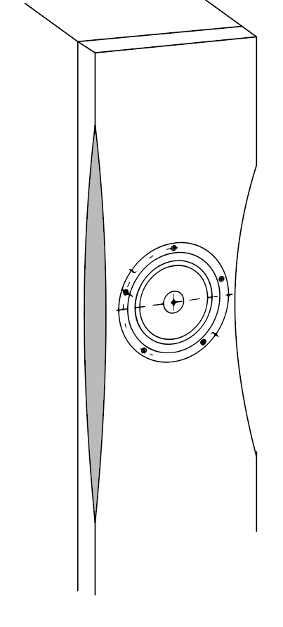

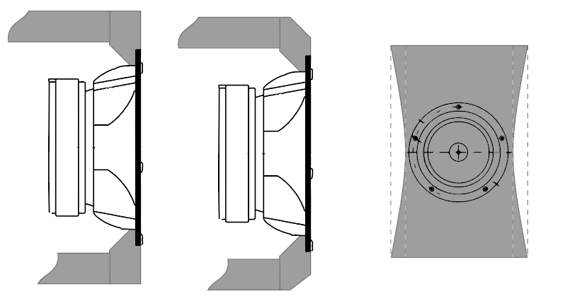

Any specific experience or guidelines on baffle width? Specifically beveling the baffle edges @ 45 to minimize edge-diffraction or in an even more creative form scalping the edges at 45 to narrow the baffle at / around the driver?
I am not sure quite what you are trying to illustrate, but a general rule is to keep the inner walls away from the back of the driver as much as possible.

Yes, I see how that wasn't totally clear. I was thinking of scalloping the front baffle only with a 45 degree router bit and curved-template and not modifying the sidewalls which remain as designed. I have built the baffle at 28mm so there is more than enough mass to "carve into" with compromising glue-up to the side-walls.I am not sure quite what you are trying to illustrate, but a general rule is to keep the inner walls away from the back of the driver as much as possible.

I don’t think that would hurt at all. A full depth ellipoidal supreBaffle would take the same idea further.

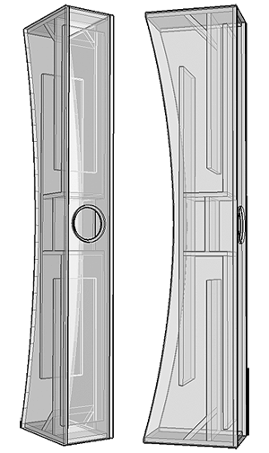

What is the sonic benefit of having two horns "in parallel" like in this design, versus a single one?
You get a loudspeaker with a smaller footprint.

Taller gives improvements because the total area of the horn is double and at the same time the arc behind the loudspeaker is wider?
The horn does not change size, just shape. Mouth is the same, just twice as wide and half as tall.
Imagine cutting the box in half and flipping the top half so that it sits beside the other half and then merge them and tidy up.

Sorry, my post wasn't clear. I meant: if I mirror a second horn in parallel with the first one, on top of the first one, total area of the output of the horn is twice, and the arc behind the loudspeaker is twice as wide. Is this giving a plus to the sound?
Pass. That isn't how they're actually designed (at least, it isn't how I design them -Dave was imply giving you a visual analogy), so assuming you started with a well-optimised horn in the first place, you'll significantly change the loading characteristics by simply mirroring one.
Doubling the width of the horn would need 2 drivers. Similar is done, but vertically with the double Frugel-Horns.
