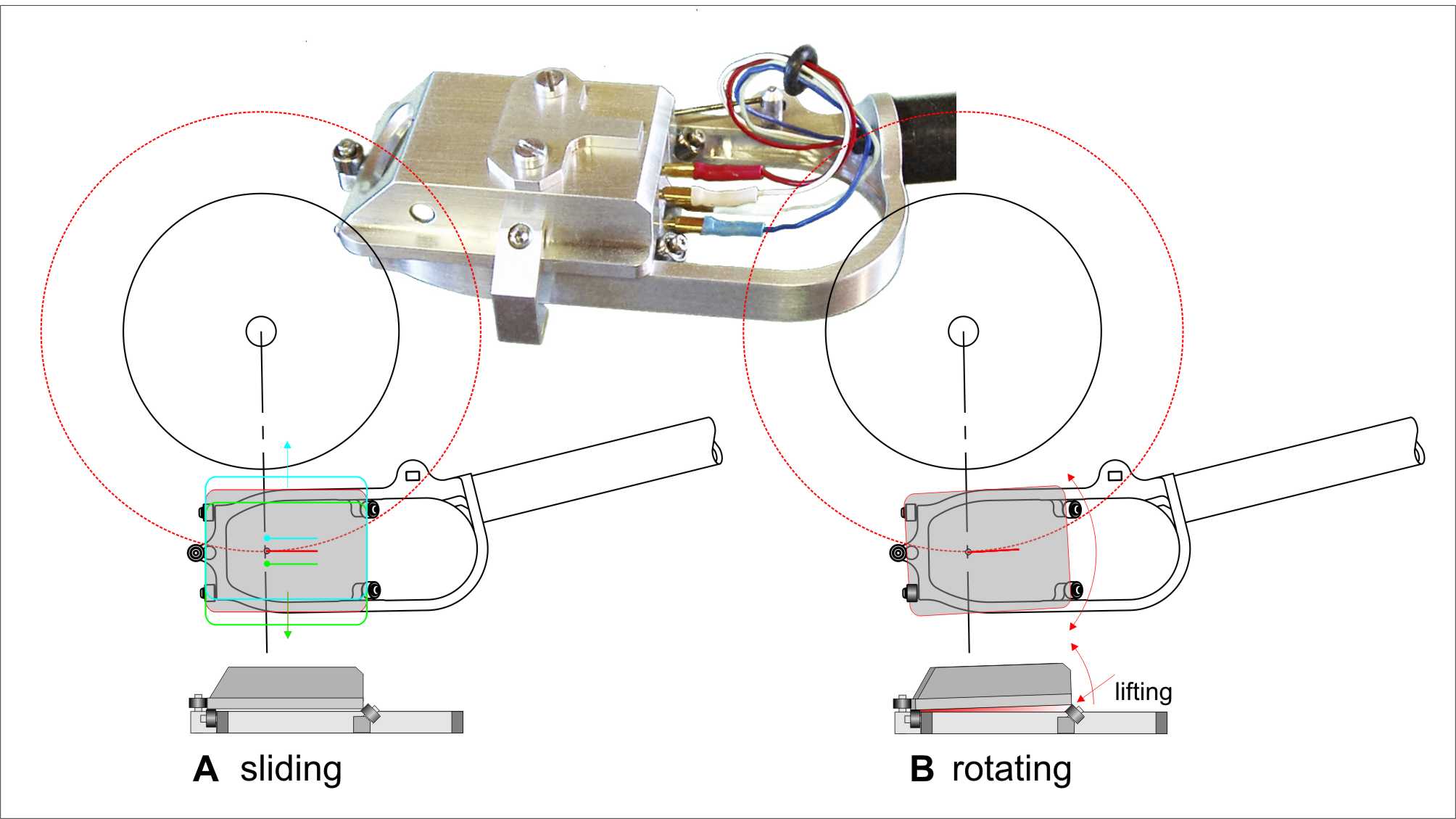

Quote Dd description: better looking (attachement) the floating headshell looks just a sliding headshell.
If it tries (and it does) to rotate it must lift on a corner: the angled bearings is a self leveling system, more than a self centering = a mini parallel linear tonearm upon a separate servo PLT base. But the winning move is the separation between the two.
carlo
Imho a parallel tracker has infinite hor. pivots (well is quite the same as no one). Here the effective length is extremely short, which is a great advantage for passive movements induced by the stylus.
carlo

Excellent sketch Carlo!!
I can now see that, for small horizontal movements, the headshell behaves as a mini purely mechanical parallel linear tracker. This opens the door to even more questions:
How difficult is it to dress the short headshell leads so that they don't restrict the horizontal motion?
Is there enough loading on the cradle bearings to prevent bearing chatter?
How does it behave at the natural resonance frequencies?
Ray K
Confused, yoda is. The drawings show the headshell can slide (forward/back), and tilt. But these motions are locked rigid by retaining screws so the headshell is effectively rigidly fixed to the supporting arm? And there's no lateral motion for the headshell as far as I can see. And the support arm is held rigid to the plinth by servo?Excellent sketch Carlo!!
Ray K
What natural resonant frequency is there, if nothing moves?
LD
That's exactly what I have been trying to convey!

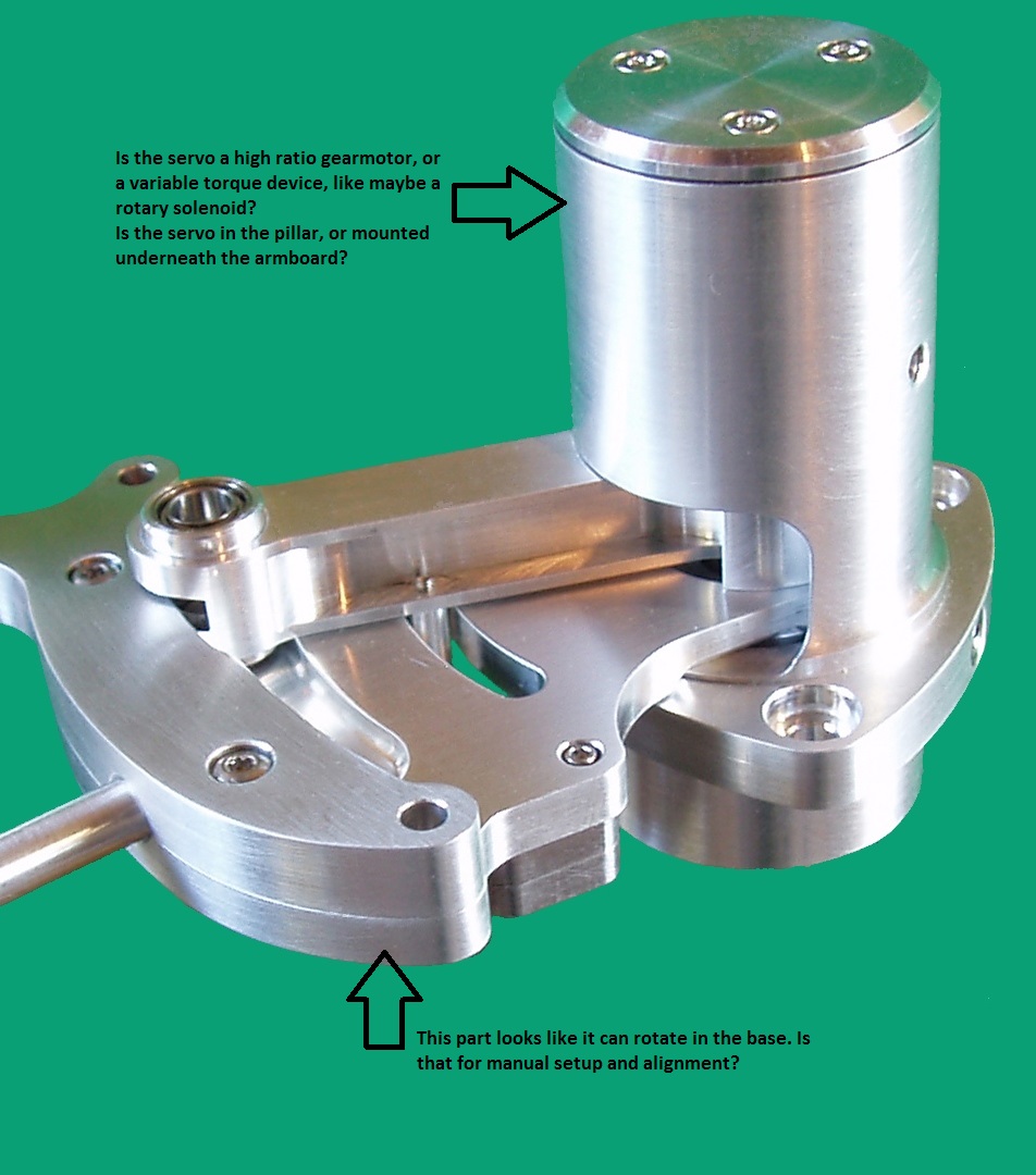

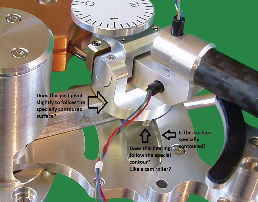

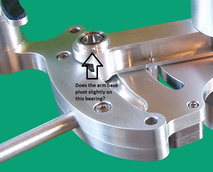

My understanding of the arm is that there's really NO horizontal pivot at all.
There is a horizontal pivot. It is just not visible. The support arm pivots in the VTA tower, and the other end of the support arm contains the horizontal pivot of the tone arm.
If the cradle is, hypothetically, 4 inches wide at a curve, you wouldn't even need a servo.
I considered that idea early during my prototype work, but discarded it because I wanted to maintain the classical appearance of pivoting tone arms. Also that four inch long track would take up a lot of space, trying to pivot it out of the way when changing records.
The servo is not there to correct error like most servo arms. It does not do the usual "crabbing" across record a la Goldmund. The servo is there to extend the runway for the floating headshell and it just so happens that its motorized base move pivotally. As the headshell starts floating in towards the spindle, the cradle eventually runs out of space for the headshell to glide on, therefore the servo tells the motor to pivot inwards. Therefore, the servo is not correcting error, it is to extend the path way. If you don't have a motor, you can nudge the armbase forward every 30 seconds or so and it is indeed what Ralf did at the early stage of the design. And the vertical arm also provides the floating headshell a way to apply tracking force. The arrangement of the 5 ball bearings allows the headshell to glide only in and out of the record center but inhibits it to move forward and backward so it's not totally free "floating". It's more of a gliding headshell. On the horizontal plane, there's no rotational movement or pivoting for the headshell on the cradle. And in Ralf's 2D drawing, it shows no pivot point at the base of the vertical arm.
You got that exactly right, except for the last sentence.
So far that's my understanding of it and I could be completely wrong and/or I'm sure I have missed some details. By the way, I think the design is brilliant.
That's a pretty good analysis all the way around. thank you.
Sincerely,
Ralf
Ralf,
On second thought, information in subsequent posts makes me suspect I had initially made erroneous assumption(s) about how the arm works, and I'm now reaching for my string. Let me play "20 questions". Here are my first few:
Ray K
Hello RAY K,
The answers are yes, yes, yes and yes.
Sincerely,
Ralf

Thanks for the clarification, Ralf. When I said "NO" horizontal pivot in capital letter was meant to be hyperbolic. My point still stand is that the two pivot points are tied to the servo system so it does not move passively like a Birch style arm. The fixed pivot at the VTA tower AND the now clarified, existing pivot underneath the vertical arm base, work in tandem with the active servo to position the cradle to allow the headshell to "float" and track tangentially. Think of the whole assembly as a positioning robotic arm to allow linear tracking. The headshell is the real tonearm!
Just by eye, the segments don't converge to a single point so the geometry is unlikely a Thales semi-circle. Hey, as long as all the plotting points are tangential to the spindle, who cares!
I'm glad you didn't use a 4 inch cradle as that would look really weird. Glad you preserve the aesthetic of classical pivot tonearms: one of life's pleasures is dropping the needle with a fingerlift on a turntable.... and I have steady hands. Perhaps you can add that as a final touch? 😉
Thanks again, Carlo, for your graphic skill of providing the excellent pictures.
Putting the word separation in bold is an excellent observation. In fact it is the single most important and ingenious part of the whole design. I have never thought of applying VTF this way and preserving the VTA of a long arm but tracking tangentially with the mass of a headshell! Wicked!!
