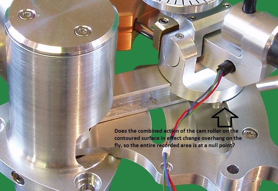

Hm you make me confused again. My question is more if the tangent of the reocrd movement at the stylus point aka friction vector is 180 degrees compared to the line/vector describing the stylus point to the tonearm fixing point (aka the pivot in a traditional arm). In a tradtional linear tracking arm it is 180 degrees, always, but never so in pivoted arms.
Thanks Ralf. Yes, for the stylus to see no skate force relies on the headshell effectively being rigidly connected to the plinth. Achieved via servo. There's still skate torgue in the support arm, but it's resolved at the connection with the plinth, not at the stylus end.Hello luckythedog,
That's exactly right. Good show!
Sincerely,
Ralf
However, it's still not clear to me how the arm copes with eccentricity of the record/centering etc?
If that's by servo allowing free movement of the support arm at very low frequencies, such as 0.55Hz eccentricity, then I think skate torque mechanics will be like a normal offset pivoted arm and the stylus will see more or less normal skate force at least the DC and lf part of it which is the most part.
If that's by servo tracking eccentricity forces and moving the arm accordingly, then how does it tell the difference between skate force and eccentricity force? They both apply a force which tries to move the arm at low frequency/DC, which on the face of it can't be told apart?
Or does the servo apply a fixed anti-skate torque, as per normal mechanisms?
Could you explain please, Ralf ? Thx

Hello luckythedog,
That gets a little tricky to answer, but I'll do my best.
When I first designed my tone arm, I allowed ±.090 inches of motion of the head-shell upon the cradle. I correctly assumed that, that would be enough to allow the cradle to keep up with the head-shell without the head-shell bumping into the cradle. The servo amplifier can be designed in one of two ways: Its gain may be set to provide a large degree of gain, or it can be set to operate on the sluggish side. When gain is set high, the tone arm will follow the head-shell in and out when tracking an eccentric LP., and when gain is on the sluggish side, the inertia of the tone arm prevents the tone arm/cradle from following the outward excursion of the head-shell when tracking an eccentric LP. Someone with the proper test instruments will have to figure out, which of the two conditions above produces the best sound.
The servo amplifier does one thing only, it keeps the head-shell and the cradle from colliding with each other. The controlling force of the servo amplifier is NOT constant. It varies with the vinyl composition and the frequency and level content of the particular LP being played.
One other thing I wanted to explain is that, the "inside force" that every tone arm with an off-set head-shell experiences is not synonymous with skating! Skating occurs when the "inside force" is not properly compensated. So, while my tone arm is subject to the "inside force" it cannot skate!
I have been wanting to make a video of my tone arm for weeks now, but keep getting interrupted. A few days ago my wife's computer crashed and guess who got elected to fix it. But next week I'll get to it or else.
If I haven't addressed something, let me know.
Sincerely,
Ralf

My tone arm tracks tangentially all the way to within ~.080" of the label. It stops there and cannot move further. If the tone arm were to continue on the same path, the stylus would precisely intersect the turn table center line.

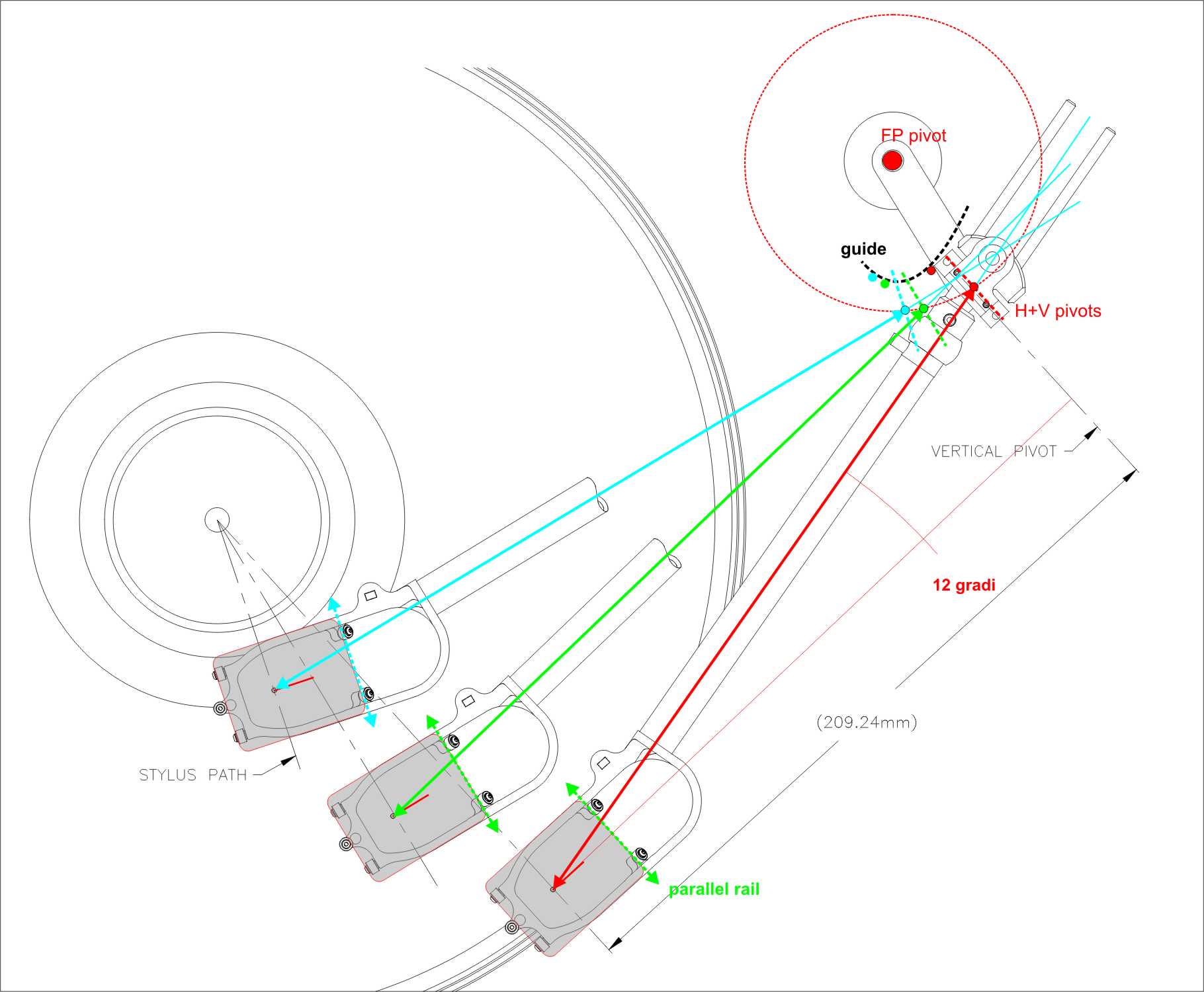

This arm is so full of small and big ideas, skills and experience that it is amusing and instructive trying to understand something. Long time ago one of my teachers said that words are no good design tools so here is a graph for the "strange offset" problem (attachment)
Imho:
- the mini parallel arm (then the stylus) has no offset = 0 tracking error, 0 skating, almost 0 stylus bending (far less than his big brothers, due the shortest possible eff. lenght)
- the servo PLT has 10°- 12 ° offset (half of a Baerwald) and an horizontal pivot angled the same, like a Rega. As the offset generates side force (skating = side force less the friction on hor. pivot) maybe here just a bit is used to facilitate the rotation. All these solicitations are dealt and held inside the servo PLT.
- H + V pivots follow a circle in FP - the guide pivot a curvilinear cam: similar to the LT, and others called "non Birch" in my simulations on Dd thread.
True? who knows, this arm is so devious...

strange offset - errata corrige
Further investigating I discovered that it is not (only) a problem of side-force: it is more a problem of geometry, innovative and advantageous.
I do not post these new graphs, maybe I have already exaggerated with "reverse engineering" and I apologize to Ralf: there are already too many copycats around.

Hello Carlo,
Thank you, and there is no need to apologize.
I should have a video ready later in the week.
