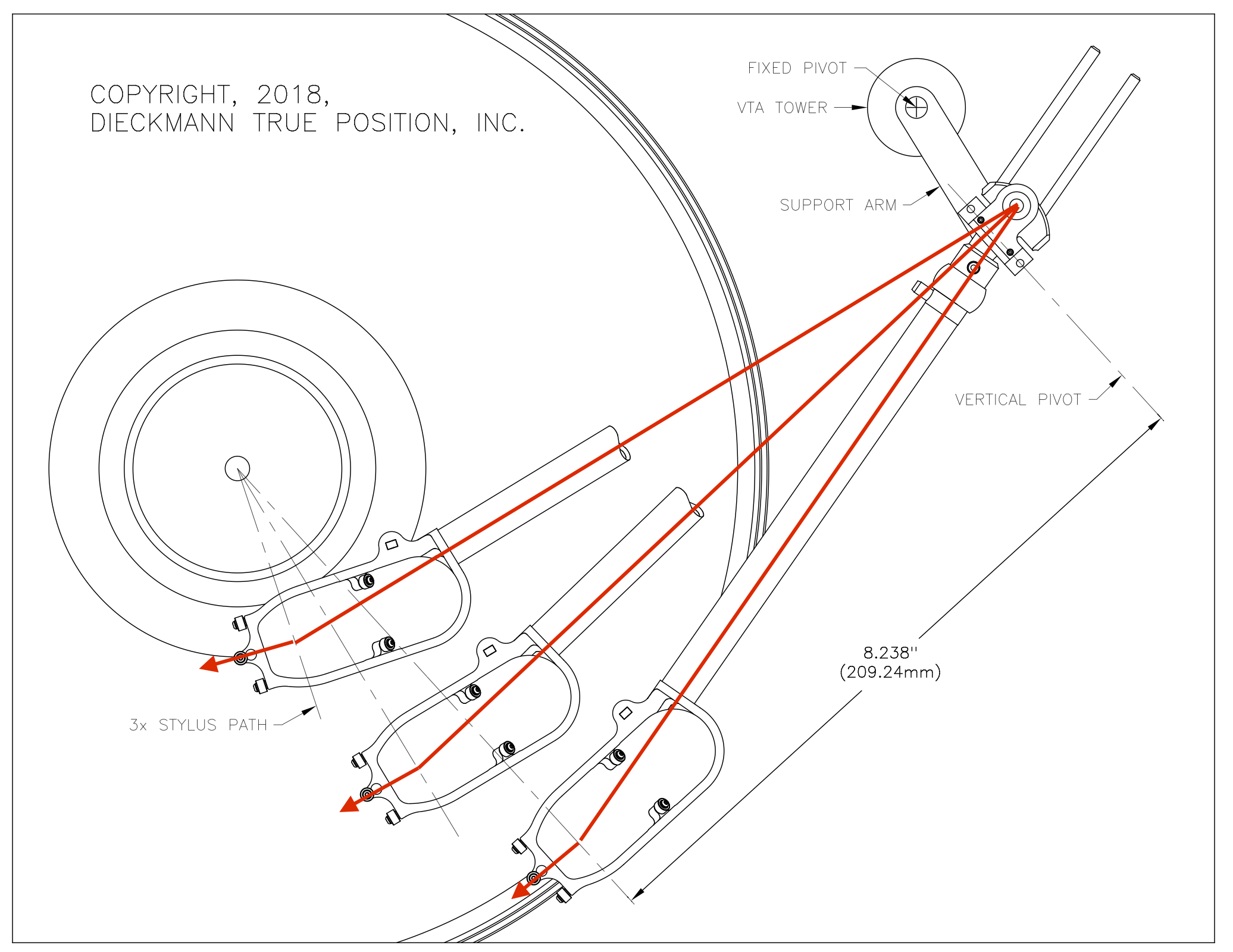

Hello Carlo,
please look at the CAD drawing I have attached, while reading the following:
The CAD drawing shows the tone arm/cradle assembly by itself in the start, mid and end positions. Ignore, for the time being, the head-shell, the sensor and the servo control. The tone arm can only move in the vertical and horizontal planes. The latter motion is governed by a simple control mechanism hidden in the base of the tone arm. In the CAD drawing you will see three "stylus path lines", drawn at right angles to the cradle and intersecting the turn table spindle. The control mechanism mentioned above, insures that the stylus path lines CANNOT deviate from intersecting the turn-table spindle from start to finish!
If we now set the head-shell on top of the cradle, and lower the tone arm onto the LP, the drag force moves the head-shell forward against the cradle, which, by virtue of its offset, is forced toward the center of the LP. Under the above conditions, the inward bound cradle would strike the head-shell if it were not for the servo. The servo applies just enough reverse force to the cradle to keep it centered under the head-shell. If the servo applied a constant reverse force, it would not work because the frictional drag varies constantly. And that is where the sensor comes in. It senses the variations of the drag and causes the servo to apply just the right degree of reverse force.
It is important to understand, that this servo controlled tone arm does not exhibit the so-called servo error that all traditional servo tone arms have.
I think I have answered at least some of your questions above.
About the two angled bearings: They prevent any "lost motion" between the head-shell and the cradle. There are no loose bearings, they are all preloaded.

  • TONE_ARM_CRADLE_2D_ASSY.pdf

Your arm gets more intriguing with each new post. Thanks for the drawing. So, if I understand right, you're using skating as a controlling factor. That's not just clever, it's devious. :D

I am not sure that this arm doesn't have skating force. From stylus point to main pivot, it always forms an angle, so, skating force exists. If the servo applies a force to counter skating force, it only mean the arm has almost perfect level of anti skating force. In other words, it has active anti-skating. However, skating does exist.
Hello super 10018,
you are partially correct. As everyone knows, skating is the tendency of the stylus to climb the 45 degree groove wall of the right hand stereo channel that can damage the vinyl and/or the stylus/cantilever assembbly and is to be avoided. My tone arm does no such thing! Although my tone arm experiences an inside force, that force does not translate into stylus skating because the head-shell is not constrained laterally by the tone arm.
While the inside force in pivoting tone arms is undesirable, it is highly desirable in my tone arm design.

Many thanks, Ralf, for the extensive answers and helpful drawing.
Now that's my idea on how this arm works: probably wrong, and you will certainly snigger of my ingenuity. But this is Diy Audio, and here we try to understand, even at the risk to show our stupidity.
Suppose we have a floating headshell, to be aligned tangentially with the groove. (that's why we try to build these damn PLTs). We must therefore have a line: that is, two points, not one. The first is certainly the contact of the tip with the groove, the second must be the point of application of the force = the pivot on which the headshell rotates.
Was said that, being floating, there is no - real or virtual - pivot, (no offset pivot = no skating) but in this case the headshell would be free to rotate 360 ​​° (at least with a conical tip). So this constraint must exist, and everything suggests that it must be along the axis that controls the drag. So not really floating, maybe rotating + sliding.
Till now I could not see a real difference with a normal Birch, a Non-Birch - or even a Thales.
But this arm is not simply mechanic, with continous feedback between the chain of parts, here we have a servo. Used not just to move the arm, as everyone one may think, but to act as an unidirectional "valve": the arm A knows well where is the headshell, and where it must be positioned - the headshell B instead feels alone in the world, and - due the stylus drag - rotates the only way it can, moving along the cradle. And the cradle can be found always where it must be, tangent to the groove. Better, angled the little bit necessary to get a resultant side force near to 0.

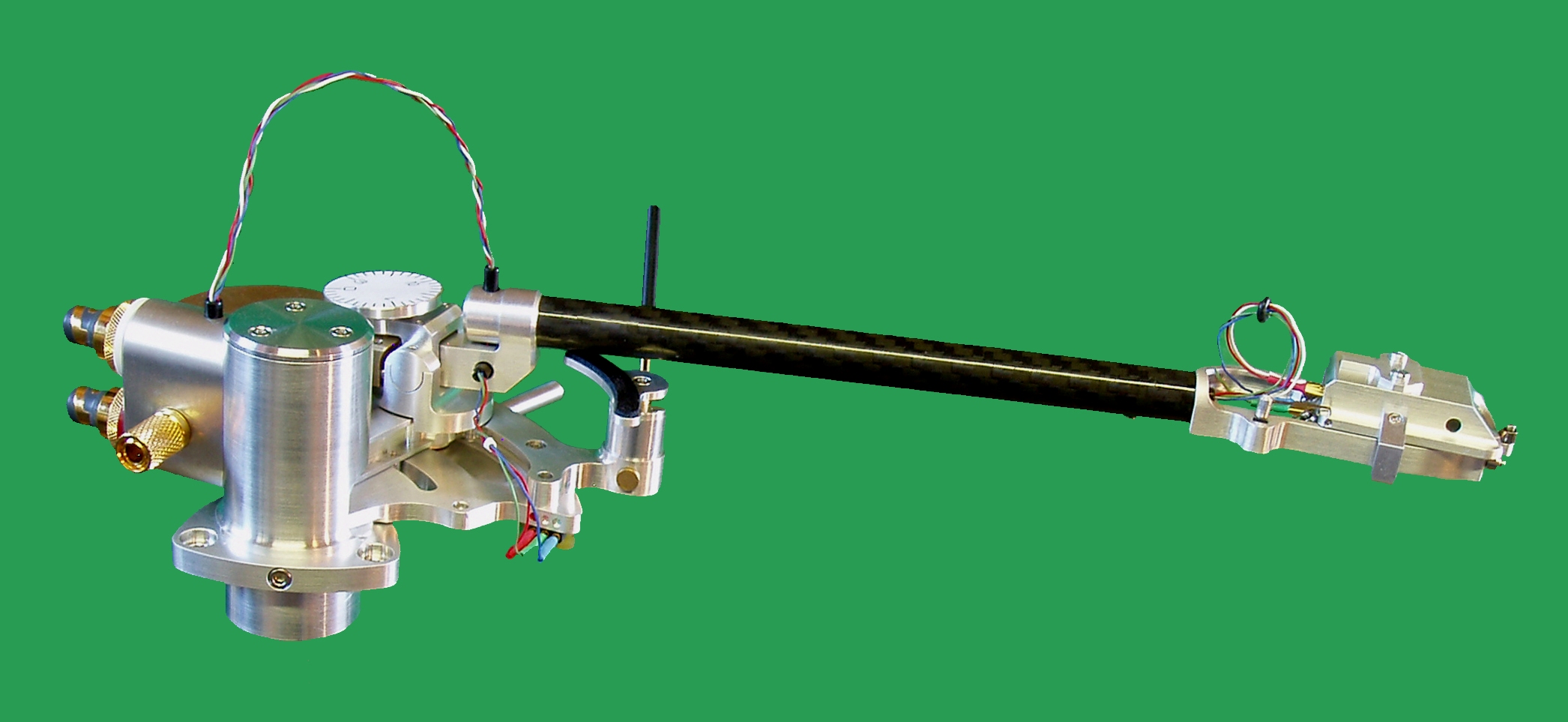

"I have been listening with my tone arm for months now and it functions flawlessly.
Glad for your result: only real arms can dispel theoretical doubts
Last question: the servo acts on the fixed pivot, or both?

Dear ralf, see my pic based on you CAD. Hope it helps to understand what I wonder about.

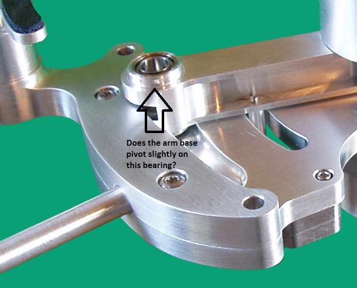

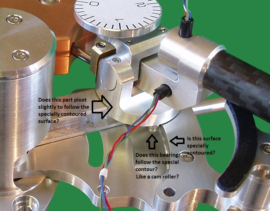

observations
My understanding of the arm is that there's really NO horizontal pivot at all. The arm and cradle are acting like a "holder" on a path for the floating headshell. The arm LOOKS like a pivot arm but it does not pivot horizontally during play. There's no passive horizontal pivoting. The servo is there to provide a longer path for the headshell to track tangentially into the spindle. If the cradle is, hypothetically, 4 inches wide at a curve, you wouldn't even need a servo. The servo is not there to correct error like most servo arms. It does not do the usual "crabbing" across record a la Goldmund. The servo is there to extend the runway for the floating headshell and it just so happens that its motorized base move pivotally. As the headshell starts floating in towards the spindle, the cradle eventually runs out of space for the headshell to glide on, therefore the servo tells the motor to pivot inwards. Therefore, the servo is not correcting error, it is to extend the path way. If you don't have a motor, you can nudge the armbase forward every 30 seconds or so and it is indeed what Ralf did at the early stage of the design. And the vertical arm also provides the floating headshell a way to apply tracking force. The arrangement of the 5 ball bearings allows the headshell to glide only in and out of the record center but inhibits it to move forward and backward so it's not totally free "floating". It's more of a gliding headshell. On the horizontal plane, there's no rotational movement or pivoting for the headshell on the cradle. And in Ralf's 2D drawing, it shows no pivot point at the base of the vertical arm. I think if the arm is reconfigured as a parallel tracker, the design would be easier to grasp.
So far that's my understanding of it and I could be completely wrong and/or I'm sure I have missed some details. By the way, I think the design is brilliant.
These two pictures show that the vertical arm is inhibited from pivoting horizontally.
705391d1537746754-revolutionary-pivoting-tangential-tone-arm-9_tone_arm_base_left_hand_view-jpg
705386d1537746754-revolutionary-pivoting-tangential-tone-arm-4_left_hand_view-jpg
709905d1539807449-revolutionary-pivoting-tangential-tone-arm-tone_arm_cradle_2d_assy-png
In your picture, the converging point is NOT a pivot. There isn't any.
If there is, it would be very very small and it's not passive and it would be active and tied into the servo system.
I see how it works. It will indeed not skate. It will pass my "string test". Well done.
Ray K

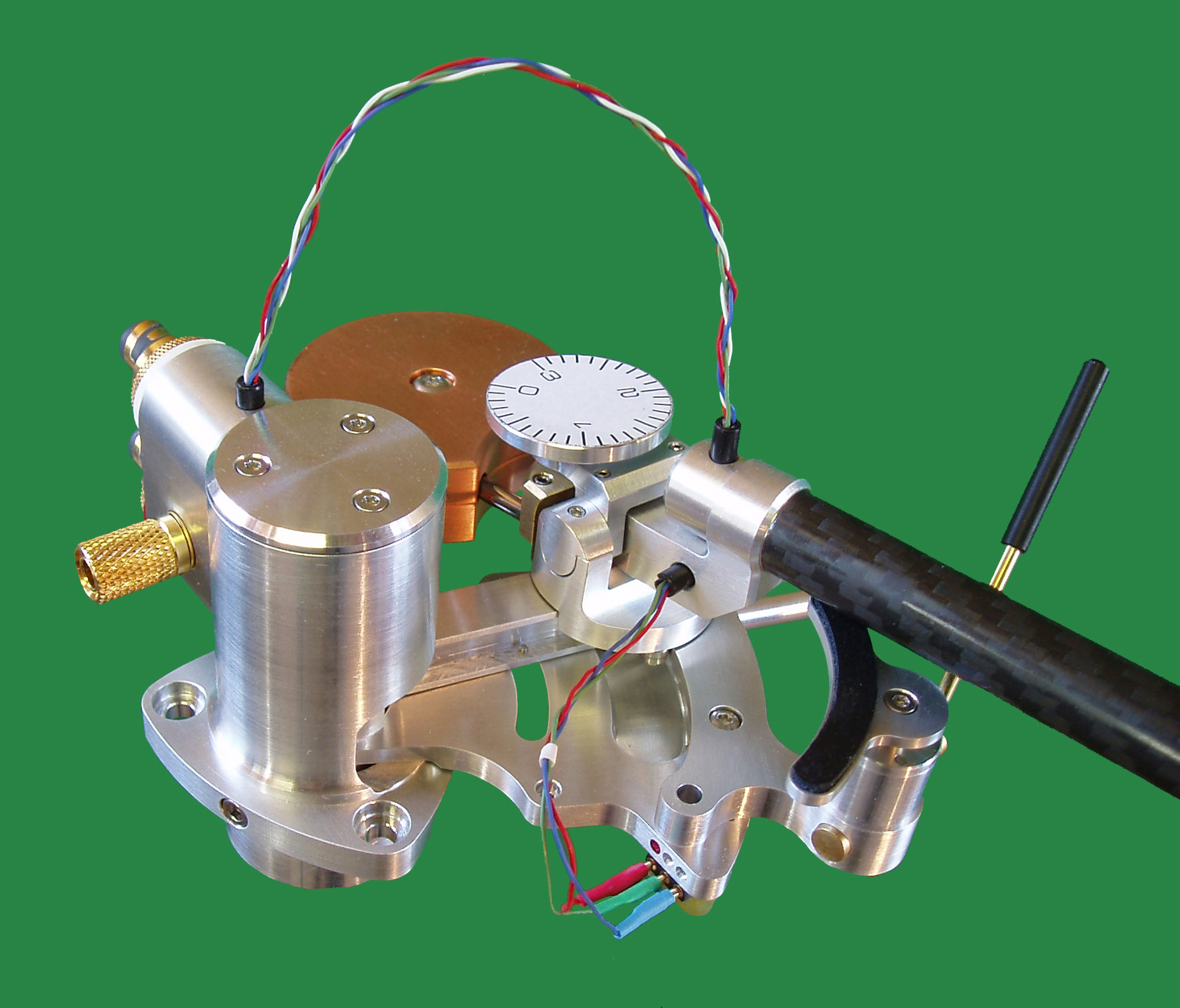

Ralf,
On second thought, information in subsequent posts makes me suspect I had initially made erroneous assumption(s) about how the arm works, and I'm now reaching for my string. Let me play "20 questions". Here are my first few:
attachment.php
attachment.php
Ray K
