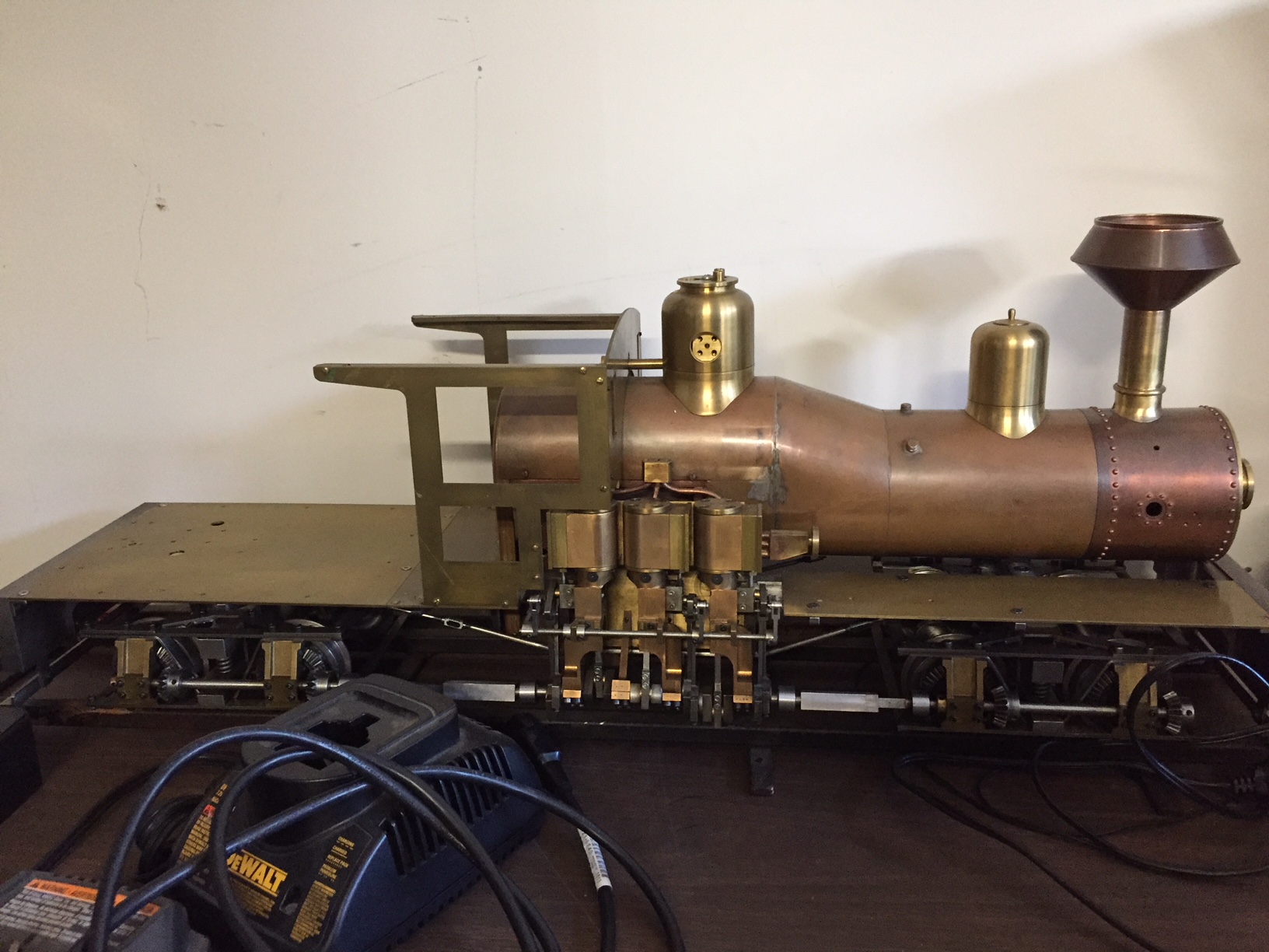

Attached is a photo of the 3/4" scale live steam Shay Locomotive I'm building. The only parts I did not machine are the gears, although I did modify them to fit. The parts that were machined were modeled in SolidWorks and a tool path created in MasterCAM.
Duke
