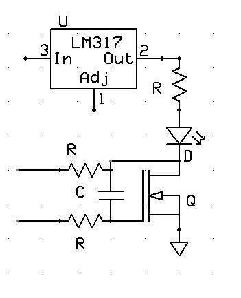

The concept is straightforward -- to use mosfets as variable resistors instead of the potentiometer as used in georgehifi's "Lightspeed" and to control the resistances with as much precision as possible using a PIC. The goal is to create a multi-channel, constant Z attenuator with closely controlled parameters in each channel without closely matched LDRs. Ideally, a single pot master volume control will be able to control the gain on as many channels as desired without audible shifting of the sound stage.
The basic building block is simple, and I'll post the schematic below. The PIC is connected to each mosfet/LDR set via a control line which goes to the gate of the mosfet and adds or removes voltage at the gate to change the mosfet transconductance, and a feedback line which reads the voltage drop across the mosfet to determine whether the gate charge is correct or needs to be raised or lowered. The PIC reads the feedback and applies correction to the gate charge. This all happens so fast that the mosfet can be held at a given level with fine precision. The controllable resistance allows control of the current through the LED, which in turn controls the resistance across the LDR.

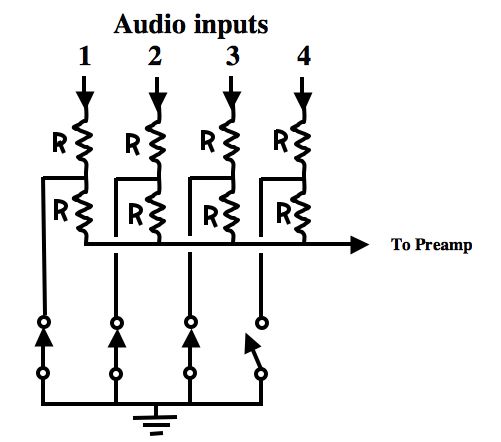

Contactless Input Selector
Instead of the resistors, use LDRs and your imagination to reduce the attenuation. After bringing the shunt LDR to the minimum resistance, use relay contacts to reduce the resistance to zero.
Gajanan Phadte

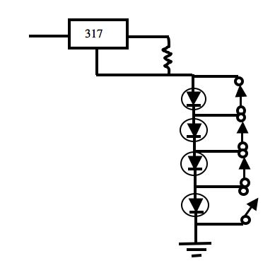

Use LDR instead of the series R and use the attached ckt to control its LEDs.
For other shunt contact, use the other contact on the relay.
All the contacts shown r of the relay that should be used to select the input.
Gajanan Phadte
