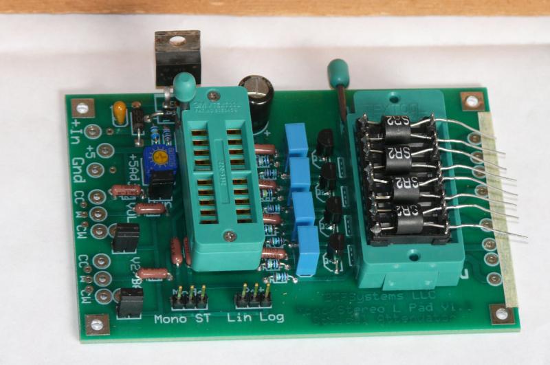

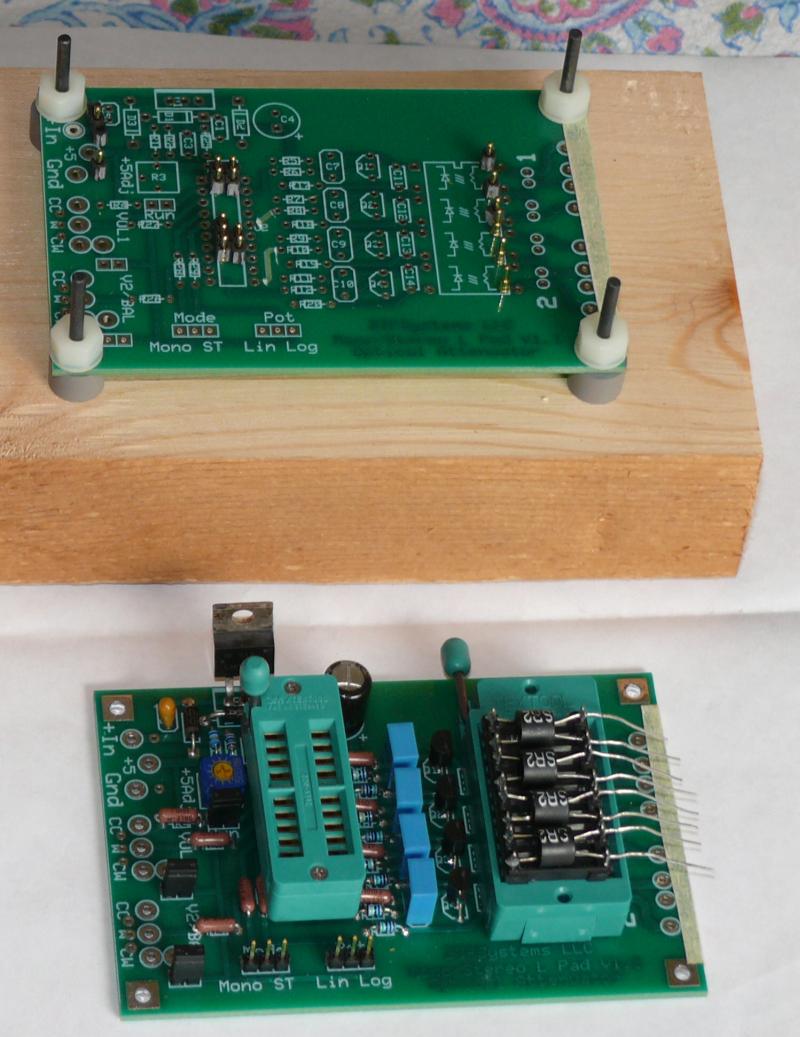

First L pad prototype board received and stuffed, and bed-of-nails board partially prepared (not yet wired).
As usual, as soon as I ordered the boards, I found a way to make a major improvement which required the rewiring of four IC pins, so this board is working with some rewires on the bottom.
Bed of nails is first try, now know that you should have at least two pins in a row to lend stability. Next board will have two rows of six and a third row of three times three pins, should be very stable and reliable.
Unless I run into major coding problems, should be able to get both the calibration code and operation code on one chip. That means potentially recalibrating in the field if you also have the bed of nails board.
The LDRs all reside on one header which can go into a socket for easy replacement or maintenance, but the LDR resistor wires are not cut off -- they extend out and will go into pads on the board for direct soldering to the input/output wires.
Had to put the IC ZIF on top of a socket to get some height because several components are too close to the IC to allow the ZIF socket to rest on the board.
Not visible are the pads that the LDR wires go into. Also taped over the labels on the input and output pads because they are mislabelled.
