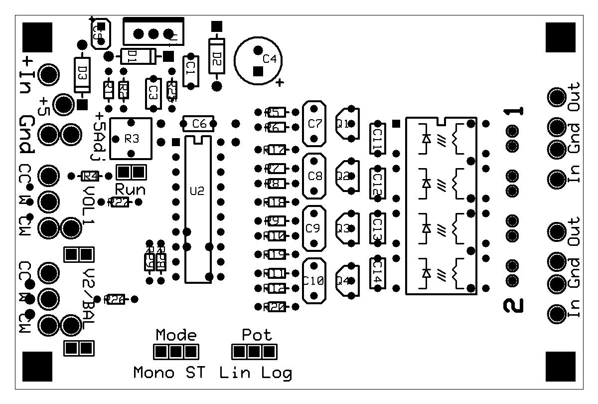

Update -
For the moment, I've switched from a T pad to an L pad style attenuator, and initial testing of the control suggests that I can achieve a .25~42dB attenuator with a constant Z of 5K with good accuracy with unmatched devices. Not as good as the T attenuator, but it should be adequate.
Switching to an L pad allows me to use 4 devices (comfortably loaded on a 24-pin header without bending wires) for a two-channel board that is configurable as a dual mono or stereo (volume + balance) instead of the eight devices for the T pad.
Design permits through-hole potentiometers on-board, or wired separately. Jumpers to allow multiple boards operating in 'mono' mode to be connected to a master volume control for surround sound or sound board applications, providing the lack-of-matched-sets concept works out OK.
I'm planning to use a socket for the 24 pin header, and extend the LDR resistor wires to solder directly to pads. That will allow flexibility in removing the header if needed for servicing, and yet ensure a fully soldered connection between the LDR resistors and the input/output pads.
Added pads to permit installation of capacitors (tantalum) across LEDs if desired.

Why could you not build using an LDR? The wiring is delicate, but that is easily managed if you put the LDRs on a DIP header. I myself use a 24 pin header to hold four devices very comfortably.
