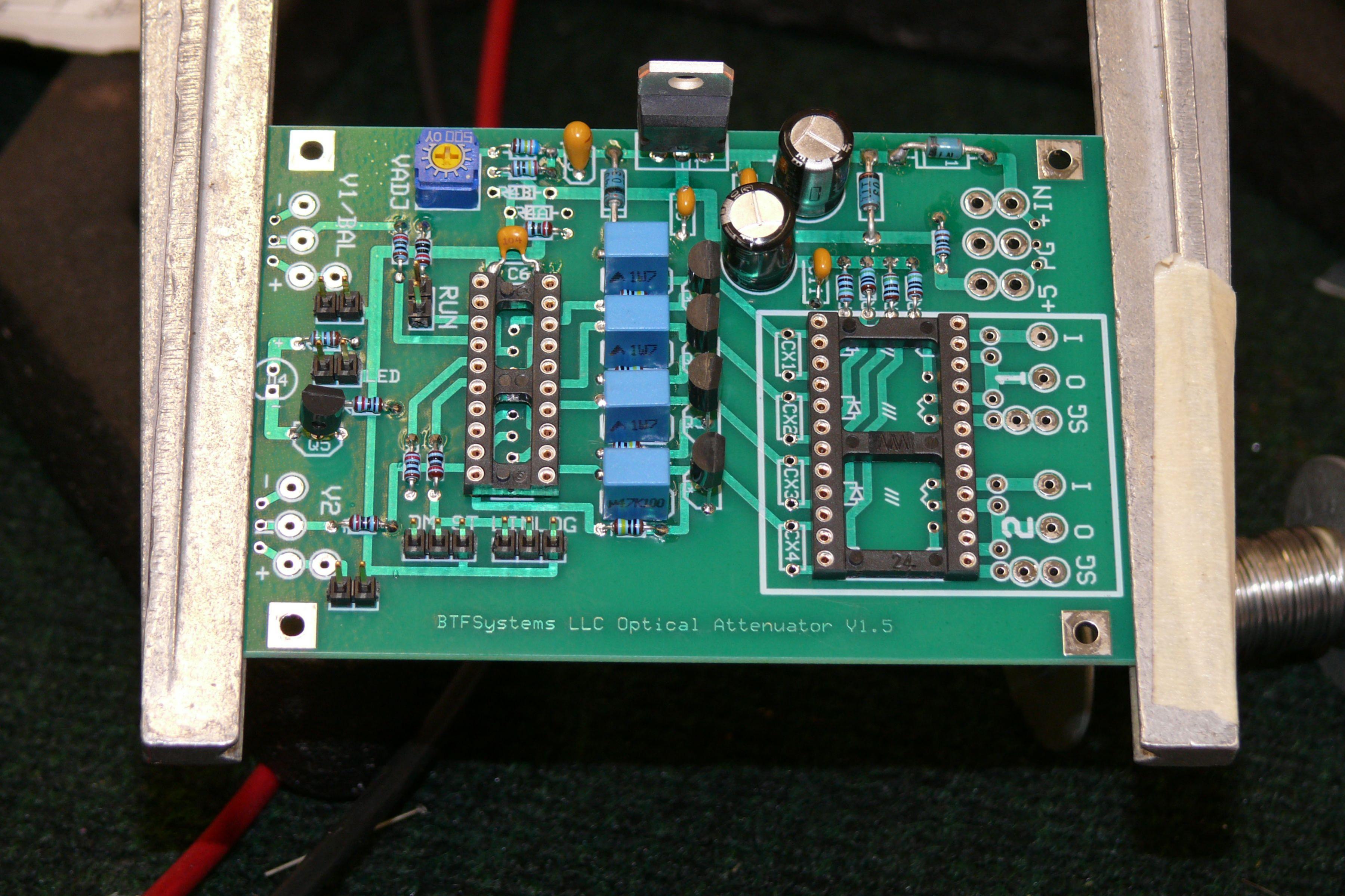

First image is close to the operational version of the board except it has 1/8w resistors instead of 1/4w. You can see the pads to the right of the LDR carrier socket where the LDR resistor wires are soldered. The carrier itself is simply plugged into the socket. This will permit fairly easy replacement of the LDR assembly. The board is designed to permit easy reprogramming of the PIC in the event that the LDR assembly must be replaced.
The second image adds ZIF sockets for the PIC and the LDR carrier to permit testing and calibration.
Not yet added are the computer interface and resistors and added wiring to permit testing and calibration. Production boards will use a bed-of-nails system for testing and calibration.

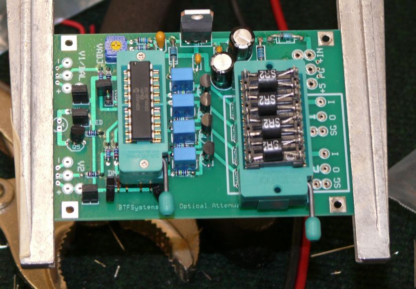

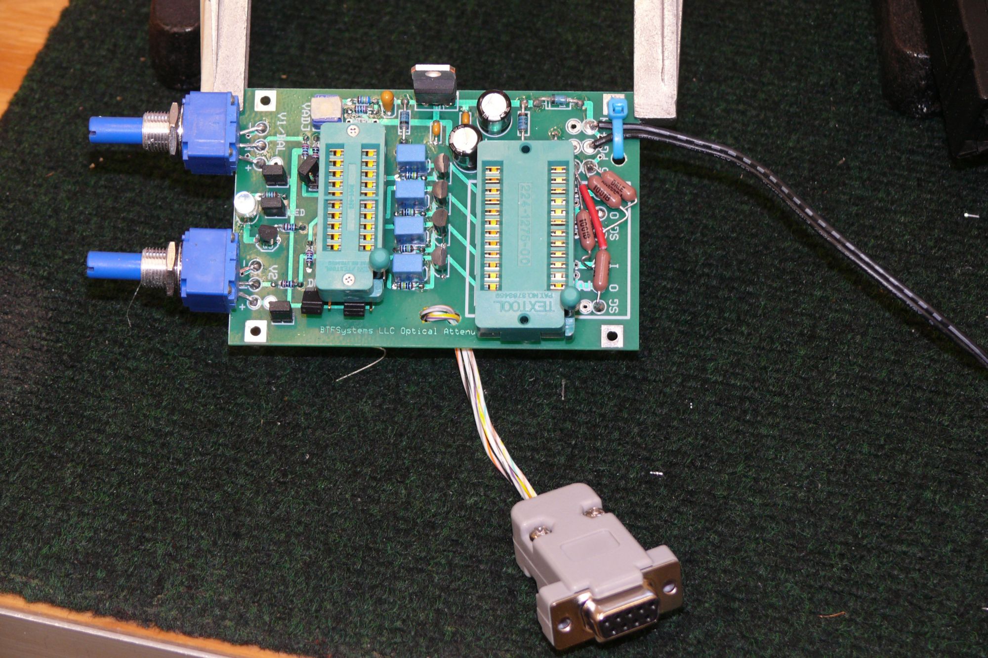

Board with computer interface and .1% resistors installed to provide the voltage divider networks for testing & calibration of chips and LDRs.
Computer interface is tested, and the computer is talking to the chip. Ready to do the programming . . .
Not shown are the wire connections under the board that connect the voltage divider test points with the spare ADC ports.

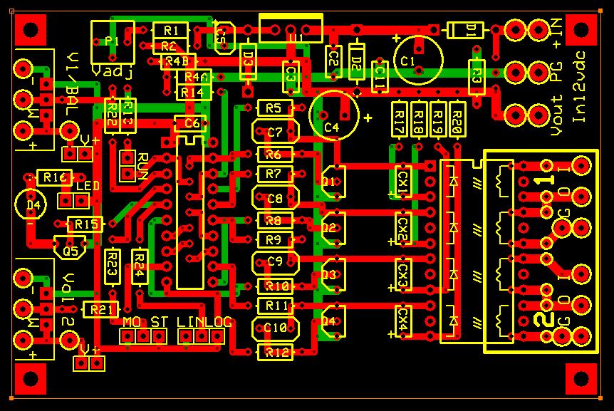

the lands around each hole are very narrow. The land is too small for direct contact with the tip of the soldering iron. This makes for more heating of the component while trying to use the component leg to heat the PCB trace.
Andrew, since you made me aware of the issue, I watched to see what would happen when I built up the first board. You are right -- the lands could be bigger, and that would result in better solderability.
Also, I find that the holes for the indicator LED are too small for all LED leads to go through. I guess I will modify all of the components that I use and save them as custom components with larger lands and in some cases, larger holes. I had already done that for the chip and LDR carrier sockets because I prefer machined pins for those and the machined pins would not fit in the original holes.

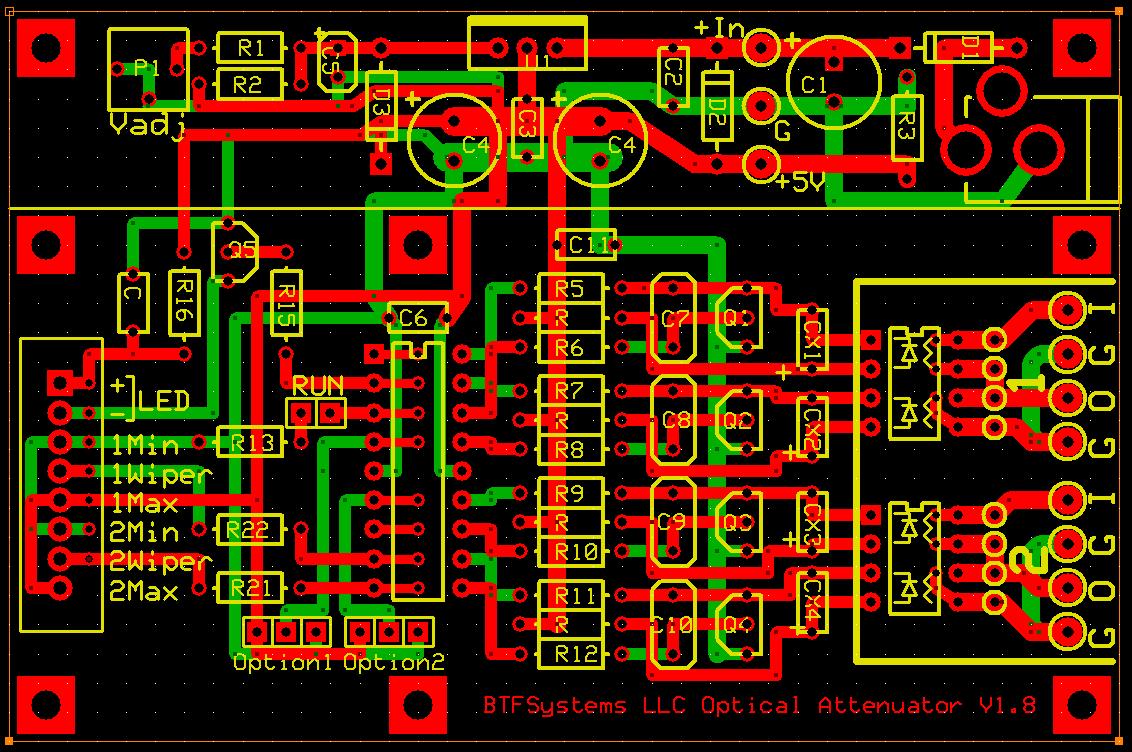

Finished version 1.7 of the board.
1) rearranged volume & balance pots areas so that pots can be either soldered directly to the board (Bourns 91 series linear or audio taper) or outboard pots can be connected with wire.
2) moved the master volume control pot connection locations to be clear of soldered-to-the-board pot footprint so that you can use soldered-to-the-board for individual channel adjustment, but still have a master volume control adjust all channels simultaneously..
3) moved audio signal areas as far away from other circuitry as possible, and closer to the board edge.
4) cleaned up the power in, regulated power out area.
If the user solders the control pots directly to the board, this board can be mostly supported by the potentiometers bolted to the front panel.

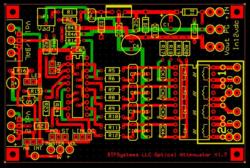

Latest board design.
1. 2.5"x3.8" with lots of free space so can be made smaller yet
2. Different PIC -- 18 pin instead of 20 pin does the same job but in smaller package. This PIC is capable of multi-tasking four tasks simultaneously via time-slicing. This means that the overall task can be divided into three -- each two devices can be one task (1 channel) to maintain tight control of the devices while a third task handles the less time-sensitive overhead (reading input, calculating individual device corrections, etc). PIC will run up to 32MHz, so plenty fast for three tasks.
3. Two 8-pin .3" DIP carriers instead of one 24-pin .6" DIP makes for much less space used for the LDRs.
4. Converted to on-board wall wart plug for easy connection and minimal noise (no AC in the box). A hole in back of box will allow wall wart to plug directly into board.
5. Eurostyle screw terminal block for front-panel connections to pots and LED.
6. Easy to drive two boards (four channels) from a single power supply if desired. This will require a decent heat sink for the LM317, or bolt it to a metal case for heat dissipation.
7. Kept the three main power circuits -- LED, PIC, LDRs -- separately home-runned to regulator for minimal interaction. Plenty of bypassing.
The extra standoff holes at other than the corners of the board are for use with the three rows of bed-of-nails pins loaded on the programming & testing circuit board.
I'm in the middle re-numbering the components, so there are duplicates and omitted numbers in the drawing.

(I haven't looked at your very interesting thread for a long time and I might not be understanding what some of your components and connections are, so please forgive me if I am just completely wrong about what something in your circuit is, anywhere below.)
Looks pretty good except that you allowed a lot of loop area to be formed between the +5V and Gnd that wouldn't have to be there. (Example: downstream from each of the caps labeled C4. What's up with THAT?) ANY loop area that's formed will allow AC and RF in the air to induce corresponding currents in the loop (or, the loop could transmit RF or AC _INTO_ the air, in the case where your loop already had its own time-varying currents). Either way can be "a bad thing", under the wrong conditions, which probably will eventually occur, so you need to prevent it from affecting your circuit.
Instead, each part of a power rail trace and its ground return should always and everywhere be as close to each other as possible. In your case that could mean overlapping them, on opposite sides of the board, absolutely as much as possible. But you should probably just fill in everything you can with a ground plane, on that (green) side of the board (or several large portions of ground plane, if you're keeping the LED, PIC, and LDR power circuits separated).
The same "avoid loop area" idea applies to ALL natural pairs of conductors, such as audio signal and gnd, AC power pair, DC power pair, speaker or output pair, etc etc. Some are "transmitters" and some are "receivers". Just avoid them all. (If they're wires instead of traces, use shielded twisted pair, where the shield is used ONLY as a shield, and is connected to gnd at one end only. Next-best common way is probably twisting a pair of individual wires together, tightly.)
Is C6 a bypass capacitor for a chip's power pins? If so, it is WAY too far from the pins. Try putting it _directly_ across the pins, probably soldered on the bottom of the board, if you can. Every millimeter counts(!), there, especially for digital stuff. The inductance of the longer traces (like you currently have) will make it really difficult for the cap to act as a good point-of-load power supply, which is what it needs to do to not have demands for fast-changing supply currents induce voltage spikes on the power rail. And where C6 currently is (after you move it to be directly across the pins), I'd put something like a 10 uF or larger electrolytic, with a not-especially-low ESR, although the electrolytic too should be MUCH closer to the chip's power pins, if at all possible.
Always try to put a pair of bypass caps (a small cheap ceramic and a small cheap electrolytic in parallel are usually best) RIGHT AT the exact point where the changing demand for current needs to be met.
Similarly, C5 and C2 are too far away from the regulator. What kind of cap is C5, anyway? Is that the adjust pin that it's bypassing? That would be very good, but you'd probably want something like a cheap (i.e. not-too-low ESR) 22uF electrolytic for that.
Also, I'd seriously consider putting in an RF low-pass filter wherever anything comes in from off your board, and also wherever a trace becomes an input to anything, and also after any trace that's more than a couple of inches long. Wherever you have a resistor, or a resistance, you can usually stick a small ceramic or film cap to ground just downstream, with the C calculated for each R so that the lowpass cutoff frequency is a few hundred kilohertz (or as low as you can get away with). I would even do it at the LDRs', in the audio path (especially there, probably).
One last thing: If you don't use ground planes, make sure that you don't run dis-similar ground returns through the same length of conductor. Keep them separate _ALL_ the way back to the big smoothing caps. Otherwise, the voltages induced across the distributed inductance of the ground return conductor will appear back at the upstream end of ALL of the ground returns. Anything with dynamic (fast-changing) ground-return currents will be a big polluter, even if the currents have low amplitude, since the amplitude of a voltage induced across an inductance is proportional to the RATE-OF-CHANGE of the current.
Sorry to have blathered-on about all of that, for so long.
Tom
