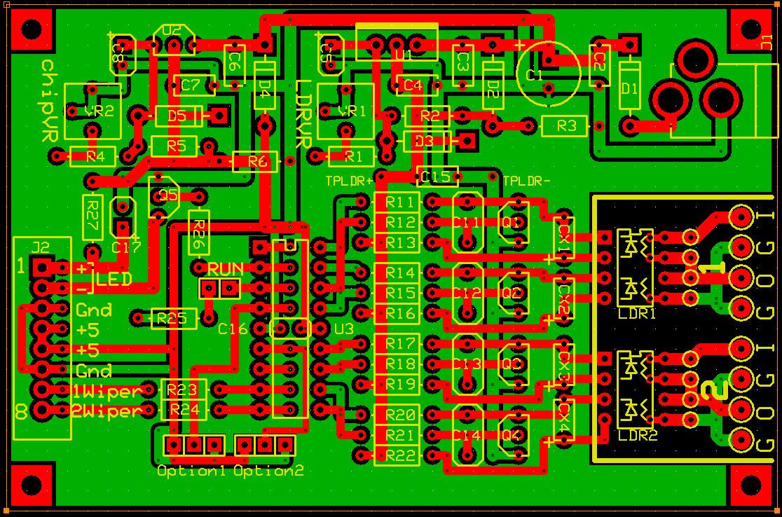

An improved board, still 2.5" x 3.8":
Separate regulators completely separate the analog (LDR) power supply from the digital power supply. Separate analog and digital grounds meet only at the power input electrolytic capacitor C1, and the ground plane also is connected to power ground only at C1. Signal ground is completely isolated from power ground, and is a simple pass-through of source ground to output ground.
This circuit employs no digital signals outside the control chip -- no PWM and no rapidly switching levels whatsoever, all control is accomplished by analog voltage level. Control voltages to the mosfets will go high or low to reach proper level to drive the LDR accurately, but then change minimally, with only an occasional instantaneous 'bump' of the control voltage to the mosfets to keep voltage to the LDRs stable and accurate.
C16 is a .1uF chip ceramic connected directly across the power pins of IC3,and nests within the IC socket.

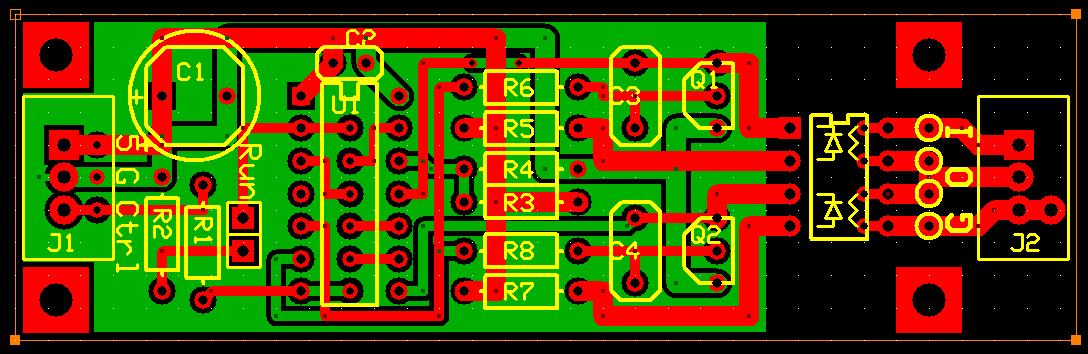

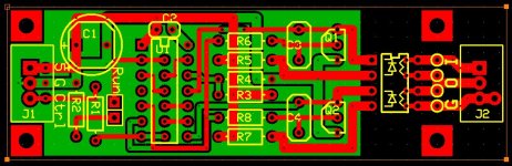

New approach is to design per-channel boards with a separate power supply providing power to multiple boards. First boards are 1" x 3.5"

But what about the input and output impedances? Have you plotted the input and output impedances versus the volume setting?
What make and model of LDR device are you going to use? If I had their R vs I response curve and the current range you plan to use (or could use), I could simulate them and plot the impedances.
There is a way to use a couple more resistors to make the impedances stay a lot more constant as the volume changes. But I'm wondering if you'd want to consider having optional input and output buffers, possibly on a different board.
I was also thinking that you might want to leave some space and possibly have some pads in place in case you find out you want to have some additional low-pass RC filtering for the LDR diode feeders. But that can wait until you see if it's needed, I guess.

Input and output impendance:
I have calculated the series and shunt resistances at 1/2db intervals so that the overall system presents a constant 5K system Z from about .5db minimum attenuation to a maximum of 42db. At .5db attenuation it's 280 ohms series and 84K ohms shunt; at 42db it's 4960 ohms series and 40 ohms shunt. I could bring the range to 48db by paralleling two shunt LDR devices for total 20 ohm shunt impedance but that would require matching LDRs at 40 ohms. We could also get 48db of attenuation by allowing the system Z to rise to 10K over the upper one-third of the attenuation range. I can actually control LDR resistances well beyond 84K ohms, but at 150K the control becomes pretty loose due to the extremely small current involved. I plan to experiment a little to see if a resistor in parallel with the LDR to raise the minimum control current through the mosfet won't give the mosfet a better grip on the resistance at that end of the spectrum. I expect control to improve quite a lot with the "recovery" of about 200 steps of ADC using the external Vref+.
Model of LDR device:
All of my experimenting has been with the Silonex device used in the Lightspeed. I've looked at the Fairchild devices, but minimum impedance seems quite a bit higher so will stick with the Silonex for now.
Input/Output buffer:
If someone wants those, it'll be up to them to implement them. I am after an LDR control that uses sophisticated control techniques to yield a simple and totally clean fixed-Z attenuation device.
Low pass LC filtering on LDR diode feeders:
Not sure where you are talking about putting those. The control of the mosfets is effectively DC, with only an occasional tiny 'blip' visible on the most sensitive setting on my HP scope once the voltage on the gate of the mosfets has been servoed to the proper level.

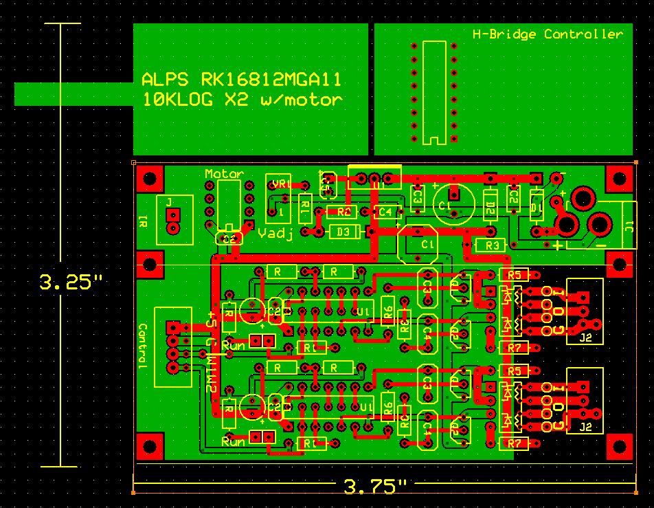

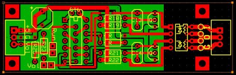

Making a little progress:
1) Multi-tasking turned out to be a red herring. The chips won't run at full speed during multi-tasking, and other issues arise as well, so I'm sticking with single-task structure.
2) Switching to multi-turn pot for better control over setting regulator voltage and for setting external Vref for the ADC ports on the chip.
3) Increasing the mosfet gate control current limit resistor value from 1 meg ohm to 3 meg ohm to get finer control of steps up and down on the gate. Right now, a single minimum duration corrective pulse moves the level at the mosfet gate too far. Increasing the resistance will reduce the amount of correction applied in one step. The alternative was to increase the capacitance of the capacitors which would either make them physically much bigger and more expensive or force a switch from metal film to tantalum, and I don't like either alternative.
In case anyone is curious, this is my latest board with Alps motorized pot (drawn to scale).
Board will include IR receiver and a second board will carry the H-bridge controller for the Alps. H-bridge is a single 16 pin IC, almost no support required except for regulator. The motor will have it's own voltage regulator, but will draw power (100ma when running) from the 12V 1A wall wart.
In process.
Renumbering of components not complete, so don't criticize that!
Circuitry for the IR receiver and H-bridge not drawn. The IR will be only for volume UP/DOWN, nothing else. Later it won't be difficult to add another larger board for input switching tasks.
Control code is working very smoothly. LDR becomes difficult to control above about 50K due to the very low current requirement, but at 10K it is very steady. Control is so fast that adding control of a second LDR device as a simultaneous task won't make any difference at all.
I will use a separate chip for the IR receiver and H-bridge control.
