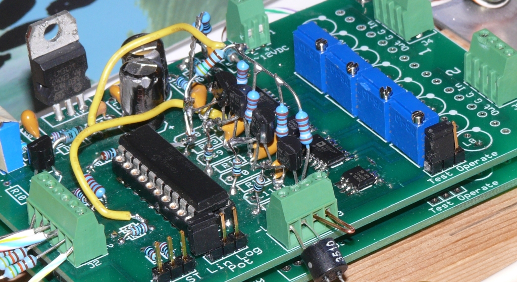

Well, depending on how I look at it, it's great progress or just progress-of-sorts.
I'm looking at my 4.5 digit meter, and it's reading 9,651 ohms at minimum volume pot attenuation (and that's good because it's the shunt resistor I'm looking at).
The down side is that I'm operating the PIC outside of the Microchip specification. And it has to be this particular model chip to work, another (earlier) version of the chip with similar specifications doesn't work at all. But I think that this version is good -- every sample I've tried works OK.
Right now the control is extremely sensitive (even though I'm using a 10-turn linear pot) because I haven't entered the linear-log conversion algorithms into software yet. So at one end of the pot, minimal travel changes resistance a lot and at the other end there's very little change for a given rotation of the control. The rotation of the pot is so small compared to the change in resistance that I'm actually using 10-bit ADC feedback through the computer to measure the relationship of pot movement to change in resistance.
Let's see if I can calculate the drive voltage change to the constant current chip that results in about 1K resistance change in the LDR at 10K ohms. The calculator result is this:

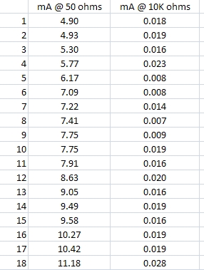

Have now completed enough hardware testing so I feel OK about fully populating the board with LDRs.
Did a very basic pre-screen of each device requiring (almost every device passes this test):
a) 50 ohms or less at 12ma
b) 10K ohms or more at .005ma
That guarantees each device is capable of delivering the resistance required for the board to operate over a resistance range of 25 ohms to 10K ohms. Beyond that, no prescreening necessary, since the PIC will learn the characteristic of each LDR pair and control accordingly. The .005ma achievability is based on the PIC's resolution capability (I'm forcing operation outside the Microchip specification, but it works), the resolution of the resistor/mosfet voltage divider network, and the constant-current chip's sense resistor value. To build a pot with a total resistance exceeding 10K ohms (a 25K pot for a tube amp, for example) the LDRs will need to be hand-picked with tighter standards. However, due to the precipitous drop-off of current above 10K ohms, the difference in drive between a 10K pot and a 25K pot is minimal.

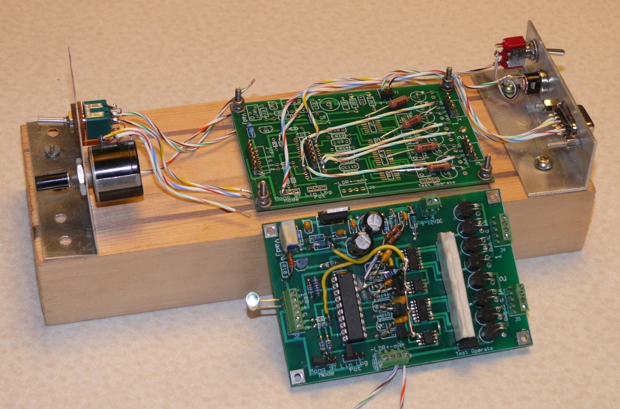

The attached photo is of the control board and the bed-of-nails test board which houses the precision .1% resistors and connections required to allow the PIC to read the LDR and "learn" what control output results in what LDR resistance.
The next step is to enable the code to control all four channels of LDRs simultaneously with each two channels of LDRs operating as the two resistors comprising an adjustable potentiometer.
Total current consumption at worst-case scenario (maximum attenuation) should be about 30~35 milliamps, and the TO-220 LM317 will be loafing.

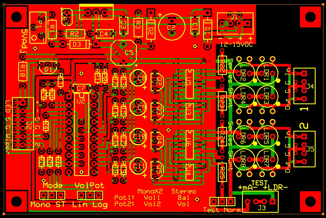

At this point, I've got 70+ components on the 2.5"x4" board, and I think the board is pretty much ironed-out and in close to final form.
This board is pretty much a final configuration.
Two areas of the hardware might change:
1) The values of R22~R25 may change once I’ve got the board up and testing. I know the calculated values but real world factors may yet intervene. I’m moving away from the trimmers that I was using previously.
2) For each of the two channels, I have planned for two LDRs for the series leg of the pot and two more for the shunt leg; however, when calculating resistor values for a 10K pot driving a 10K (or higher) amplifier load, the lowest series resistor value required for .5dB attenuation (the least attenuation I’ve planned for) is just under 300 ohms, and that minimum value is even higher for higher ‘pot’ values like, say, 25K ohms. Thus, the series leg should be adequately served by a single LDR rather than the two in series/parallel that I’ve planned with the shunt leg. If I’m right, I’ll just jumper the power leads for one of the LDR positions for each series pair and change the layout for the next board.
The op-amp and voltage-to-current converter chips I’ve selected for this project are the OPA2342 and the AD8277. I like them because they are unity gain stable, rail-to-rail, high precision, and require only four external resistors (R22~25) to correctly drive two complete channels (four legs of LDRs).
I switched C8~C11 from metal film to tantalum to get a larger value. Adjusting the RC network driving the mosfet gates will give a better combination of quick response and a more stable voltage to drive the op-amp inut.
For the heck of it, I put ground planes on both sides of the circuit card. Hopefully there’s no hidden gotcha lurking when I do that because the science of ground planes is above my pay grade. The circuitry is operating at DC levels, so I’m assuming that extra stray capacitance is not going to bother the circuit. If anyone sees this and knows I’m doing something wrong, I’d love to hear about it.

wapo54001,
The board layout looks really very good, to me, now. Excellent job!
Sorry but I have just a couple more bothersome questions and suggestions. ;-)
Is there some reason for not also putting ground planes in the LDR area? I would at least want to run the "current in" and "current out" traces for the LEDs as close to each other as possible, so there is no enclosed loop area between them to act as a receiving (or transmitting) antenna. Actually, I'd probably want to just flood the LED area with the "current out" (green?) copper, so it would (also) cover the area on the opposite side of the pcb under the red "current in" traces, giving very low enclosed loop area, in that region at least.
That same flood-fill could also basically eliminate the effects of sharing the single "current out" trace by currents from multiple LEDs, which would probably be a good idea, so that the distributed voltages induced along the traces (which would basically appear back at every LED cathode) by current from one LED, flowing through the trace impedance, wouldn't affect another LED, and using more of a plane would also minimize the effect of each LED's own current on its own downstream voltage, which overall would present a more-constant "ground" voltage to the more-negative end of each LED.
The input and output impedances worry me a little, with only 10k max LDR resistance. With a realistic "average" setup, i.e. with "average" amplifier input resistance (maybe 10k) and source output resistance (maybe 50 Ohms, or even 0.01 Ohm), what would the plots of the attenuator's input and output impedances look like, or what would be the max and min of each?
Are you running the 50 Ohms to 10k Ohms LDR profiles linearly (vs pot travel), with about a 5k/5k intersection at the volume pot's midpoint? Or do you have them as log or log-related functions?
What kind of options have you got, for the resistance profiles, and what have you tried, and how has it affected the maxes and mins of the Zin and Zout?
Tom

Tom, your post comes under the heading of "I'll just spend a few minutes writing this here, and let's you -- Wapo -- spend the next month working this stuff out. . ."
Well, even if I wanted to, I don't have the electronic training to deal with all that, I am a rank amateur. I'll tell you what I think and why I think some things are OK as is.
First, ground planes in the LDR area -- I thought if there was any current flowing through it, I'd just keep it clear of the audio path. Don't see a reason to include the LDR area.
Actually, given the DC-nature of my circuit, other than the PIC area and power connections (which travel through multiple capacitors), there should be no noise at all. Where signal goes high or low as driven by the PIC, the circuit typically holds that condition for many milliseconds, and there should be no high frequency switching hash. Also, control signals coming out of the PIC immediately go through a 1 megohm resistor into a 2+uF capacitor which changes charge very slowly; there just isn't a lot of opportunity for noise.
Second, regarding current flow from the LEDs: Maximum current flow in the worst-case scenario (both channels volume at minimum but not muted) would be !0~20ma total with 5~10ma drawn from each channel, and it would be steady-state. I made the power tracks .040, which is the recommended size to carry several amperes so I can't get too excited about 20ma.
Currently, both top and bottom planes are connected to ground; I could make the top plane +5 and the bottom plane ground . . .
With regard to the input/output impedances, I have created a spreadsheet that allows me to enter the pot value and the amplifier load value and the spreadsheet gives me R1 and R2 values at 1/2 dB steps of attenuation for the given pot. I can increase the value of the pot to any value and get the resulting resistor values at 1/2dB steps. If I need to get fancier and change the R1 and R2 values in such a way that they do not always equal the theoretical value of the pot, then I'll consider it, but you'll have to explain to me what the objective is, and show me the formulas for making the calculations. There also is a practical limit to this that relates to the increasing difficulty of controlling the LDR at higher resistances.
Re the pot being linear or log -- I answered that above, I am planning to use a linear pot to control the circuit, but percentage linear travel of the pot will result in equal percentage change in dB -- a log curve.
As for calculating the Zin and Zout, I haven't done anything in that area. Again, give me the formulas, and I will try to integrate it into my spreadsheet. I'll also need to know what I'm trying to accomplish -- what is a desirable Zin and Zout objective.
