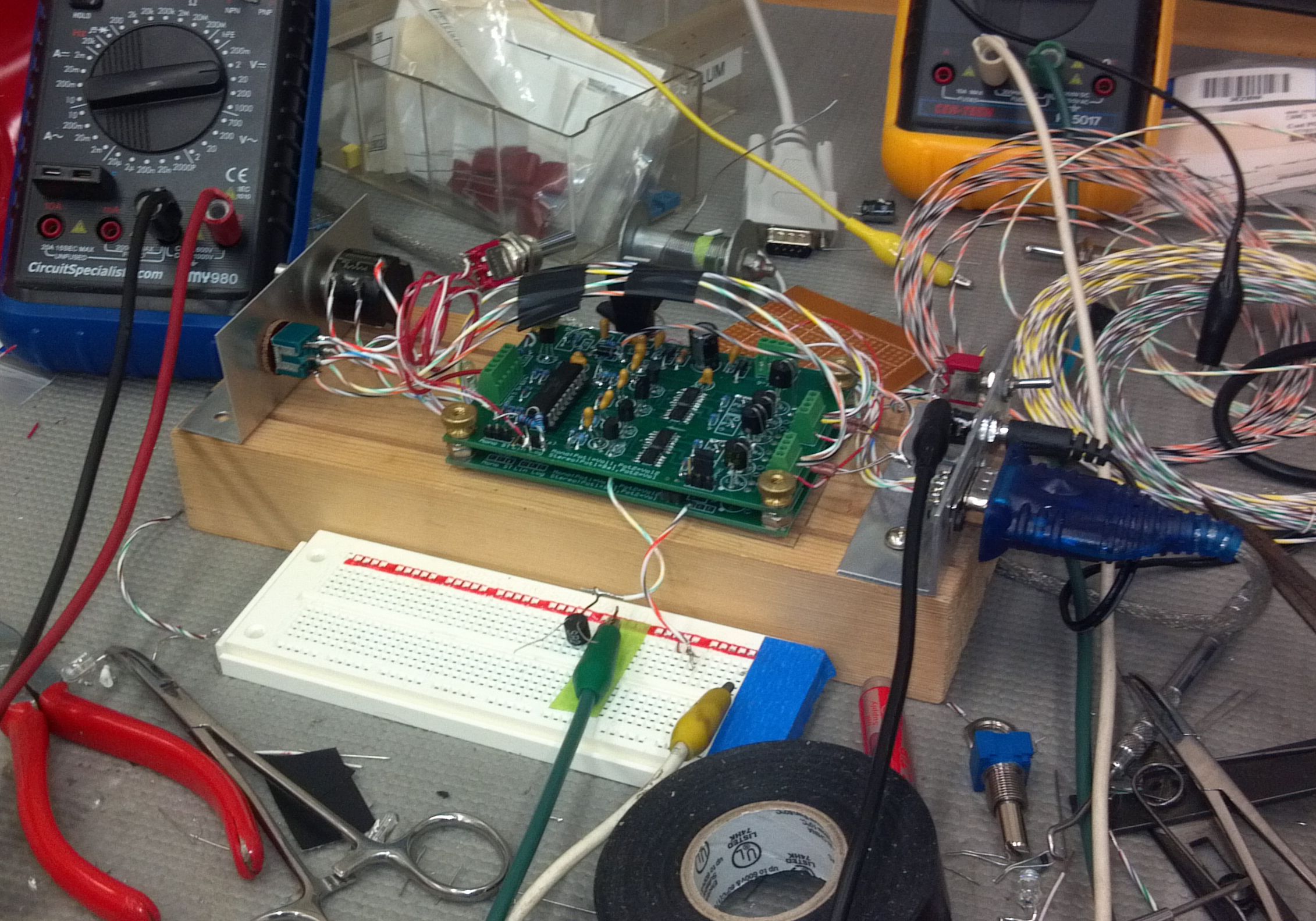

I haven't posted in a while, but I've been making some progress.
The attached photo shows the current design on a 2.5" x 3.8" board (it's pretty messy because I have changed and replaced a lot of components along the way).
The design can be controlled by either pots or by button presses, and has selectable modes: Stereo (Volume & Balance), Mono (two independent channels), and Calibration (for initial calibration, changing the pot value, creating independent R1 or R2 response curves, or periodic recalibration).
The design will deliver very good channel-to-channel accuracy with LDRs that are selected only to meet minimum standards, not matched. I have tested the design with one, two, and three LDRs paralleled in the shunt legs which allow 17 ohm shunt values even at a very conservative maximum drive current of 11ma. A 10K pot with 54db of attenuation is entirely doable using current values that don't even come close to affecting the long-term stability of the LDRs.
By adding a little external wiring for calibration, it's looking very good for a board that could be totally assembled and calibrated in a wide variety of configurations by the end user without involving any programming skills.

James, thank you for the kind comments. I just looked back over this thread and realized I've been fooling around with LDRs for three and a half years now! Certainly there have been long periods of total inactivity in that time, but still I've put in some hours on this, and over the period I've tried a lot of various configurations and have given them some thought, and certainly reached a number of dead ends and some conclusions.
I have been trying to get people to look at the technical aspects of the LDR on another thread that is dedicated to the type of boards you have built, and sometimes the effort turned into a good conversation and sometimes it turned into accusations of trying to hijack the thread and/or hijack potential customers. Yet my vision is nothing like George's board or Uriah's board and I know nothing of a board made by "Allan." I simply was interested in getting people thinking and talking about the reality of what an LDR is and how it works. By the way, could you give me a link to Allan's board which I have never heard of? I would like to see what it's about.
My concept is entirely different from George's or Uriah's implementation, although it is similar to Uriah's in one key concept -- the ability to independently select different values for the R1 and R2 sides of a potentiometer section to allow for special circumstances like an overall system with excessive gain, or a requirement for special consideration for the source impedance or the amplifier impedance.
George's board is elegantly simple and easily implemented except for the requirement to hand-select individual LDR devices. George does, in fact, recommend that all four LDR devices in a stereo potentiometer be quad matched, which makes the matching even more challenging than finding two matched pairs to do the job. George says that power supply regulation is, after a point, not important. The Lightspeed does use a voltage-regulated circuit.
Uriah, on the other hand, from what I am given to understand, seems to espouse using two sets of matched-pair LDRs per board rather than a matched quad set, but also believes in a very pure power supply with lots of capacitance smoothing. I have never seen a diagram of his circuit so I cannot say what the circuit philosophy is so know nothing of its strengths or weaknesses from the perspective of what I think I have learned about LDRs.
Some folks on the other thread seem to think that I'm trying to pit voltage controlled systems against current controlled systems. I'm not, because there is a place for both types. The voltage-based circuit is easily implemented and no doubt sounds wonderful. The PIC-controlled current-based circuit serves an entirely different purpose and has tradeoffs. The tradeoff is, in exchange for much greater complexity and expense, you get predictability and repeatability and flexibility.
I seem to be one of only a few people who are interested both in analog audio electronics and in digital electronics. I could see how they would work together and when combined, produce the best of both worlds -- on the audio resistor circuit side a device that is just as simple and pure as George's Lightspeed, and on the driver LED side a circuit that is far more consistent and repeatable and absolutely inaudible to the listener.
My design goals are:
1. Easing of the LDR matching requirement. Pretest only for minimum resistance and maximum resistance at predetermined minimum and maximum current. Pass/fail test with at least 60% yield from randomly selected LDRs.
2. Close tracking of the logarithmic response curve.
3. Very close tracking between channels.
4. Stability over time and temperature variation.
5. Consistency of tracking to make multi-channel control possible (5.1, 7.1, etc).
6. User-adjustable pot value from 5K to 50K to optimize for most solid state or vacuum tube systems.
7. Make the building, calibration, and modification of response curves to custom values easy enough and repeatable enough to allow DIY construction by hobbyists and customization to exactly match the needs of the specific system.
I started my latest configuration running yesterday morning, holding LDRs at 10K ohms at room temperature +/- 20 ohms. I put an ice cube against one LDR and the resistance changed a mere 10 ohms average at 10K ohms. I was thrilled, and announced the fact on another thread and that was not received well. 😱 BTW, this circuit has been running continuously for a day and the resistance is still exactly where it was when I started the circuit yesterday.
Over the past several months I've really put some effort into the firmware and have made good progress. Also about the same time realized that I should revisit an IC that I had looked at three years ago and rejected because it would not deliver the performance I thought (then) that I needed. I've looked at it again with new criteria and find that it works -- which means that I can do away with my SMT-only ICs and reduce the price of components by about $12 per board.
So, I'm headed in the right direction and I see no technical issues that will be a show-stopper, but only time will tell.
