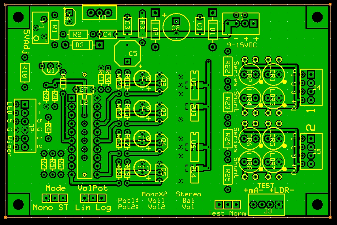

Tom, please look at the schematic with the planes removed.
You can see that there is a star ground with individual parts of the circuit grounded directly to a single point, which is the main capacitor on the output of the regulator. I've tried to avoid having various currents interfere with other parts of the circuit. The PIC has it's own ground, the analog op-amps have their own ground, the LDRs have their own ground, the status LED has it's own ground (and the LED will change state (flash) only when the PIC is actually moving the input to the op-amps. When the op-amp input is steady, the LED will always be steady and no abrupt current changes will occur..
On each channel, all LEDs will spend most of their time consuming maybe a single milliamp or two per R1 and R2 leg, given typical listening levels. At the worst, only one leg will be at 'full power' which will be somewhere between 5ma and 10ma. So, total maximum current consumption per channel is 10ma.
So, having seen the details, are you still concerned about ground circuits?

Tom,

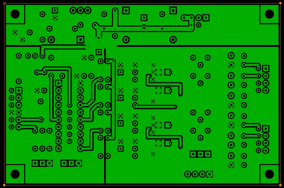

I think what you are saying is that a full ground backplane is (probably and marginally) better than the star configuration in this circuit. I personally truly have no idea, and your arguments sound convincing. So, the attached is my interpretation of what I think you said.
1. Have I correctly understood where you were headed?
2. If this is the preferred ground plane, what should I do with the top layer? Leave the traces as-is, with power connections still going to the individual parts of the board in a star configuration?
Comments appreciated.

Actually, I was only talking about filling the area around the LDRs; basically just a partial ground plane for the LED ground returns.

There are people who understand all of the nuances of the theory and practice of ground and power planes and pcb design and analysis. I've got a lot of their scientific and technical papers and journal articles and books. It's a little difficult to generalize about, sometimes. But for particular cases, simulations and analysis can pretty-much tell you everything. And if nothing else the likely alternatives can simply be tested.
There are a few people who frequent diyaudo.com whostudy and design PCB planes etc for a living. But I am not one of them.
At any rate, I'm not a huge expert and I'm not saying that it would make a big difference, because I really don't know. But I can say with certainty that it would be better than what you currently have, just not by how much. I was and still am just wondering if you had a good reason for not planing that area (becuase if you didn't, I assumed that you would have done so).
The fact that the currents are very small also means that they are much more easily affected, and is actually a good argument FOR using either a plane/fill or a separate ground trace for each LED. You have neither.
Separate star ground traces for each LED probably wouldn't fit very well, so using a plane or ground-fill is probably the best option of the two. And for a second reason, discussed farther below, it is the preferred option.
As I said, I haven't done even any rough calculations to see how big the effects might be, of using a single shared ground return for the LED currents. I'm guessing "extremely small". But the LED currents are where the metal hits the meat, so to speak, for this device. They are critical. They ARE "the product". And they go down into the low double-digit microamps. What is the necessary precision, at that level?
OK. I guess we have to do this. Let's "explore", a little:
At 10k Ohms LDR resistance, you're using 20 uA through the LED, and 125 nA (0.125 uA) would change the LDR resistance by about 100 Ohms. You'll have about right at 2 Volts across your LED when it has 20 uA through it and the LDR is at about 10k Ohms.
Then, let's say that another LED is getting 10 mA. And say that goes back to the main ground through four inches of the single LED ground-return PCB trace, and say that has a resistance of roughly 1 milliOhm per inch, for .004 Ohms. That makes 40 uV. But you'd have two doing that, one per channel. So that's 80 uV.
That might change another LED's current by 7 nA or so, which might change a 10k LDR resistance by 10 Ohms, or 0.1%.
Is that enough to worry about? Maybe not. It might have been, if that was a difference between the two channels attenuations, since it might be noticeable as a change in balance. But although your LED ground return is much longer for one channel than it is for the other, the difference in attenuation between the channels would probably be less than 0.05%. Is that enough to worry about?
On the other hand, I didn't have any opamps in mind, above; just voltage sources and resistors and LEDs. So I don't know how your circuit might react or differ, regarding the effect of an 80 uV rise of an LED's ground voltage.

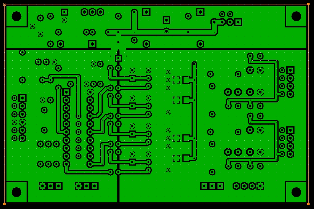

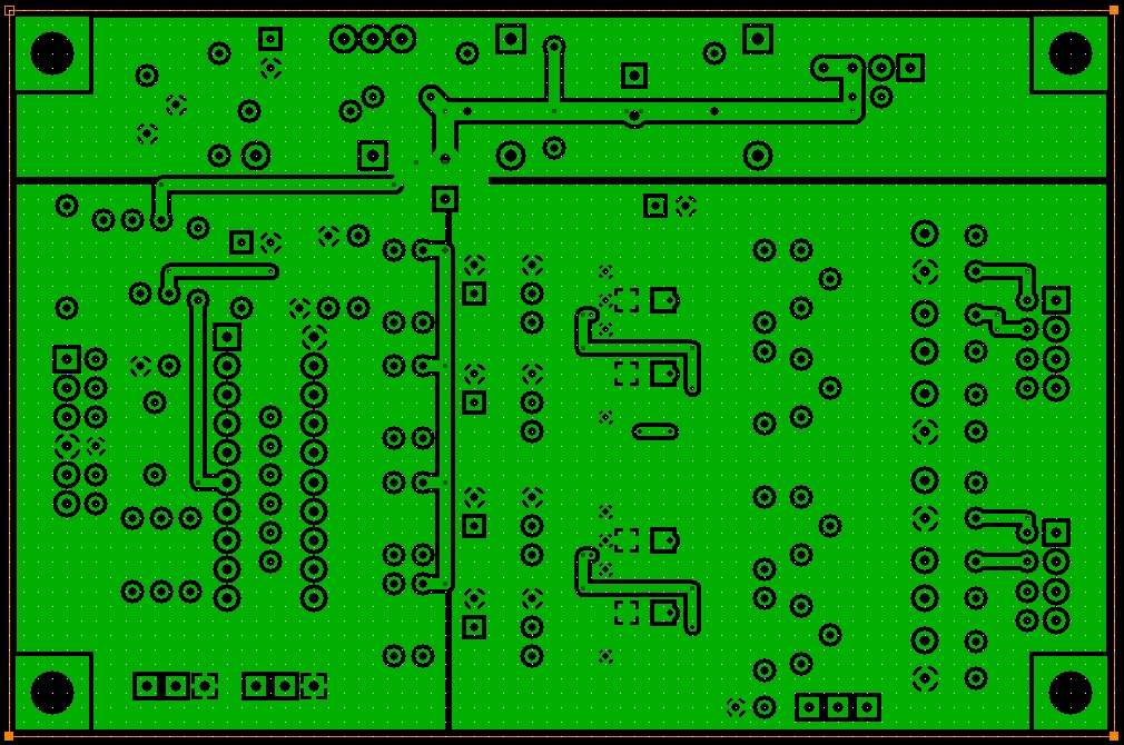

I've been on a long break from this project -- I needed to get away, and a photography project had been long beckoning . . .
Attached is a view of my final effort with getting the best possible ground plane for this project. There are two main changes -- one is fewer traces interrupting the ground plane (more traces were moved to the top of the board) and second, the edge where the digital ground plane and the analog ground plane abut was adjusted for a slightly better configuration.
In the next few days I intend to get back to programming the PIC.

When I thought I'd refined the board design to the nth degree, I kept finding little tweaks that seemed to be a bit of an improvement. But I've run out of ideas and the board has gone to manufacturing.
The ground plane has improved some more, additional traces moved from the bottom of the board to the top, see attached image.
The new board should be here Thursday, and digi-key has already delivered the parts for stuffing. Hopefully by the weekend I'll have a board with one LDR path working so I can use that to do some LDR testing. I'll post a photo when I have the board stuffed and ready to test.
