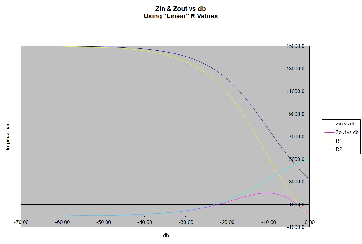

James, your thought is actually spot on, and i can do this with the tools I have at hand now and I have thought of it. Since I don't have the math skills or the ability to define R1 and R2 values appropriately -- assuming that it's possible -- I went looking for help from the guy who helps me with complicated spreadsheets that I couldn't do alone, and also raised the question in the Lightspeed thread.
My spreadsheet guy who had already done a ton of work for me at that point said, quite rightly, "first do a proper 10K pot, then we'll talk!" and the Lightspeed thread response was -- silence.
Right now, my friend has provided me with a spreadsheet that shows me the potentiometer's Zin, Zout, and attenuation at various R values which can be specified separately. He's shown me what the curves look like -- including Zin and Zout change with attenuation change -- with both linear and log value responses. I will attach a graph showing a pot with a 15K R1 and 5K R2 which I view as potentially useful for someone with a high gain low impedance setup. I posted this graph on the Lightspeed thread and no one had any comment or suggestion -- maybe it's old hat for the fellows who've been doing this for a while, but seeing the curves for the first time was very educational for me. (Edit: The values in graph are based on 100R source and 10K load, both of which I can change in the spreadsheet.)
So, at this point I don't know what the curves would look like or the details of what kind of resistance values would be required. If, for example, it required precision resistance control of values in the 200K range, I would say it isn't going to be easy because the LDR at 200K would waver probably +/- (guessing) ~10K or more. I have no idea. But I like the idea and computer control of the LDR completely releases one from any preconceived notions of what the R1 and R2 resistance curves should look like. And even if real-world constraints prevent full implementation, certainly you should be able to do a configuration that "leans" in that direction. So your idea is truly an excellent one in my opinion.

You guys are on the right track, with wanting to make the input and output impedance stay at more-ideal levels as much as possible.
I did quite a bit of work on that, a few years back, with LT-Spice. I have found a few of my sim files, from that, but not the ones I am looking for. It's been a long time, and I'm old, so I can't remember how good I was able to get the impedance curves. But I think that it's mathematically impossible to make them ideal, or even just as ideal as you might want, with the standard LDR divider setup. However, you can definitely improve on the typical curves, by quite a bit. And you can shape the attenuation (versus knob position) curve fairly well, if you want to. You can also use feedback to perfectly-linearize the LDRs, if you really want to.
I will keep looking for my LT-Spice files from that effort. But I think that I concluded that I would rather just use a couple of nice jfet buffers, or opamp buffers, for each channel. Still haven't built a finished version of any of it, of course.
I think I started out by adding resistors in series and parallel with both the series and shunt LDRs, to see what that could achieve. But I think there was still always a nasty trade-off between good input impedance and good output impedance, although the variations could be minimized, pretty well, especially if you knew exactly what the source and load impedances would be, and especially for only one or the other (i.e. either the input or the output impedance).
Later I started playing with the drive-current curves, in earnest. That's the stuff I can't find. It was pretty slick, if I recall correctly, but couldn't fully overcome the fundamental limitations of the attenuator topology (i.e. the tradeoff between input and output impedance curve manipulation).
But since you're already automating the handling of the LDR drive currents, maybe you could add one or two more LDRs to each channel and solve the problem, fully. I haven't tried to work out whether or not that's theoretically possible. Or, if I did, I have forgotten. It should be easy to do, though.
The math for this stuff isn't hard, theoretically. It's just two-port resistive networks. So it's just basic algebra. Nevertheless, I would tend to recommend using LT-Spice, so you can avoid most of the math and just test your ideas directly, and hopefully define the limits of the "trade space" that's available. You could even just use simple resistors in divider networks (but probably with "parameterized", i.e. variable symbolic resistance values, so you can set their values with "step" directives and sweep and plot whole ranges in one spice run). You probably only need to check the min, max, and middle attenuation values, which could also be done with pencil and paper, or in your head in many cases...
I have some .asc (circuit) files for (the freely-downloadable) LT-Spice that I can post, that have the lightspeed-style control setup, with a working potentiometer component that can be controlled by a voltage source (i.e. with any mathematical construct you care to try), and spice models of the LED-LDR modules that most people are using. I remember also just using two separate current sources, instead of the potentiometer circuit, for when I wanted to try special curves that were more straightforward to generate that way.
You can easily linearize the attenuation response (versus knob position), with the correct drive-current curves. But I don't think doing that helped at all with the impedances. To get those better, I seem to recall the attenuation (versus knob position) looking more like a quasi-inverse-cosine's first cycle, i.e. volume increased slowly at first, then had max slope at the mid-point, then increased more slowly near the top end. But I could be remembering wrongly and that might have nothing to do with the impedance curves. Those (impedances versus knob position) curves were always a bow-shaped curve, at least with the standard lightspeed-type potentiometer setup, bowing up or down significantly in the center, usually with one end higher than the other, if I recall correctly.
I think it was possible to get the impedance curves to stay somewhat flat (and at decent values) in the middle portion of the volume knob's excursion range. But it was a bear to keep them within a good range of values near the highest volume, if I am remembering right. As I am thinking about it, I am remembering more. I think that one basic limitation was not having enough dynamic range in the LDR resistances, in the "good end" of the resistance range that needed to be used. So maybe stacking two LDRs in series for the series element, and paralleling two LDRs for the shunt element, or some other arrangement, could solve that problem (within some limited range of possible i/o impedances, at least). At the time, I was thinking about an all-analog system, with LDRs that would need matching, so there were possibilities that I just dismissed, only because of that inconvenience. Your digital control setup might eliminate some of those considerations or limitations.

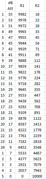

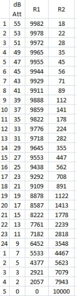

I've been fiddling with my code, trying to squeeze the very last bit of accuracy I can out of it. A little while ago I was holding 10K resistance at +/- 250 ohms and didn't feel that this was good enough. I now have it down to (I think) below 200 ohms variation and feeling pretty good about it.
Then I went online and found a website that allowed me to easily get the R1 and R2 resistances for 2dB steps on a 10K pot. I am now wondering why I bothered messing with the precision I've been shooting for -- for R1, two-thirds of the attenuation range sits between 9000 and 10,000 ohms! And on the R2 side, the last 2dB of attenuation spans the range from about 8000 to 10,000 ohms. In other words, a 250 ohm variation at 10K is practically irrelevant!
As the resistance goes down, the accuracy goes up, and at the far end of the range, at 50 ohms, I can control to 1/10th of an ohm. So, in the area where it counts I have very good accuracy, and in the area where it doesn't matter much, I still have pretty good accuracy but not pinpoint accuracy.
Attached are the calculated resistance values I got off the web. This is specified as a 10K pot with output load of 10K ohms.
Personally, I think you have achieved a remarkable result and could call this part of your development complete - can this control of the impedances be extended for the equivalent of a 20k, or 50k, pot and still obtain a corresponding reasonable accuracy of impedances?
