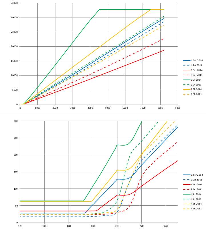

The LDRs I used came close to or below 45R at 6mA. I measured very small differences in resistance for high differences in currents above 6mA. The extension of the range has a very low efficacity, with a higher risk for fast aging. They are extremely non-linear in this area. That's the reason I stopped at 6mA as that seemed the most efficient point.
But now I discovered even 6mA is too high at long term. Splitting the range in "normal use mode" and "background listening mode" with a relais seems more wise. That will be my next modif. I still have some LDRs to change the used ones to start from scratch.
I've added graphs to make this clear. Vertical scale is resistance measured with full-scale 50kR instead of what's shown. Horizontal is current with +/- 6mA at 0 and close to 0 at max. Take care, the 6mA stays stable upto +/- 170 due to the hardware limit I built in.
Sorry to add that much in your post, I should have started this in mine...
