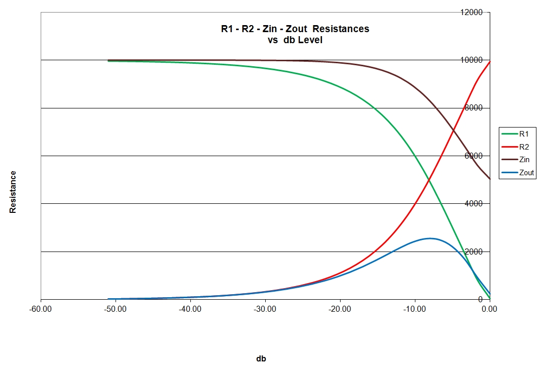

James, what potentiometer value is ideal for transistor amps? I assumed that it was 10K, but have I got it wrong? Here is my spreadsheet-based impedance calculations for a 10K pot. These curves assume a 200 ohm source impedance and a 10K load impedance. The curves do change slightly with changes in source and load.
Zin falls @ low attenuation because the load resistor is too low.
For a 10k vol pot the minimum recommended load is 5times Zout, i.e. >12k75
I prefer 20times (or more if available) Zout giving load = 51k
Minimum Zin = 10k||51k = 8k36 cf 5k
Using 100k for the load gives min Zin = 9k1 (just 9% less than 10k)
