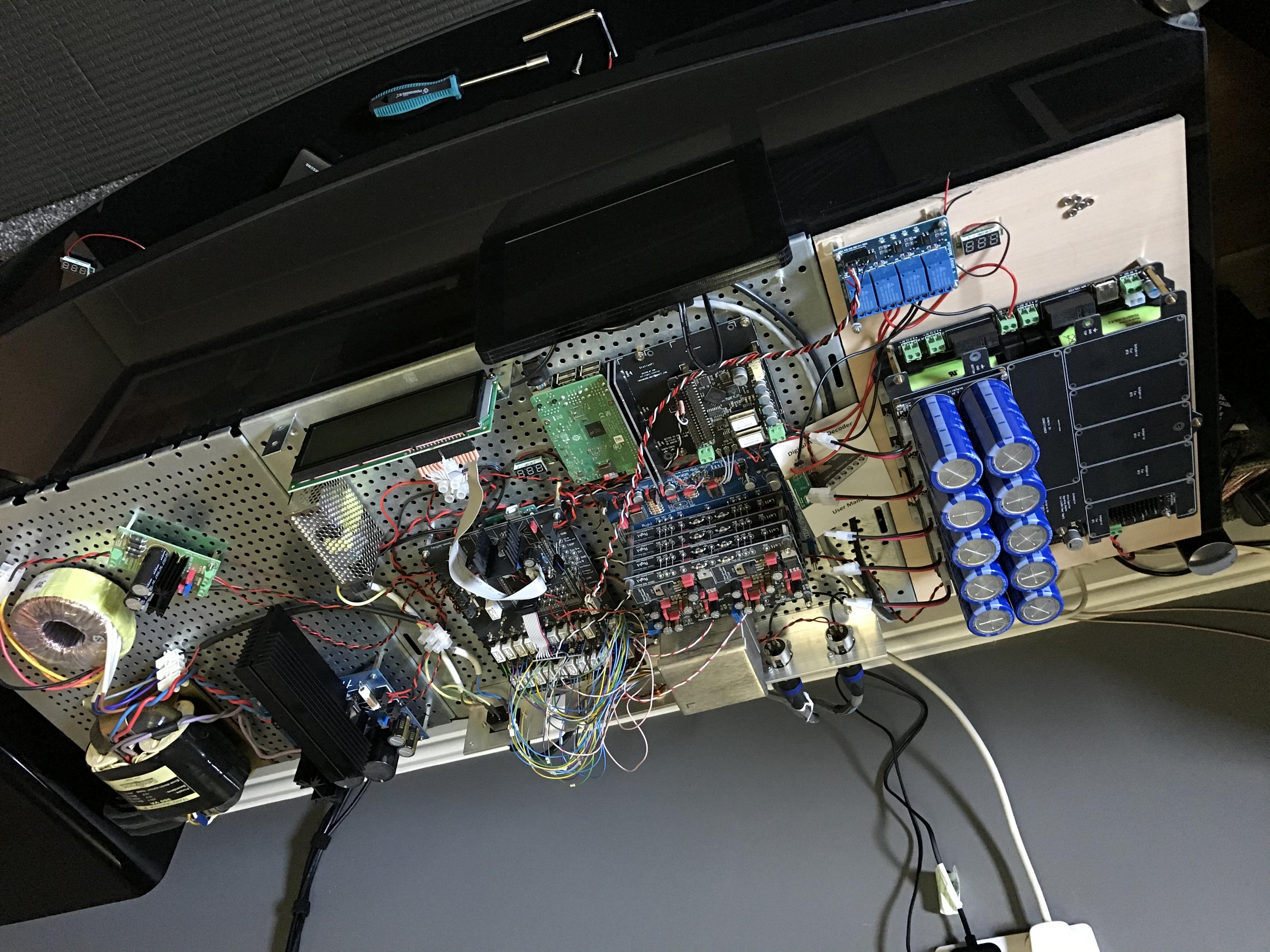

Current status with the new Pi streamer with FIFOPi and battery PSU with super caps 😀
