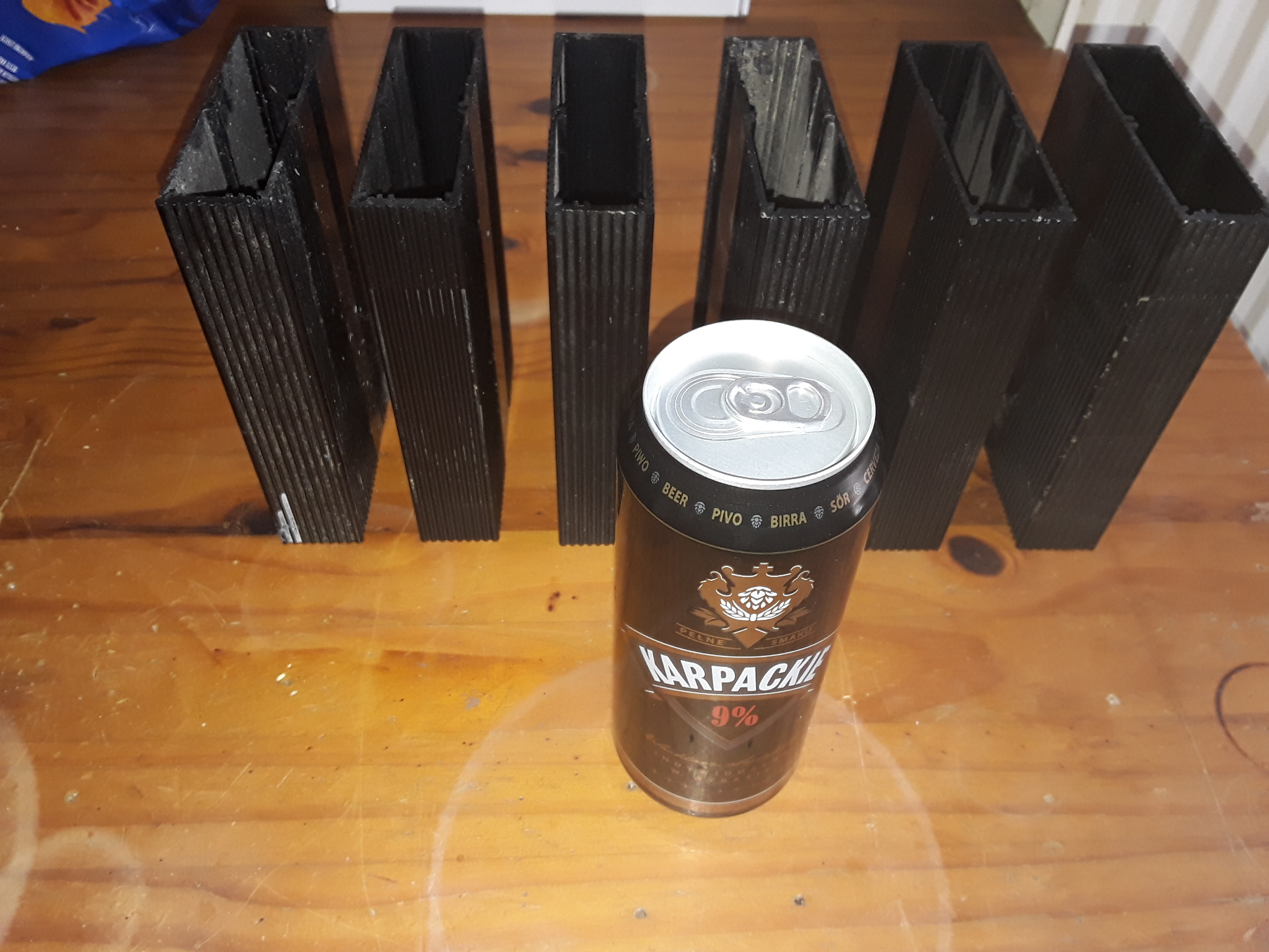

I will make it with some leftovers from my former employer. 300 grams each. Can interconnect them with the 2 mm aluminium panel so without power supply it will be below 5 kilograms.
Not sure how i will use them in the end . Probably for vibration killing properties i could give each rectangular it own " cap" with something attached so i can " fix it " on one spot in a sandfilled box. Between rectangular 2 cm of sand .
Can be done very easily.

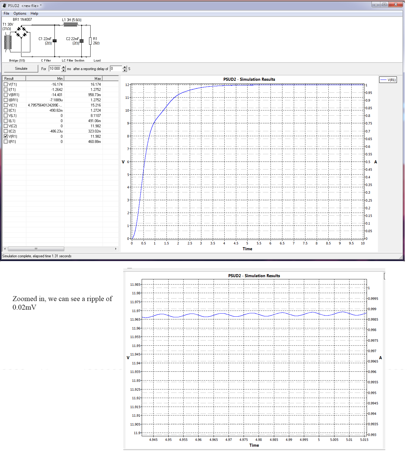

Played around a bit with this config in PSUD2
- CLC: 22.000uF - ll2771 - 22.000uF - 26ohm bleeder
- It takes about 5 sec to reach full output. The Input is 30vac and the output is 12vdc(11.9v)
- The ripple is 0.02mV
- I(r1) = 460mA...
This is just a test.. ofc
- I(r1) = 460mA...
