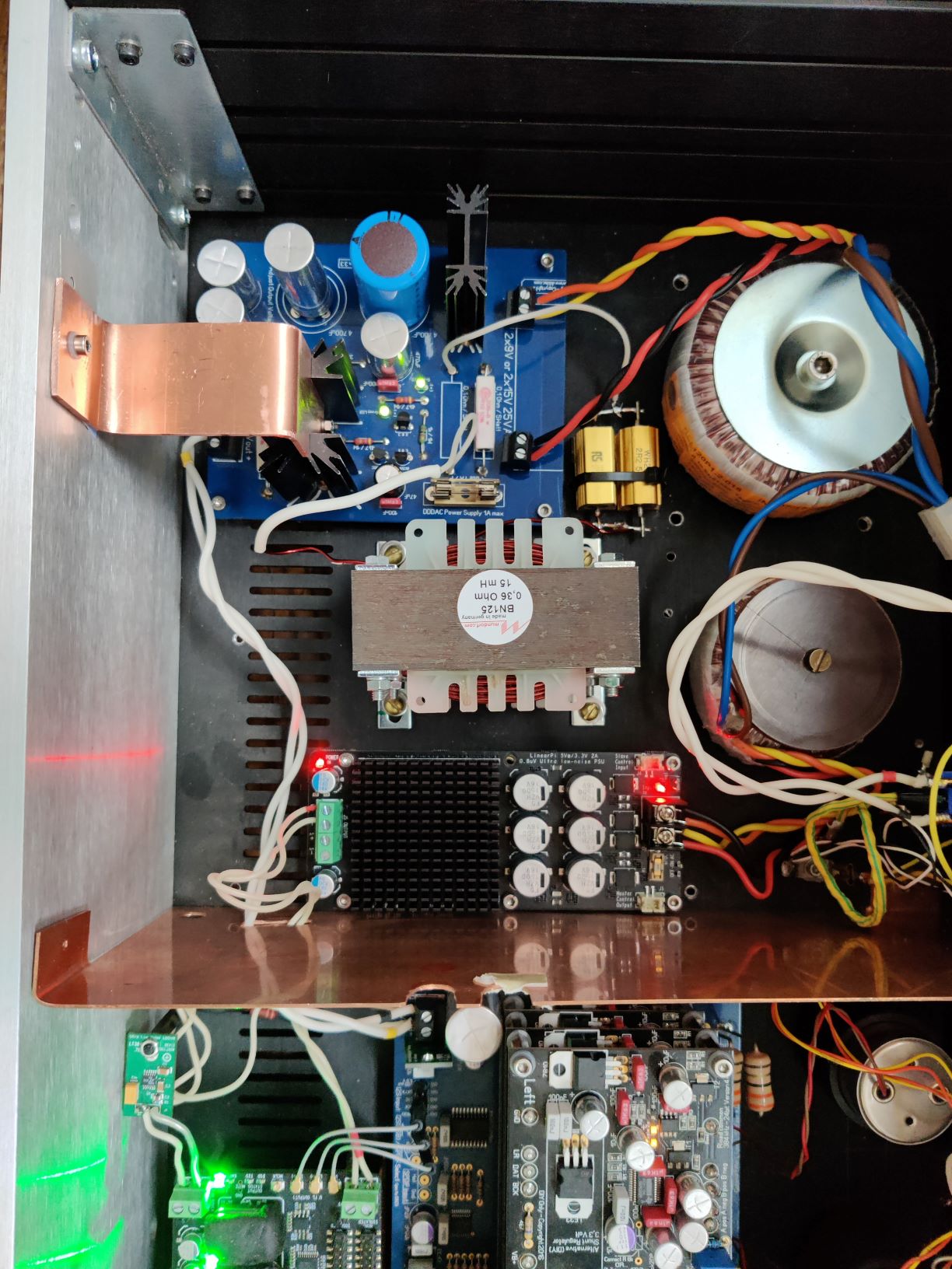

Here is a review of my updates of DDDAC shunt regulator and power supply. But first I have to explain why I started my upgrades of my power supplies, having BBB-Hermes- cronus In my system for many years, and being very satisfied with the sound signature. But also, in the knowing it was going to be obsolete and was not the easiest to update. I then moved to Raspberry pi-Fifopi combo. After the change, I was not totally satisfied with the high notes and transients, they came out very hard and annoying. A track that sounds very annoying if something is wrong, is Quincy Jones “Q’s jook joint”-you put a move on my heart” Track 4. Tamia’s voice on the track is very revealing, she will tell you if anything is wrong in the top end. I cornered the problem down to be the standard DDDAC 5v power supply not being powerful enough for the pi setup. And the fifopi to close to the pi. The first thing I did was to make a cobber shield between the pi and fifo, this really helped the attack and precision of the transient response. I recommend users that also have this setup to move the fifopi away from the Raspberry pi, one way or another. Next step was to upgrade the 5v power supply to Ian Canada 5v supply powering the pi. This was another positive step. Suddenly the snapping sound in left channel of Elvis Presley’s “Fever” did not sound as hitting an old fish with a wooden spoon, but as what I really is. Next step was to upgrade my 12v supply, and would not have come through this operation without the help from Doede, Eduard and Mbernnwa. Thanks again. The 12v upgrade is in my opinion not a night and day experience, but still a positive step toward a “analogue” reproduction. The 12v upgrade made the sound stage of a stereo recording more precise and ambient. After making new updates in my system, I start with Phil Spector “Back to mono” I find mono recordings very reviling in a stereo setup, but here the big bonus was the stereo reproduction. Then it came to the 5v shunt regulator on the blue motherboard. I have had the Ldovr 5v there for many years, a dear friend of me gave me a 5v Tent shunt regulator. After installation, I can only agree 100% with Doede’s review in earlier post. Upgrading the DDDAC is a odd hobby, my wife keeps telling me, and somehow, I must agree with her. But here I go again, Eduard was so kind to send me two Bourdere 0,1H Chokes to put in series =162mh/2.6 ohm to try instead of the Mundorf 15mh+1.32 ohm I was using in my 12v supply. The Nos chokes from Eduard made the soundstage now even more precise and ambient. Female voices has more texture, on Louis Armstrong & Duke Ellington “The making of the great summit” track 3. Louis Armstrong voice and trumpet comes out just beautiful, I can recommend this lovely recording, you have hands clapping, footsteps, whiskey bottle opening and a great soundstage. Just loving it😊 In my system the cobber and 5v upgrade has the biggest effect. But I do not regret the 12v upgrades they are here to stay.

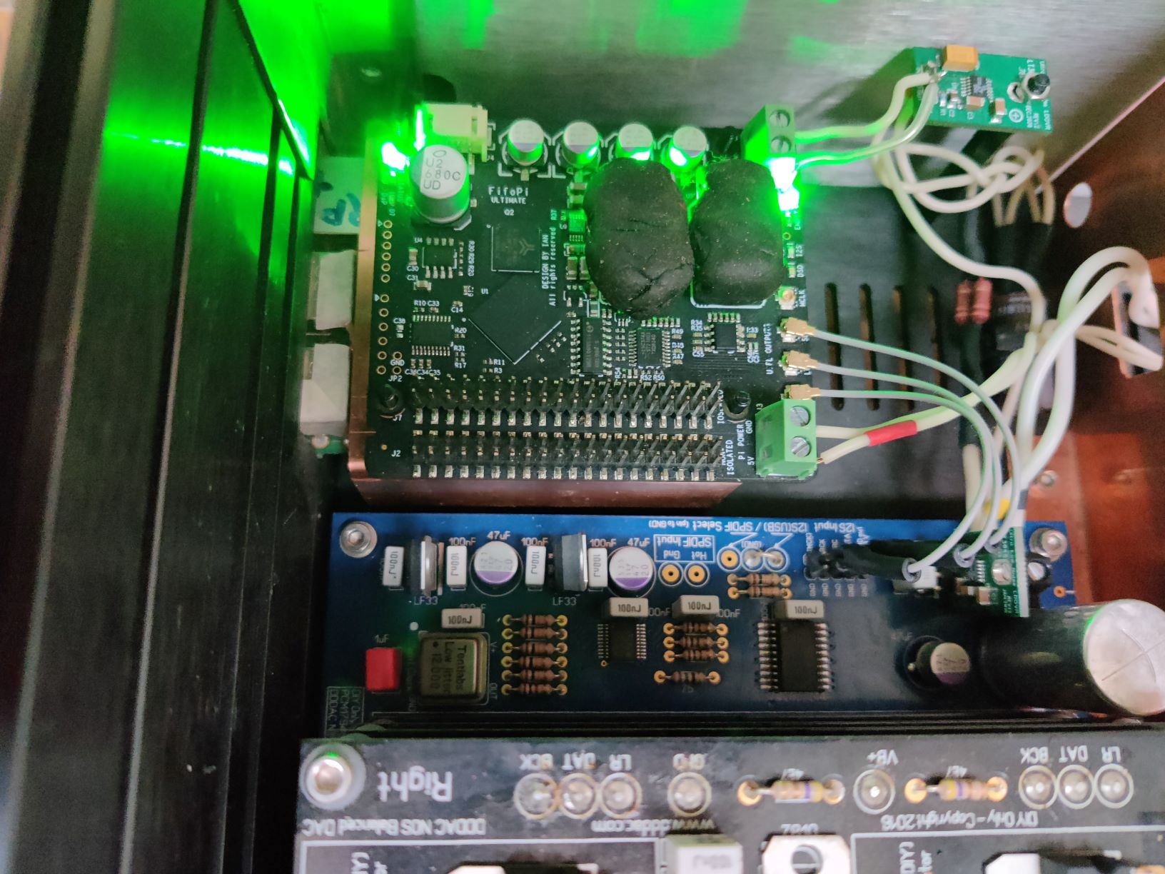

Thanks for these insights! Which oscillators do you have on your FiFoPi? And what's the black stuff on them?
The oscillators is the accusilicon, and the black stuff is Butylband beidseitig stark klebend | WURTH
...the black stuff is Butylband beidseitig stark klebend | WURTH
...to keep the oscillator temperature more stable? Or something else?
I put it on to damp vibrations, when a/b testing upgrades the Dac is very close to my speakers with the cabinet open. The temperature issue is not the prime reason.
Hmmm... I guess damping mechanical vibrations would require a bit of mass coupled to a resistive element to dissipate the vibration energy.
True is your conclusion.. but tapping with a nail on the oscillator, made me use this solution as a quick fix.
