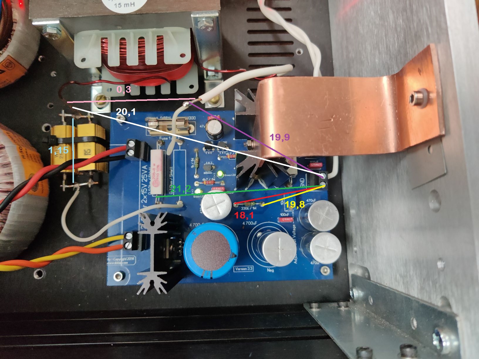

The resistor is 2.7/3.3 ohm =1.32omh and when i measure from one side of resistors to the box of the dac i get 37,3 vac.
Is this the right place to measure the voltage drop?

Hello Bubu,
You should check the DC voltage ACROSS the two resistors in parallel which gives a value of 1,485 ohm so voltage drop should be around 1,5 volts.
Like i said before in a private message it looks like the input voltage of the regulator is to high.
I would wait for Doede to react and switch off the unit before you will fry it.
Greetings, eduard
Hello,
So then drop across the two resistors combined should be around 1,32 volts.
AND you should try to check DC voltage on the capacitor that is on the input side of the resistor.
I think it will be higher than it should according to the DDDAC blog.
If it is to high you can use a choke with a higher dcr to make the actual input into the circuit lower like i explained in a pm.
greetings, Eduard

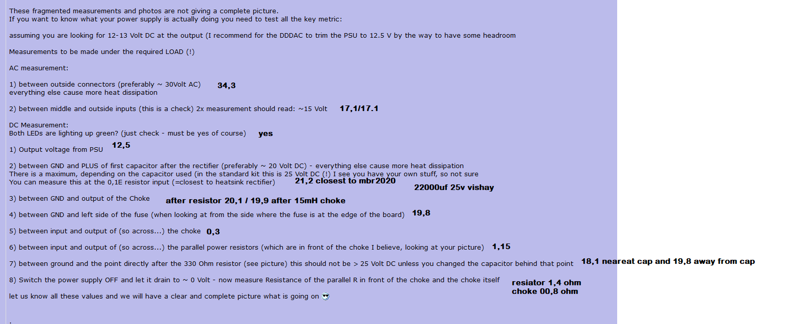

These fragmented measurements and photos are not giving a complete picture.
If you want to know what your power supply is actually doing you need to test all the key metric:
assuming you are looking for 12-13 Volt DC at the output (I recommend for the DDDAC to trim the PSU to 12.5 V by the way to have some headroom
Measurements to be made under the required LOAD (!)
AC measurement:
1) between outside connectors (preferably ~ 30Volt AC)
everything else cause more heat dissipation
2) between middle and outside inputs (this is a check) 2x measurement should read: ~15 Volt
DC Measurement:
Both LEDs are lighting up green? (just check - must be yes of course)
1) Output voltage from PSU
2) between GND and PLUS of first capacitor after the rectifier (preferably ~ 20 Volt DC) - everything else cause more heat dissipation
There is a maximum, depending on the capacitor used (in the standard kit this is 25 Volt DC (!) I see you have your own stuff, so not sure
You can measure this at the 0,1E resistor input (=closest to heatsink rectifier)
3) between GND and output of the Choke
4) between GND and left side of the fuse (when looking at from the side where the fuse is at the edge of the board)
5) between input and output of (so across...) the choke
6) between input and output of (so across...) the parallel power resistors (which are in front of the choke I believe, looking at your picture)
7) between ground and the point directly after the 330 Ohm resistor (see picture) this should not be > 25 Volt DC unless you changed the capacitor behind that point
8) Switch the power supply OFF and let it drain to ~ 0 Volt - now measure Resistance of the parallel R in front of the choke and the choke itself
let us know all these values and we will have a clear and complete picture what is going on 😎

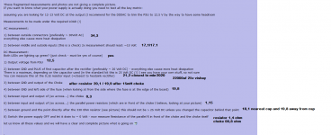

I measured and hope it is at the right points i measured. At the points that i was not sure, i made measurements at both sides of the resistor.
6) should i change the order of the resistor/choke to choke/resistor?
The only thing that i have changed is the 22000uf 25v Vishay the rest of the blue board are the original components.

Hi Bubu,
ok, I read all values and congrats, all is 100% fine. The reason you get a hot TIP122 is because your input voltage is a little bit a the high side, hence you are dissipating roughly 7-8 watts. No problem for the TIP, but with this heatsink it will heat up like 50 degrees above room temperature. That is than like 70 to 80 degrees and yes, that feels hot. Nothing will break, but it was a good idea to add some extra cooling 🙂
Nice that Elvis is alive again 😛
oh, no need to change the order of resistor and choke...
edit after reading Eduard post: At point 4) you need like min 18,5 Volt DC, so you could loose another 1,3 volt so add another 1,3 Ohm in series with the choke if you want or using a choke with 1,3 Ohm more.
This will reduce the power dissipation with ~ 20% so ~10 degrees less
