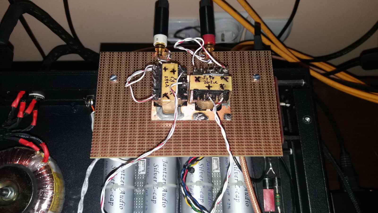

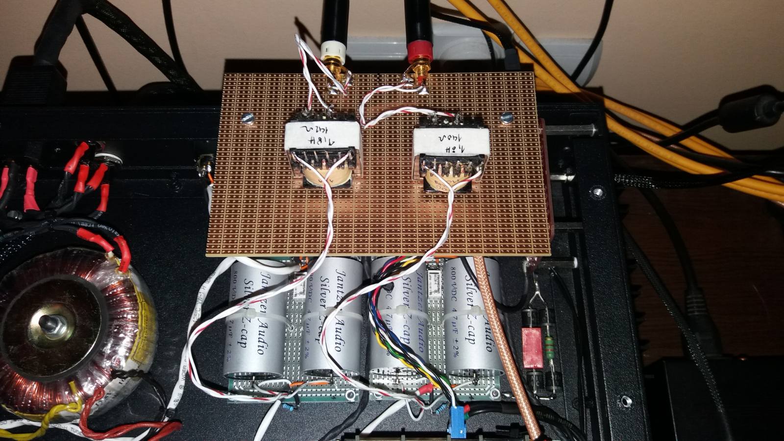

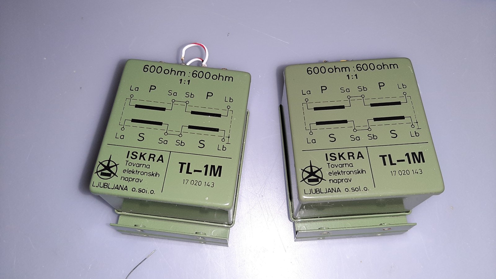

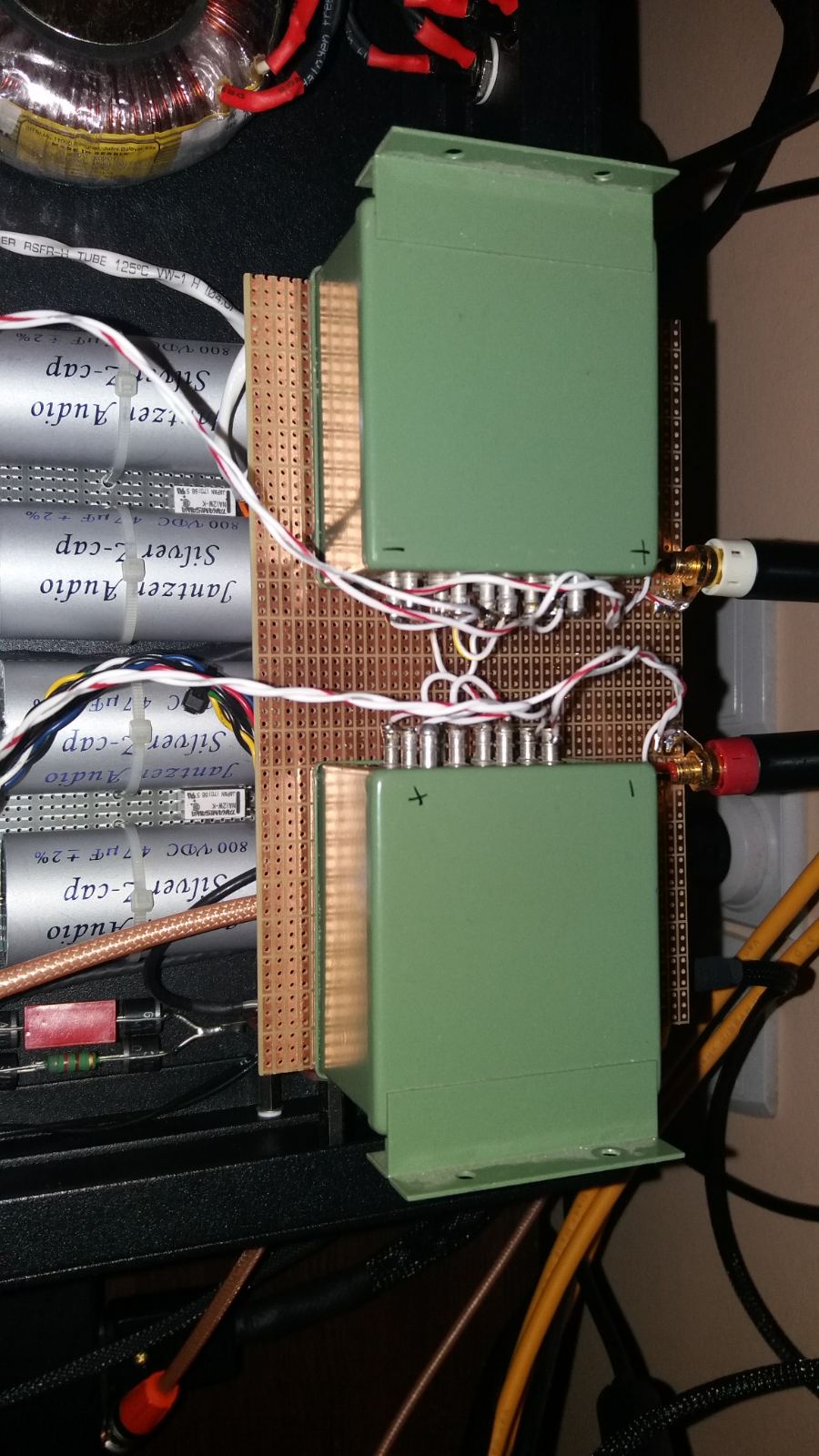

I'm trying some 600: 600 ohm DIY transformers on the DDDAC output, so I'm wondering if I can try a 10k: 10k transformer? Has anyone tried it? DDDAC is with 4 boards.
600 Ohm is fine, has less windings as 10k normally and hence a larger bandwidth. Make sure to terminate the output with 600 Ohm - 1k5....

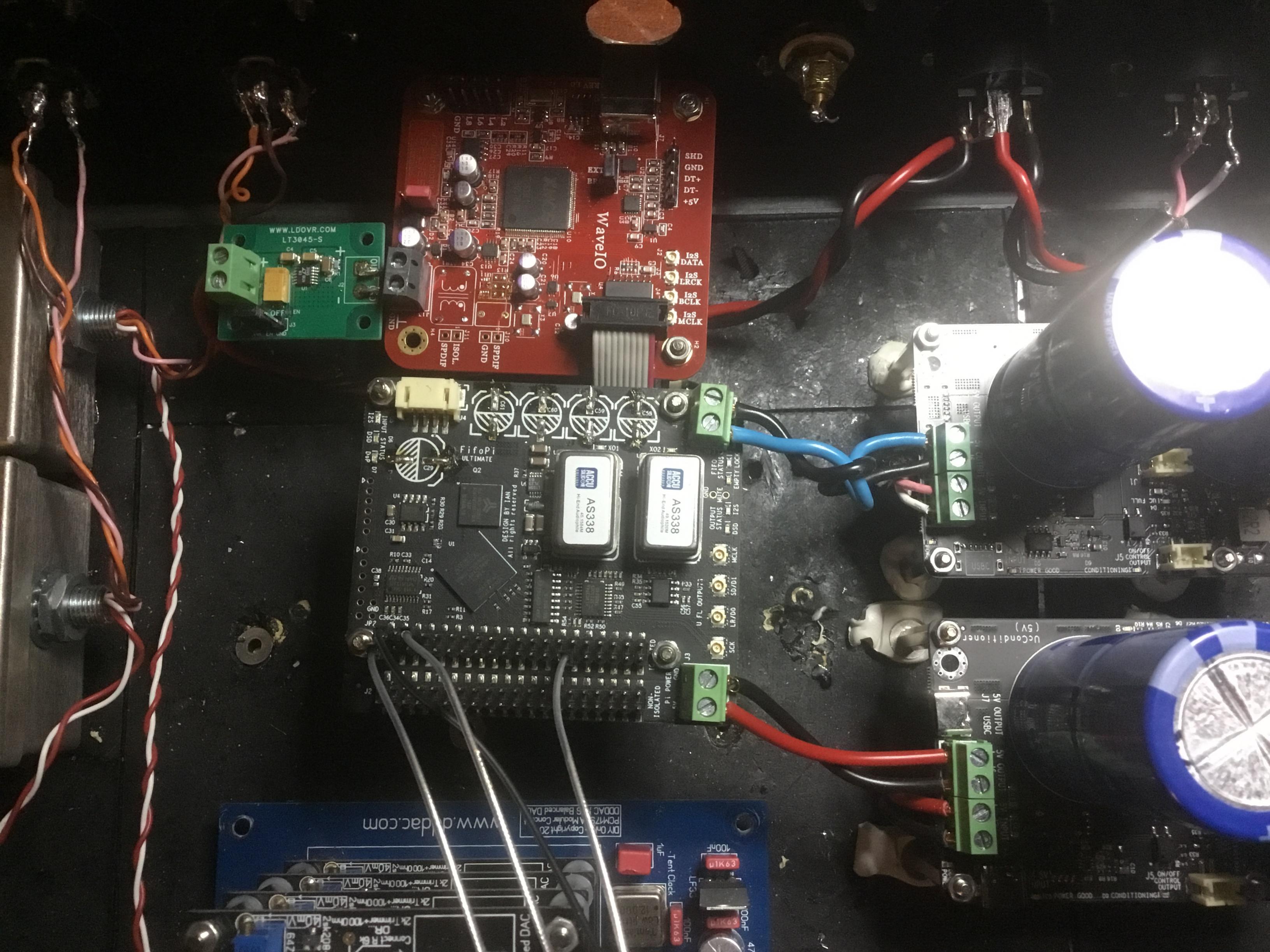

I have FIFO Pi Q3 in my system for quite some time now. I'm very pleased soundwise when a track is running, no pop / clicks, very clean and detailed sound, great soundstage.
But there is one issue I'm struggling with: When I start playing a new track or jumping to a new position within the same song, there is often one short (loud) click / pop. After that the track plays without issues with great sound. The click volume differs, sometimes it is quiet I can almost not hear it, but most of the times it is really loud and I'm afraid that my speaker get broken!?! Also the 'position' of the click moves: Most of the time on the left side, sometimes the click moves to the middle and right side of the soundstage. Really strange.
My chain is: RPI I2S -> FIFO PI Q3 -> DDDAC.
I'm running volumio, but I have also tested with moode. Same issue. Because I thouht this comes from EMI issues I have ordered a GPIO extension cable to get some space between RPI and FIFO PI. But did not help either.
With RPI USB -> WaveIO -> DDDAC I have no such issues, so I think my DDDAC, PSU and the rest of the chain is not the problem.
A test without FIFO PI (Only RPI) is pending (Maybe I have the time at weekend).
Do you have an idea? Someone with the same issues? I would really love to keep the FIFO PI in the system because sound is great when track is running, but the clicks in the beginning are driving me crazy...

Thank you for your feedback. Seems that I'm not the only one with this issue!?
I did a check without fifo pi q3. Means RPI I2S -> DDDAC
no clicks and pops anymore!!!!
I then installed the fifo pi again and I also exchanged the accusilicon clocks against the default clocks, but this didn't help either. Clicks and pops again... 🙁
So this tells me, that the fifo pi is the cause of the issue!?? Maybe it is broken? Or maybe this is 'normal'. Crazy that there are some people with the same issue and others are not having any clicks / pops 😕

Sure you can try. Just make sure to keep the DC voltage across the primaries at zero to avoid saturating the core (some transformers are more tolerant to this than others).
Can I try these transformers at the DAC output? The measurement of primary and secondary is L = 1.5H + -0.05H, DCR = 20ohm + -1.5ohm. They are quite large.
With one Deck, you will have a low frequency -3dB point of 28 Hz
2 decks 14 Hz and 4 decks 7 Hz.
Connect the primary between POS and NEG and leave the Common pin not connected ....
Looking at the specs, they are close to the special DDDAC Sowter transformer.
This could work very well, as they are large, they will be able to handle high output voltages at low frequency which will give a solid sound....
Let us know how it went, ok ?
Thanks Doede, I have 4 decks, bass will be there. I'll connect them tomorrow. I'm just wondering how it will sound.

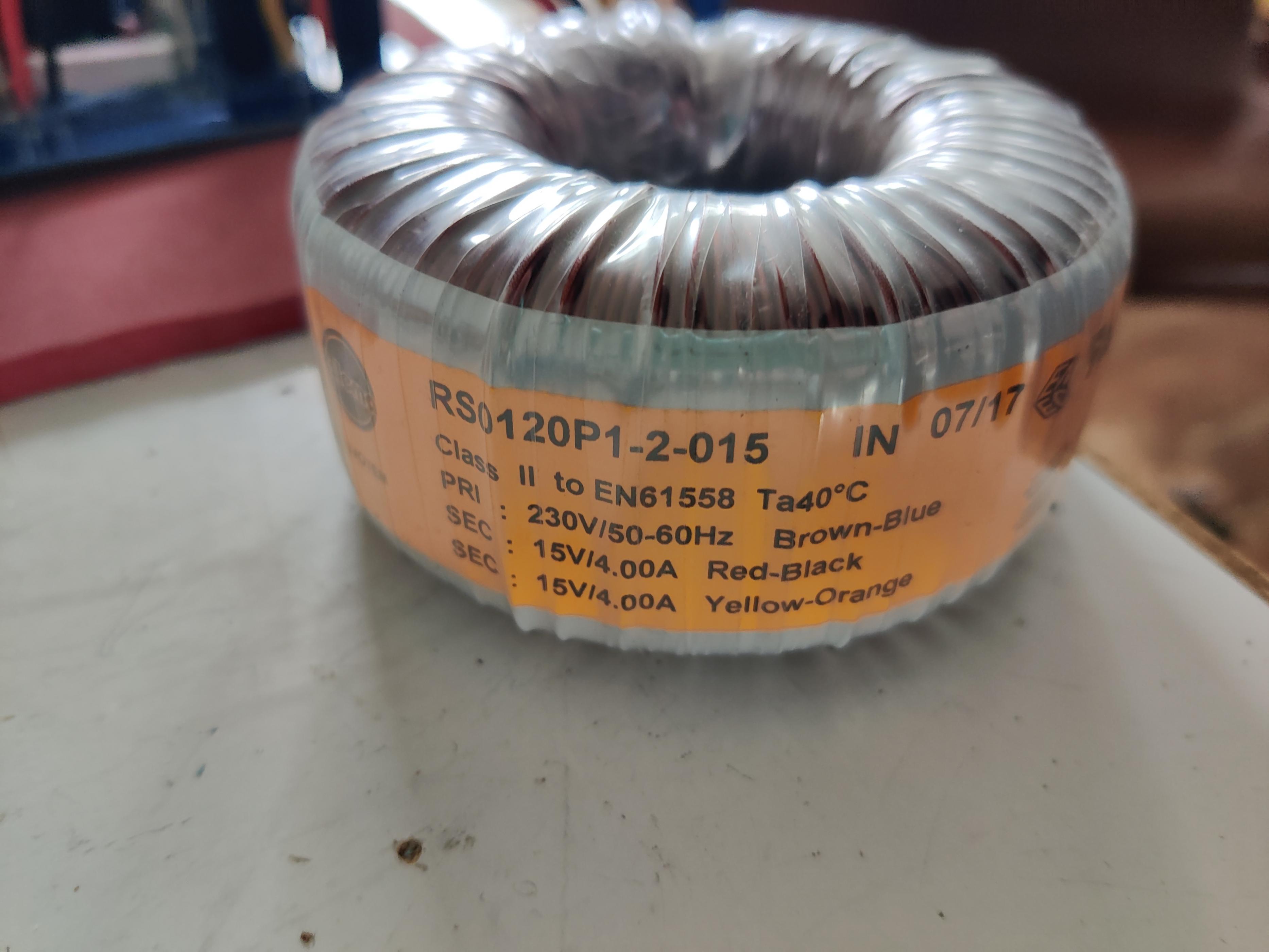

I have been reading Doede and mbernnwas posts on power supplys and have some questions on how to put i all together.
1. Are my leads from the 15v side ok? i measure 32v at the two outer holes of the blue board the trafo is a 2x15v 120vac 4A.
2. should i install 15mH 0.36ohm trafo and a 0.5ohm resistor in series? or leave the original 0.1ohm in?
3. what size of the fuse to use 250v ?A?
The blue capacitor is 22000uf the rest of the blue board are the original parts.

How much current do you need for your DDDAC?

Toroidal transformers are most sensitive to saturation if there is some DC across the primaries. I'd suggest you tweak your DC imbalance to super-duper low levels by adjusting the load resistors accordingly.
