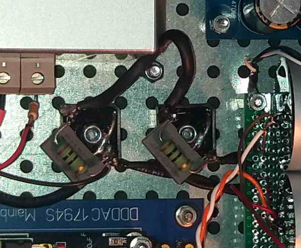

1. Connect DAC supply GND to chassis with 10ohm + 100nF in parallel.
2. Connect WaveIO suppply GND to chassis with 10ohm + 100nF
3. Connect Pin1 to chassis or to DAC supply GND
4. If there is still some buzzing, put 2.2uF cheap poliester capacitor on each DAC output.

Do you have a picture of your set up as an example?
Here's a picture. Plus and minus pin of both greatz 10A 1000V connected together. One AC pin from both greatz connected to the chassis, the other AC pin connected to GND from DAC supply (or WaveIO supplu, separately from DAC). AC pins bridged with 10ohm 2W MOX resistors and 100nF X2 PP capacitors. On the pin where the power supply from the DAC is grounded I connected Pin1 from the XLR connectors. An alternative is Pin1 on the chassis.

Well looking back on the discussion from last month, pin1 of the XLR came up a lot. I did the most basic experiment of taking an interconnect and putting one end on pin1 and the other end to chassis (where the XLR plug is bolted). Buzzing completely gone and absolutely silent on the headphones. So I think that's cracked it, I just need to connect pin1 to chassis like in my NC400 amp.
I listened to some music through my headphones even with the ground loop in the background and it still sounded incredible! Wow, absolutely cannot wait to get the solder iron out.
I also decided to upgrade my DDDAC (well tweak) for the first time in a few years and will now run it from a Raspberry pi with FIFOpi attached (and Newclass D Neutron Star clock) feeding directly to the I2S pins of the DDDAC. Also ordered some Salas regs and other PSU bits so I just cannot wait to hear what this is all going to sound like 🙂🙂🙂
Just wanted to report back.... pin1 connected to chassis and no buzzing just awesome sound!!!
