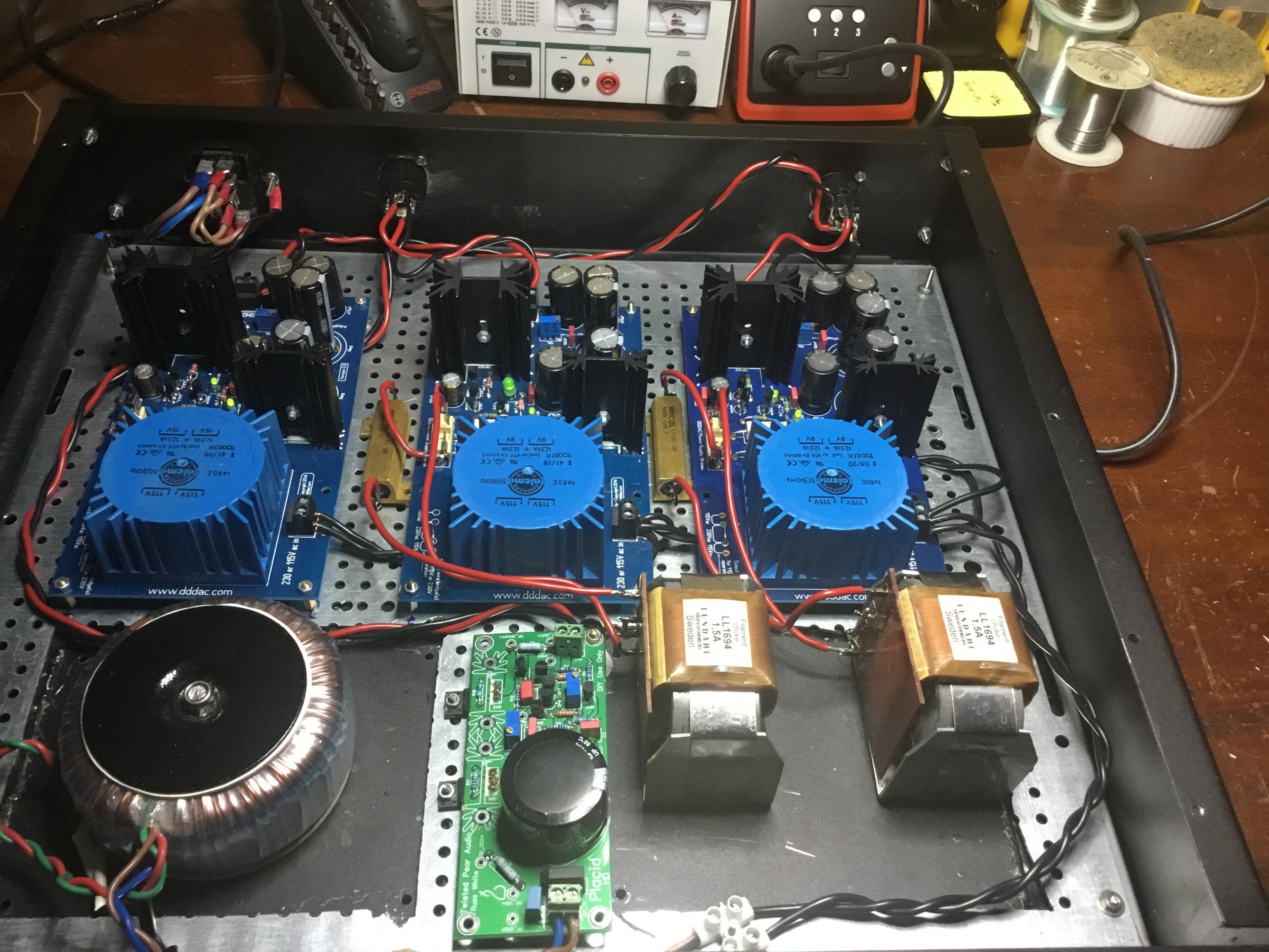

A NOS 192/24 DAC with the PCM1794 (and WaveIO USB input)
yes, no resistor at all. I think the bleeder is needed to give the choke a minimum supply or current draw. I think the chokes do not like the "no load" scenarios. But my DDDAC PSU is always drawing about 700mA (DDDAC mainboard with two DAC boards and WaveIO). So I think the DDDAC itself is my bleeder ;-).

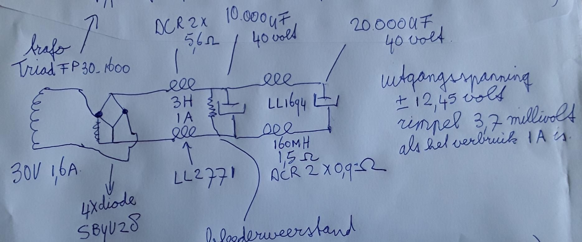

Hello,
In the attachment you can see a drawing with Dutch language to explain how to do it to a diy friend.
With a choke input it is kind of mandatory to create a minimum current flow ALL the time by using the right resistor AFTER the choke.
Sure you can say that the shunt will be there to create enough current right from the start.
Because i am using a BIG choke with higher DCR i choose to use a bleeder because with no load at all the voltage across the cap will go up a lot. With the right bleeder it will drop to a value that will be safe for the caps with or without the circuit connected.
MAYBE you can raise the voltage a little bit by using other diodes. There is a big difference between 40 and 160 mH.
I started with a special LL2733 540mH 1,25A then changed it into LL2771 3000mH 1A when that one appeared on the market. Happily my diy DDDAC chassis was big enough to install the LL2771. I replaced the 500VA r core power transformer. The transformer in the drawing is around 15 euro. I am convinced that for choke input better invest in a bigger choke than a bigger transformer. The choke will create a nice steady charging current so the transformer and diodes will have an easy job.
Greetings, Eduard

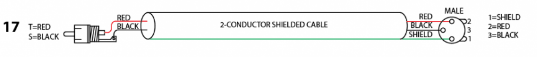

I’m not so sure how this behaves when going from Xlr (balanced) to rca (unbalanced).
You need to convert from XLR (DDDAC out) to RCA (amplifier input)? If your DDDAC has a transformer output, I'd suggest the following:
  • Connect the DDDAC chassis to XLR pin-1.
  • Connect the transformer secondaries to XLR pin-2 and pin-3.
  • Do not use the XLR/RCA conversion from your link, because it connects the audio GND to the chassis/PE (not good!).
  • Instead, use the Rane #17 connection, but use the cable "backwards". This will connect the transformer secondaries (XLR pins 2 and 3) to the RCA "tip" and "ring" at the amplifier. The cable shield at pin-1 will be connected to the DDDAC chassis, but is separate from the audio signal.
This is how I connected my DDDAC to my USSA5 amplifier, which only has a single ended input.

  • As far as I understand the instructions for the DDAC1794 outputs, this connection is possible when there is a transformer at the output. When there are capacitors at the output (my case) then this connection is not possible.

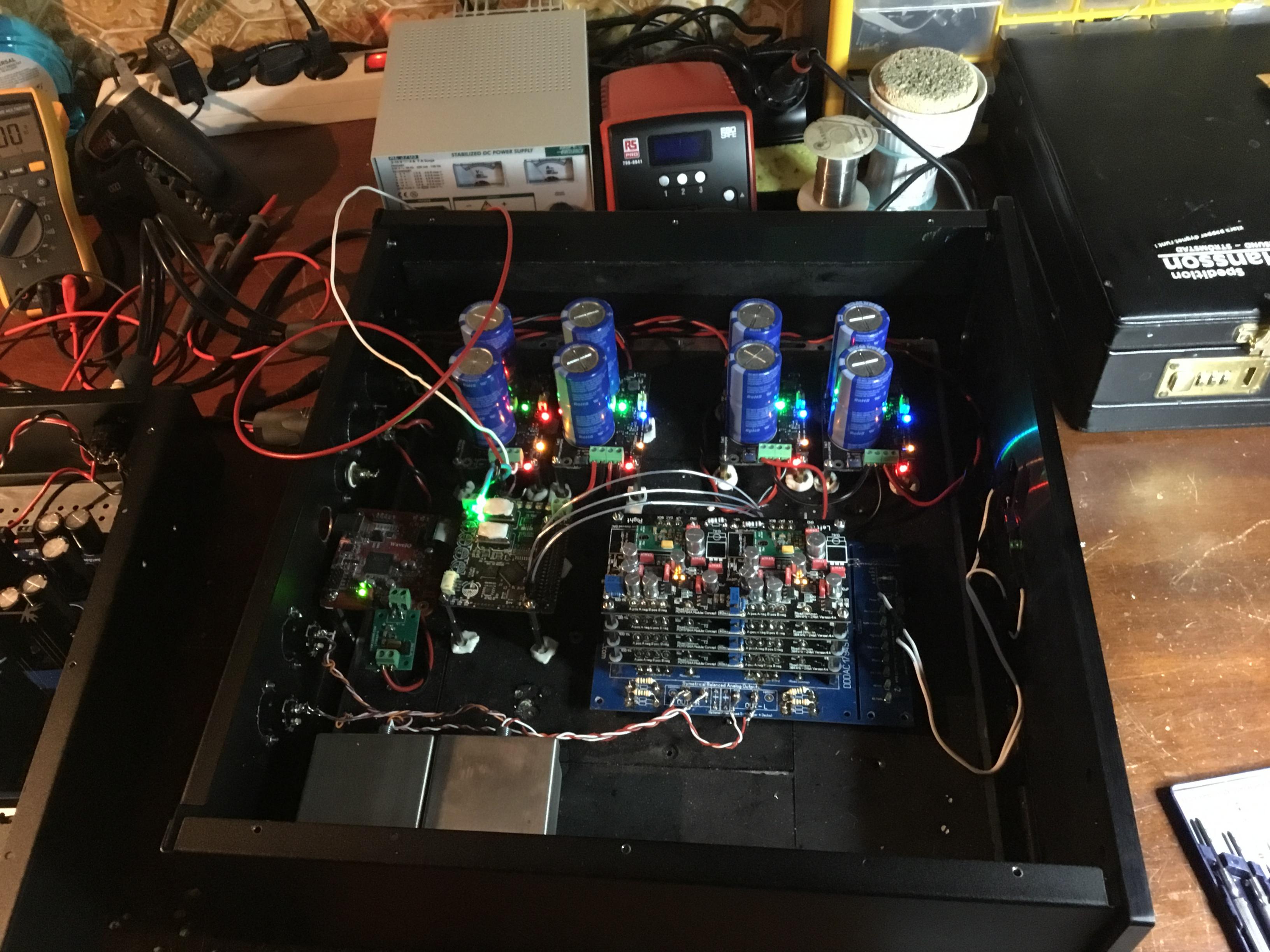

Stock dddac psu, no problem at all. Just remember to not connect load before power up the first time after the supercaps is installed, (if your psu deliver around 1A, as mine).If you have a bigger psu, 2-3A, you have enough juice to power up with load connected.
I was afraid that I have to disconnect the load if dac had been powered off for a few days or so, but so far so good. It takes only a few sec, and everything lights up on the Uccapacitor boards from Ian. Very pleased for time beeing.

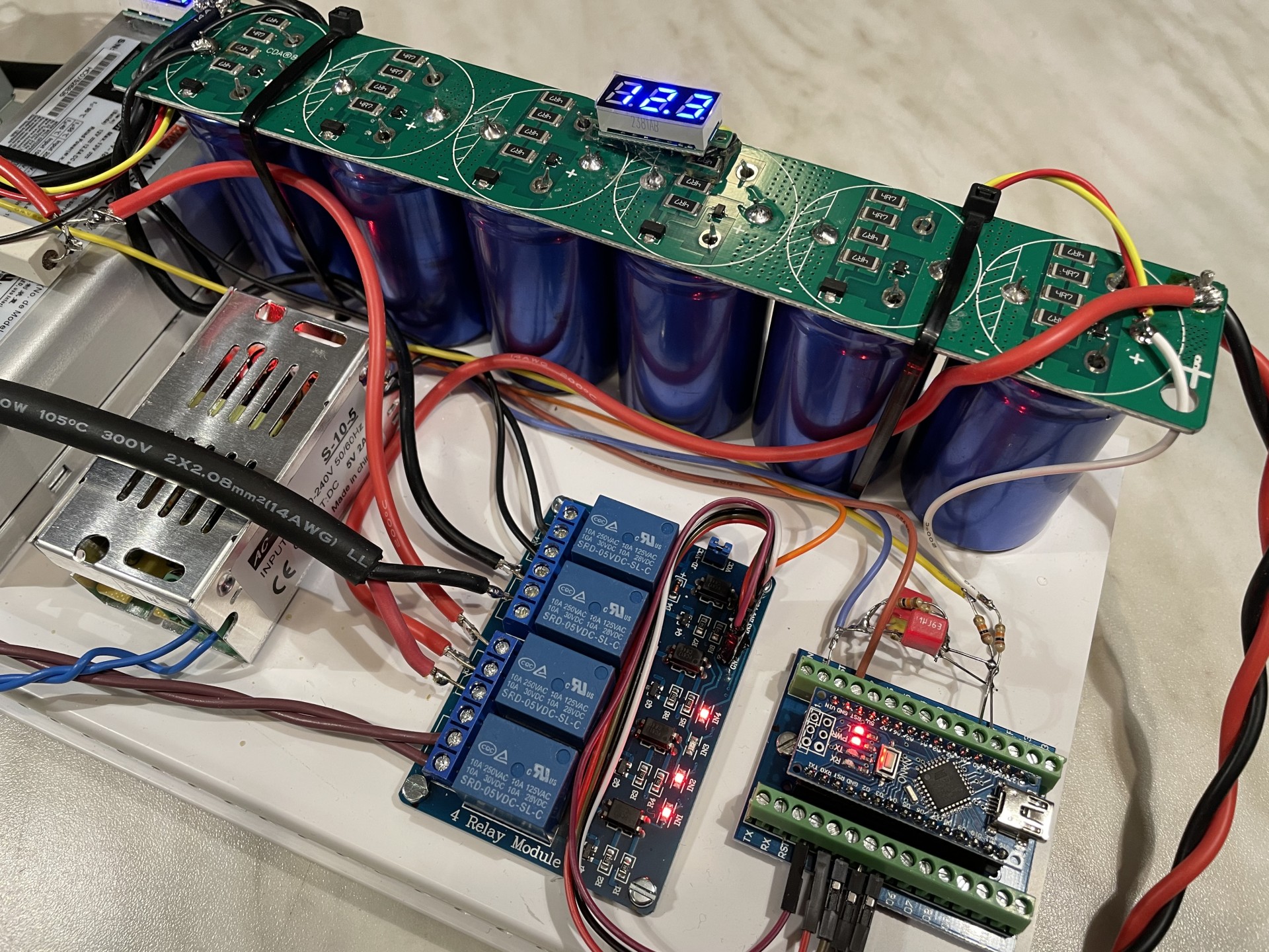

Funny, this is exactly the topic i am struggeling with at the moment.received fifopi yesterday toghether with a 3.3v conditioner. Unfortunately i have not informed myself about startup charging currents. I connected the conditioner behind a 3.3v regulator board which is itself connected to dddac psu. Fifopi was connected to the conditioner. In this setup dddac 1A fuse blew about 3 times. I measured about 3 ampere at the fuse.i then removed the conditioner and everything was fine. This morning i read the manual and found the hint that the psu needs at minimun 1.5A for the first load of the super caps. If no such psu is available (like in my case) the load needs to be disconnected in the beginning (first load) So I connected the conditioner again but without load. In this setup the conditioner ran about 1 minute (the two LED were on in this time - OK). After about one minute it seemed that the conditioner turned into another state (tried to turn on other LEDs!?) and fuse blewed again. Did I kill the conditioner by connecting it with load in the beginning?
Fifopi ist great by the way. Better than waveio even without conditioner. I'm wondering if it is worth to further try to get the conditioner running!?! Cannot imagine to get further improvements, but this was also the case in the past and then I was surprised when there was another improvement.
I had the same problem with a 5V Unconditioner that I was using to meet my DAC's 5V requirements. Just at switch over from charging to charged, it seems that the Unconditioner very briefly draws quite a few amps from the source supply. I did measure the spike using a recording meter, but I don't seem to have recorded the value in my notes. It was sufficient to blow the 3Amp quick blow fuse that was installed in the Salas L-Adapter used as the source. Since this L-Adapter is built to deliver many more amps, I upped the fuse to an 8Amp slow blow as specified in the original L-Adapter design. Not had any problem since then.
