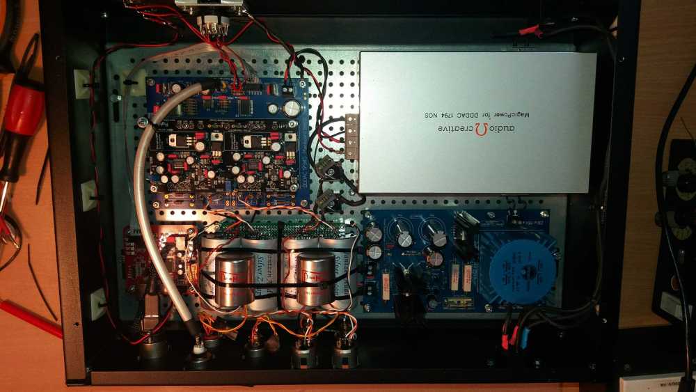

I had a similar experience with the Cinemag CMLI-600 / 600C. The picture is from the test Cinemag VS Jantzen Silver Z 4.7uF 800VDC. Cinamag lost the battle, Jantzen stayed in DDDAC. Put some good capacitors (4 pcs.) so you don't have to think about whether there will be problems with the preamplifier, balanced or single ended all the same. One capacitor on each output (L+ L- R+ R-). You can put 150k or 220k resistor paralell to signal GND behind each capacitor (usually not necessary).
Thanks Nixie, and nice lay out by the way 🙂 Im looking for a specific answer on whether I NEED to have caps or transformers when looking to buy a headphone amp (and the theory of why I need them). I would rather go direct and have none like I have been doing if possible. Also, it looks like you have a single board which is perhaps why the Cinemags dont sound great (I have 4 boards so transformers are still an option for me).

There are 2 boards in this DDDAC. This is not my DAC, but from a friend. I completely re-wired it with VDH SCS and other quality cables and now it plays phenomenally. Cinemag should work nicely with 2 decks but that was not the case. If you want to be 100% sure, install a Jantzen Silver Z or similar not less than 4.7uF.
My DAC is much older, with 4 boards, but still with Jantzens on the output.

Ahhh my eyesight clearly going down hill, Nixie haha Looks a lovely set up and thanks for the info on the caps. Certainly a cheaper option than transformers.
